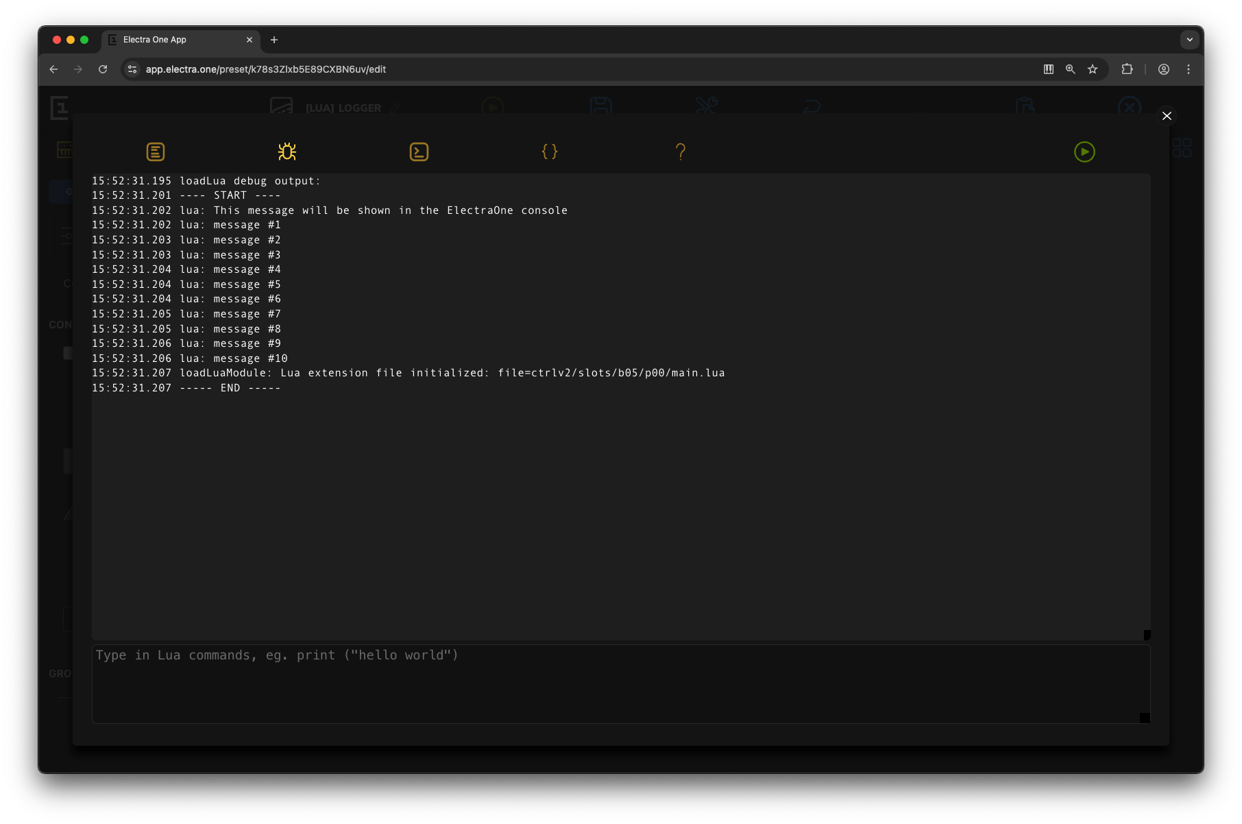

-- Printing to the console log
print("This message will be shown in the ElectraOne console")
for i = 1, 10 do
    print("message #" .. i)
The Example will produce following output in the Electra One web application Console
Hello world output
