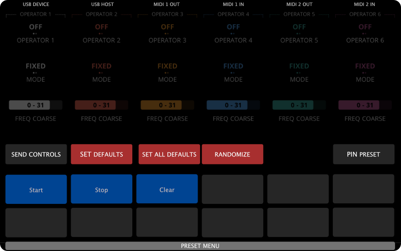

Assign Buttons
The Assign Buttons feature is used to assign custom Lua user functions to the controller’s hardware buttons. These assignments allow users to further customize the Electra One controller to fit their workflow.
Assigning a button
To assign a user function to a hardware button, arm the learning mode by tapping the [ASSIGN BUTTONS]. The learning mode is indicated by the flashing frame around the button.
Assign buttons armed
Touch and hold the knob that represents the user function you want to assign. The on-screen button will be highlighted while you hold the knob. While continuing to hold the knob, press the hardware button you want to assign the user function to. Once the hardware button is pressed, the assignment will be shown on the on-screen button representing the user function.

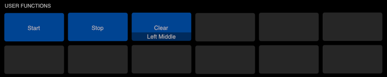

Assign buttons assigned
The picture above shows the Clear function being assigned to the Left Middle hardware button, while Start and Stop user functions stay unassigned.

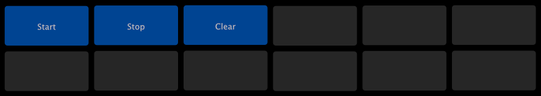

User Functions are custom Lua functions defined by the preset developer to provide additional actions or behaviors tailored to the preset. These functions are registered in the preset’s Lua script using the preset.userFunctions table.
Pinned preset button
Up to twelve functions can be registered per preset, each represented as a button in the Preset Menu.
  • Buttons with an assigned user function are shown in blue
  • Tapping a button on the touchscreen triggers the corresponding function
  • If enabled in the preset’s configuration (see Pot Touch Selections under Settings → Interface), touching the corresponding knob can also trigger the function.
User functions can perform virtually any task supported by the Lua environment, such as sending MIDI messages, triggering patch requests, adjusting control states, or interacting with external gear. This makes them a powerful tool for extending the preset's capabilities.
