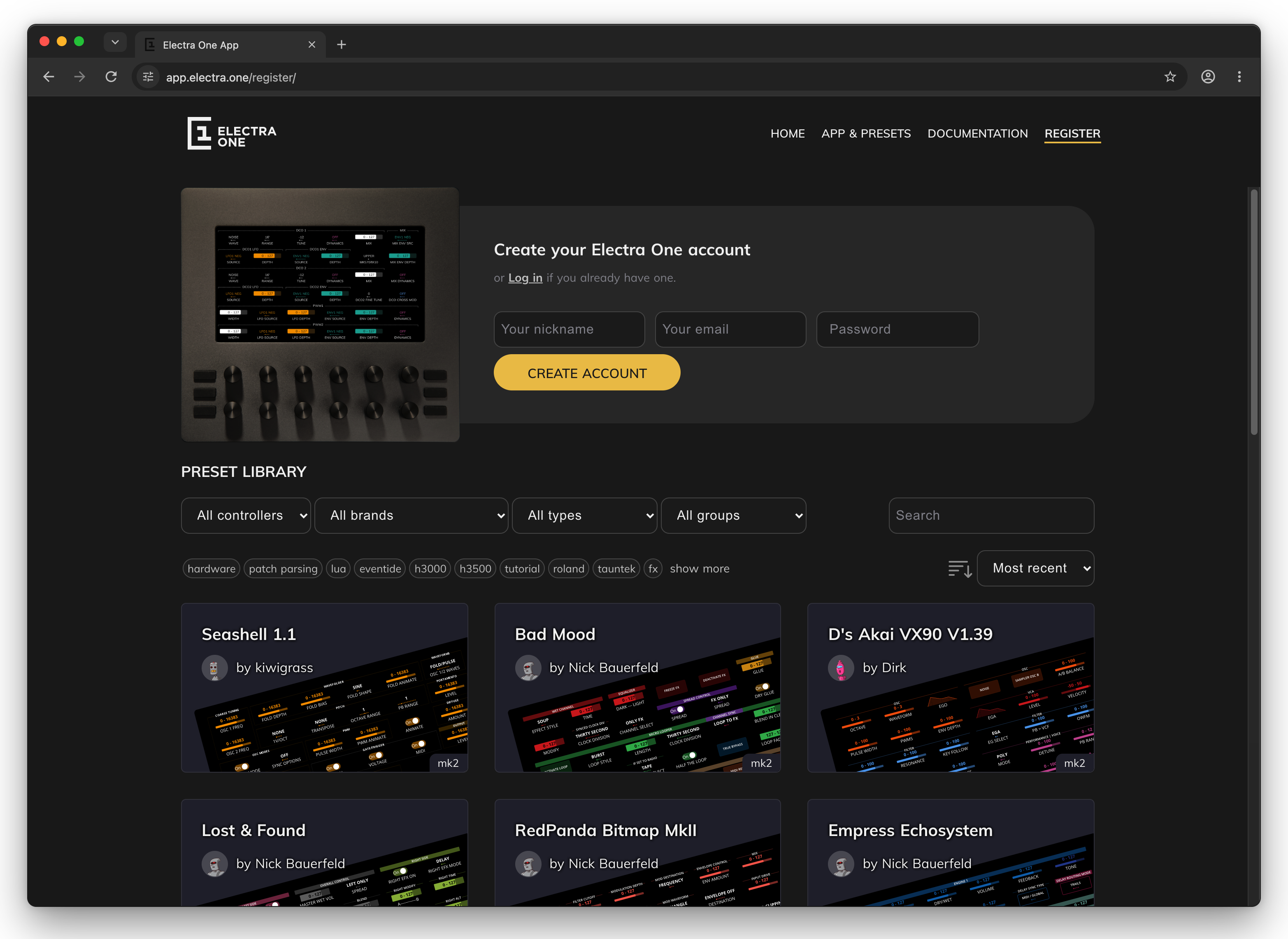

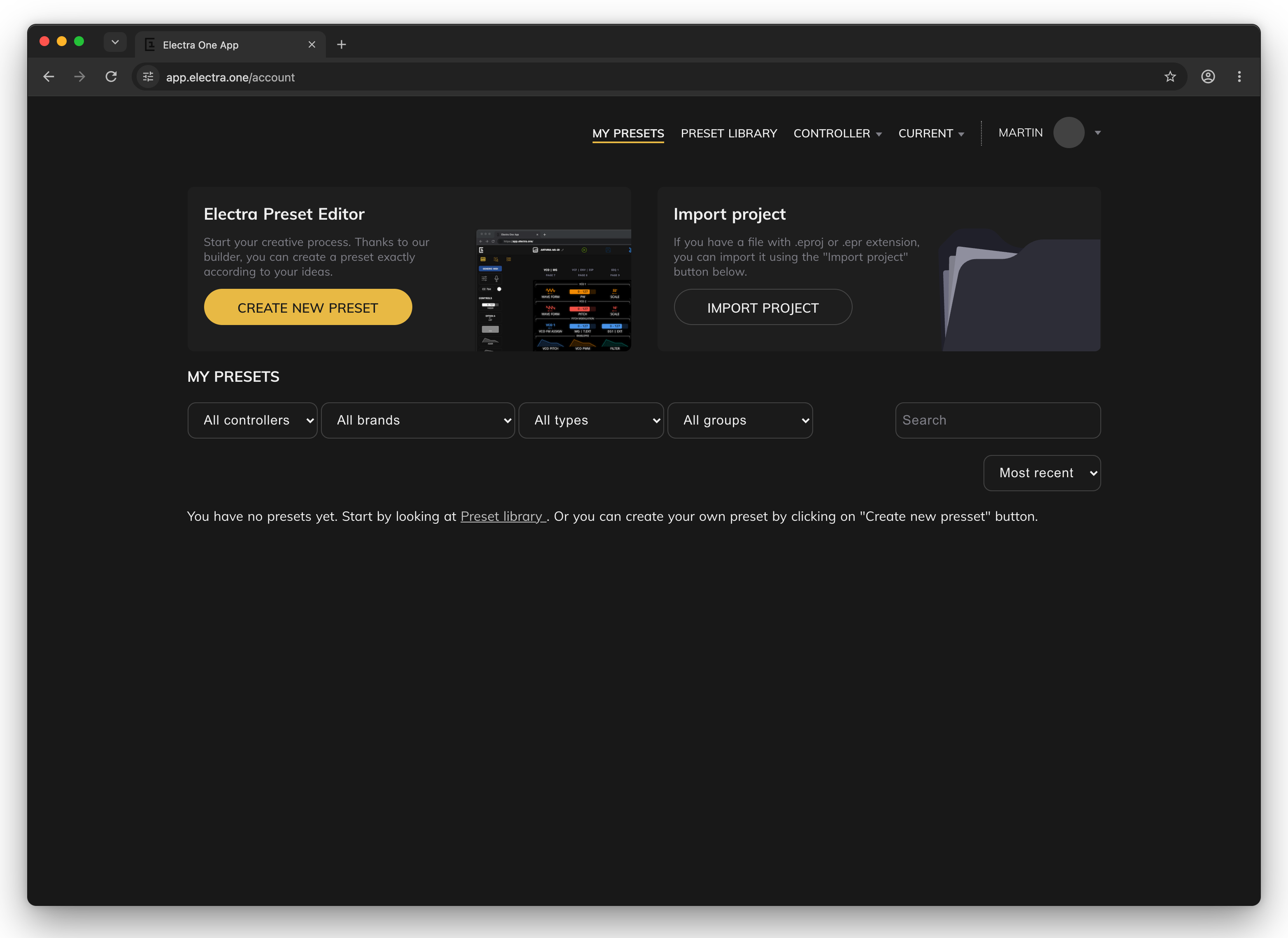

1. Create your Electra One account ​
Open Chrome or Edge and go to https://app.electra.one/register. Enter a nickname, your email and a password, and click CREATE ACCOUNT. If you already have an account, click Log in instead. The account gives you access to the Library of shared presets and to the Preset Editor.

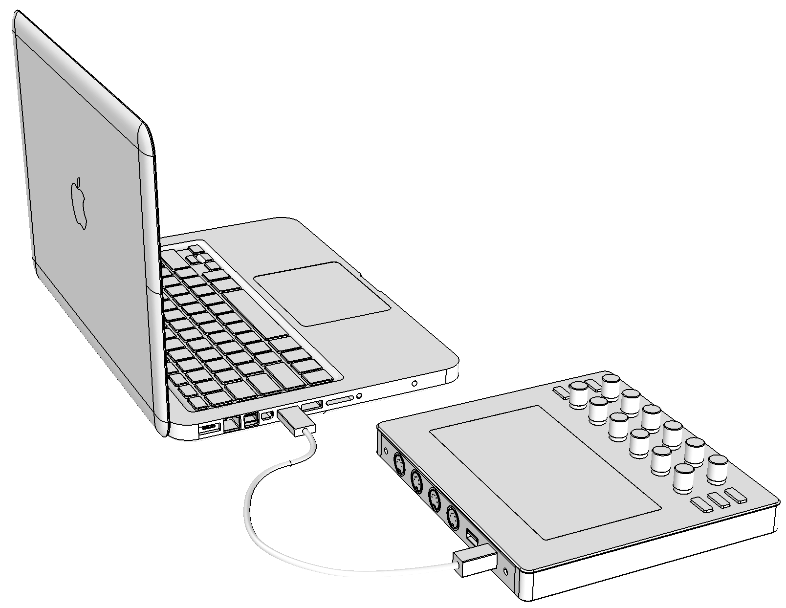

2. Connect your Electra One controller to your computer ​
Once you are signed in, use the included USB cable to connect the <USB DEVICE> port of your Electra One to a USB port on your computer.
Electra One connected to a computerElectra One connected to a computer

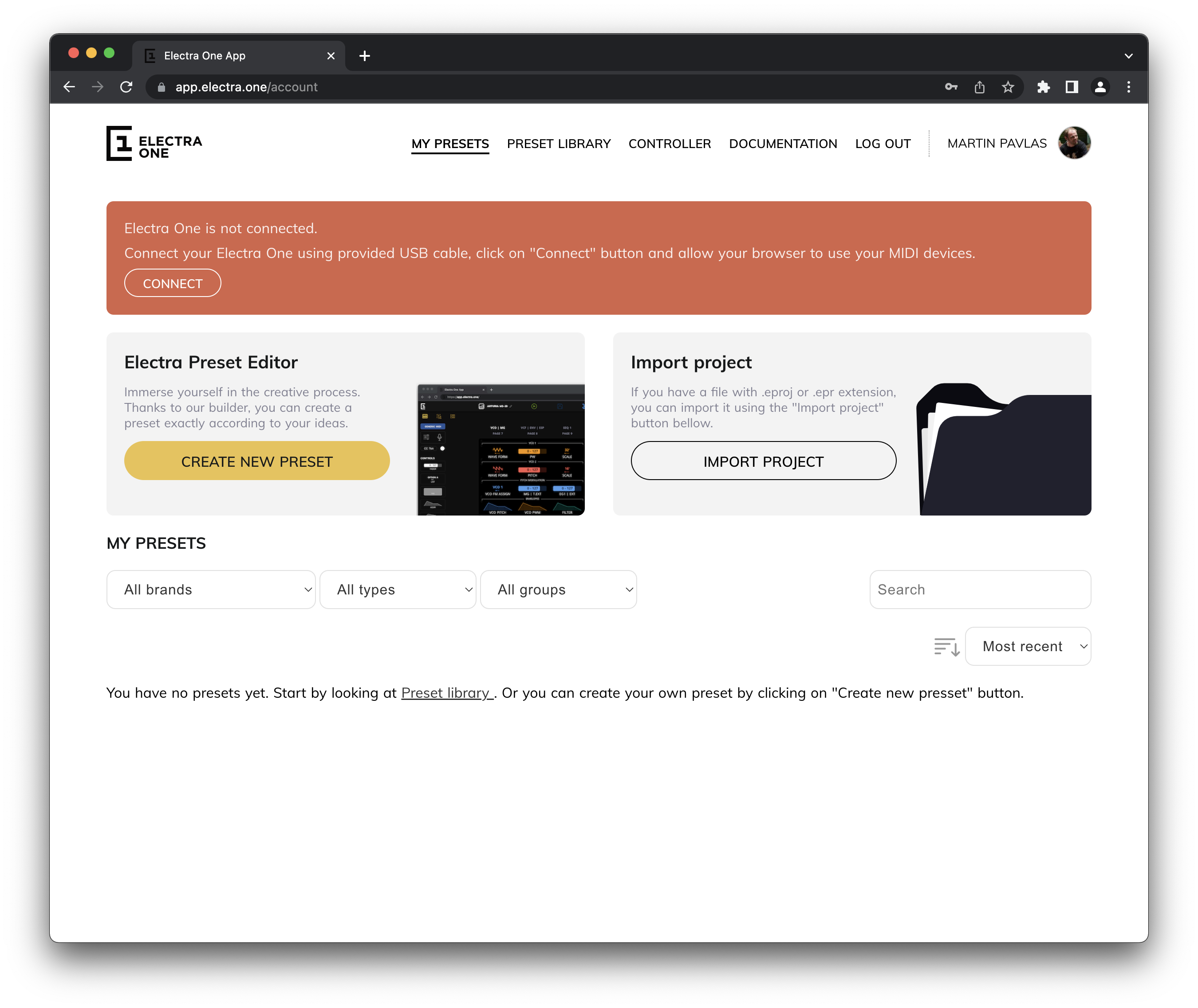

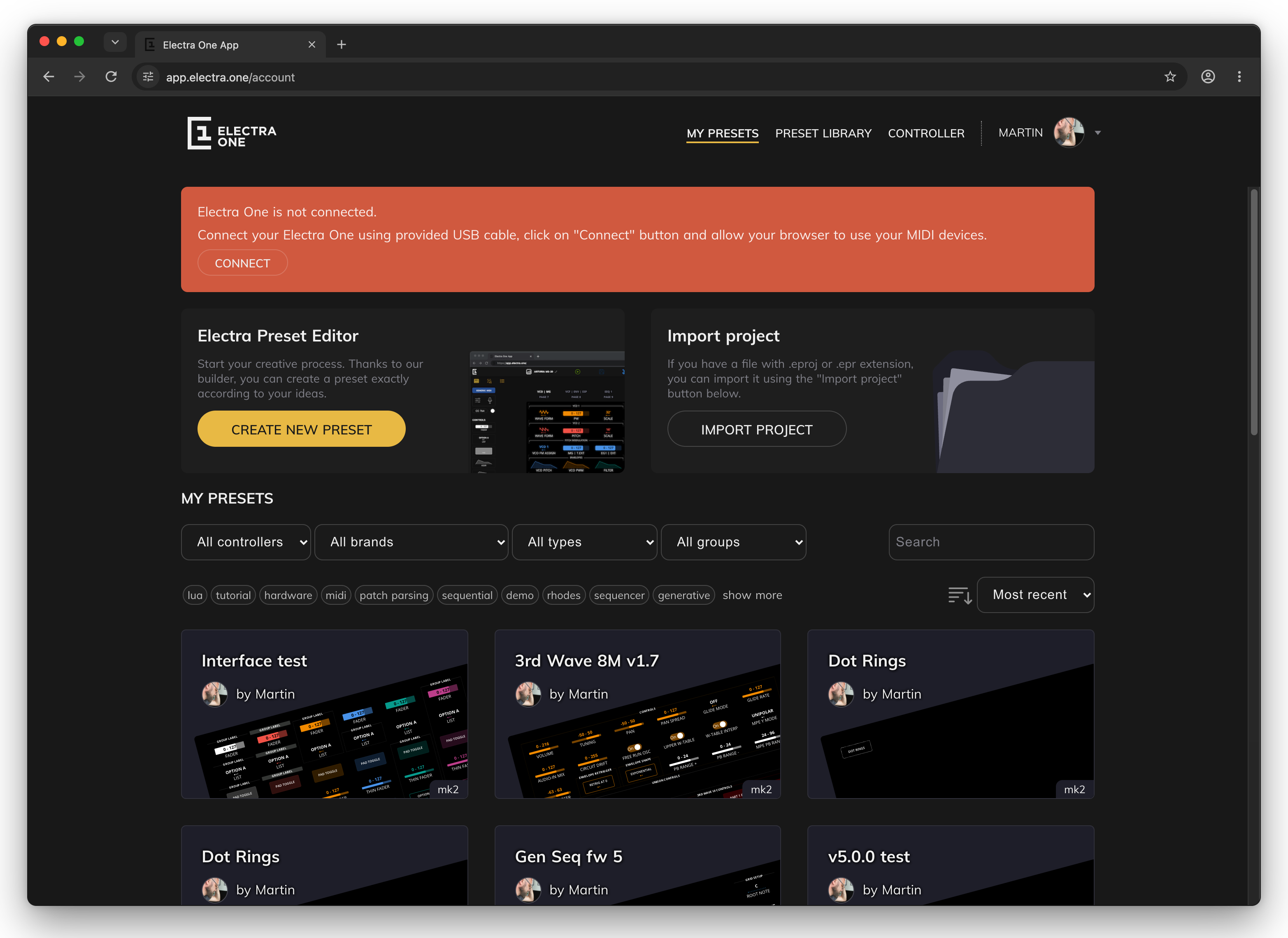

3. Connect the controller to the web application ​
The first time you open the application, your WORKSPACE is empty and shows a red banner saying that Electra One is not connected. Click its CONNECT button.

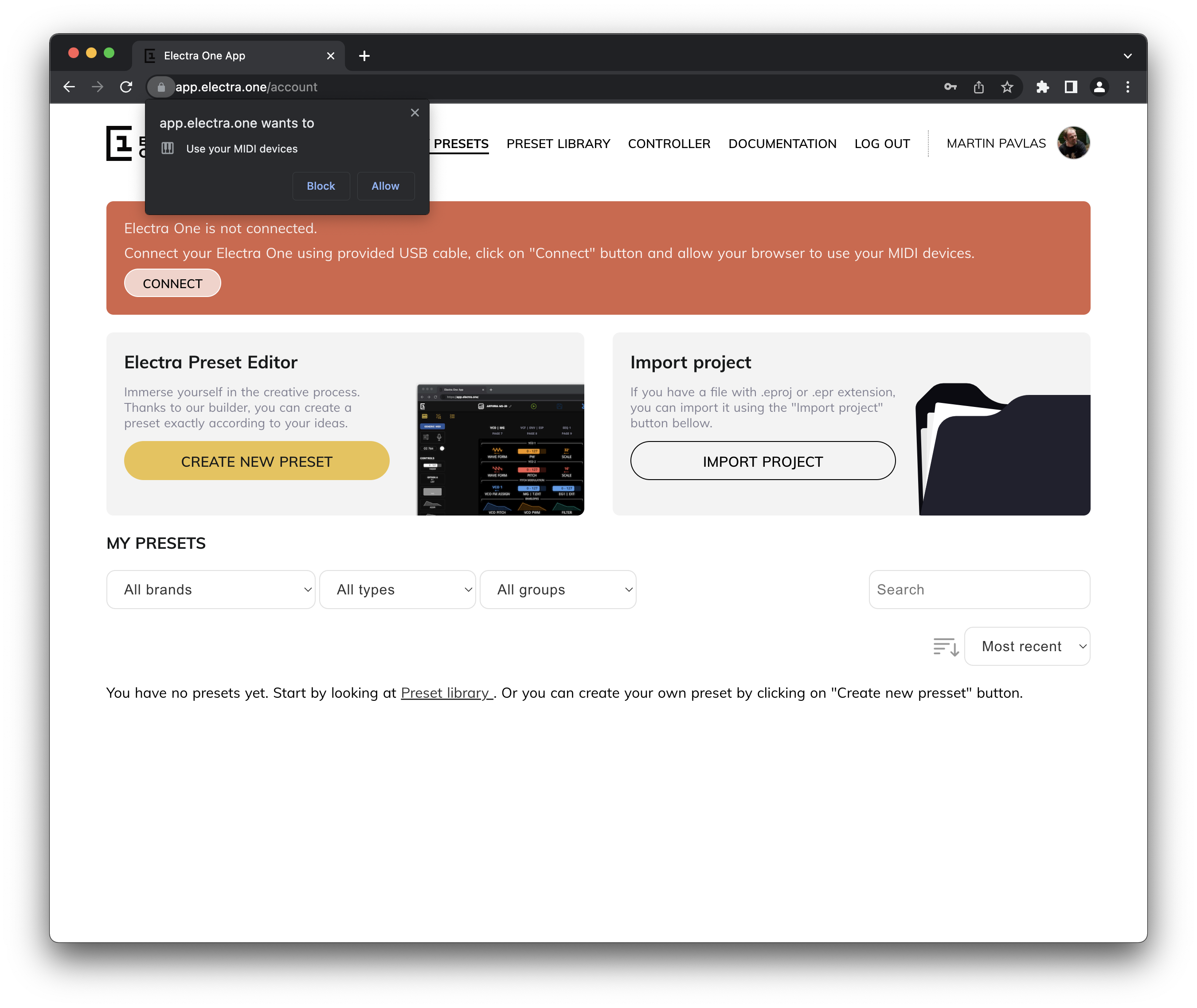

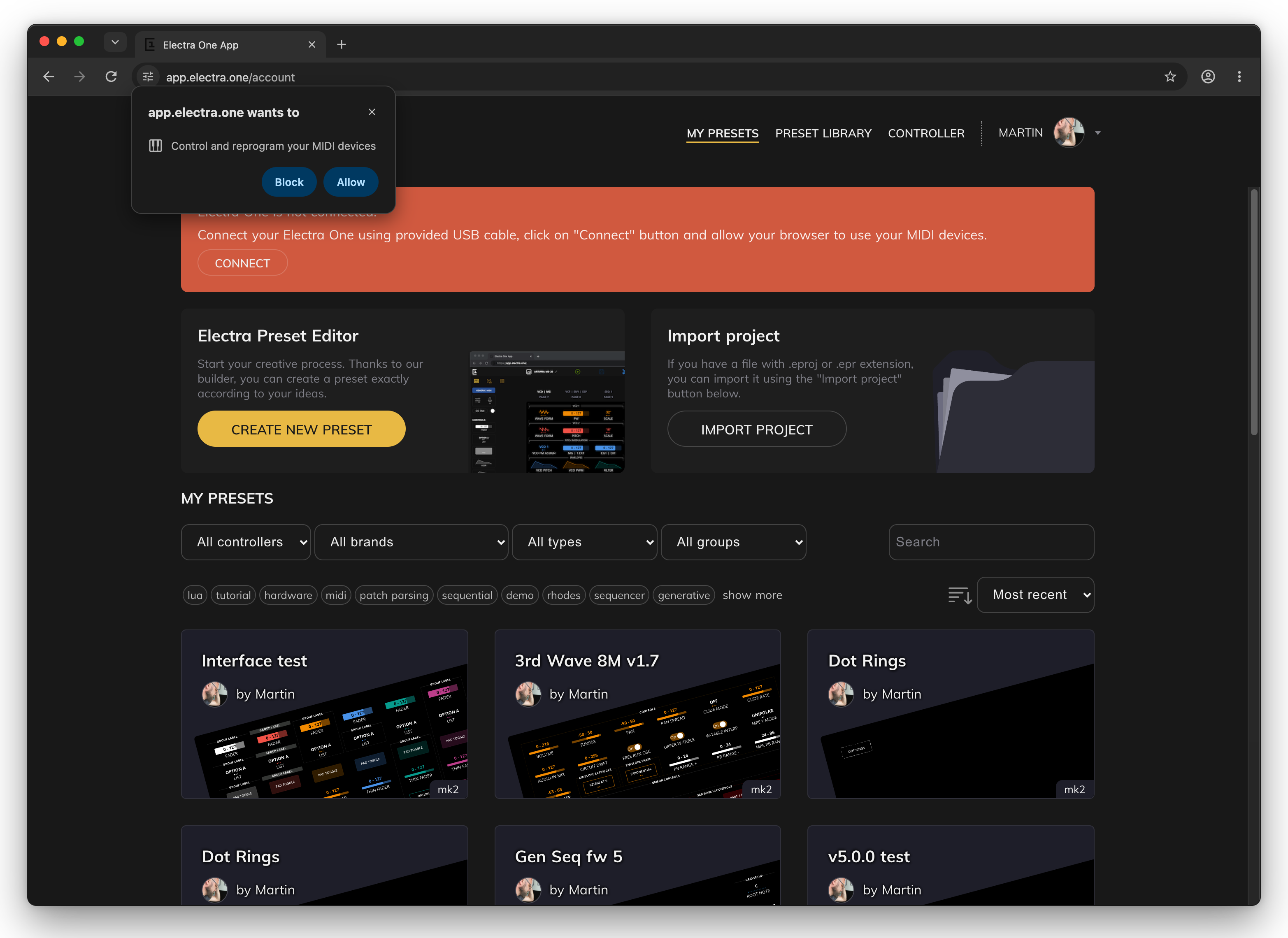

4. Allow access to MIDI devices ​
The browser asks whether the site may control and reprogram your MIDI devices. Click Allow. The application talks to Electra One with MIDI System Exclusive messages, and without this permission it cannot reach the controller at all.
Allow the use of MIDI devices
If you clicked Block by mistake, the banner changes to ask for the permission again. Click its ENABLE MIDI button, or allow MIDI devices for the site in the browser's site settings (the icon at the left of the address bar), and reload the page.

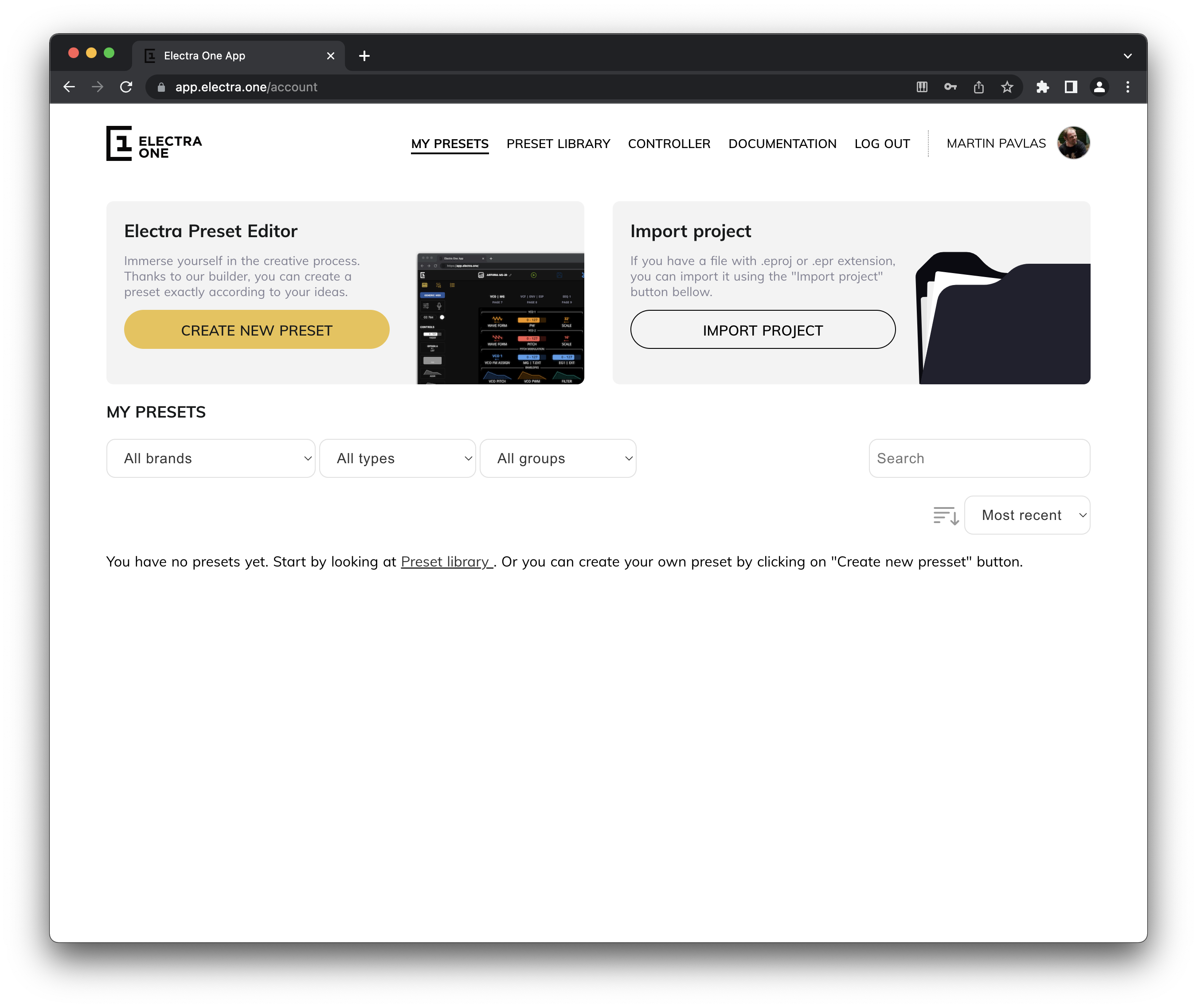

5. Your Electra is connected ​
When the controller answers, the red banner disappears and the top menu gains CURRENT, with CONTROLLER next to it. From now on the application finds your Electra One by itself whenever it is connected to the computer. Your controller is also linked to your personal account.
If a grey banner says that your Electra One is not connected, check the USB cable and click SCAN ALL MIDI PORTS. If the controller still cannot be found, see The Connection Troubleshooting Guide.

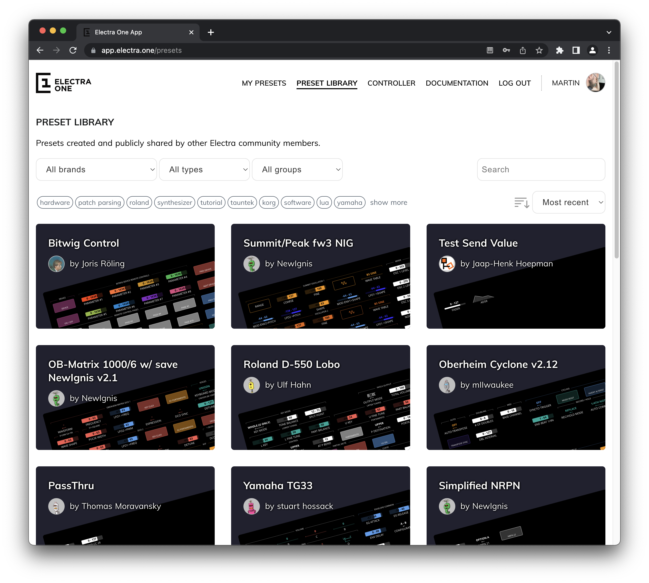

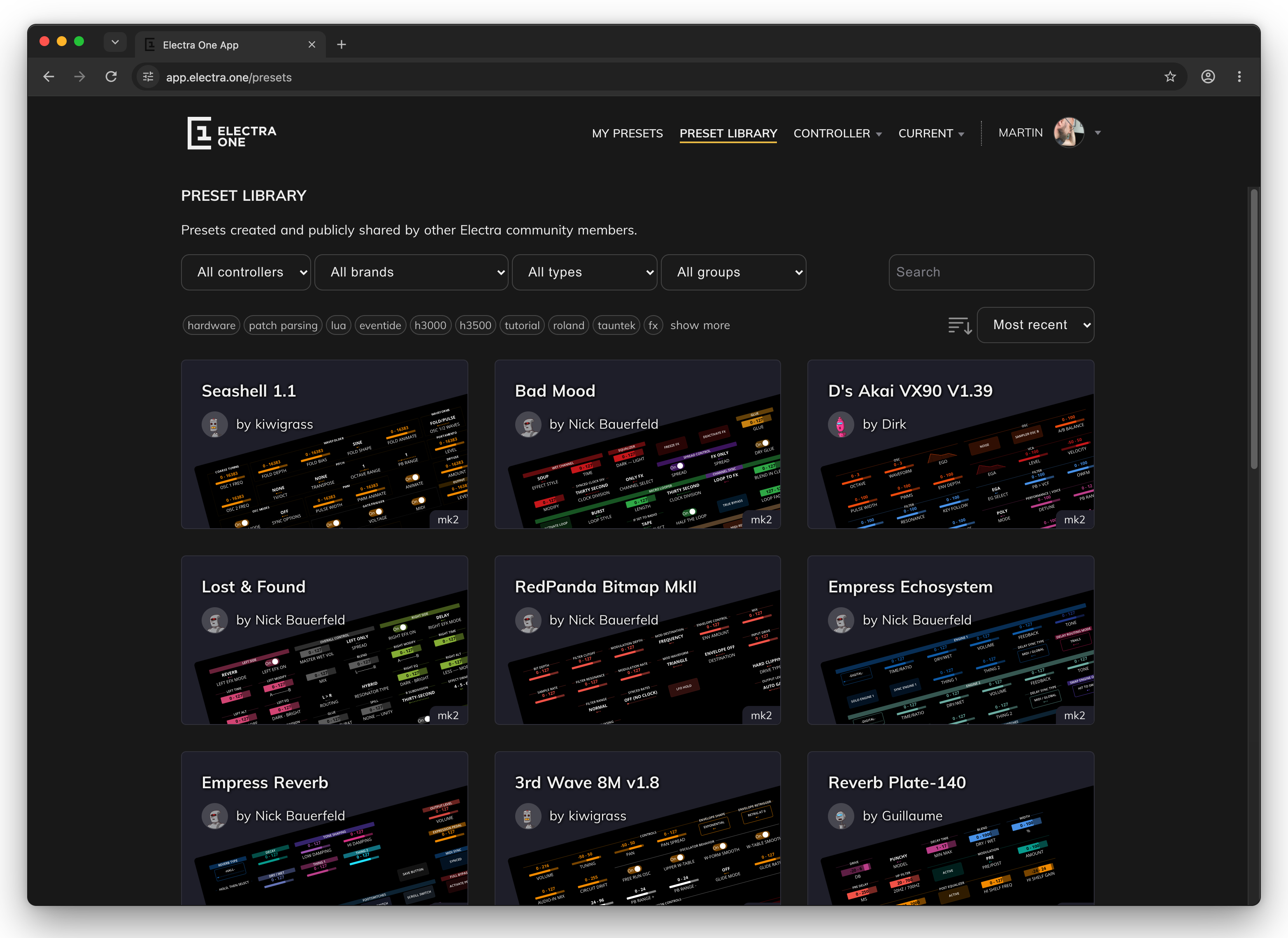

6. Go to the Library ​
Click LIBRARY in the top menu and browse the presets shared by other Electra One users. The Library calls them projects. Type in the search box, click a tag, or click the funnel icon to show only the presets for your controller, Regular for the Mk2 or Mini. Choose a preset you'd like to try.
Go to the Library

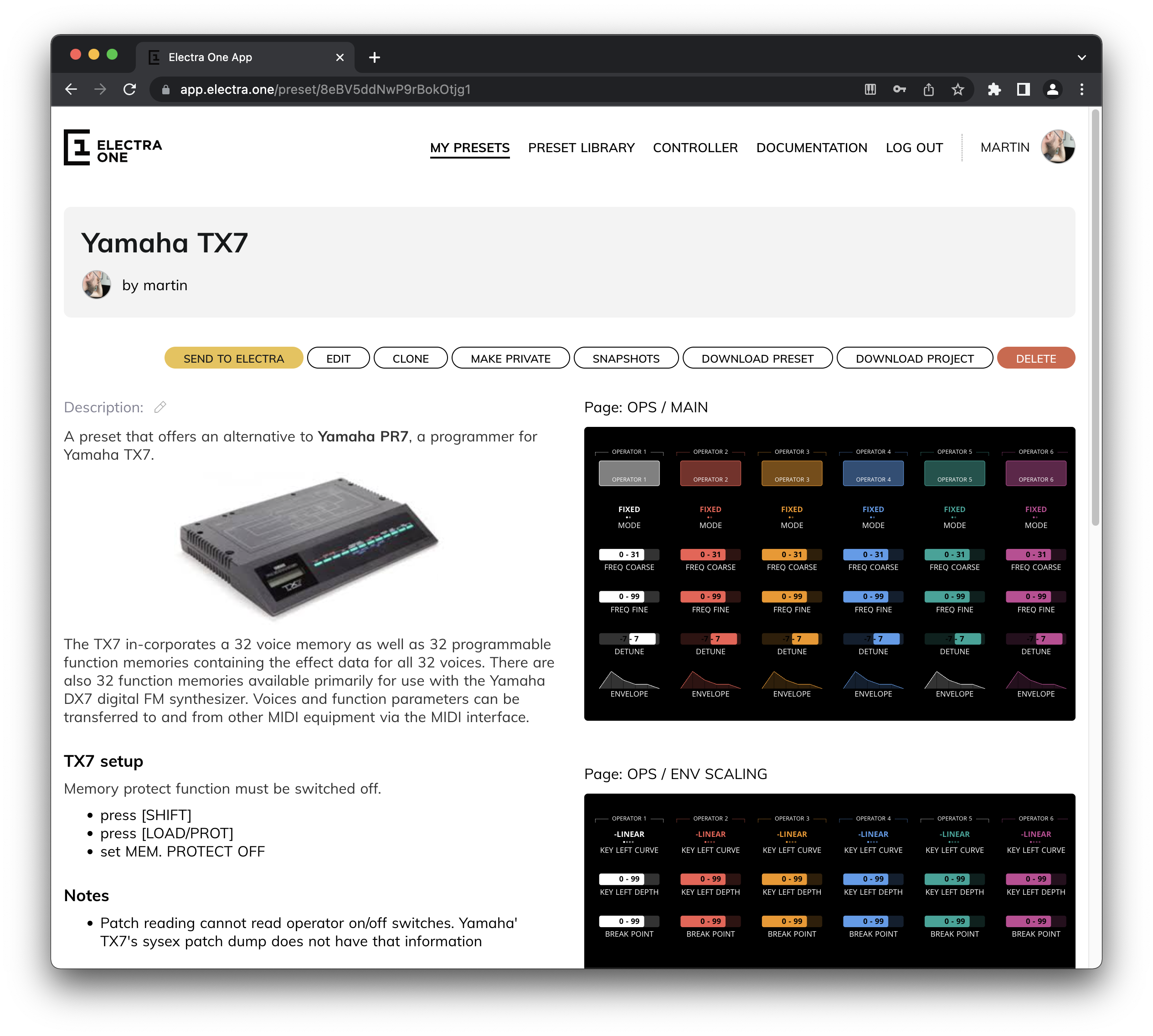

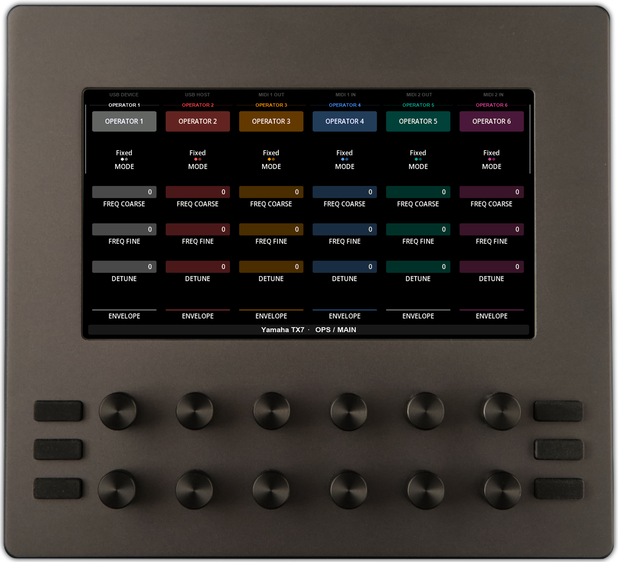

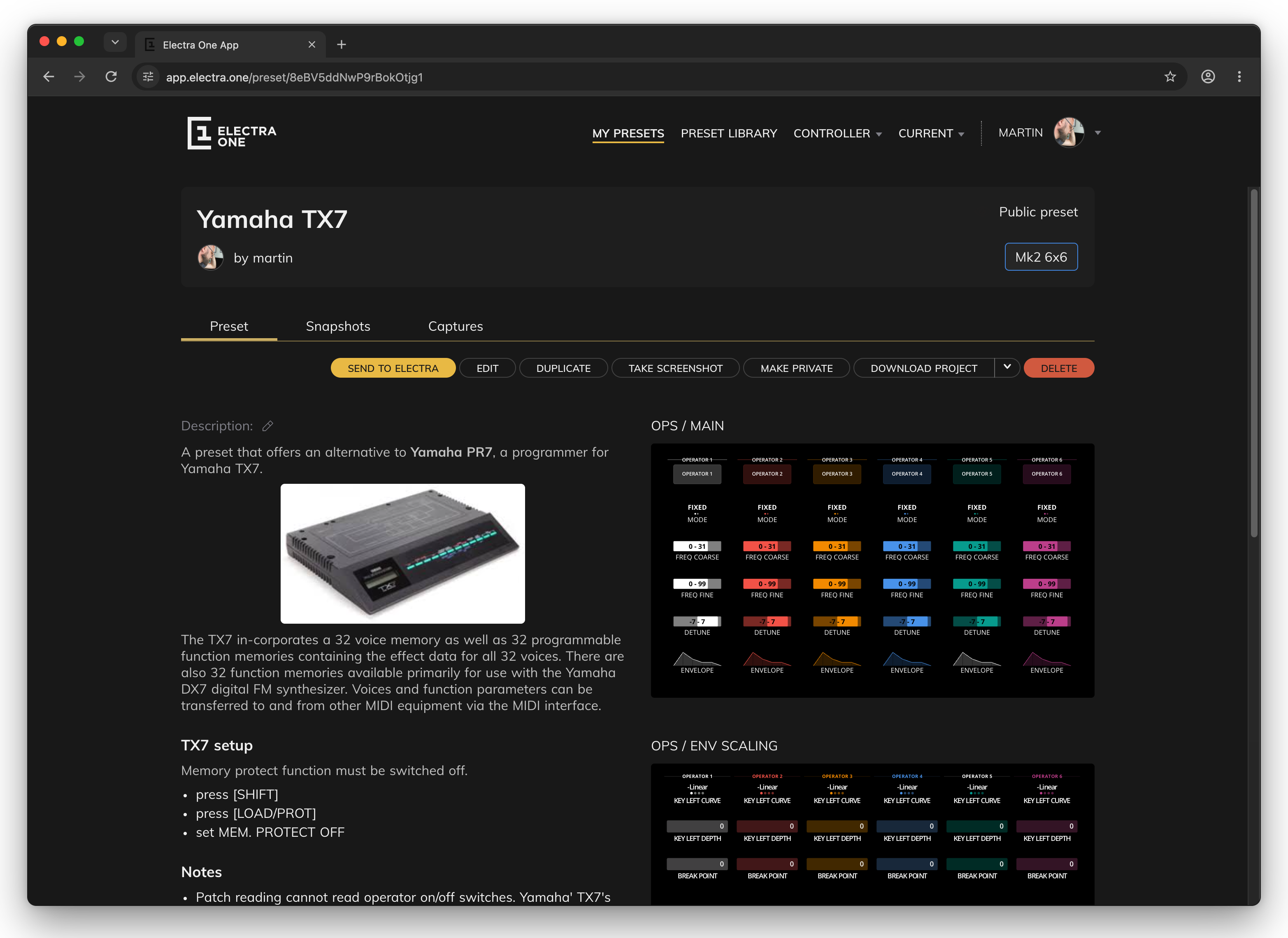

7. Send the preset to your Electra One ​
On the Project tab of the preset's page, click SEND TO ELECTRA. The preset is sent to the preset slot that is currently selected on your Electra One and replaces whatever that slot held before. It is loaded straight away and ready to use.
The preset loaded on Electra One
When you turn the knobs on your Electra One, or touch the screen of an Electra One Mk2, the controller sends MIDI messages according to the preset you have loaded.
