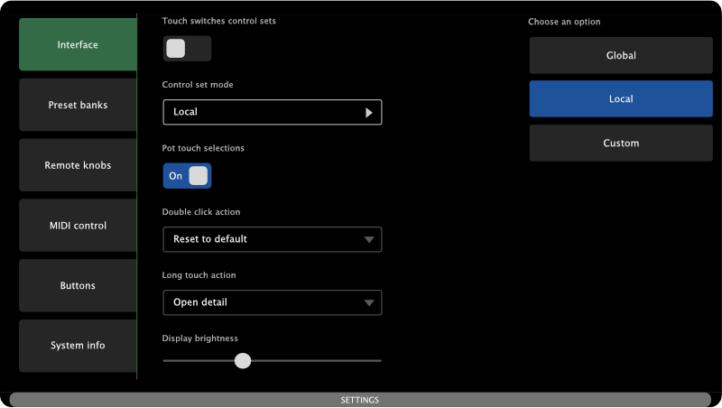

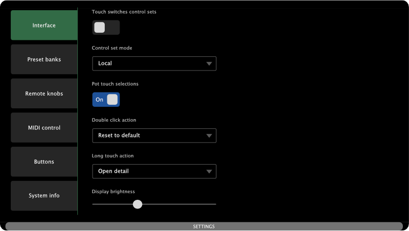

Interface
The Interface tab allows you to configure how you interact with the Electra One controller. These settings control how touch, knob actions, and display behavior are interpreted, enabling you to tailor the experience to your preferences.
The tab includes the following options:
Touch Switches Control Sets
When enabled, touching the screen will automatically switch to the corresponding active control set. When disabled, you’ll need to use hardware buttons (configured accordingly) to switch between control sets.
Control Set Mode
Defines how control sets are handled:
- Global – The active control set is shared across all preset pages. Changing the page does not change the control set.
- Local – Each preset page remembers its own active control set. When you return to a page, it restores the control set that was active when you last left it.
- Custom – Each preset page uses a default control set, as defined in the preset. If no default is specified, the first control set is selected when switching to that page.
Pot Touch Selections
When enabled, pot (knob) touch can be used to make selections on pages such as Preset Selection, Page Selection, Snapshot Bank Selection, and others. When disabled, selections must be made using the touchscreen only.
Double Click Action
Defines what happens when you double-tap a control on the touchscreen:
- None – No action is triggered.
- Reset to default – Resets the control’s current value to its default setting.
- Open detail – Opens the detail window for the selected control.
Long Touch Action
Defines what happens when you touch and hold a control on the touchscreen. The available actions are the same as for the double-tap gesture:
Display Brightness
Adjusts the screen brightness to suit different lighting conditions. This setting helps reduce eye strain and power consumption, especially in low-light or on-stage environments.
If your USB host (e.g. a MIDI router) does not supply enough power for the Electra One, lowering the backlight brightness can help reduce the controller’s power requirements.

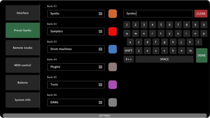

Preset Banks
Electra One provides six preset banks for organizing and accessing your presets. Each bank can be customized to help you organize the color-coding to your needs.
For each bank you can set:
- Name – You can assign a custom name to each bank using the on-screen keyboard. This helps identify the purpose or contents of each bank at a glance. To open the on-screen keyboard, tap on the Bank name text field.
- Color – A color can be selected from a set of predefined options, making it easier to visually distinguish between banks. To change the color, tap on the color button next to the Bank name text field.

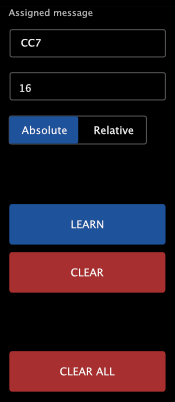

The sidebar on the right displays information and options for the currently selected slot, including:
- The CC message number
- The CC message type (absolute or relative)
- A button to re-learn the MIDI message
- A button to clear the mapping and to clear all mappings

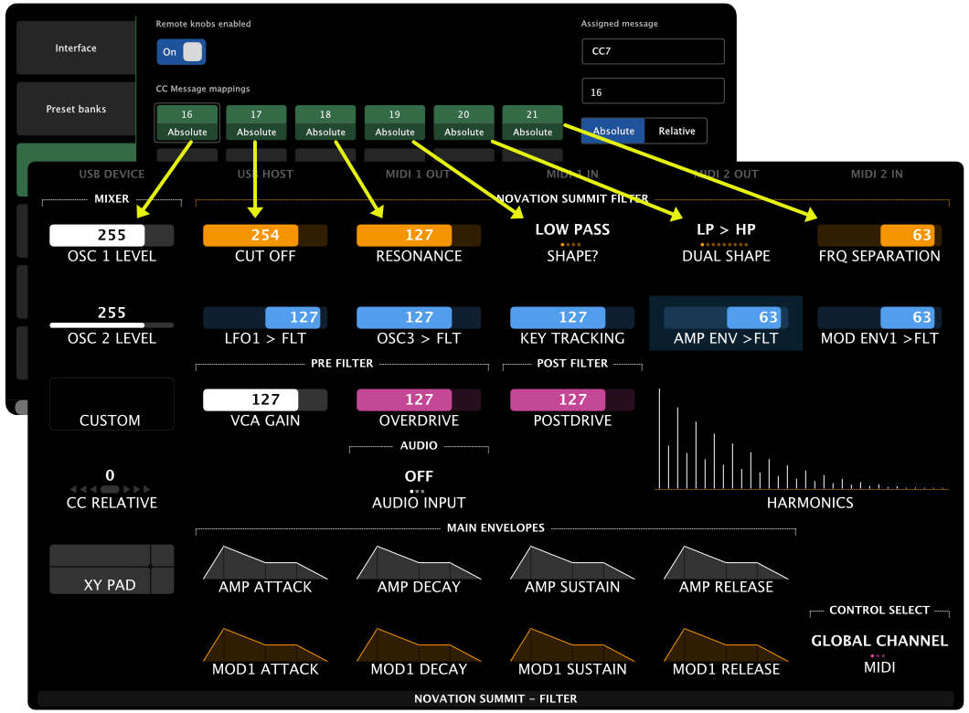

An example of mappings:
The image above shows CC #16 assigned to control the first slot of the preset page, CC #17 assigned to the second slot, and so on.

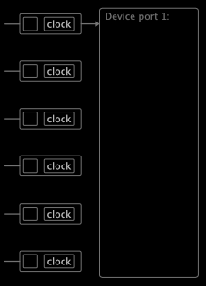

To assist with setup and troubleshooting, the screen also includes:
- MIDI activity indicators
- A MIDI log window
These tools display incoming MIDI data in real time. See the Router section of this manual for more details on how they work.

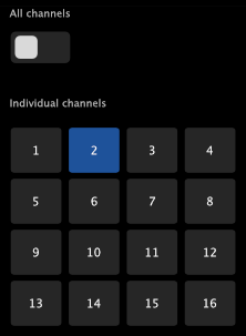

A sidebar on the right lets you configure which MIDI channels are used for each selected input. When you select a row, its checkbox is highlighted with a light gray outline, and the sidebar displays the channel settings for that input.
You can choose to listen on:
- All MIDI channels, or
- One or more specific channels
This gives you precise control over which connected devices or software sources can send Remote Knobs data to Electra One.

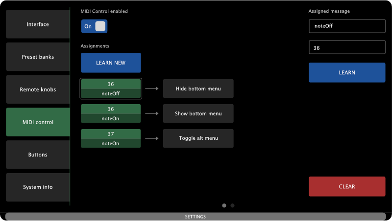

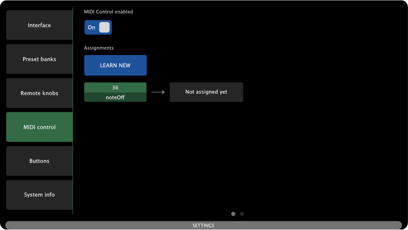

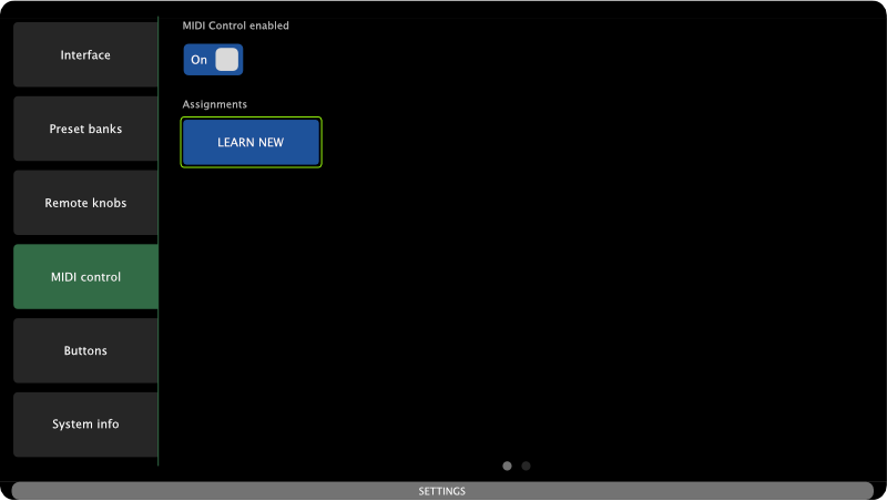

This screen allows you to create MIDI control assignments using MIDI Learn.
To create a new assignment, tap the [LEARN NEW] button. It will be highlighted with a yellow outline, indicating that the controller is now waiting for a MIDI message to learn. If you want to cancel the process, simply tap the button again to disarm it.
When MIDI Learn is armed, press a pad, turn a knob on a connected MIDI controller, or send a MIDI message to Electra One. The controller will capture the first valid MIDI message it receives and create a new assignment based on it.
The image above shows Note On #36 as the learned MIDI message. It currently has no Electra One command or action assigned, which is indicated by the Not assigned yet box.

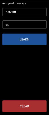

To assign a command, tap the Not assigned yet box. It will be highlighted with a light gray outline, and a swipeable list of available commands will appear in the right sidebar. Swipe through the list and tap the command you want to assign to the previously learned MIDI message.
To change the MIDI message of an existing assignment, tap the MIDI message you wish to change. It will be highlighted with a light gray outline, and detailed information about the message will appear in the right sidebar.
In the sidebar, you’ll find a [LEARN] button. Tap this button to arm the learning mode and assign a new MIDI message, which will replace the existing one. To remove the assignment, tap the [CLEAR] button.

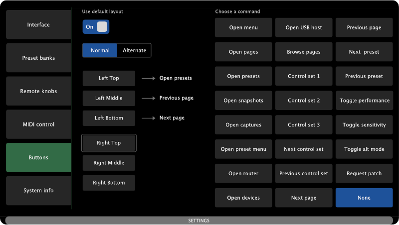

Buttons
The Buttons settings screen allows you to customize the commands and actions assigned to Electra One’s hardware buttons. The available commands are nearly identical to those used in the MIDI Control feature, providing consistent control options across both systems.
For the physical layout of the hardware buttons, refer to the First steps section.
Default Layout
A global switch lets you enable or disable the default layout (the factory-defined set of button assignments).
When the default layout is enabled, your custom button configuration is temporarily ignored, but not deleted. Disabling the default layout will restore your custom assignments without the need to reconfigure anything. This makes it easy to switch between factory and user-defined setups as needed.
Modes
To expand the number of assignable functions, Electra One supports two button modes:
- Normal Mode – The default set of button assignments.
- Alternate Mode (Alt Mode) – A secondary set of button assignments, activated by triggering the
Toggle Alt Modecommand. To use it, you must assign theToggle Alt Modecommand to either a hardware button or a MIDI Control assignment. This allows each hardware button to perform two different actions, depending on the current mode.
To switch between the two modes use the mode switch:
Button Assignments
The screen displays a column of six buttons, arranged in two groups of three, representing the physical hardware buttons on the controller and their assigned commands.
To change a button’s assignment, tap on the desired button. It will be highlighted with a light gray outline, and a list of available commands will appear. Simply tap the command you want to assign to that button.
