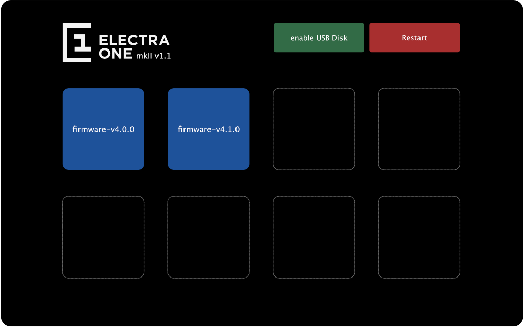

6. Restart the controller
7. Start the bootloader again
The bootloader will start, and firmware-v4.1.2 will appear in the list of available firmware images:
Firmware uploaded
8. Apply the update
Tap the blue tile labeled firmware-v4.1.2 to begin the update process.
