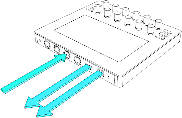

MIDI messages generated with external gear or software can be received on all Electra's interfaces, ie. <MIDI IO>, <USB DEVICE>, and <USB HOST>.
Electra in
If the configuration of a Control matches the incoming MIDI message information about the port and channel (defined by the device configuration), the MIDI message will affect the value of the Control and you will get visual feedback on the display.
In other words, Electra monitors all incoming MIDI messages on all interfaces, if the preset consists of a Control listening to that given message, you will be able to see it.

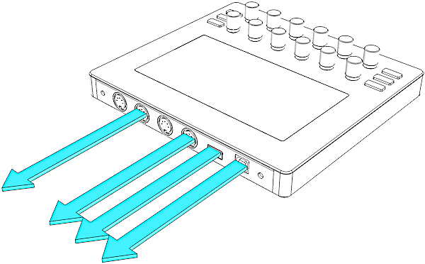

Electra Out ​

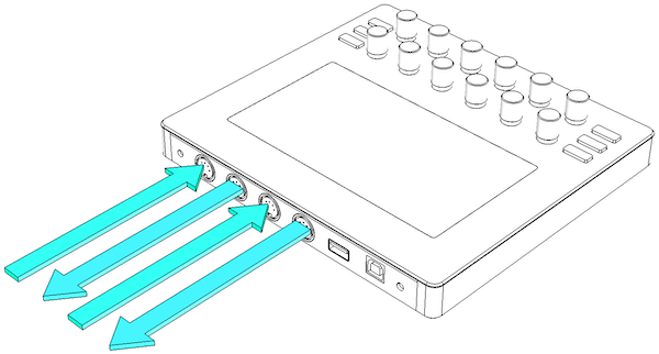

MIDI message created by twisting Electra's knobs and using the display touch is sent to all Electra's interfaces, ie. <MIDI IO>, <USB DEVICE>, and <USB HOST>.
Electra out
A control is always assigned to a particular device, which in turn represents a port and channel. When you twist a knob and it affects the value, a MIDI message is generated and send out to all interfaces.
In other words, twisting a knob will cause the same MIDI message to be sent out on the same port and channel of <MIDI IO>, <USB DEVICE>, and <USB HOST> interfaces.

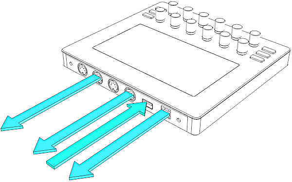

A MIDI messages received from a computer over the USB cable, ie. received on the <USB DEVICE> interface.
USB device IN
Inbound <USB DEVICE> MIDI message received on port 1, will be automatically forwarded to port 1 of <USB HOST> interface and <MIDI 1 OUT> port. Of course, if the MIDI message matches a configuration of any Control within a preset, the value of that Control will be updated and shown.

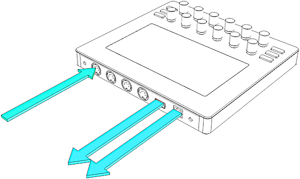

A MIDI message received from external MIDI gear connected to <MIDI 1 IN> or <MIDI 2 IN> will be forwarded to a corresponding port of <USB DEVICE> and <USB HOST> interface.
MIDI IO 2 IN
All messages received on <MIDI 1 IN> port will be forwarded to <USB HOST> port 1 and <USB DEVICE> port 1.
MIDI IO 2 IN
All messages received on <MIDI 2 IN> port will be forwarded to <USB HOST> port 2 and <USB DEVICE> port 2.

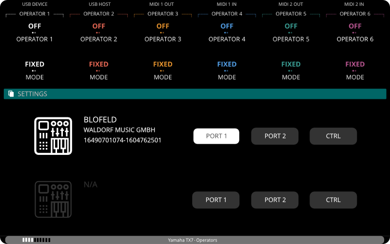

USB Host port assignments ​
The USB host interface is a bit different from the USB device and MIDI IO interfaces. USB host does not have hard-wired port assignments. The default Electra configuration assigns devices to ports in the order as they are connected. The device you connect first will be assigned to port 1, the device connected as second will be assigned to port 2.
USB host selection
This might not be appropriate in all situations. The USB Host configuration page gives you an option to change the port assignments. These assignments will be, however, lost, when you turn Electra off.
Should you require a permanent assignment of devices, a custom Electra configuration must be uploaded to your Electra.

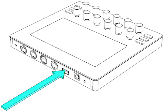

USB Host input ​

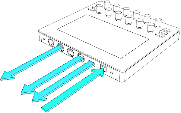

A MIDI Message received from a device connected to the <USB HOST> port will be forwarded to <USB DEVICE> interface and <MIDI IO> interface, keeping the information about the port.
USB host IN

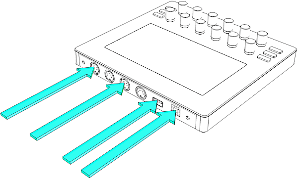

MIDI IO thru ​
When MIDI IO thru is enabled for port 1, all messages received on <MIDI 1 IN> port are forwarded and sent out on <MIDI 1 OUT> port. The same applies for port 2.
