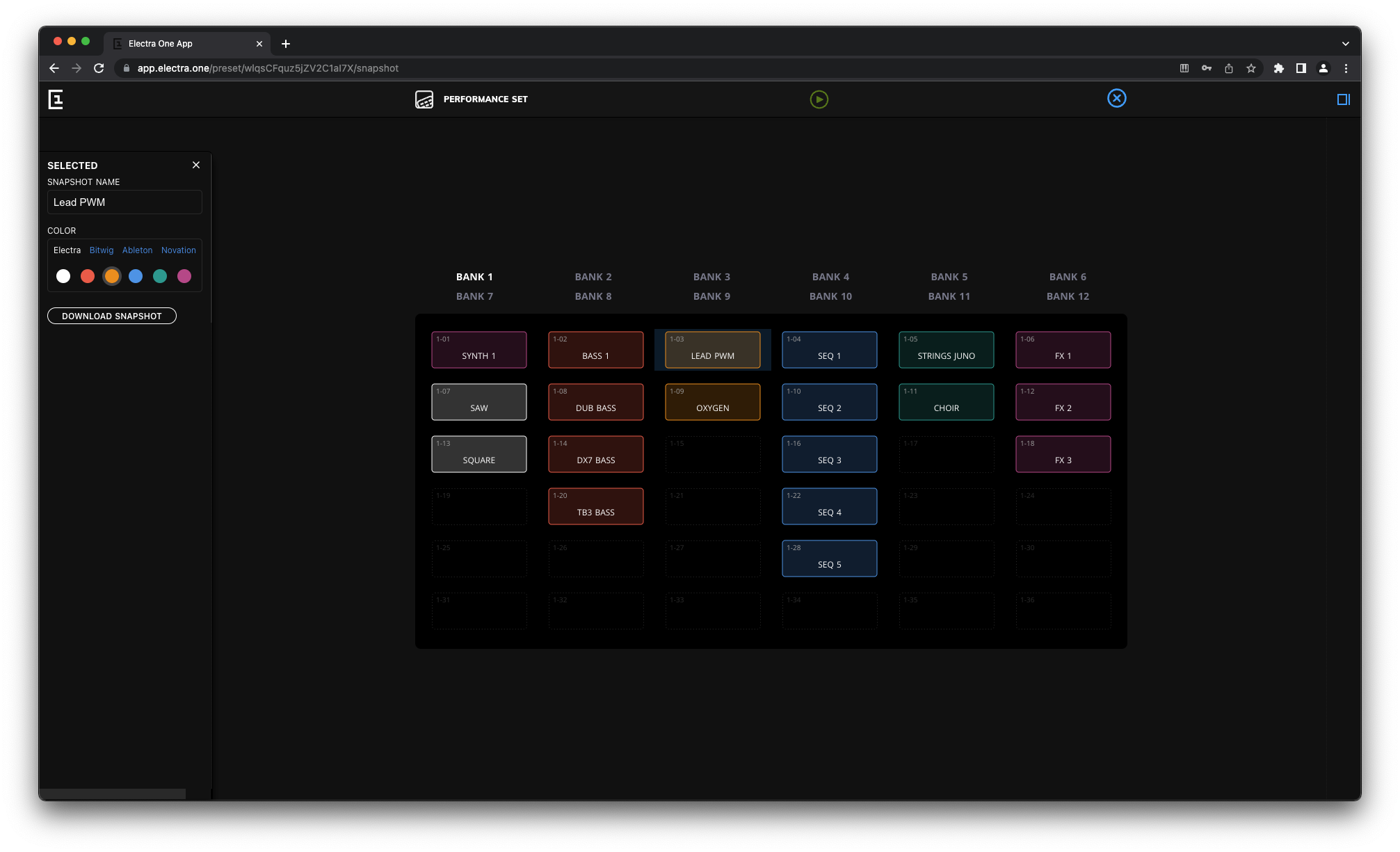

The Snapshots editor can be opened by clicking the SNAPSHOTS button on the preset detail. The editor always loads all the snapshot data from the Electra One controller. That means, the controller must be connected to the computer when you want to edit the snapshots.
Editor overview
The editor window consists of two sections:
  1. Grid
  2. Sidebar panel
The grid ​
The grid is a representation of Electra One display in the Snapshot editor. Saved snapshots are displayed there in the same way as you see them on the hardware controller.
The grid allows you to:
  • select the snapshots
  • move snapshots around to new locations
  • remove the snapshots
The list of snapshot banks is located above the grid. Snapshot banks can be switched by clicking the bank name.
Snapshots are moved to new location on the grid by dragging them with a mouse. Cut and paste can be used too.
The sidebar panel ​
The sidebar panel shows information about currently selected slot. When the slot contains a save snapshot, a snapshot detail is shown. It allows users to modify name and colour of the snapshot. There is the donwload button to save the snapshot to a file.
Sidebar
For empty slots, an option to import a snapshot from a file is provided. The imported snapshot is stored in currently selected slot location.
