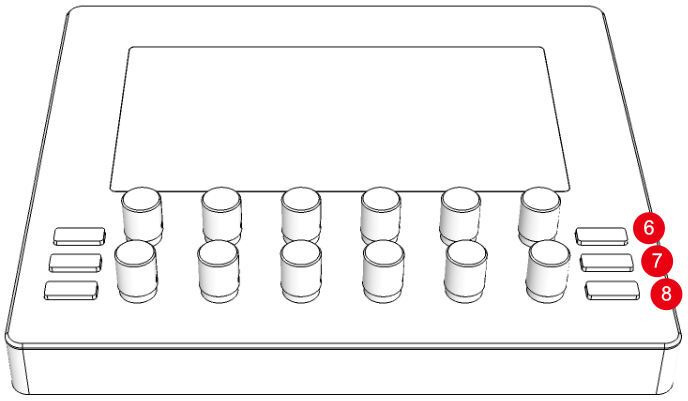

Right side buttons ​
Right side buttons provide access to presets, preset pages, snapshots, configuration, and to request patches.
Right side buttons
  • Button 6, referred to as [PATCH REQUEST]
  • Button 7, referred to as [SNAPSHOTS]
  • Button 8, referred to as [MENU]

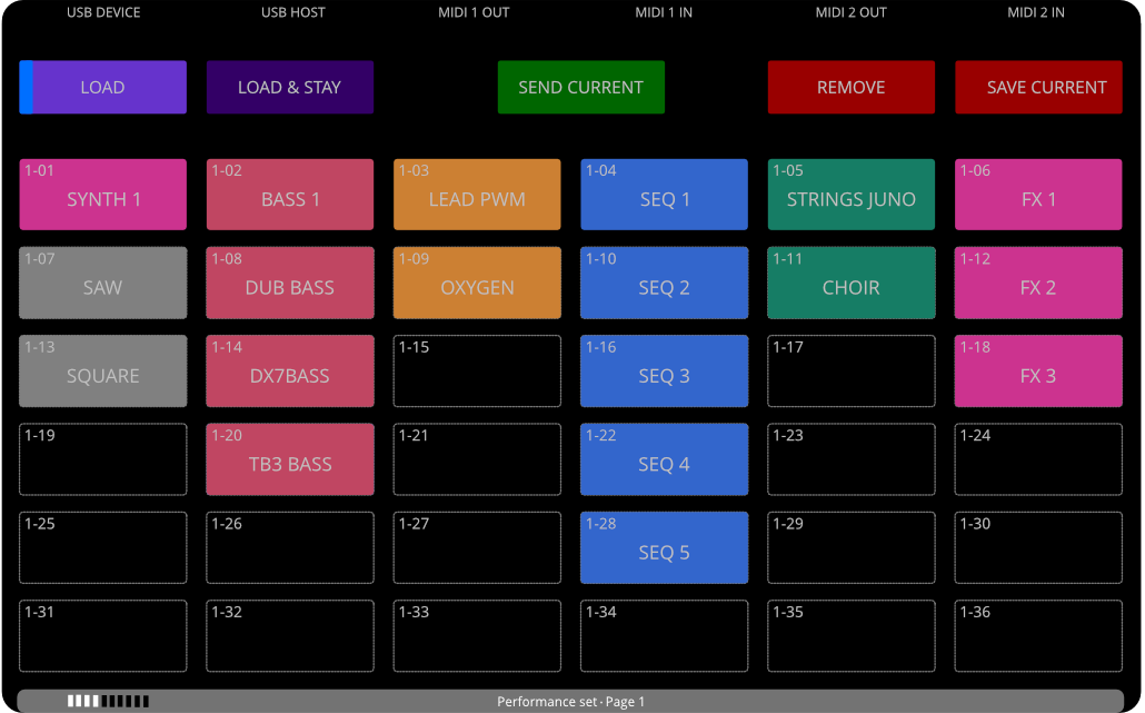

Snapshots ​
Pressing the [SNAPSHOTS] button will open the Snapshots window. Snapshots are saved sets of preset Control values. The Snapshots window can be closed by pressing the [SNAPSHOTS] again.

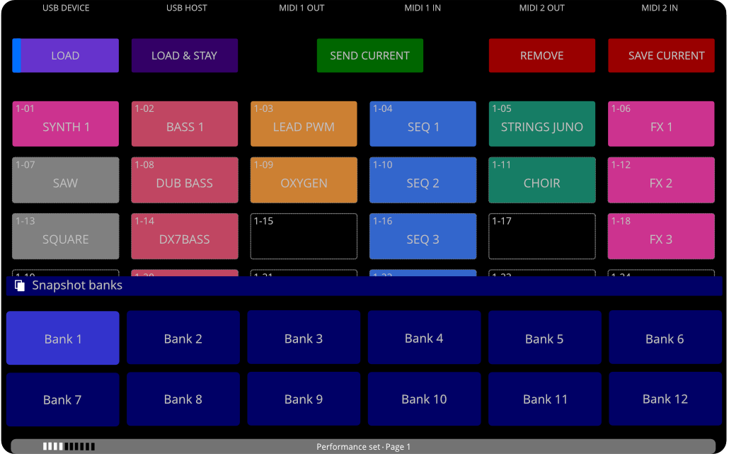

There are 12 banks, each having 36 snapshot slots. Current snapshot bank can be changed by pressing and holding the [MENU]. The knob touch or tapping the Bank button on the screen can be used to switch the snapshot banks. The snapshots bank selection is shown as long as the [MENU] button is held pressed.
There are several buttons at the top of the Snapshots window. These are to manange the snapshots and send them out to the connected MIDI devices.
Load ​
Swicthes Electra One to the Load mode. Subsequent tap on any of the saved snapshots will will update the preset values, will send the values to connected devices, and eventually the Snapshots window will be closed.
Load & Stay ​
Swicthes Electra One to the Load & Stay mode. Subsequent taps on any of the saved snapshots will will update the preset values, will send the values to connected devices. On contrary to the Load, the Load & Stay does not close the Snapshots window. It means you can keep sending the snapshots as long as you keep the Snaphosts window open.
Send current ​
Sends all current preset values to the connected devices. No data is sent or modified.
Remove ​
Switches Electra One to the Delete mode. Subsequent taps on any of the saved snapshots will permanently remove them from the controller.
Save current ​
Switches Electra One to the Save mode. Subsequent taps on any of the saved snapshots will create a new snapshot at given location. When a used slot is chosen, the original saved snapshot will be overwriten.

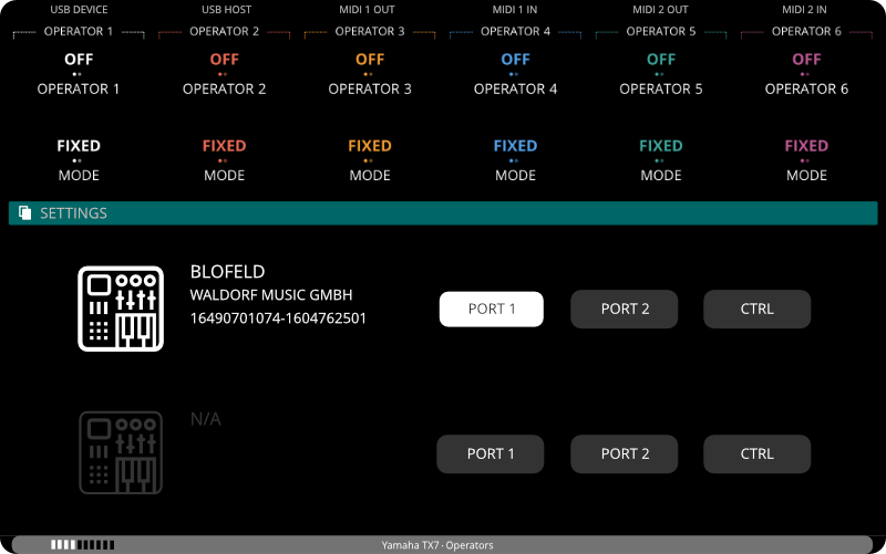

USB Host configuration ​
Electra features a <USB HOST> port to connect USB MIDI devices and Electra accessories. Although there is only one USB port, it is possible to connect a standard USB Hub to increase the number of USB ports.
Any USB MIDI device connected to Electra’s <USB HOST> port can be assigned to PORT 1, PORT 2, or CTRL.
To open the USB Host configuration window, press and hold the [MENU] and then press the right-top [PATCH REQUEST] button.
USB Host selection
If the USB device, for example, a master keyboard, is connected to PORT 1, the messages it sends will be forwarded to <USB DEVICE> port Electra Port 1 and <MIDI 1 OUT> port. Any MIDI message sent to either <USB DEVICE> port Electra Port 1 or <MIDI 1 IN> port will be automatically forwarded to the USB device connected to the <USB HOST> port 1. PORT 2 uses the same principle.
The CTRL port is used for Electra's external MIDI control. External control allows you to switch pages and presets by sending MIDI messages to Electra's <USB HOST> port.
