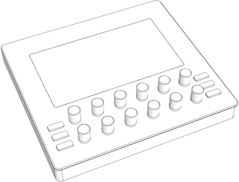

Front panel
The front panel is the place where you interact with Electra One. A large touch-sensitive LCD displays all the controls and allows you to modify their values with a touch. 12 touch-sensitive knobs are assigned to on-screen controls and allow you to change values as well. The rubber buttons are here to navigate within Electra's pages, presets, sections, and windows.
Electra front panel
  1. Touch-sensitive display
  2. Touch-sensitive 360-degree knobs. They are referred as KNOB1 (top-left) to KNOB12
  3. [SECTION 1] button to make the upper section of controls active
  4. [SECTION 2] button to make the middle section of controls active
  5. [SECTION 3] button to make the bottom section of controls active
  6. [PATCH REQUEST] button to download current patches from connected devices
  7. [SNAPSHOTS] button
  8. [MENU] button

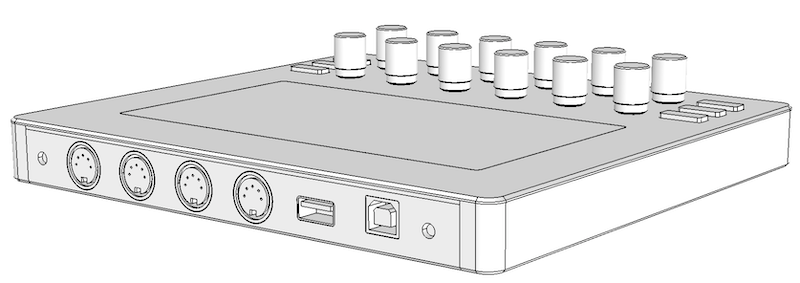

Back panel and connectors
The back panel serves two purposes. It is the place to connect your gear and the computer. There are also buttons to reset Electra and initiate the firmware update.
Electra back panel
  1. [UPDATE] button
  2. [RESET] button
  3. <USB DEVICE> port
  4. <USB HOST> port
  5. <MIDI 2 IN> port
  6. <MIDI 2 OUT> port
  7. <MIDI 1 IN> port
  8. <MIDI 1 OUT> port
Ports <MIDI 1 OUT>, <MIDI 1 IN>, <MIDI 2 OUT>, <MIDI 2 IN> are often referred as to <MIDI IO>
