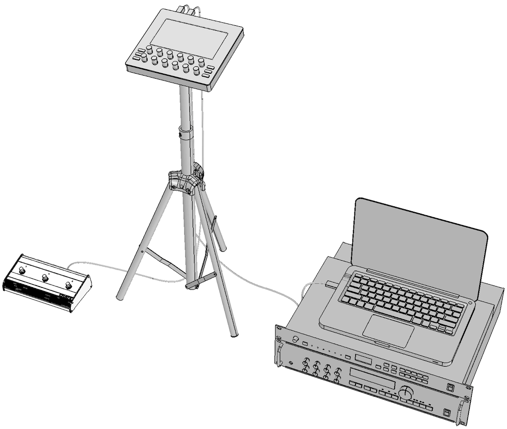

Electra with footswitch
The external MIDI control allows you to map a number of Electra actions to MIDI messages sent over to Electra's <USB HOST> port. The currently supported actions are:

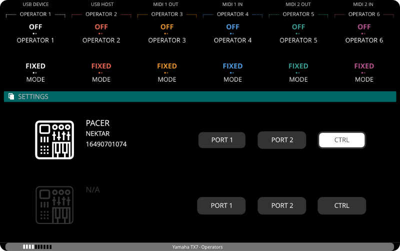

Configuring a USB Host device
In order to use a MIDI Controller to send commands to Electra, it must be connected to Electra's <USB HOST> and assigned to CTRL port. This assignment can be done manually at the USB Host configuration on the controller. Pre-defined mappings of USB devices to USB Host ports can be added on the Controller configuration page of the Electra One Account application, for more details visit Electra One configuration.
USB device footswitch
A permanent assignment can be done by uploading a custom configuration file to your Electra One.
