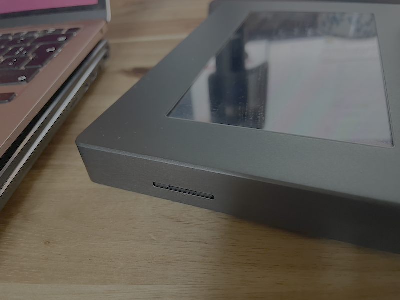

    • Newer models have an SD card slot on the left side of the controller’s body. Card in Gently push the card inward until it clicks and releases. Then pull it out. New slot

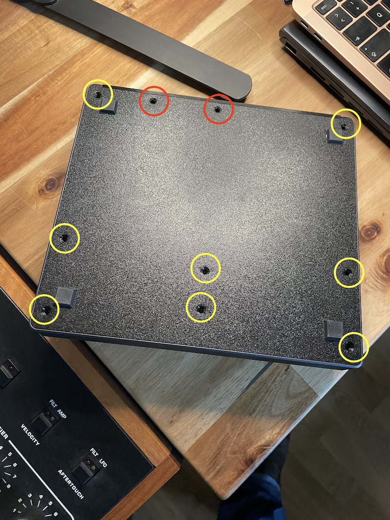

    • Older models have the SD card under the bottom plastic lid. To access it, remove the lid using a T6 hex key (Allen wrench). Tote, that the screws marked in red are longer. old screws Then carefully remove the card from the slot on the PCB - gently push the card inward until it clicks and releases. Then pull it out. old slot
