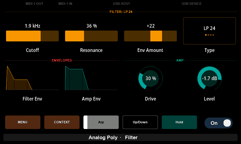

A preset is a set of pages, and each page shows a number of controls. A control is one thing you see on the screen and change with your hands: a fader, a dial, a list of options, a pad you switch on and off, an envelope, and so on.
The Filter page of a synthesizer preset on Electra One Mini
Electra One Mini: the Filter page of the Analog Poly preset

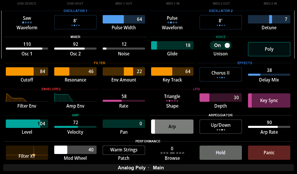

The same synthesizer on one page of Electra One Mk2
Electra One Mk2: the whole Analog Poly preset on one page

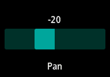

The display value and the MIDI value ​
A control works with two numbers:
  • The MIDI value is the number that travels in the MIDI message. For most parameters it goes from 0 to 127.
  • The display value is the number you see on the screen.
Often the two are the same. Sometimes a different number makes more sense to the person turning the knob. A pan control is a good example: the synthesizer expects 0 to 127, but "left 50, centre 0, right 50" is much easier to read. In the preset you set the display range to -50 to 50 and the MIDI range to 0 to 127, and Electra One translates between them in both directions.
What you see (display value)What is sent (MIDI value)
-50 (fully left)0
0 (centre)64
50 (fully right)127
A Pan fader showing -20
A Pan fader with a display range of -50 to 50, set to -20
When a fader's display range goes below zero, the fader fills from zero outwards: to the right for positive values and to the left for negative ones.

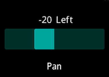

If a number is still not the clearest way to show a value, a control can show text instead. You will meet overlays, which give values names such as "Saw" or "Square", and formatters, which turn a value into any text you like, further down this page.
A Pan fader showing -20 Left
The same Pan fader with a formatter: -20 is shown as -20 Left

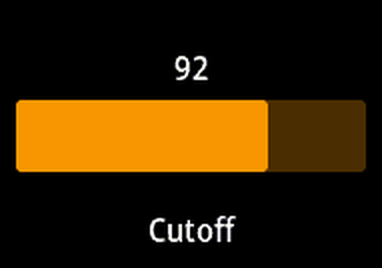

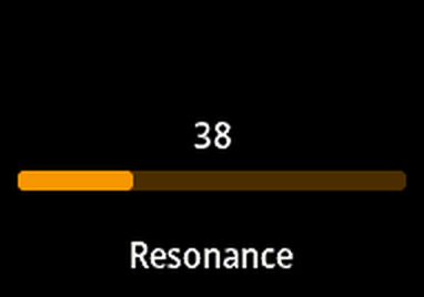

Fader ​
A fader is the most common control. It shows a value from a range, from a minimum to a maximum, and turning the knob moves smoothly through that range. Typical examples are filter cutoff, resonance, detune or volume.

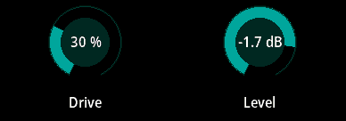

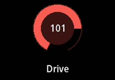

Faders come in three variants:
DefaultThinDial
Default faderThin faderDial
  • Default shows a full-size bar.
  • Thin shows a slim bar under a larger value.
  • Dial draws a knob, with the value in its centre. On the Mk2, where a control has less room, a dial leaves out its name, so it works best where the group label already says what it is.
A fader can also be bipolar or unipolar. A bipolar fader (the default) fills from zero, as described above. A unipolar fader always fills from the left, even when its range starts below zero.

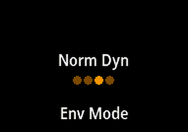

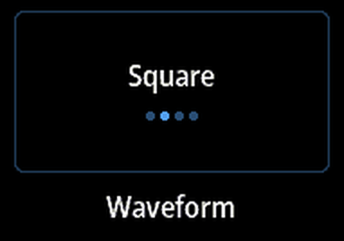

List ​
A list is for a parameter whose values each have a name. A synthesizer might use 0 for "Normal", 16 for "Inverted", 32 for "Normal with dynamics" and so on. Numbers like these mean nothing on their own, so a list shows the names. Turning the knob steps through the options one at a time.
DefaultValue only
ListValue only list
  • Default shows the name of the selected option with a row of dots, one dot per option. A long list shows a bar instead of dots.
  • Value only shows the option in a box, like a button.
The names and their MIDI values are stored in an overlay, a small table that pairs each value with a label. One overlay can be shared by many controls, for example all the waveform selectors of a synthesizer. If the instrument sends a value that is not in the list, the control ignores it.

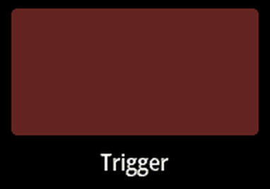

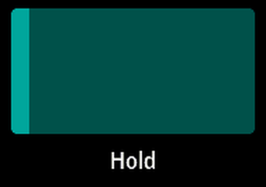

Pad ​
A pad is a switch with two states, on and off. When it changes state, it sends its On value or its Off value.
ToggleMomentary
Pad toggle, onMomentary pad
A pad works in one of two modes:
  • Toggle: the pad stays on until you switch it off again. Good for things like "Hold" or "Unison".
  • Momentary: the pad is on only while you hold it, and switches off when you let go. Good for triggering things.
You can switch a pad with the knob, too. Turning the knob clockwise switches it on, and turning it anticlockwise switches it off. On the Mk2 you can also touch the pad on the screen.

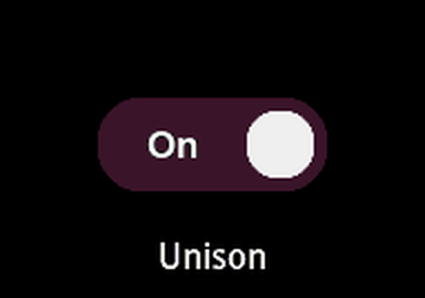

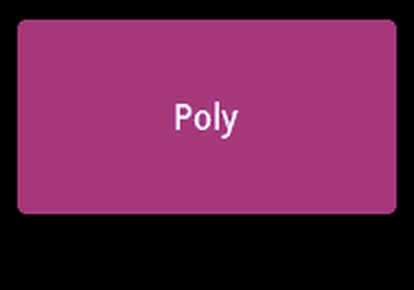

Pads have three variants:
DefaultCheckboxValue only
PadCheckboxValue only pad
  • Default is a coloured pad with its name.
  • Checkbox looks like an on/off switch.
  • Value only shows a word for each state instead of the name, for example "Mono" when it is off and "Poly" when it is on. The words come from an overlay.

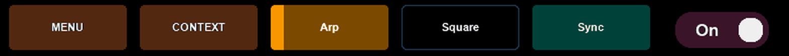

Controls on the Mini's buttons
On Electra One Mini, the four buttons under the screen can hold controls too: pads and lists. They show up in the row at the bottom of the screen. See Overview.
Controls on the Mini's hardware buttons
Electra One Mini: a pad, a list, another pad and a checkbox on the four buttons

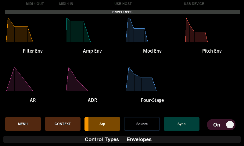

Envelopes ​
Envelope controls show the shape of an envelope and let you adjust all of its stages. Each stage, such as Attack or Decay, has its own value and its own MIDI message, and the picture updates when you change a stage or when the instrument sends new values.
The six envelope types on Electra One Mini
The six envelope types: ADSR, ADSR, AHDSR and ADSSR above, AR, ADR and Four-Stage below
Electra One offers six envelope types, so you can pick the one that matches your instrument:
TypeStages
ADSRAttack, Decay, Sustain, Release
AHDSRAttack, Hold, Decay, Sustain, Release
ADSSRAttack, Decay, Break, Slope, Sustain, Release
ARAttack, Release
ADRAttack, Decay, Release
Four-Stagefour levels and four rates, as on classic FM synthesizers

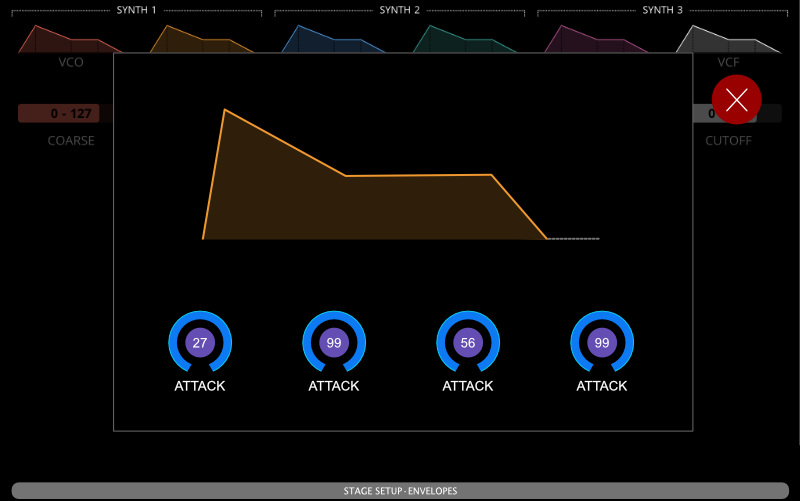

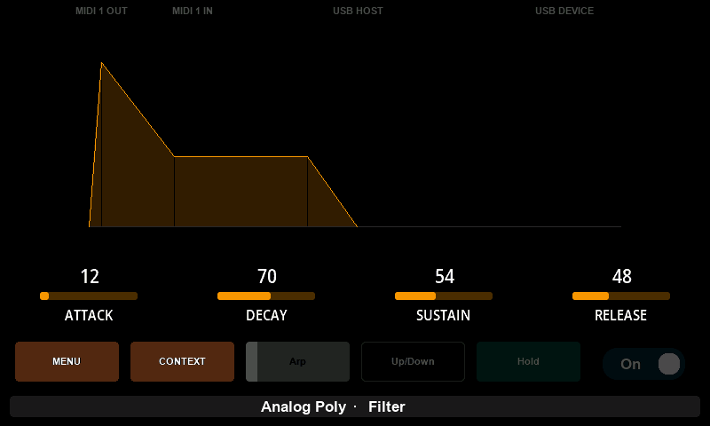

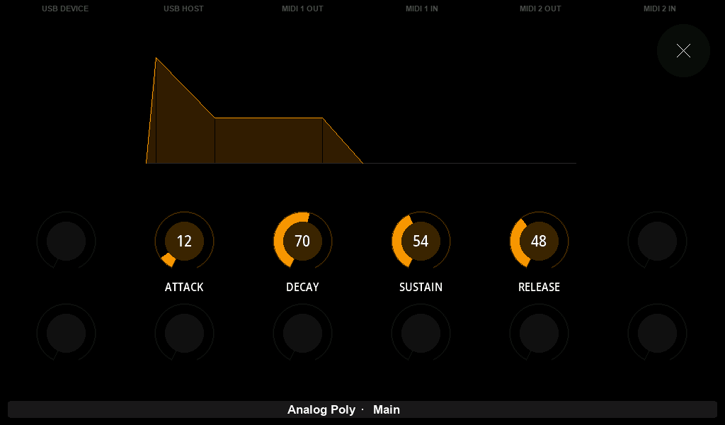

An envelope has more stages than its knob can move at once, so the knob changes one stage at a time. While you hold the knob, you can switch to the next stage. To see and change all stages together, open the envelope's detail window. There, every stage gets a knob of its own:
An envelope detail window on Electra One Mini
Electra One Mini: the Filter Env detail window, a fader for each stage
An envelope detail window on Electra One Mk2
Electra One Mk2: the Filter Env detail window, a dial for each stage

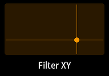

XY Pad ​
An XY Pad combines two parameters in one control: one on the horizontal axis (X) and one on the vertical axis (Y). The dot shows both values at once. It is ideal for parameters that are often changed together, such as cutoff and resonance.
XY Pad
An XY Pad controlling cutoff (X) and resonance (Y)
The knob changes one axis at a time. On the Mk2 you can open the XY Pad's detail window and drag your finger across it to change both values in one movement.

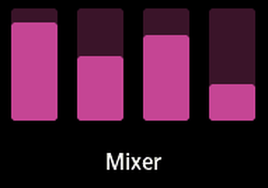

V Fader 4 ​
A V Fader 4 shows four vertical faders in one control. It is a compact way to show four levels that belong together, such as the levels of four oscillators or the four sends of a mixer channel.
V Fader 4
A V Fader 4 showing four mixer levels

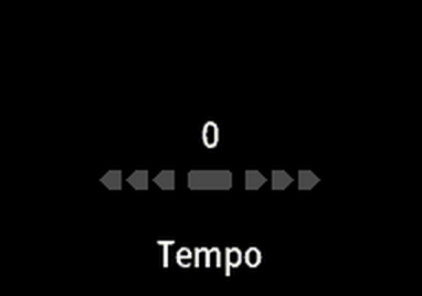

Relative ​
Most controls send the value itself: "set the cutoff to 92". Some software and some instruments expect steps instead: "a little higher", "a little lower". A Relative control sends exactly that.
Relative control
A Relative control at rest
A relative control does not know the parameter's current value, so it does not show one. While you turn the knob, it shows how big a step it sends, and it returns to 0 when you let go. Turn faster and the steps get bigger, if the control is set to accelerate. Because it has no value of its own, it cannot follow incoming MIDI messages.

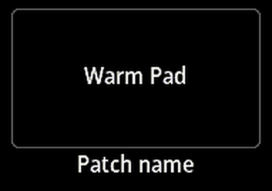

Text box ​
A text box shows text rather than a number, such as the name of the patch loaded in your synthesizer. On the Mk2 you can tap it and type with an on-screen keyboard. On the Mini, the knobs move a cursor through the letters.
Text box
A text box showing a patch name
Text boxes are usually filled by the preset itself, for example with a patch name that a Lua script reads from the synthesizer.

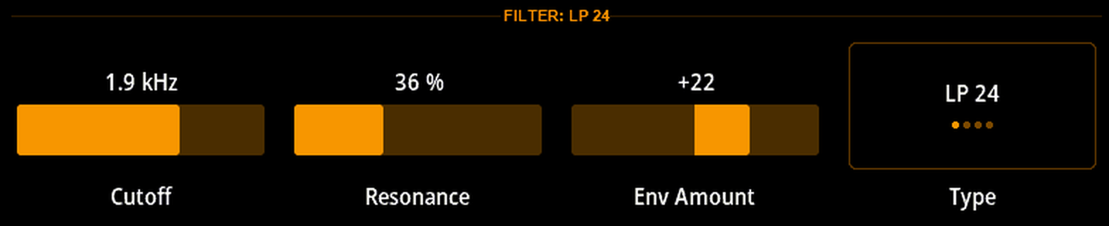

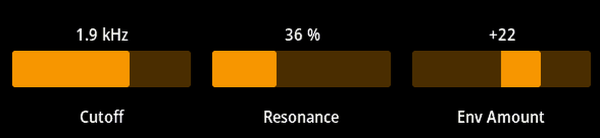

Groups that follow a MIDI value ​
A group can also follow a MIDI parameter, just as a control does. Its title and colour then change with the parameter's value. You link the group to a parameter and to an overlay, and for every value the overlay says which title and which colour the group shows.
In the Analog Poly preset, the FILTER title follows the filter type. When the type changes, whether you choose it on Electra One or on the synthesizer itself, the title says which filter is active and takes on its colour:
A group showing the low-pass filter
The FILTER group follows the filter type: FILTER: LP 24 in orange

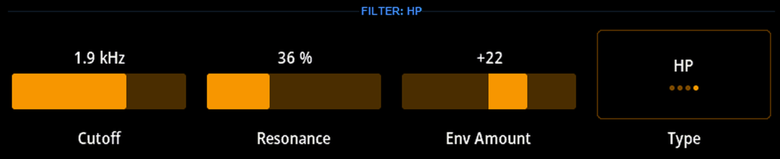

The same group showing the high-pass filter
After switching to the high-pass filter, the group reads FILTER: HP in blue

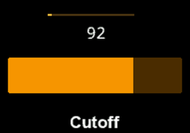

A knob on another controller and the value on Electra can disagree, for example after you load a snapshot. The takeover setting decides what happens when you then move the remote knob:
  • Jump: the value jumps to the knob's position.
  • Pickup: nothing happens until the knob passes the current value.
  • Scale: the value moves towards the knob gradually and catches up by the end of its travel.
  • Nudge: the value moves by as much as the knob moves.
Take Pickup as an example. The Cutoff control below is set to 92, but the remote knob bound to it was left at 30. Turning that knob does not change the cutoff yet. A thin amber line above the control shows the gap: its bright end marks where the remote knob is, and the line reaches to the control's value. As you turn the knob up, the bright end moves along the line. When it reaches 92, the line disappears and from then on the knob moves the cutoff as usual.
A Cutoff fader waiting for a remote knob to pick it up
Pickup: the remote knob is at 30, the Cutoff stays at 92 until the knob gets there

Here is the Analog Poly preset from the top of this page, with formatters on its faders and dials. Each value is still 0 to 127 underneath, but the screen shows it in the unit the synthesizer itself uses:
Faders with formatters
Formatters at work: Cutoff in kilohertz, Resonance in percent, Env Amount with a sign
Dials with formatters
The same on dials: Drive in percent and Level in decibels

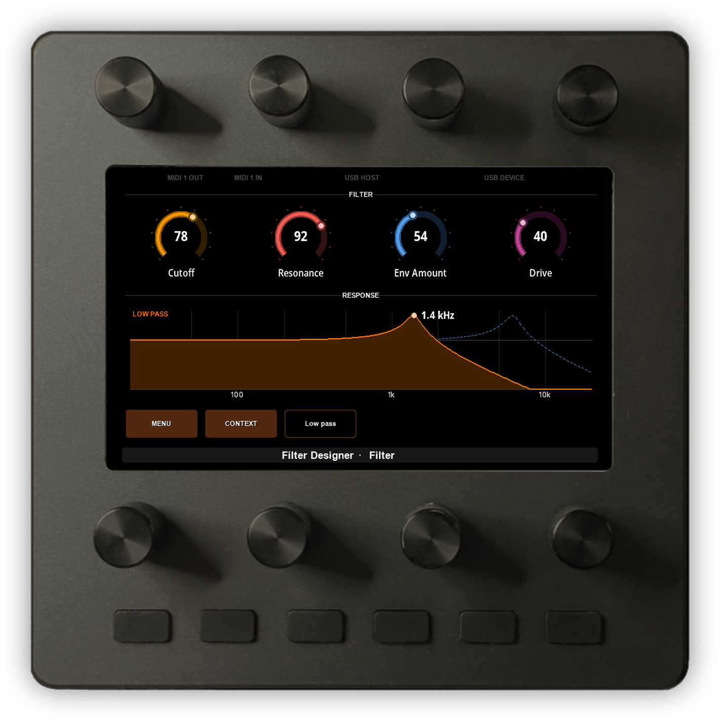

A custom control is a blank area of the screen that the preset's Lua script draws. You decide what it looks like and what its knobs and screen touch do, so it can show things no standard control can.
The Filter Designer preset below is built from custom controls. The four ring dials are drawn by Lua, and the wide control underneath draws the filter's response curve. The curve changes shape as you turn Cutoff and Resonance, shows how far the envelope sweeps the cutoff, and follows the filter type chosen on the first button.
The Filter Designer custom controls on Electra One Mini
Electra One Mini: the Filter Designer preset, built from custom controls
Custom controls are an advanced feature. They are a good choice when you want to visualise something, such as a filter curve, a step sequence or a level meter, or build a control surface for an instrument that works in an unusual way. The Preset Lua Extension documentation explains the drawing functions they use.
