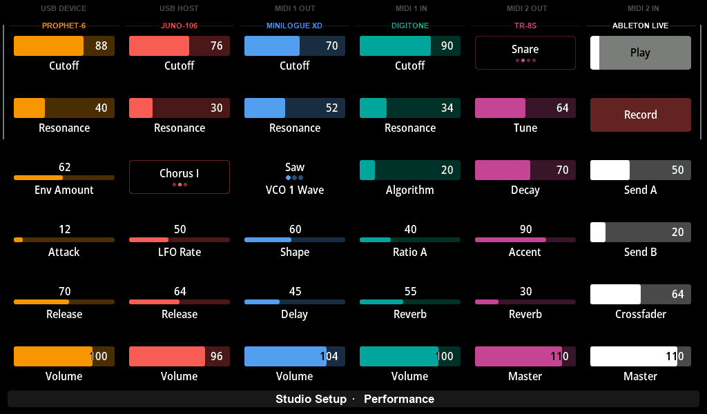

A preset controlling six instruments on Electra One Mk2
Electra One Mk2: one page controlling six instruments, one device per column

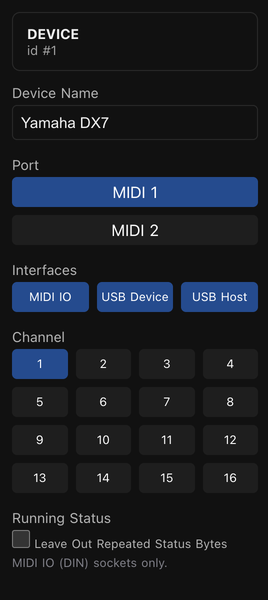

The device settings in the preset editor
The settings of a device in the preset editor
Every device has a name, so the preset reads like your studio: "Prophet-6" rather than "Port 1, channel 1". The name appears in the editor wherever you choose a device for a control.
The port and channel tell Electra One where the instrument is, as described above. Together they are the address of the device.
By default a device uses all three interfaces. You can switch some of them off. A synthesizer plugged into the <MIDI IO> sockets does not need its messages copied to your computer as well, and restricting it keeps the USB connection free for other traffic. The choice works both ways: a device limited to <MIDI IO> also listens only to messages arriving there. It even lets two devices share one port and channel, as long as they use different interfaces.

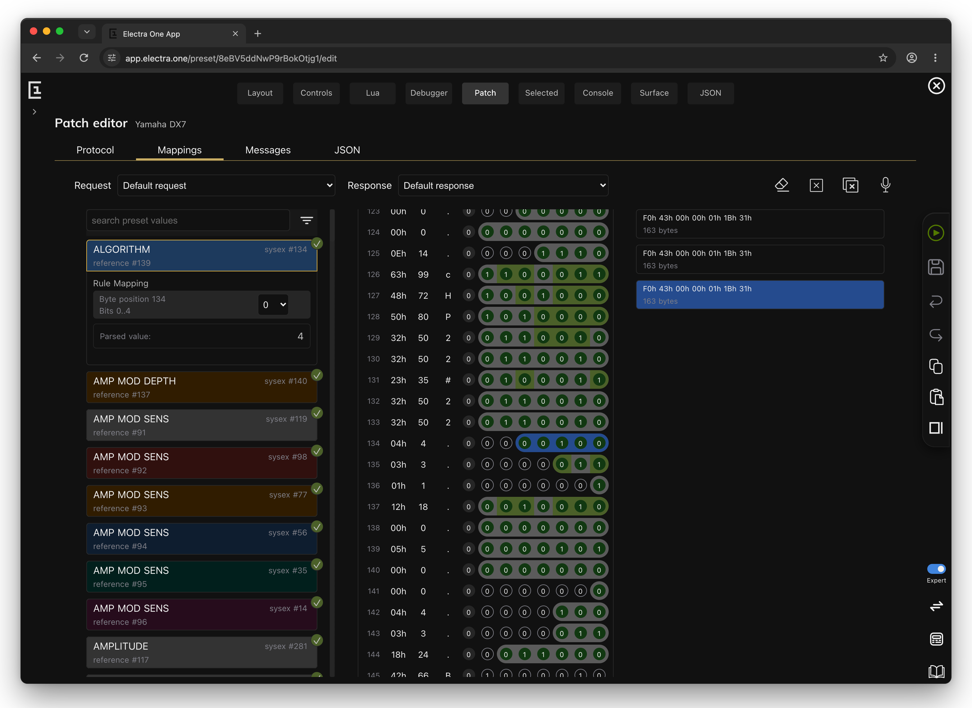

A request is a SysEx message that asks the instrument to send its current sound. The instrument answers with a response, often called a patch dump: a long SysEx message that contains every parameter of the sound. Electra One reads the dump and updates all the controls at once.
To read a dump, Electra One needs to know where each parameter is inside it. The device describes this with rules. A response starts with a header, a few bytes that identify it, and each rule then says "the value of this parameter is in byte 134, bits 0 to 4". Rules can take a whole byte, a few bits of a byte, or combine several bytes into one larger value.
Mapping the bytes and bits of a Yamaha TX7 patch dump in the preset editor
The Patch editor's Mappings tab: a real Yamaha TX7 voice dump, the bits each rule reads, and the bits that changed since the previous dump in green
You do not need to be a programmer to build these rules. The preset editor's Patch tab (in Expert mode) shows a received dump byte by byte and bit by bit. You pick a control on the left and click the bits that belong to it. When you request the dump again after changing a parameter on the instrument, the bits that changed light up, which makes it easy to find where a parameter lives, even for an instrument whose SysEx format is not documented anywhere. What you do need is an understanding of SysEx messages, bytes and bits.

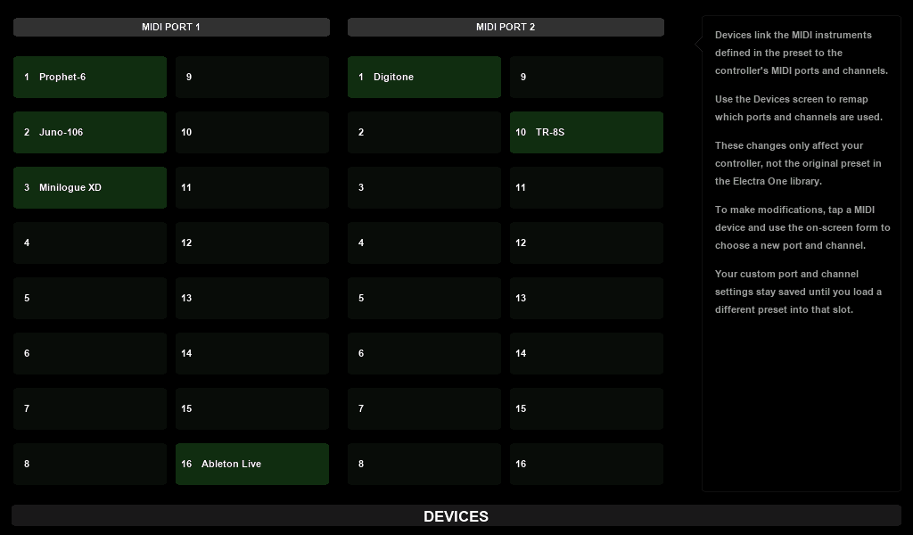

The Devices screen of Electra One Mk2
Electra One Mk2: the DEVICES screen lists the preset's devices by port and channel
On the Mk2, open DEVICES from the main menu. The screen lists the preset's devices under MIDI PORT 1 and MIDI PORT 2, by channel. Tap a device and choose its new interfaces, port and channel. If you pick a port and channel another device already uses, the two devices swap places. The overrides are saved when you close the screen.
