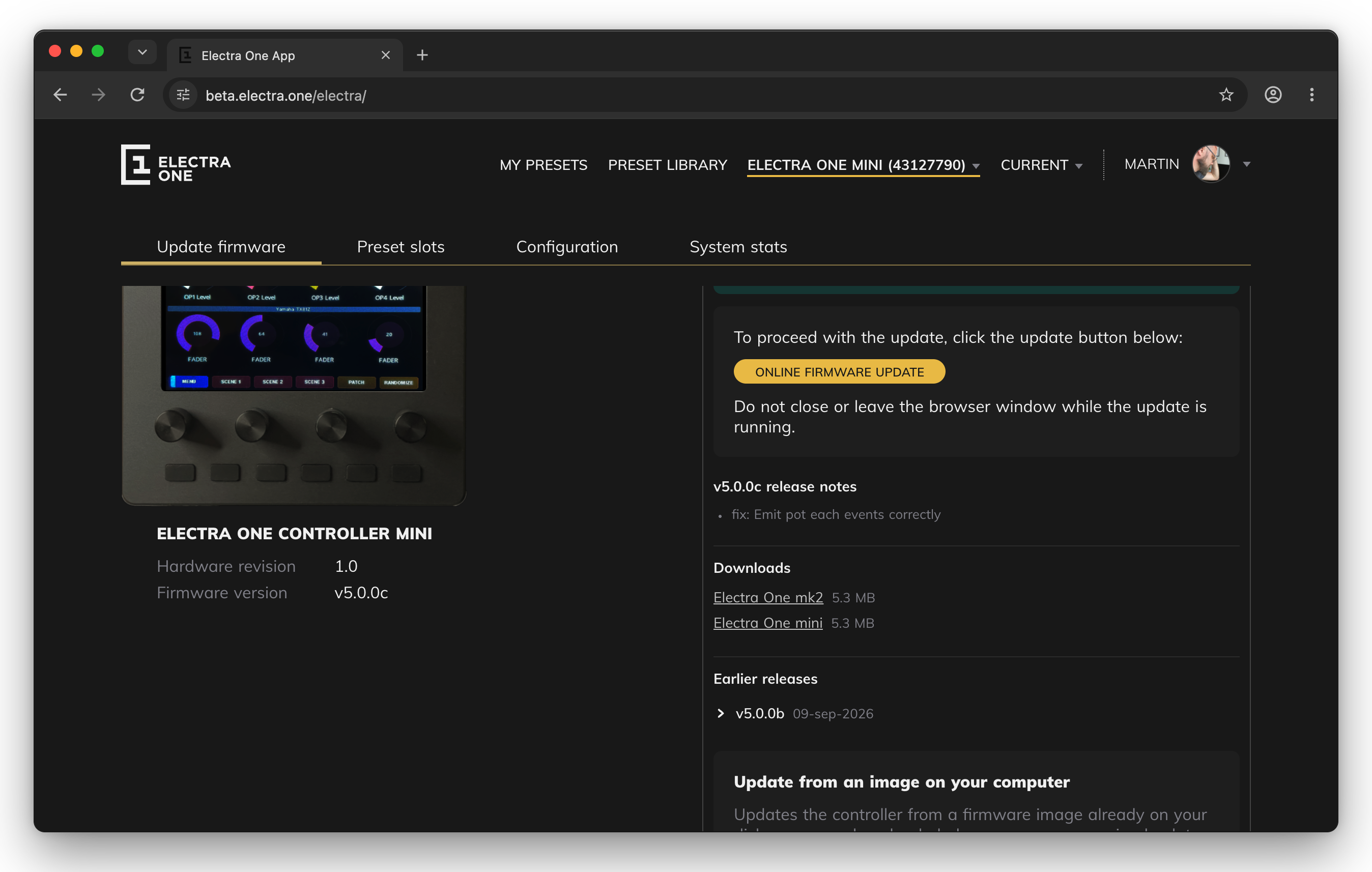

1. Get the firmware file ​
From firmware 5.0.0 on, the firmware files are published in the Electra One web application, not in this documentation. Open app.electra.one, go to CONTROLLER, and on the Update firmware tab take the image for the Mini from the Downloads list under the release notes. Earlier 5.x versions are under Earlier releases.
Where the firmware files are
The Downloads list of the Update firmware tab, with the image for each model
Save it where you can find it again - it is the file the bootloader installs.
