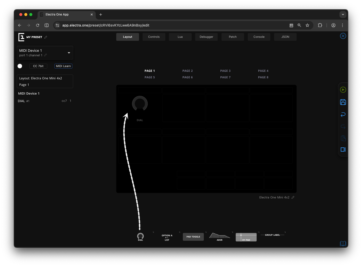

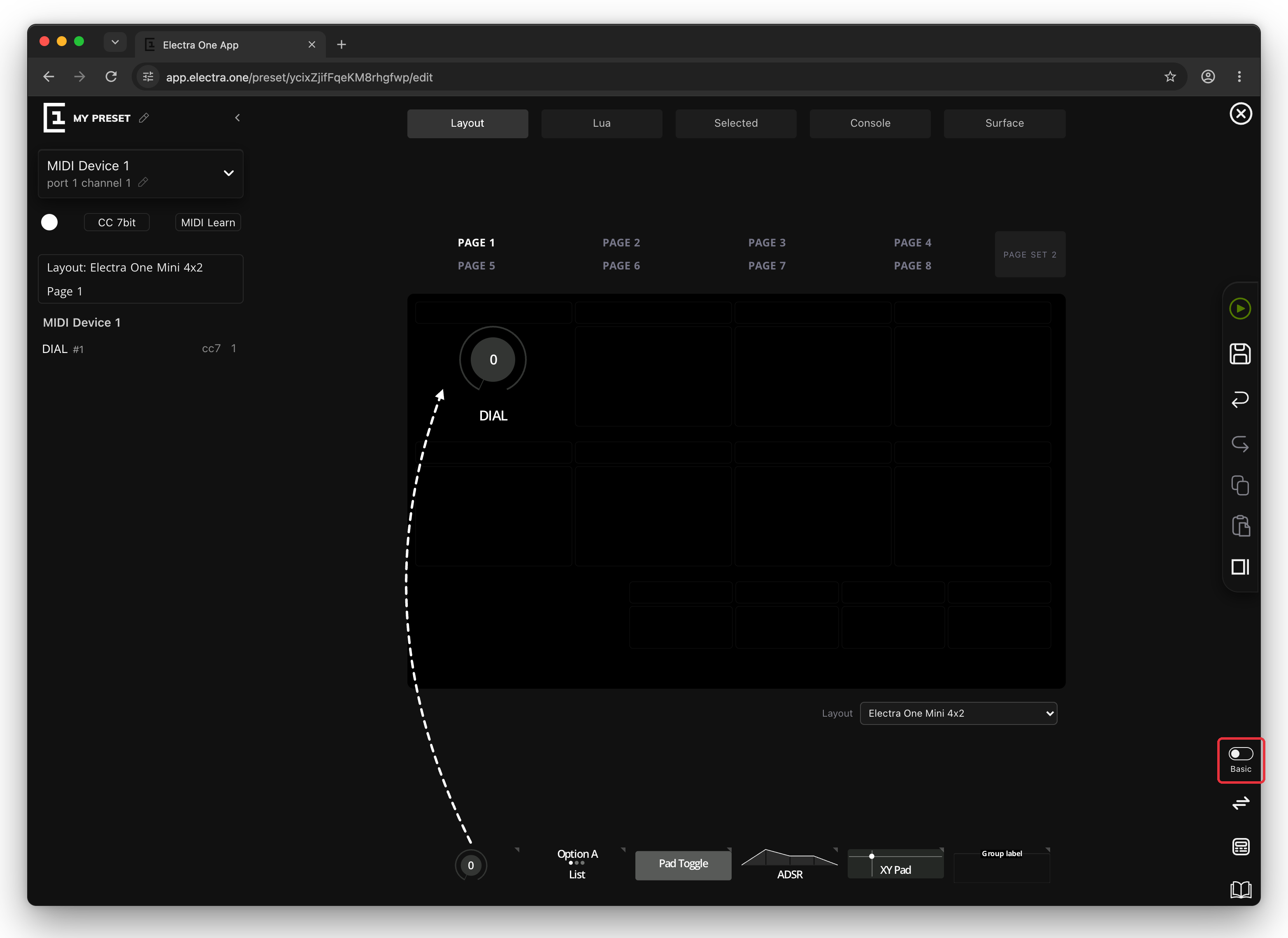

The large black area in the middle of the editor is a picture of your controller's screen, divided into slots. The controls you can add are lined up below it. Drag the Dial, the first one on the left, and drop it on the top-left slot.
Drag the Dial onto the screen
Dragging the Dial onto the top-left slot. The Basic switch is at the right edge.

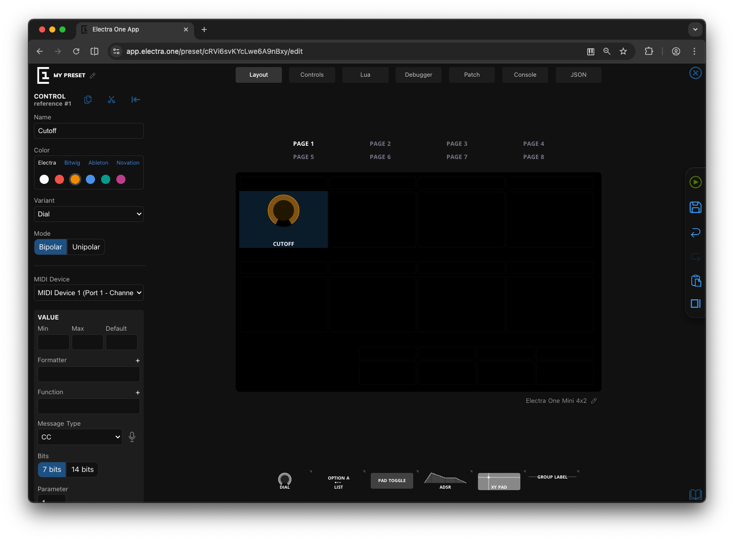

Click the new dial to select it. The sidebar on the left now shows its settings. Type Cutoff into Name and click the orange circle under Color.
Name the control and pick a color
The selected Dial renamed to Cutoff and coloured orange

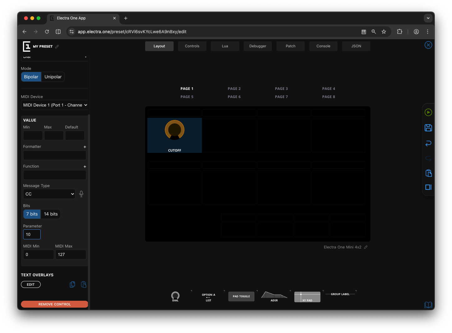

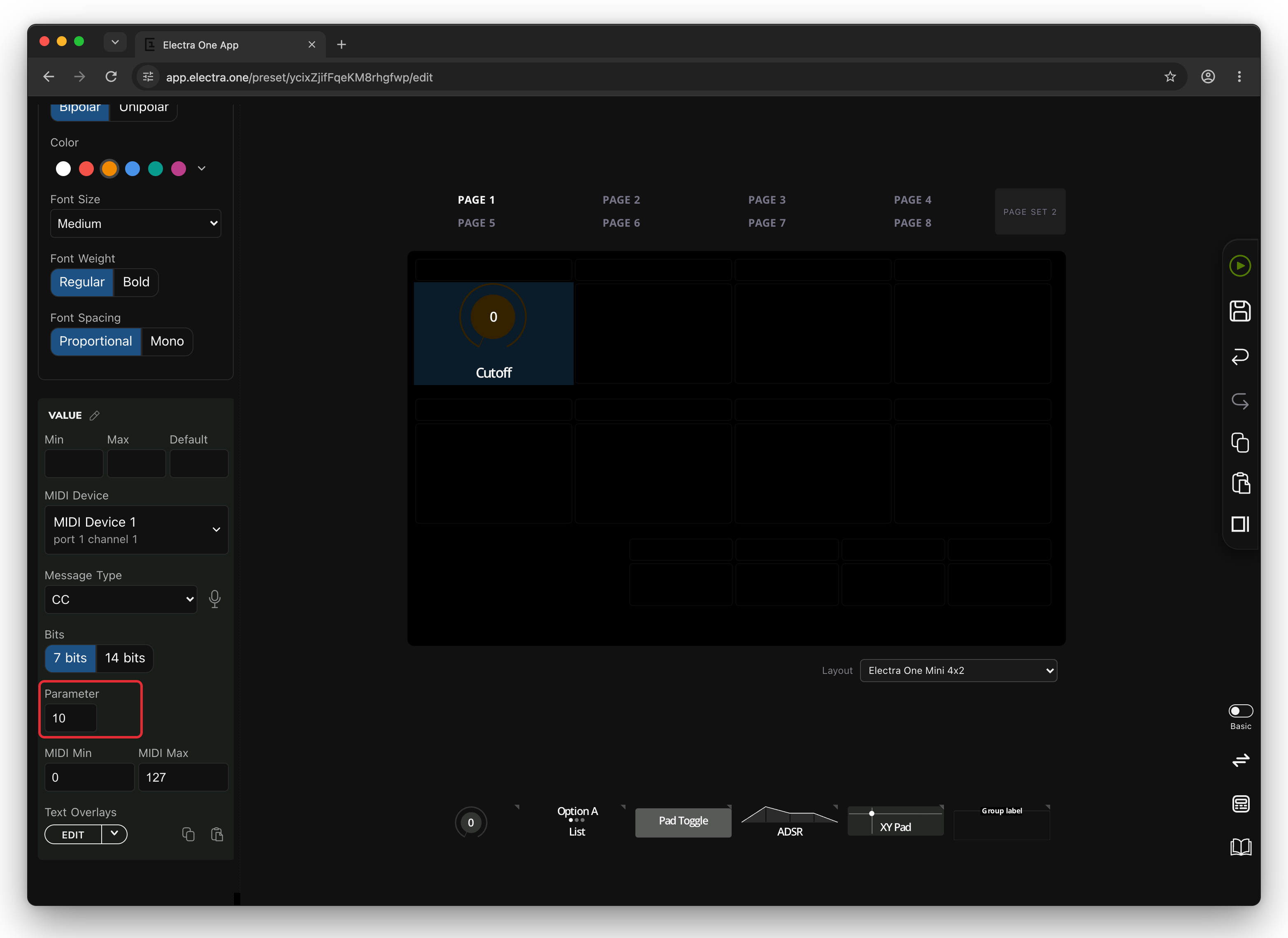

Now scroll the sidebar down to the VALUE section. Message Type is already set to CC, which stands for Control Change, the most common way for a controller to change a setting on a synthesizer. The Parameter number says which setting it changes. Type 10 into Parameter.
Set the parameter number to 10
The Parameter number set to 10
Which parameter number changes what depends on your synthesizer. Its manual usually has a table of the Control Change numbers it responds to.

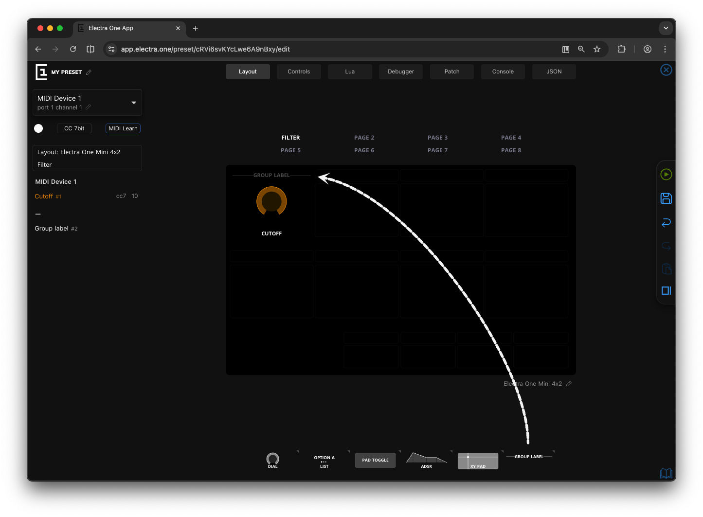

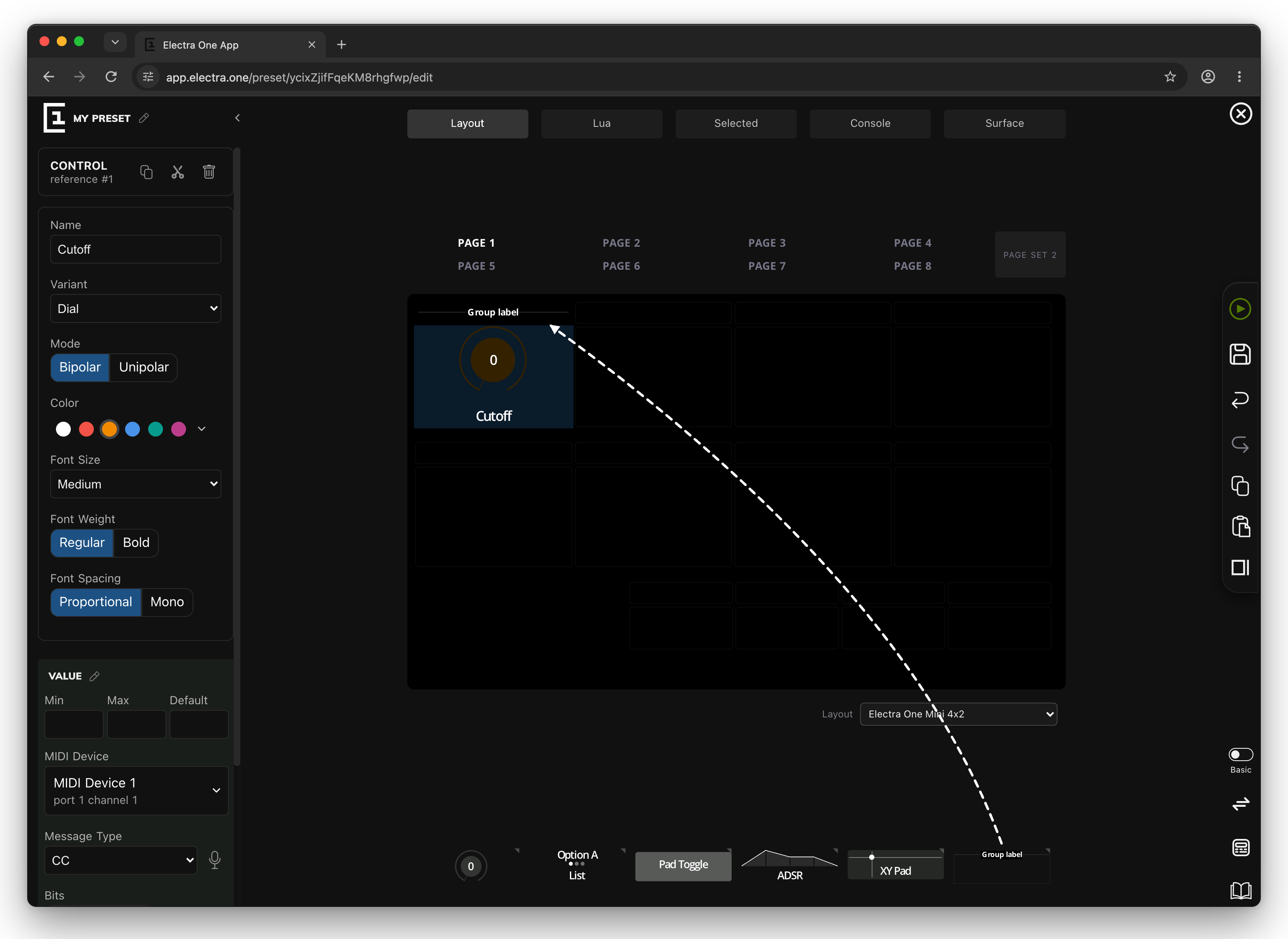

A group label is a title that you place above one or more controls to keep the screen tidy and organized. Drag the Group label, the last one in the row, and drop it on the narrow slot right above Cutoff.
Drag the group label above the control
Dragging a Group label above the Cutoff control

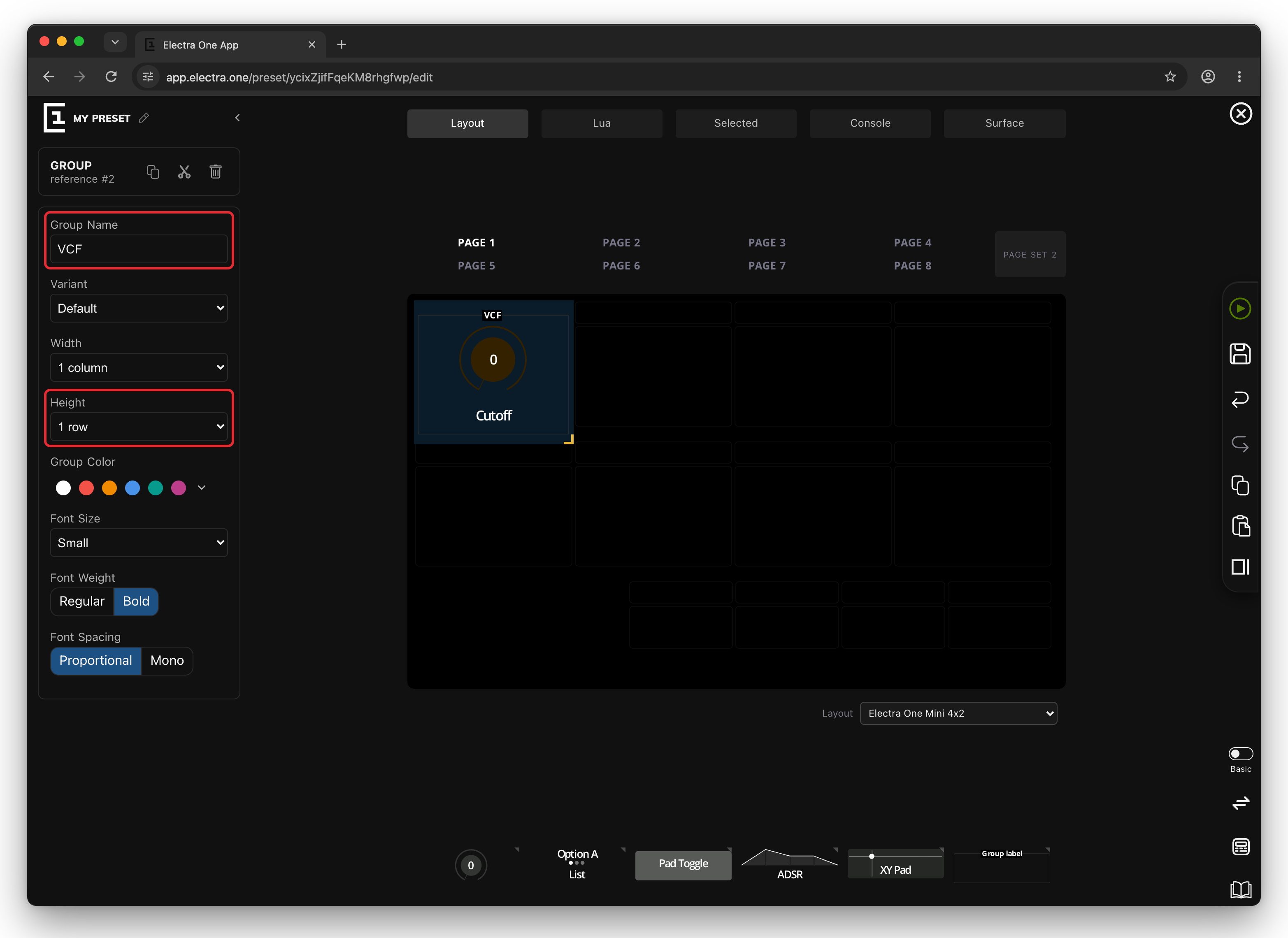

5. Name the group ​
Click the group label to select it. In the sidebar, type VCF into Group Name. Then change Height from thin line to 1 row, so that the group draws a frame around the Cutoff dial below it.
Name the group and set its height
The group named VCF, one row high

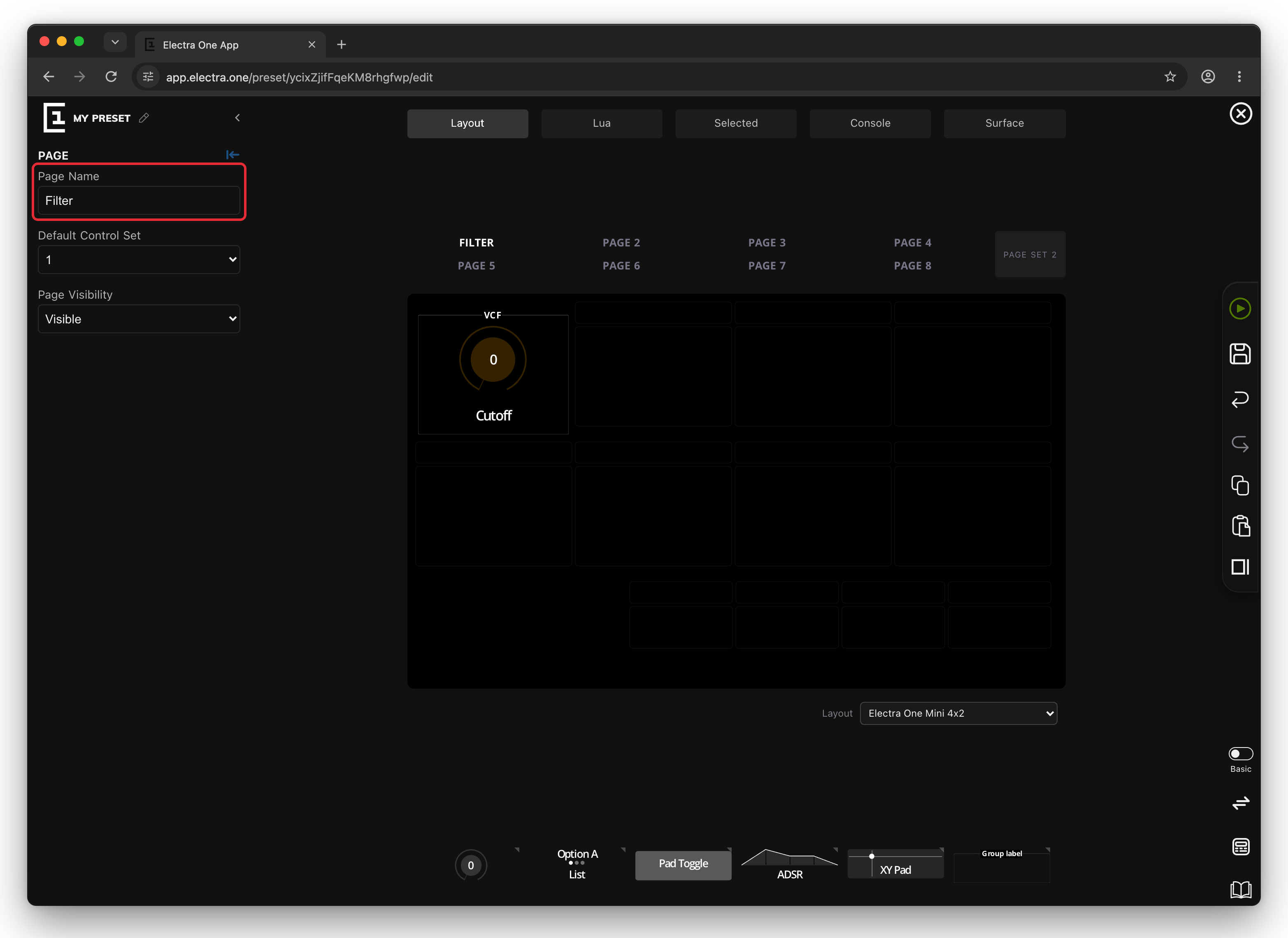

6. Name the page ​
A preset can have many pages, and each page shows its own set of controls on the controller. A page name tells you where you are.
Move the mouse over the PAGE 1 button above the screen. A small pencil icon appears next to it. Click the pencil.
Click the pencil next to PAGE 1
The pencil next to PAGE 1 opens the page settings

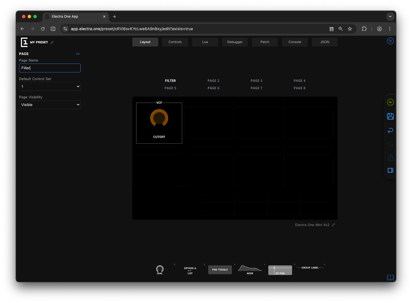

The sidebar now shows the page settings. Type Filter into Page Name.
Name the page
The page named Filter

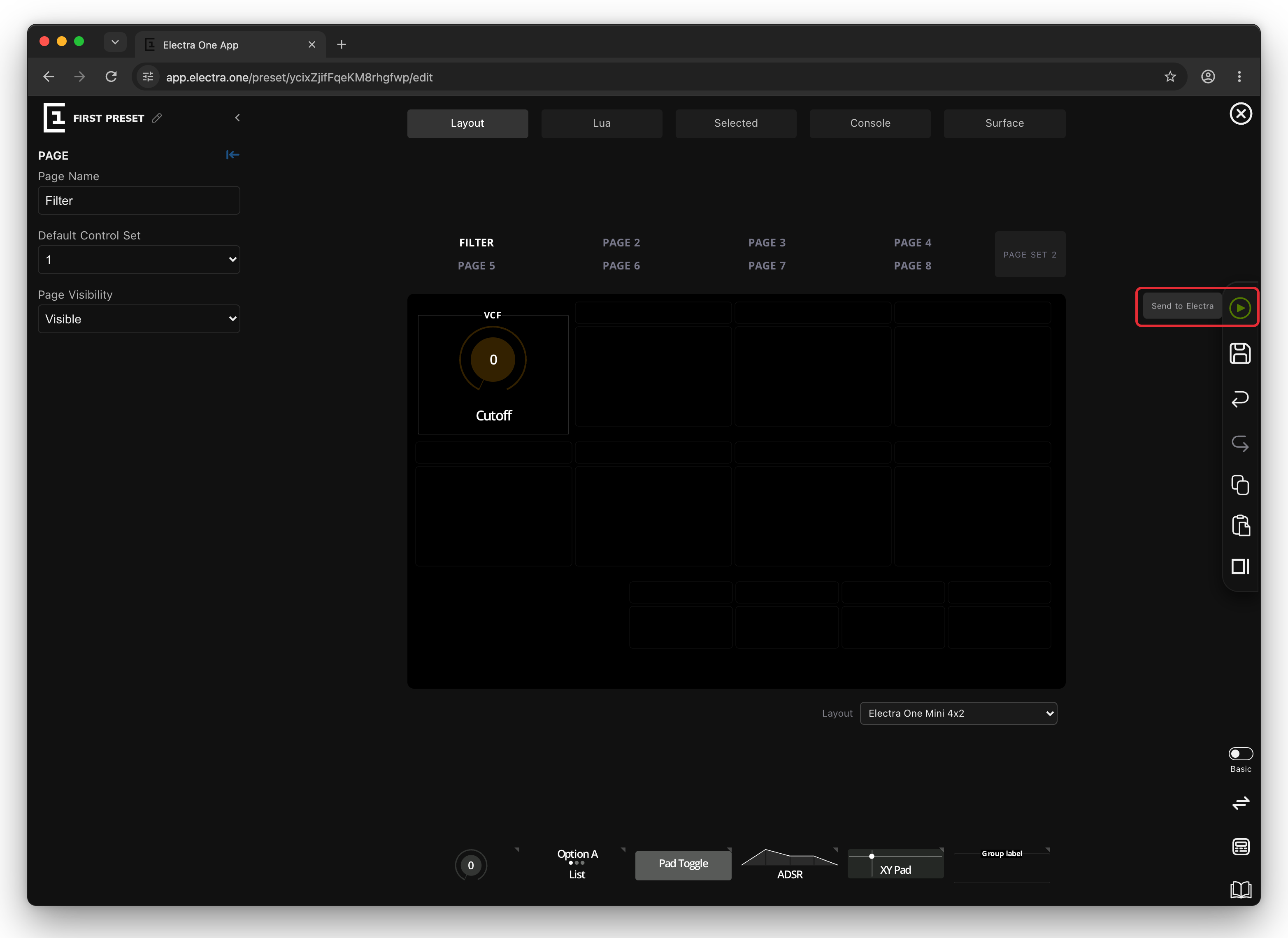

8. Send the preset to your Electra One ​

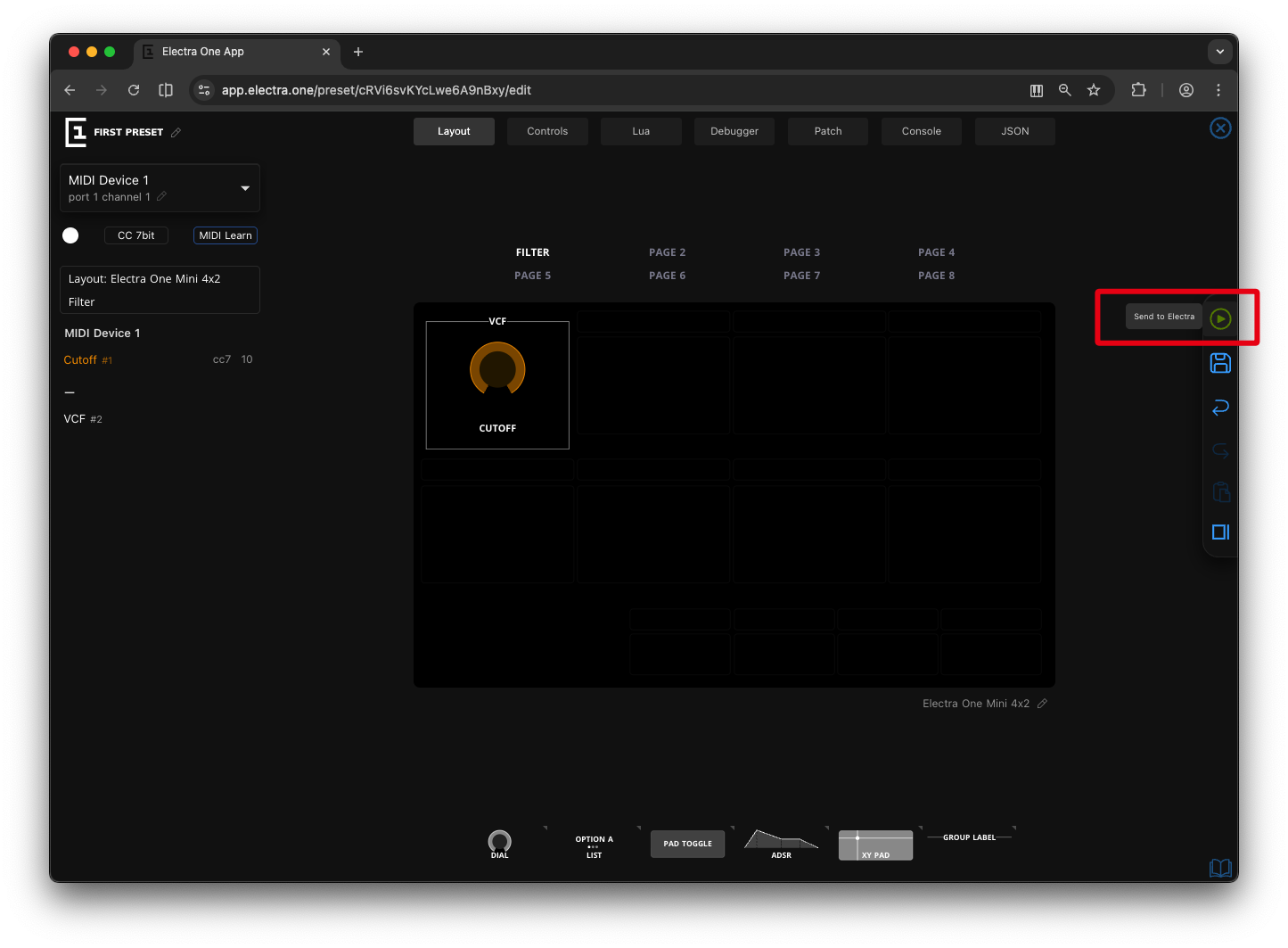

On the right edge of the editor, move the mouse over the green play button. It says Send to Electra. Click it.
The Send to Electra button at the right edge of the editor
The preset goes to the preset slot that is currently selected on your Electra One and replaces whatever that slot held before. It is also saved to your account at the same time, so you will find it in your WORKSPACE.

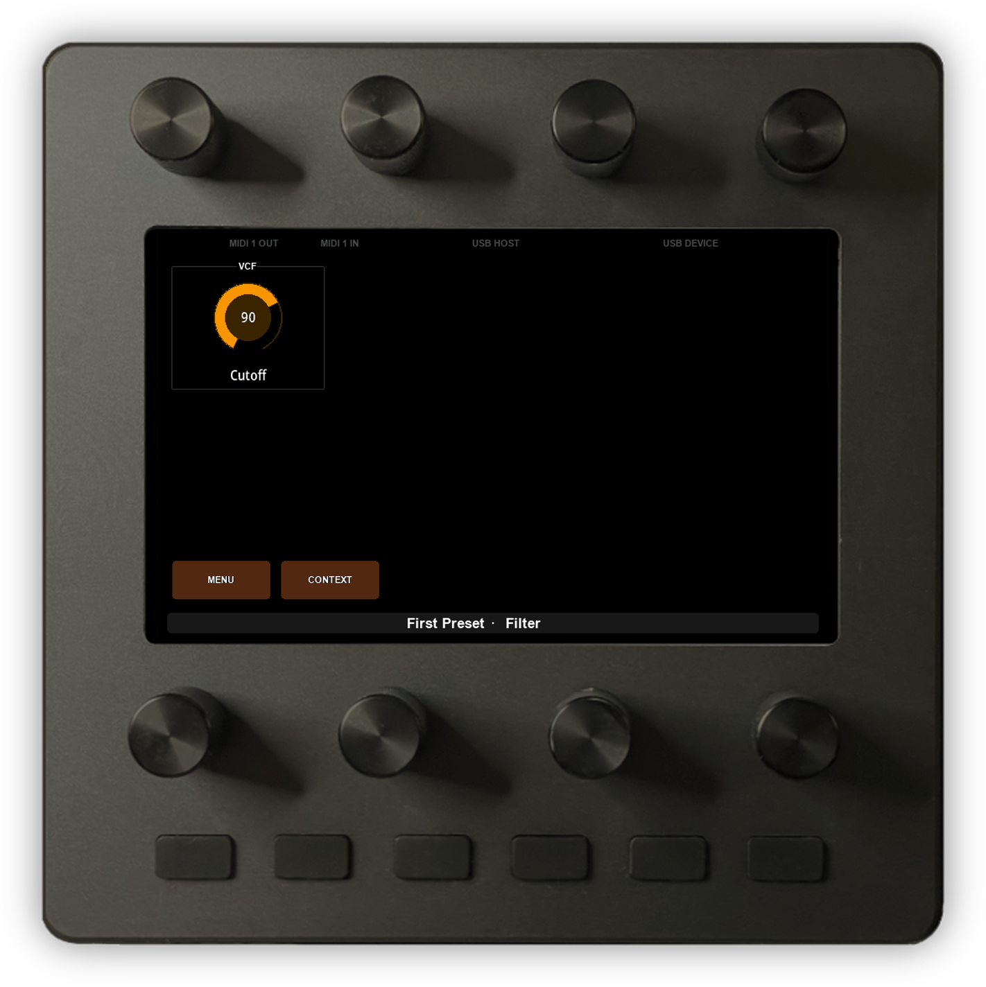

9. Try it on your controller ​
Your Electra One now shows the Filter page with the orange Cutoff dial in its VCF frame, and the name of the preset and the page at the bottom of the screen. Turn the top-left knob. The dial follows your hand, and the controller sends Control Change 10 messages on MIDI port 1, channel 1. On the Electra One Mk2 you can also use the touch screen.
First Preset on an Electra One Mini
First Preset on Electra One Mini, with the Cutoff dial turned up
