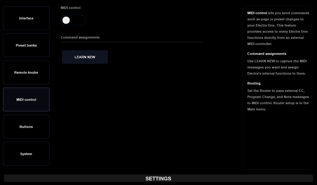

Settings overview
The screen is divided into several tabs, each focused on a specific configuration domain:
  1. Interface – Adjust settings that affect the behavior of the user interface.
  2. Preset Banks – Manage preset banks stored on the device.
  3. Remote Knobs – Configure support for external MIDI controllers used to extend Electra One’s knobs.
  4. MIDI Control – Set up control of Electra One using incoming MIDI messages.
  5. Buttons – Customize the functions assigned to Electra One’s hardware buttons.
  6. System – View information about the Electra One hardware and runtime resources.
To switch between tabs, simply tap the corresponding tab.
The Settings screen has no SAVE button and no BACK button. Everything you change is written to the controller when the screen closes, and pressing any hardware button closes it. The SAVE STATE button on the System tab writes the same thing without leaving the screen; see System.
The same settings can also be made in the Electra One app, where a few of them have different names and two of them exist only there. See The configuration in the Electra One app at the end of this chapter.
Each tab is covered in detail in the following sections.

MIDI Control ​
The MIDI Control feature allows you to map external MIDI messages to internal Electra One commands and actions. It works similarly to Remote Knobs, but instead of controlling on-screen parameters, it triggers system-level functions.
The MIDI control tab
The MIDI control tab with MIDI control switched off and no command assignments yet
Configuration ​
You can assign incoming MIDI CC, Note, or Program Change messages to a wide range of Electra One actions, such as:
  • Switching presets or pages
  • Opening windows (e.g., Snapshots, Captures, Settings)
  • Toggling performance and alt mode
This makes it possible to control Electra One using an external MIDI controller or a computer, greatly expanding performance and integration options.
For example, using a pad controller like the Novation Launchpad Mini, you can easily map its pads to act as extra buttons for triggering Electra One functions, such as switching pages, sending patch requests, or opening snapshot banks.
The tab carries the MIDI control switch, which turns the whole feature on and off. It is off until you turn it on, so a new controller runs no actions however many assignments it has. Below it, under the label Command assignments, is the list of mappings. A CLEAR ALL button removes every mapping; press and hold it until it fills, as letting go early does nothing.
A full list of available actions is in The actions below.
The MIDI Control tab holds the Mapping Screen. Which MIDI inputs MIDI Control listens to is set on the Router screen, as described below.
