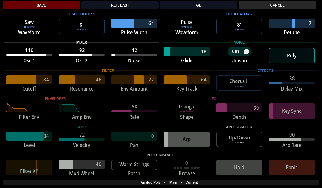

The snapshot tool bar ​
The snapshot tool bar lets you build a series of variations of a sound without opening the Snapshots window again for each one.
Switch to [SAVE CURRENT] mode and touch and hold a free slot. The current values are saved into that slot, the window closes, and the tool bar appears in the row above the controls, where the page buttons go. The Status bar is hidden while the tool bar is on the screen.
The snapshot tool bar over the Analog Poly preset: SAVE, REF: LAST, A/B and CANCEL where the Status bar was, and Current on the Bottom bar
The tool bar has four buttons:
  • SAVE - saves the current values into the next slot of the bank. When the last slot of the bank has been used, the button reads RETAKE; tapping it starts again from the first slot after the one you held.
  • REF: LAST / REF: FIRST - chooses what A/B plays: the variation you saved last, or the snapshot you started from.
  • A/B - switches between the reference and the values you are working on. Tap it to hear the reference, and again to return to your own values, exactly as you left them. If you change a value while you hear the reference, that becomes your current sound, and the next tap keeps it.
  • CANCEL - closes the tool bar. Everything you saved stays in its slot.
A button lights up while you touch it. The Bottom bar shows what you are hearing after the preset and page names - A0 First or D3 Last while A/B plays the reference, Current otherwise - and confirms each save for about two seconds, for example Snapshot D0 saved.
The tool bar closes when you load another preset, and when you open the Snapshots window again; the window then opens below the Status bar as usual. What it is for, and a worked example, is described in Quick variations with the Snapshot tool bar.

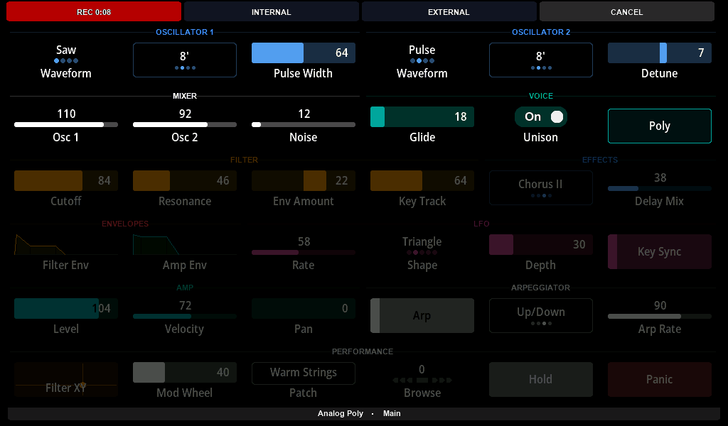

The capture tool bar ​
The capture tool bar lets you record while the preset page is on the screen, so you can record the knob moves you make.
Tap [RECORD], then touch and hold a capture slot. The window closes, and the tool bar appears in the row above the controls, where the page buttons go. The Status bar is hidden while the tool bar is on the screen. Nothing is recorded yet.
The capture tool bar while it records: RECORD reads REC 0:08 and is bright red
  • RECORD - starts the take at once. While it records, the button is bright red and shows the elapsed time, such as REC 0:05. Tap it again to stop: the capture is saved, the tool bar closes, and the Bottom bar shows Capture A0 saved, with the name of the new capture, for about two seconds.
  • INTERNAL - a toggle. When on, the messages the controller sends itself are recorded: a knob you turn, a button you press, the MIDI a Lua script sends.
  • EXTERNAL - a toggle. When on, the messages that arrive at the controller are recorded: from the MIDI sockets, from USB instruments and from the computer.
  • CANCEL - discards the take and closes the tool bar.
With the tool bar the recording starts when you tap RECORD, not with the first message that arrives. See Recording for what a capture records and what it leaves out.
