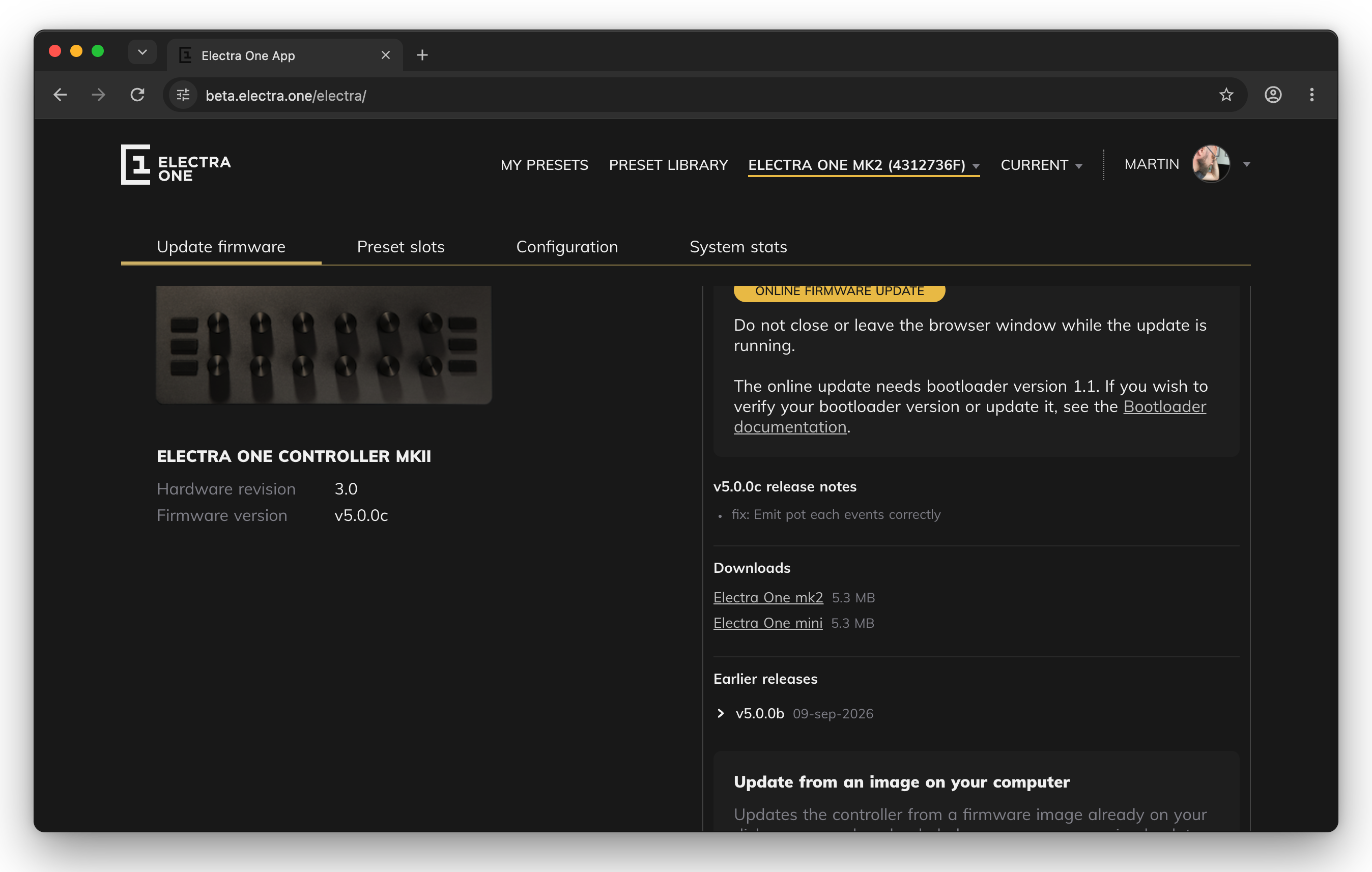

1. Get the firmware file ​
From firmware 5.0.0 on, the firmware files are published in the Electra One web application, not in this documentation. Open app.electra.one, go to CONTROLLER, and on the Update firmware tab take the image for the mk2 from the Downloads list under the release notes. Earlier 5.x versions are under Earlier releases.
Where the firmware files are
The Downloads list of the Update firmware tab, with the image for each model
Save it where you can find it again - it is the file the bootloader installs.

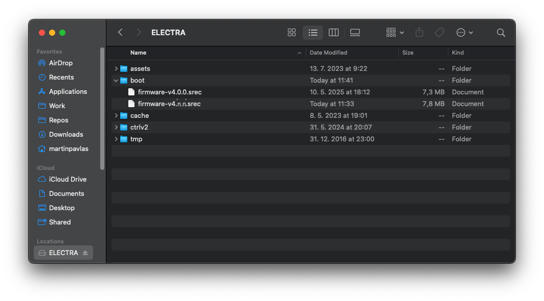

5. Copy the update file to the boot folder ​
Copy the file you downloaded in step 1 into the boot folder on the Electra One disk. This process may take a few moments to complete. Note: You may see other files already present in the boot folder — it’s perfectly fine to leave them there.

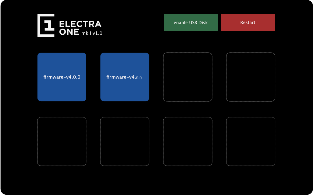

The bootloader will start, and the image you copied will appear in the list of available firmware images:
Firmware uploaded
8. Apply the update ​
Tap the blue tile with the name of the image to begin the update process.
