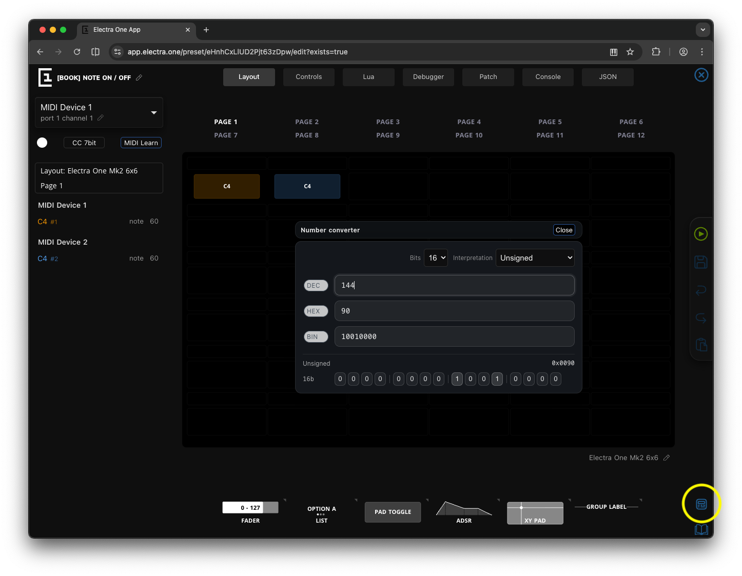

This is the part that can feel a little tedious. Working with bits and number conversions is not always the most exciting topic, especially in a book about music. Fortunately, you do not have to perform these conversions manually every time. The Electra One web editor includes a built-in Number Converter that makes working with binary, decimal, and hexadecimal values much easier. You can open it from anywhere in the editor by clicking the icon in the toolbar on the right side.
number system converter
Built-in number system converter

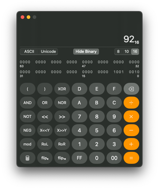

If you are using macOS, the Calculator application also provides a programmer mode that allows you to convert between number systems and perform calculations at the same time.
MacOs calculator
Calculator application on MacOs

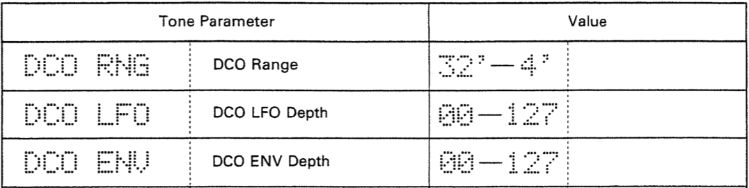

In MIDI documentation, decimal numbers are written the way we are familiar with from everyday life: 0, 12, 345, 1024. Decimal notation typically appears when displaying value ranges, discrete values, or commonly referenced parameters such as velocity, number of semitones, and similar quantities.
display mks-50
Decimal values in Roland MKS-50 manual
For the sake of simplicity, we will focus only on whole numbers here and leave fractions aside.

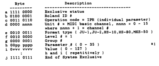

Binary maps directly to signal levels in electronic circuits. In MIDI documentation you will often find binary numbers in the sections that descibe MIDI messages, especially the SysEx data exchange.
midi mks-50
Binary values in Roland MKS-50 manual
