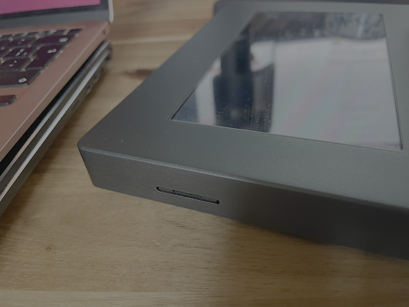

    • Newer models have an SD card slot on the left side of the controller’s body. Card in Gently push the card inward until it clicks and releases. Then pull it out. New slot

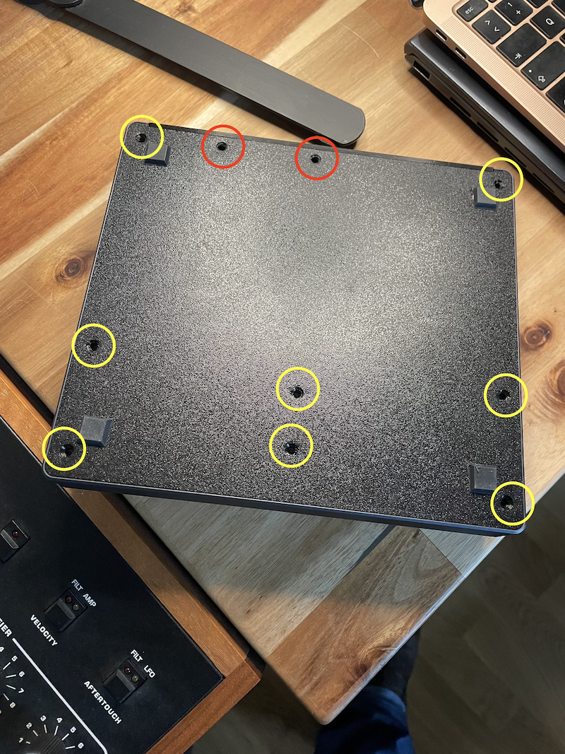

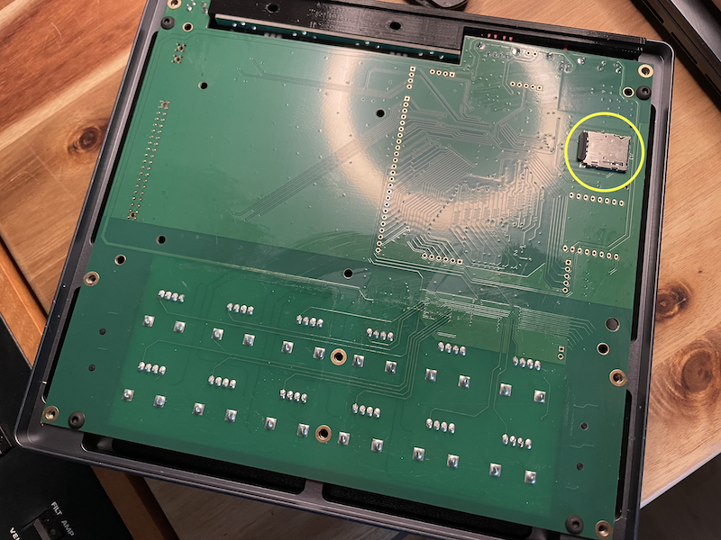

    • Older models have the SD card under the bottom plastic lid. To access it, remove the lid using a T6 hex key (Allen wrench). Tote, that the screws marked in red are longer. old screws Then carefully remove the card from the slot on the PCB - gently push the card inward until it clicks and releases. Then pull it out. old slot

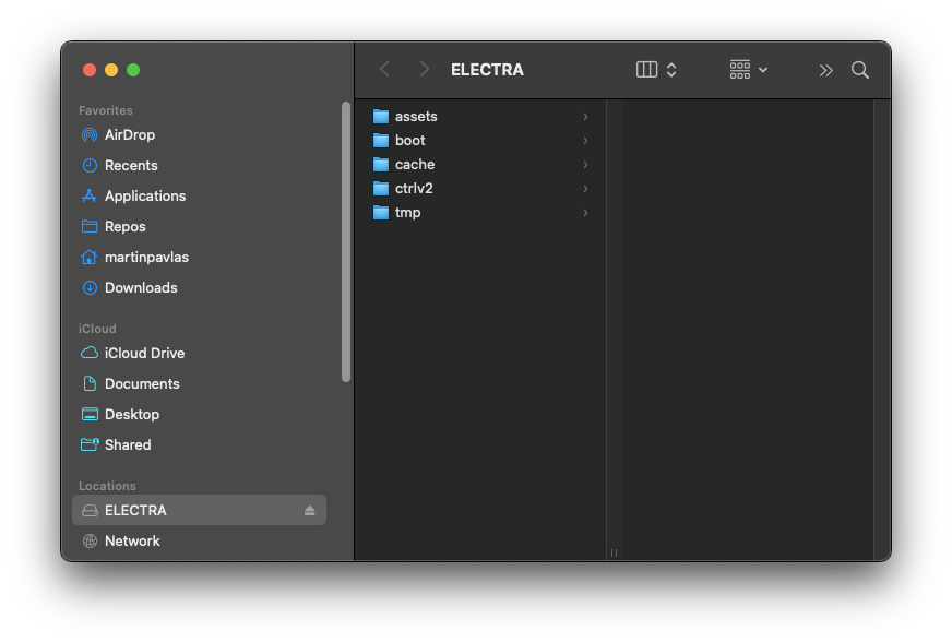

    Once the card is formatted, download the factory SD card image from the Downloads, unzip it, and copy the extracted files on the SD card. Once you are done, your SD card contents should look like this:
    After formatting, download the factory SD card contents from the Downloads page. Unzip the file and copy the extracted contents to the root of the SD card.
    Your SD card should look like this after copying:
    SD card contents
