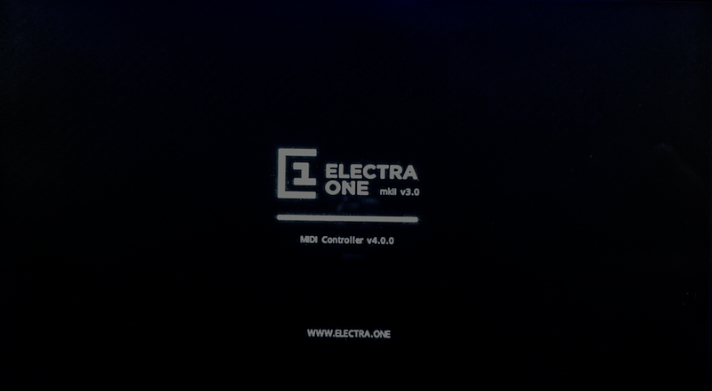

- Boot Failure: Electra One MIDI Controller gets stuck on the startup splash screen and fails to complete the boot sequence. The controller stays at the following screen:
If your Electra One controller is stuck during startup, it is often caused by a problematic preset or Lua script saved in the default preset slot (i.e. the last one used). This may happen if recent changes to the Lua script introduced a fatal error or an infinite loop. If you haven't edited any Lua code recently, the script file may have become corrupted for some other reason.

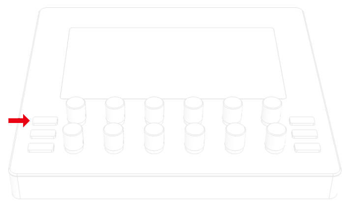

- Make sure your Electra One controller is powered off.
Press and hold the
[LEFT-TOP]button- Locate the
[LEFT-TOP]hardware button and press and hold it.
- Locate the
Power on the controller while holding the button
- While continuing to hold the
[LEFT-TOP]button, connect the USB cable to power the controller on.
