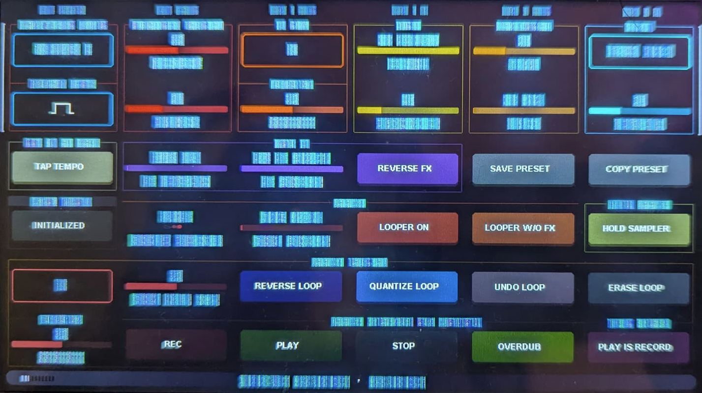

Text Fonts are unreadable
Symptoms
  • Font display issues - Fonts on the device screen appear broken or unreadable.
  • Unusual Screen Behavior - The display shows irregular patterns or characters not aligning properly.
Broken fonts
If you are experiencing any of these symptoms, it may indicate corruption of the graphical asset file located on the internal SD card. Follow the recovery procedure below to resolve the issue.

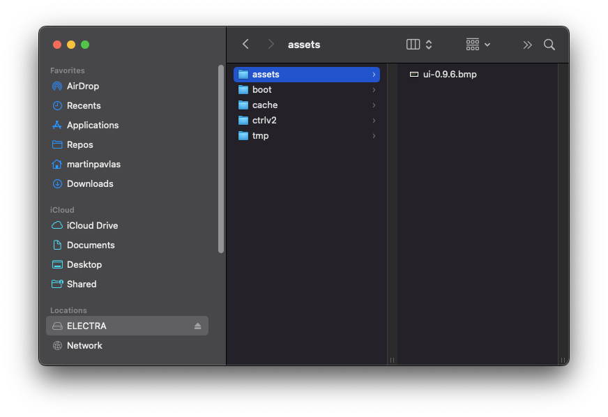

  7. Copy the UI toolkit file to the assets folder
    • Copy the ui-0.9.6.bmp file into the assets folder on the Electra One drive. If a file with the same name already exists, delete it first before copying the new one. Your assets folder should look like this: assets folder
  8. Safely ejact the disk
    • Close Finder (on macOS) or File Explorer (on Windows), and safely eject the Electra One drive.
