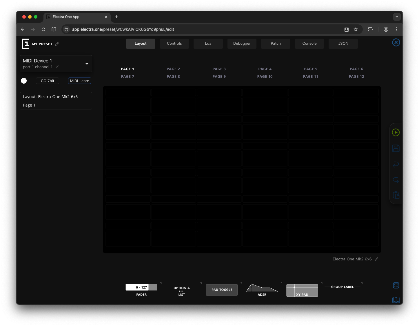

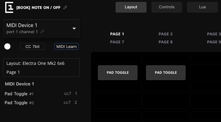

It is time for the first hands-on exercise. We will create a small project and use the MIDI Console to explore Note On, Note Off, and MIDI channels in a way you can see and hear immediately.
If you did not create a new project at the beginning of this chapter, do that now. You should be looking at a new, empty Electra One project, similar to this:
In the top-right corner of the editor, click on the preset name (it will most likely say My Preset) and rename it to Note On/Off. Giving your preset a meaningful name may seem like a small step, but it is a good habit—especially once your project list starts to grow.

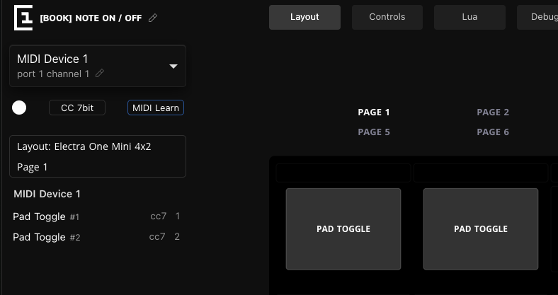

Next, we will add two PAD TOGGLE controls to the layout. Drag a PAD TOGGLE control from the repository at the bottom of the screen into the first slot of the grid. Then drag a second PAD TOGGLE control into the next slot beside it. When you are done, your layout should look similar to the image below.
If you are using an Electra One Mini, the preview will look slightly different because the Mini uses a 4×2 grid layout. The principle, however, is exactly the same.
From this point on, the demonstration will be shown on the Electra One Mk2. If you are working with the Mini, simply adapt the layout visually, the configuration steps remain identical.
At this stage, you have created two Pads on the layout. A Pad represents a simple On/Off control, and in this case it is configured as a toggle. That means each time you tap it, or press the corresponding encoder on the Mini, it switches between its two states. One state will send a Note On message, and the other will send the corresponding Note Off.
Take a moment to look at the left sidebar of the editor. It provides a brief summary of how the controls on the layout grid are configured. You should see that the first pad is currently assigned a Control Change message (cc7 #1), and the second pad is assigned a different Control Change message (cc7 #2). Both pads are set to use MIDI Device 1 on Port 1, and both are configured to MIDI Channel 1.
In other words, at the moment, both pads are sending Control Change messages to the same device on the same channel. That is not what we want for this exercise.

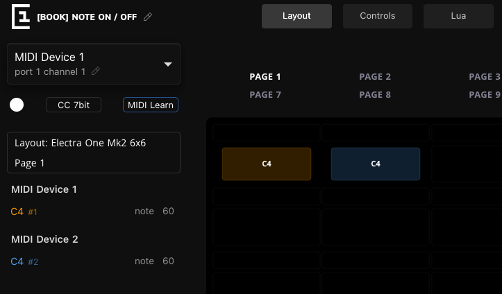

Let’s adjust the Pads so that they send Note messages instead of Control Change messages.
Click on the first pad in the editor. The Control editor will appear in the left sidebar, showing all configuration options for the selected control. Make the following changes:
- Change the name to C4 (instead of PAD TOGGLE).
- Select an orange color.
- Set Message Type to Note.
- Change the Note Number to 60 (which corresponds to C4).
Next, click on the second pad to configure it. Apply the following changes:
- Select a blue color.
- Change the MIDI Device to MIDI Device 2, using Port 1, Channel 2.
- Change the Note Number to 60 (C4).
When you are done, press Escape or click the Close icon at the top of the sidebar to hide the editor panel.
The layout should now look similar to this:
Take a moment to review what you have just done. Both pads now send the same note C4, but they are assigned to different MIDI devices and different channels. Although the musical note number is identical, the Status byte will differ because the channel information is encoded within it. In the next step, we will open the MIDI Console and observe exactly how this difference appears in the transmitted data.

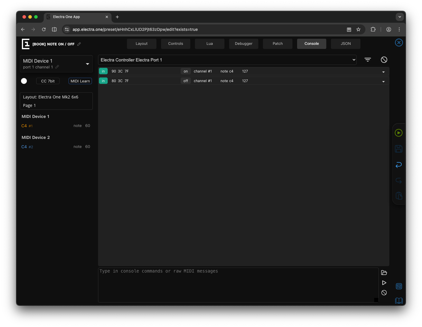

It is time to have some fun. Click the Play button to send the preset to the controller:
Open the MIDI Console by clicking the Console tab at the top of the editor. The Console is divided into two sections. The upper section is the monitor window, where you can observe incoming and outgoing MIDI data. The lower section is the data entry area, which allows you to send MIDI messages manually by typing them in.
With the MIDI Console open, tap the first (orange) Pad. The Pad will become highlighted, indicating that the note is currently active. Tap it again, and the highlight will disappear, meaning the note has been released.
Now look at the monitor window. You should see two new entries similar to the following:
These entries confirm that a Note On message was sent on MIDI Channel 1 when the Pad was activated, followed by a corresponding Note Off message when the Pad was deactivated. The MIDI Console allows you to see exactly what is happening behind the scenes - every tap of the Pad results in a precise sequence of bytes being transmitted.

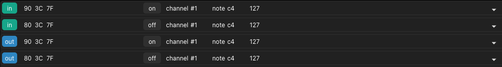

So far, we have observed the sending side of the Pad. Now let’s look at the receiving side.
In the Console’s data entry field at the bottom, type:
144 60 127If you have been following the previous chapters carefully, you already know what this means. The value 144 represents a Note On message on MIDI Channel 1. The number 60 corresponds to note C4, and 127 is the maximum velocity.
As soon as you press Enter, the orange Pad becomes highlighted. It has received a matching Note On message and switched to its active state.
Now type:
128 60 127and press Enter again.
The highlight disappears. You have just sent a Note Off message on MIDI Channel 1 for note 60, which deactivates C4.
What you have just demonstrated is an important concept: the Pad does not care whether the message originates from your finger or from the MIDI Console. It simply reacts to incoming MIDI data that matches its configuration. This is MIDI in its purest form—devices sending and receiving well, defined byte sequences that carry musical meaning.
The monitor will inform you about the outbound MIDI messages you just sent:

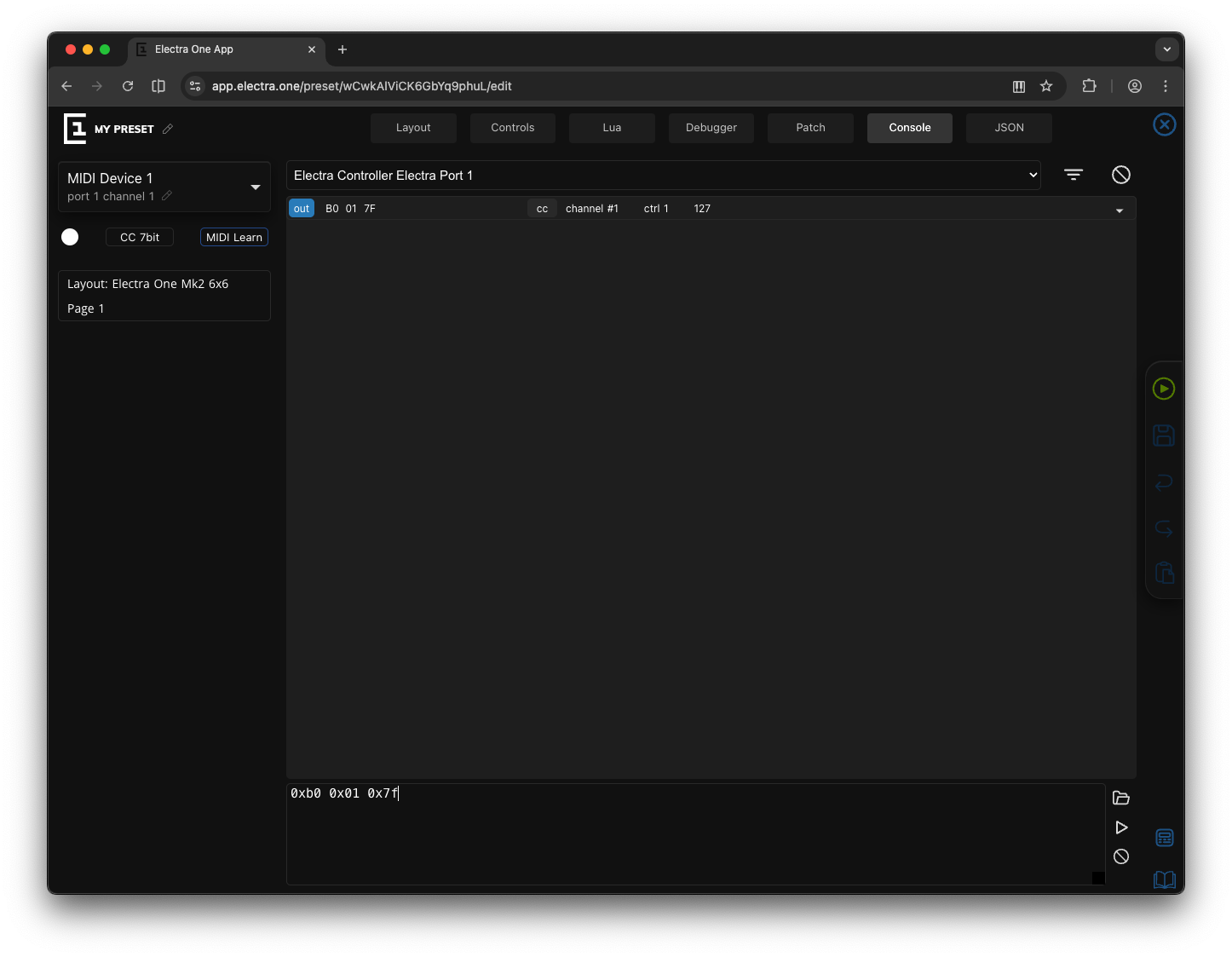

You are not limited to decimal notation. The MIDI Console also accepts hexadecimal values.
For example, the following message plays C4 at velocity 127 on Channel 1:
0x90 0x3C 0x7FNow try the same note on Channel 2. Notice how only the lower nibble of the Status byte changes. The message type (0x9_) remains the same, but the channel value increments from 0 to 1:
0x91 0x3C 0x7FThis should activate the blue Pad, because it is assigned to Channel 2.
To stop the note using the “Note On with velocity 0” technique, type:
0x91 0x3C 0x00The blue Pad will deactivate.
The MIDI Console also supports convenient text shortcuts for common message types. For example, you can type:
ch 2 on 60 127to play C4 on Channel 2 again.
To stop it, type:
ch 2 off 60 32And to stop C4 on Channel 1, use:
ch 1 off 60 32Take a few minutes to experiment. Try different velocities, try different channels, and observe how the Pads react. The more you play with it, the more natural the relationship between bytes and musical behavior will become.
If you would like a more detailed description of all MIDI Console features and shortcuts, refer to the User Guide.
Congratulations! You have completed the first exercise.
You now know how to use toggle Pads, assign MIDI devices and message types, and observe and send data using the MIDI Console. You have also seen how raw MIDI bytes translate into actual behavior on the controller.
Next, we will move on to Control Change messages.
