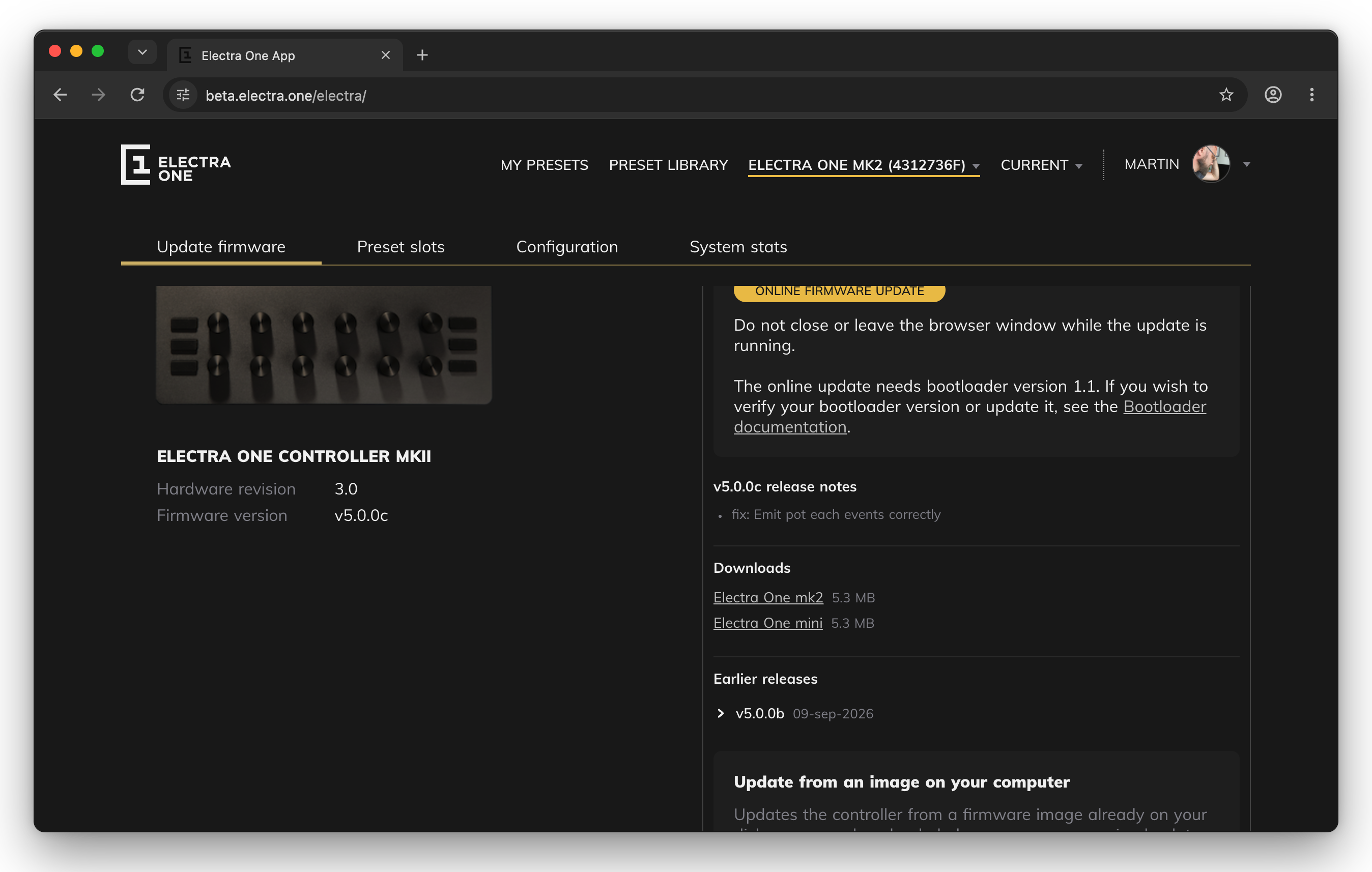

1. Get the firmware file
The firmware is not published on this site. It is in the app, beside the online update: open beta.electra.one, go to CONTROLLER, and on the Update firmware tab take the image for the mk2 from the Downloads list under the release notes. Earlier versions are under Earlier releases.
Where the firmware files are
The Downloads list of the Update firmware tab, with the image for each model
Save it where you can find it again - it is the file the bootloader installs.

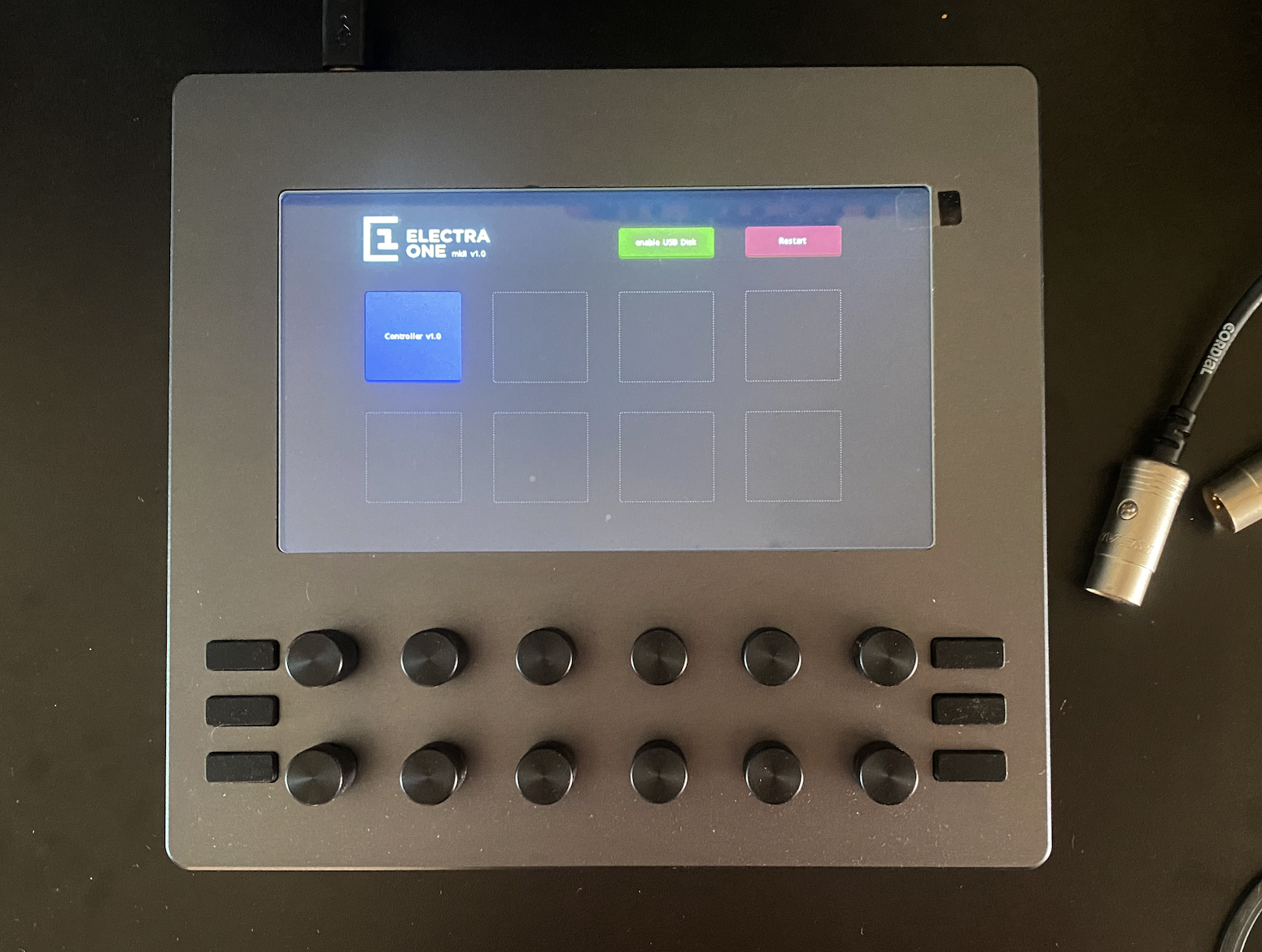

3. Switch to the bootloader mode
4. Enable the USB Disk option

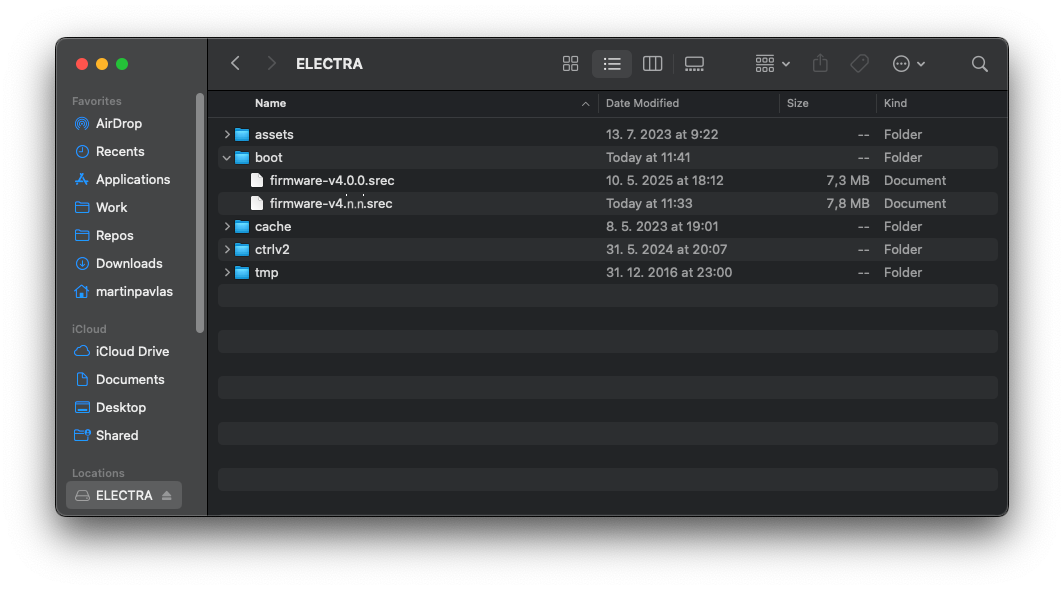

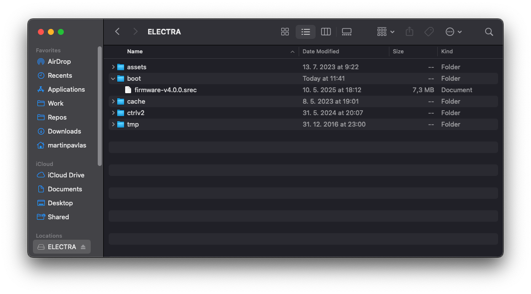

5. Copy the update file to the boot folder
Copy the file you downloaded in step 1 into the boot folder on the Electra One disk. This process may take a few moments to complete. Note: You may see other files already present in the boot folder — it’s perfectly fine to leave them there.

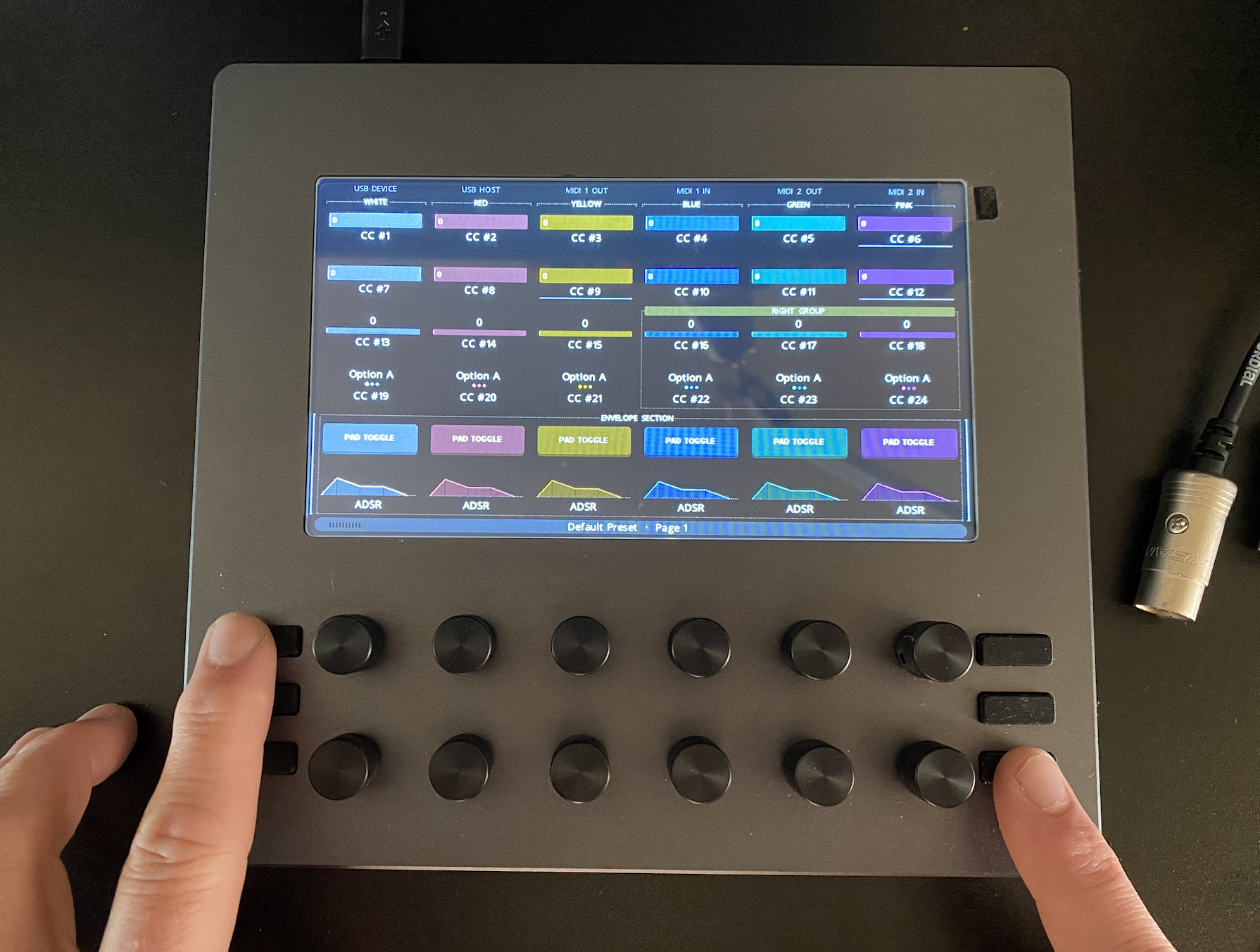

6. Restart the controller
7. Start the bootloader again

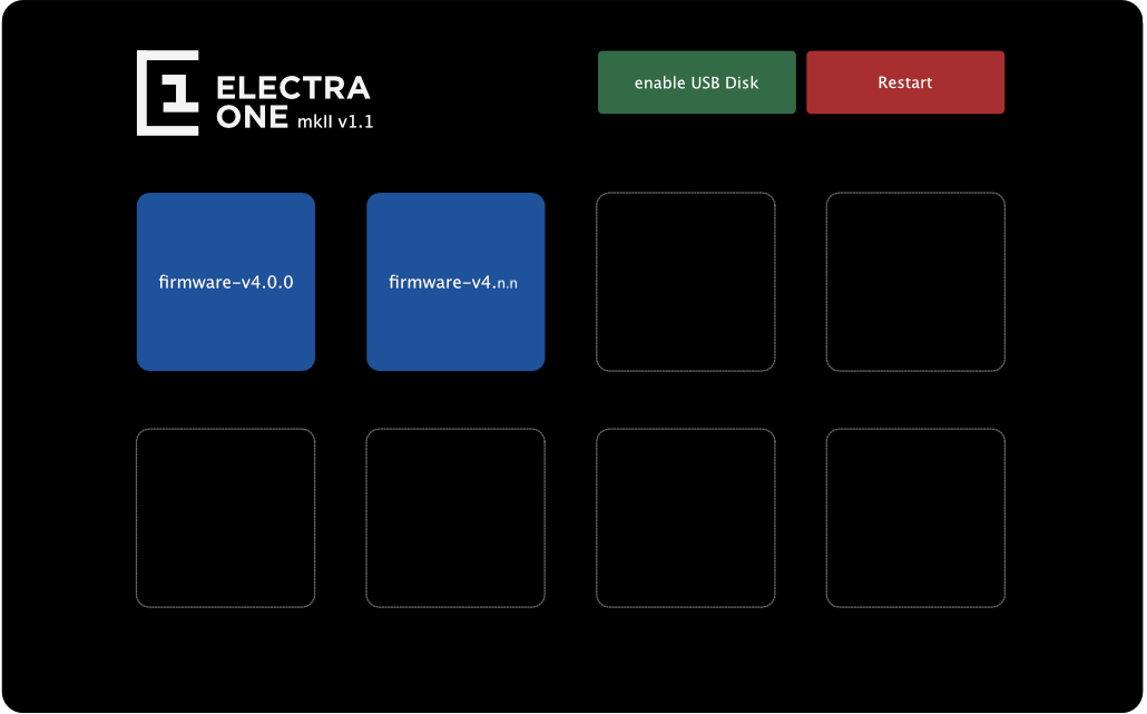

The bootloader will start, and the image you copied will appear in the list of available firmware images:
Firmware uploaded
8. Apply the update
Tap the blue tile with the name of the image to begin the update process.
