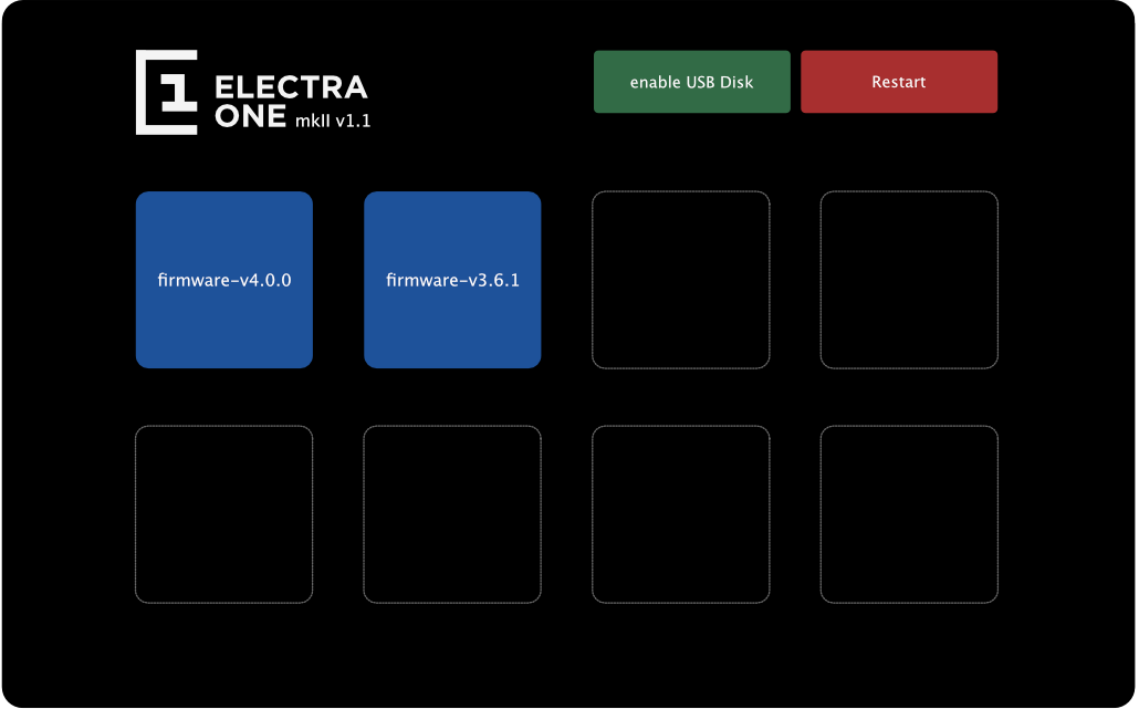

The bootloader screen is divided into two three sections:
  1. Bootloader version info
  2. On-screen Buttons
  3. Firmware images
Bootloader version
The bootloader version is shown at the top-left corner alongside the Electra One logo. It is important that you have the latest version of the bootloader installed. At present the most recent version is v1.1.
Electra front panel
On-screen Buttons
There are two buttons. One to enable the USB Disk Mode and the other to restart the controller.

Firmware images

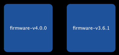

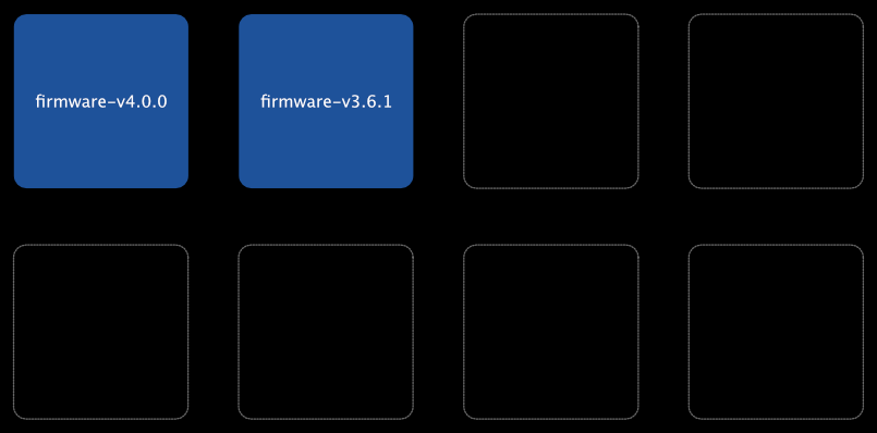

The Electra One bootloader supports up to eight firmware slots, allowing you to store and manage multiple firmware images on the controller at the same time. These can include the current version, older releases, beta builds, or even alternative firmware versions. You can switch between them at any time.

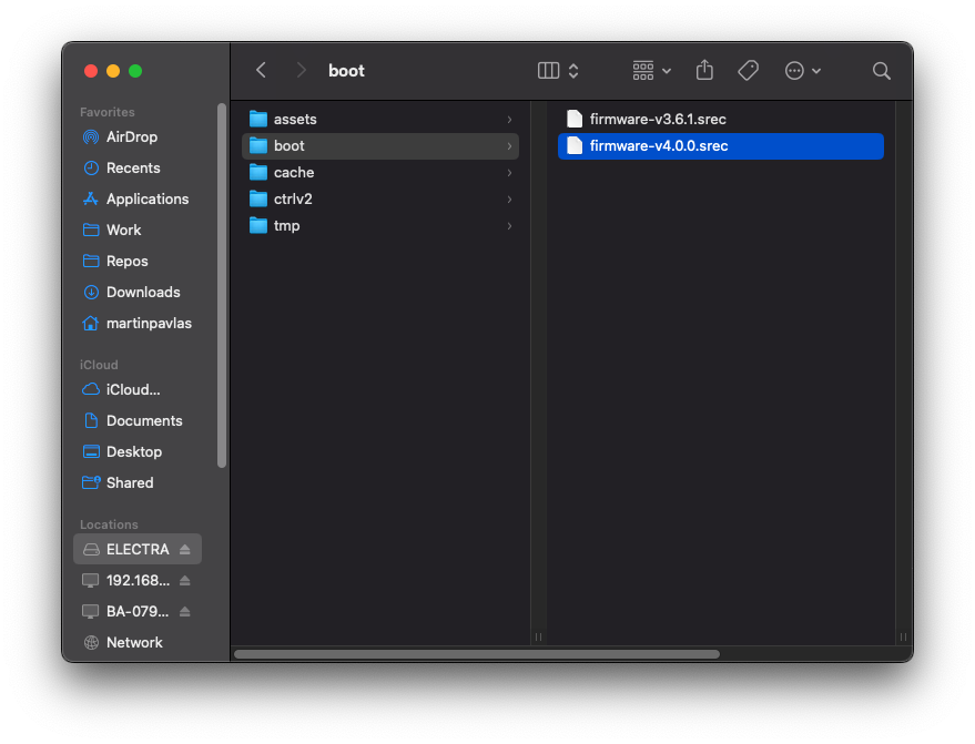

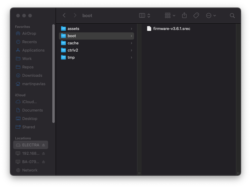

Each used slot corresponds to a .srec file located in the boot folder on the controller’s internal SD card:
  • Used slots are shown as blue tiles with the firmware filename.
  • Empty slots appear as grayed-out tiles.
A maximum of eight .srec files can be stored in the folder. Any additional files will be ignored by the bootloader and will not be shown.
To add, rename, or remove a firmware image, simply perform the corresponding action on the .srec file(s) in the boot folder on the internal SD card, either via USB Disk Mode or by accessing the SD card directly using your computer.
To flash (activate) a different firmware version:
  • Tap the tile of the firmware you want to use.
  • The update process will begin automatically.
Once complete, the controller will reboot and start running the selected firmware version.

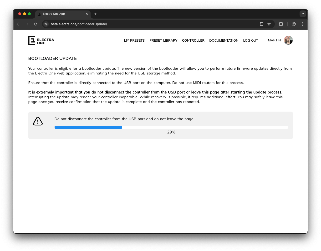

Occasionally, the bootloader itself needs to be updated. As of firmware 4.0.0, it is possible to update the bootloader using the app.electra.one web application.
If you purchased your Electra One before May 2025, your controller likely has bootloader version 1.0 installed. In that case, it is highly recommended to update the bootloader.
The bootloader version can be viewed on the bootloader’s main screen. It is displayed near the Electra One logo. For details, see the section Bootloader version.
Update procedure
To update the bootloader, follow the steps below:

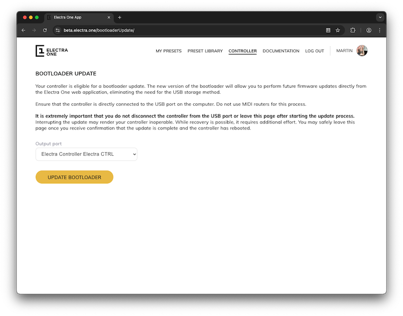

  1. Connect your Electra One directly to the computer that will be used for the update. Do not use a MIDI router or hub for this connection.
  2. Ensure that firmware version 4.0.0 or later is installed on your Electra One.
  3. Navigate to the Bootloader Update page on app.electra.one website. Bootloader update
  4. Carefully read the instructions provided on the Bootloader Update page to ensure everything is set up correctly.
  5. Make sure Electra’s control port is selected as the MIDI output port:
    • On macOS, it appears as Electra Controller Eletcra CTRL
    • On Windows, it appears as MIDIOUT3 (Electra Controller)
  6. Click the [Update bootloader] button on the page.

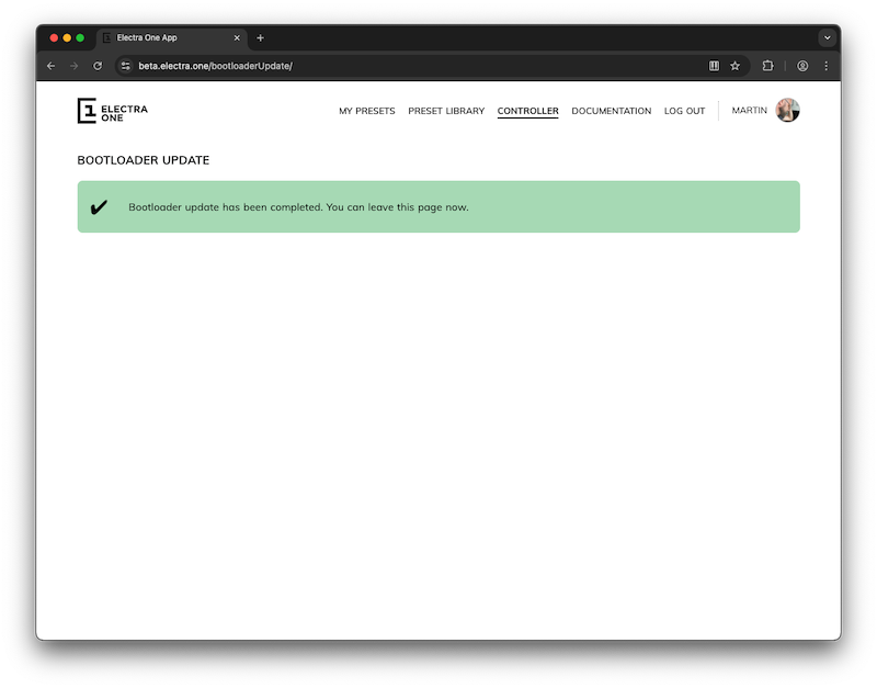

  7. Both the Bootloader Update web page and the Electra One controller screen will display progress feedback. The controller will restart automatically once the update is complete. Bootloader update progress
  8. The Bootloader Update page will provide confirmation that the update is completed. Bootloader updated
