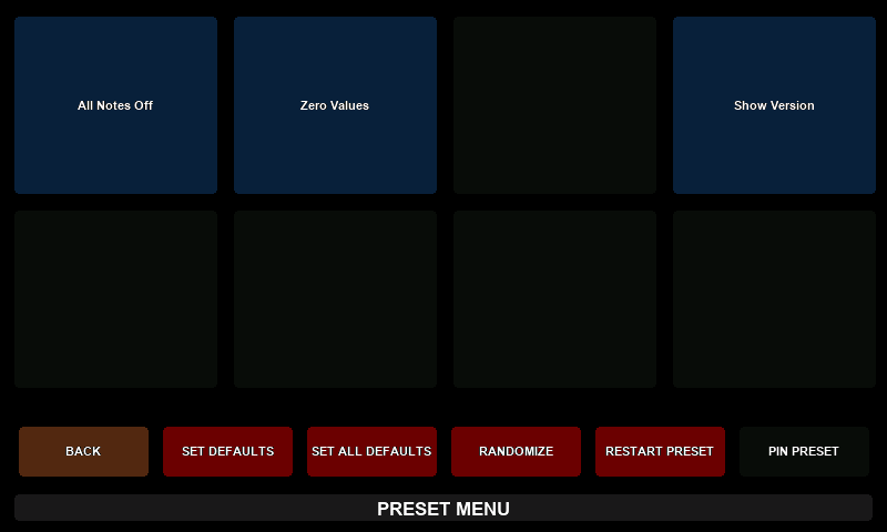

The Preset Menu collects actions for the current preset. The window is titled PRESET MENU, and the button that opens it is labelled FUNCTIONS.
The Functions window
The PRESET MENU of Poly Synth: three user functions on the pads, preset actions on the buttons
The buttons, from the left:
ButtonLabelWhat it does
[MENU]BACKcloses the window
[CONTEXT]SET DEFAULTSsets the controls that have a default value in the preset to that value. Other controls keep their values.
[BUTTON 1]SET ALL DEFAULTSsets every control to its default value
[BUTTON 2]RANDOMIZEgives every control a random value
[BUTTON 3]RESTART PRESETrestarts the preset
[BUTTON 4]PIN PRESETpins or unpins the preset
All of them except PIN PRESET close the window. They act as soon as you press the button, and there is no undo. SET DEFAULTS, SET ALL DEFAULTS and RANDOMIZE change every control of the preset, on all pages.

User Functions
The eight pads show user functions: actions that the preset's author has written in Lua, such as sending a special message to an instrument. Pads with a function are blue and show its name; the other pads are empty.
  • Press a knob to run the function on that pad.
  • Some functions close the window when they are done; others leave it open, so you can run them again.
A preset without user functions shows eight empty pads, and pressing the knobs does nothing.
User functions are defined in the preset's Lua script, in the preset.userFunctions table. On the Mini, the keys pot1 to pot8 belong to KNOB 1 to KNOB 8:
