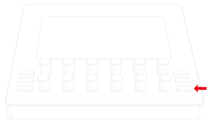

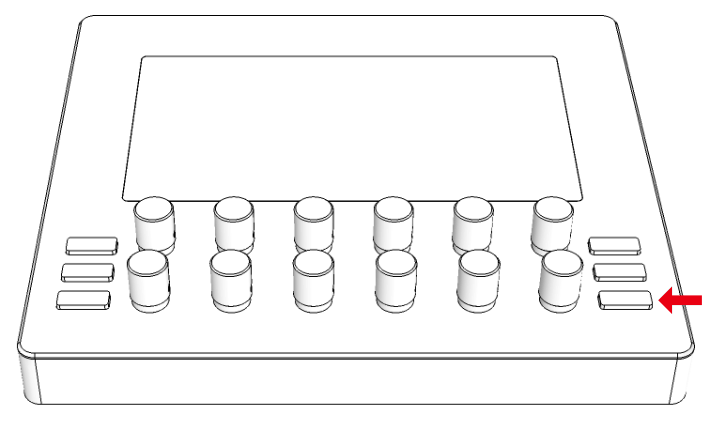

  3. Press and hold the [RIGHT-BOTTOM] button
    • Locate the [RIGHT-BOTTOM] hardware button on the controller and press and hold it. RIGHT-BOTTOMRIGHT-BOTTOM
