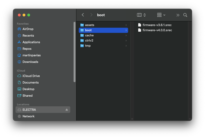

  6. Copy the latest firmware file to the boot folder
    • Download the lastest firmware file from the Downloads page.
    • Unzip the downloaded firmware file.
    • Copy the unzipped firmware-vx.x.x.srec file to the boot folder on the Electra One disk. boot folder
  7. Select a Firmware Image to Boot
    • Tap the blue tile that shows the name of the firmware file you just uploaded. The controller will then re-install the firmware using that file. Bootloader
