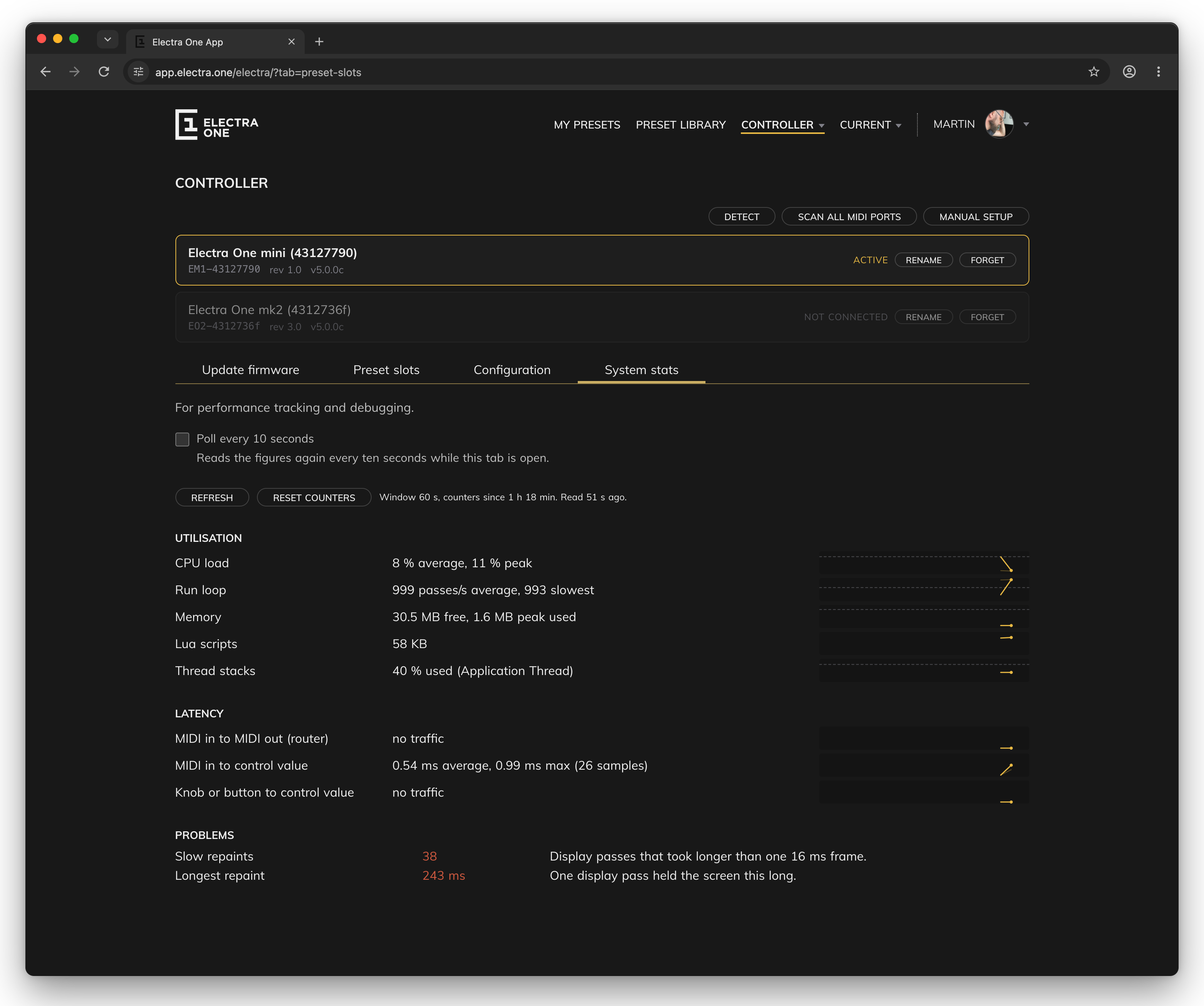

You can watch this on the controller. The System stats tab of the Controller page in the Electra One web application reads the runtime information the controller reports and shows the run loop as passes per second, the average and the slowest second, over the last window. A healthy controller sits near a thousand; a number well below it is the one sign of a starved application thread that MIDI itself cannot show. Next to it are the latencies from a MIDI message and from a knob to the Parameter Map, the memory a preset's Lua is holding, and a list of overruns that are all zero on a controller that is keeping up: timer ticks skipped, MIDI callbacks shed, parameter updates dropped, router packets dropped, slow repaints, and any queue that came close to full. When a preset feels late, look there before looking at the script. The Electra One Account chapter describes the tab row by row.
The System stats tab: the run loop, the latencies to the Parameter Map, and the overrun counters
