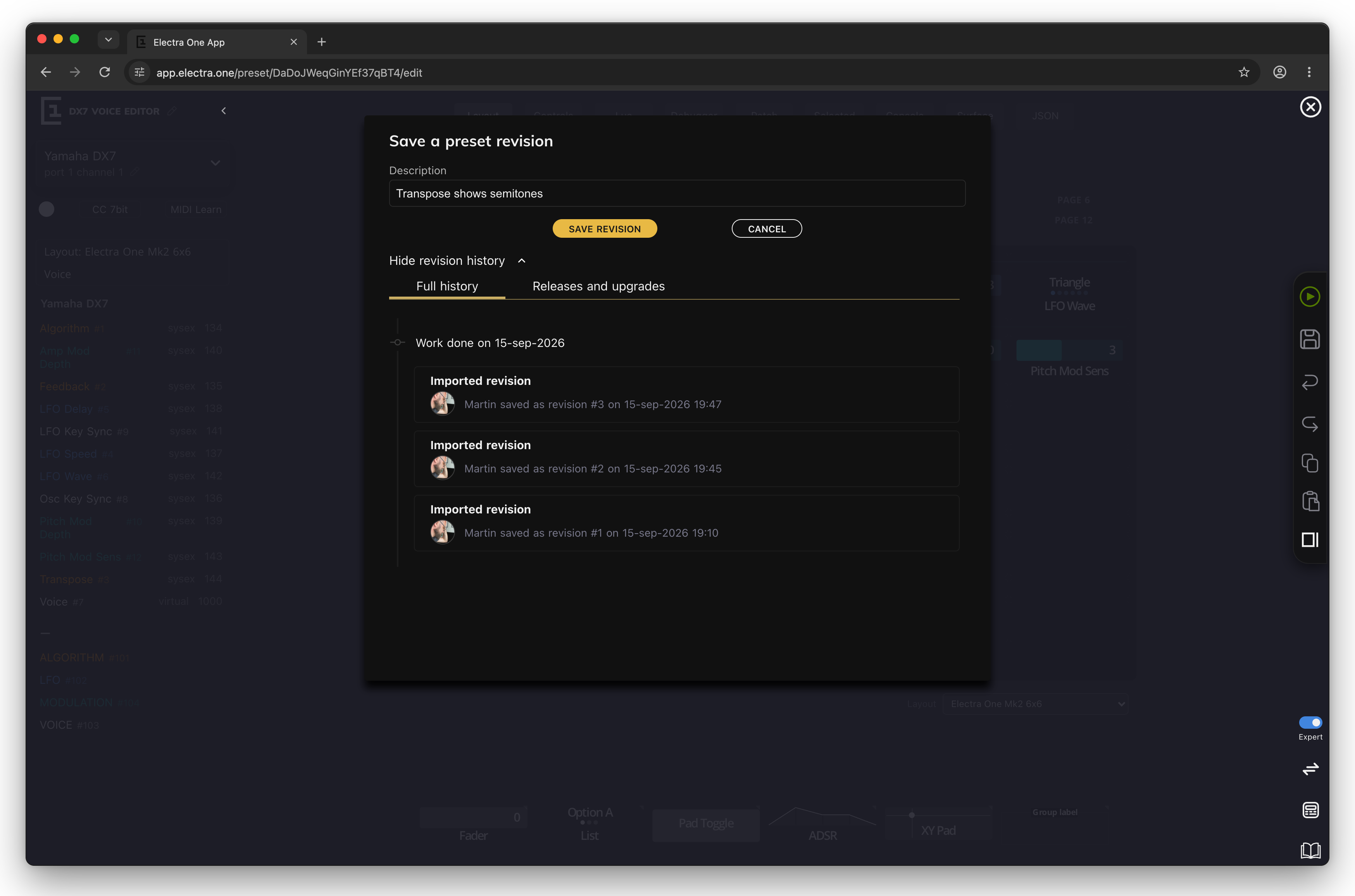

1. Saving, and saying why ​
Save in the editor opens a dialog asking for a short description. What you type there is the whole mechanism:
The save dialog
The save dialog: a description, and Save revision
  • Type a description and save, and the editor records a revision - a version you can come back to, with your sentence attached.
  • Leave it empty and save, and the preset is saved but no revision is recorded. The change is in the current version and nowhere else.
Think of the description the way a programmer thinks of a commit message: not what changed - the editor knows that - but why. "Cutoff on knob 3" is worth more than "changes", and takes the same three seconds.
You do not need one every time. Save without a description while you are fiddling, and write one when you reach something you would be sorry to lose.

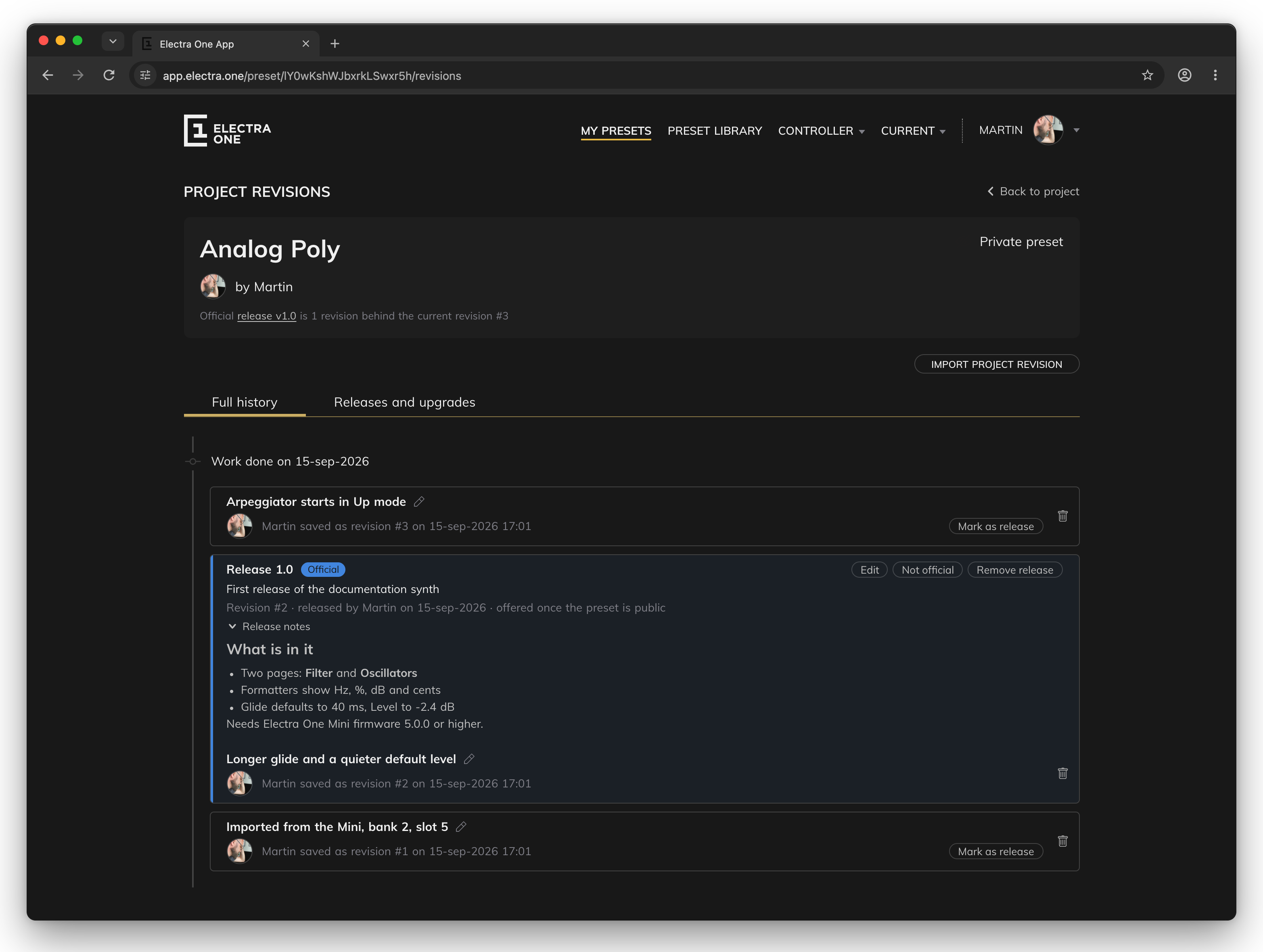

Open the history with browse project releases and revisions on the preset's page:
The history page
The history page: revisions newest first, grouped by day, one of them released
Two things here are worth the minute they take:
  • The pencil beside a description edits it. An automatic revision you recognise - that was the one where the envelopes came right - deserves a sentence. Click outside the field and it is saved.
  • The trash icon deletes a revision. Delete the automatic ones between the saves that matter and what is left is a history you can read. Deleting is confirmed first, the only revision of a preset cannot be deleted, and deleting the latest revision puts the preset back to the one before it - so that one is not simply tidying, it is undoing.
Tidy as you go, or set aside a few minutes at the end of a project. Either beats scrolling past forty identical lines a month later.

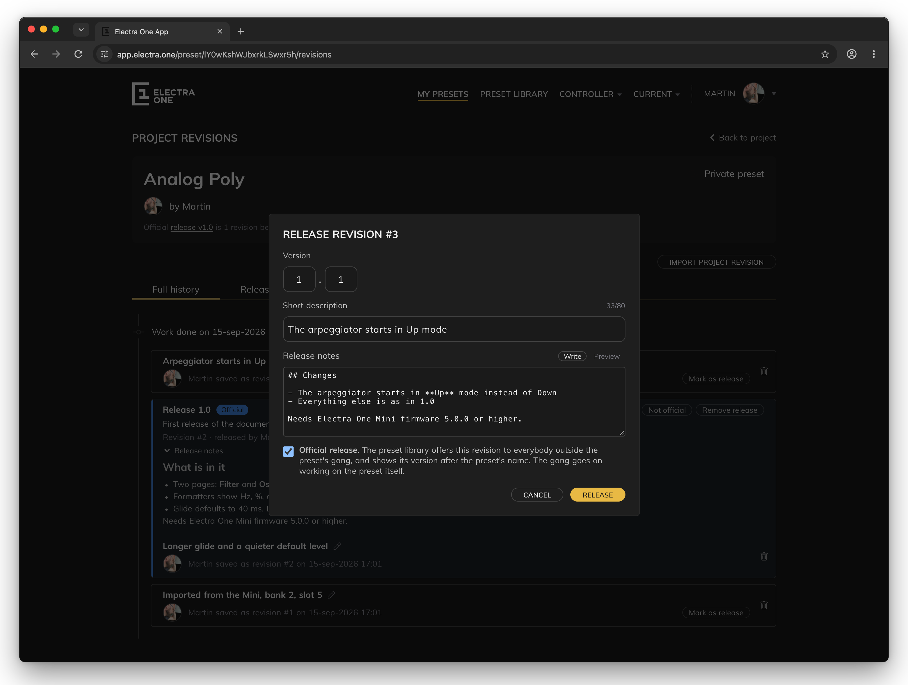

3. Naming a version ​
A release is a revision you have given a version number, like 1.0.0, with a short description and some notes. Mark as release on any revision opens the dialog:
The release dialog
The release dialog: version, short description, release notes, and the official release switch
The version numbers are yours to choose; the dialog suggests the next free one and asks only that they go up over time. The notes are Markdown, and Preview shows how they will look.
For a preset you keep to yourself, a release is a bookmark: 1.0.0 is the one you play live, and you can find it in a year.
For a public preset it is more than that. One release can be the official one, and the official release is what everybody else gets - what the Library shows, what SEND TO ELECTRA sends, what downloads contain. You always work on the latest version; everyone else stays on the official release until you say otherwise.
That is what lets you work on a published preset in daylight. Save fifty times, release when it is ready, and nobody downloading it in the meantime sees the half-finished middle.
A release is not automatic
After you make a release official, your later saves do not reach the Library. When a change should go to your users, mark the new revision as a release and make it official too. If a release turns out to be broken, make the previous one official again and everybody has the older version back at once.

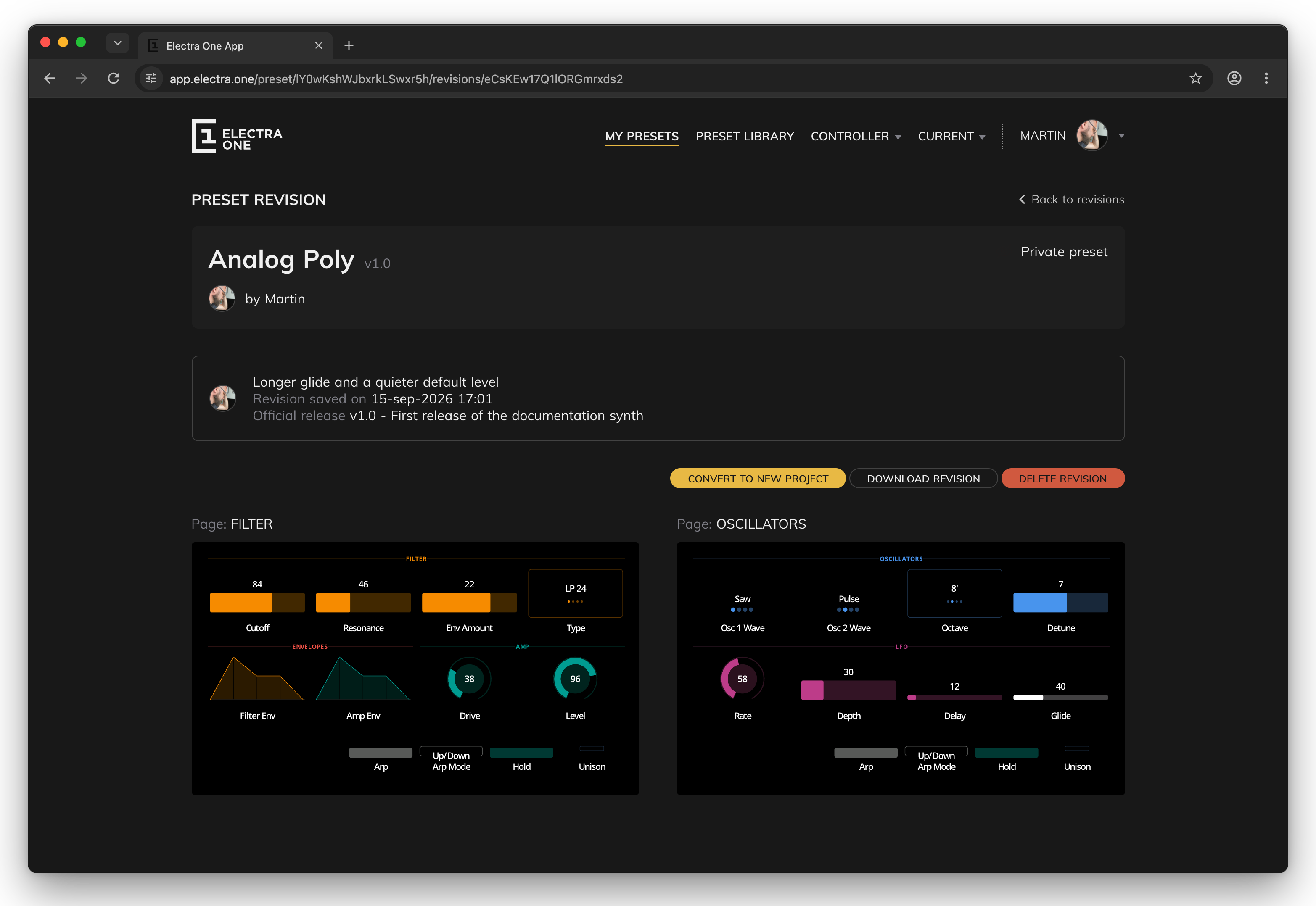

4. Going back ​
Click any revision to open its own page:
A revision
A revision page: its description, its pages, and the buttons to convert, download or delete it
You get three ways back, and they differ in how much they disturb:
  • DOWNLOAD REVISION saves it to your computer as a project file. Nothing changes online. This is the cautious one: look at it, send it to the controller, decide.
  • IMPORT PROJECT REVISION, on the history page, reads such a file back and makes it the preset's latest version, recorded as "Imported revision". Download then import is how you return a preset to an earlier state without losing anything: the versions in between stay in the history.
  • DELETE REVISION on the latest revision rolls the preset back one step. It is the blunt one, and the only one that throws something away.
