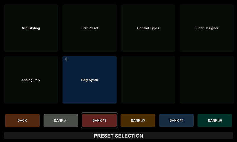

Preset selection ​
Presets are stored in slots on the controller. The Mini has five banks of eight slots each, 40 slots in all. Each slot is empty or holds one preset.
Press [MENU], then PRESETS.
PRESET SELECTION showing bank 2. Poly Synth is the current preset
The eight pads show the slots of one bank, arranged like the knobs, with the names of the presets in them.
  • Press a knob to load the preset in that slot. The window closes and the preset's page is shown.
  • The current preset, the one you are working with, is highlighted in blue. It is highlighted only when its bank is shown. The window opens on the bank you looked at last.
  • A small icon in the top-left corner of a pad marks a preset that is running. A pin icon in the top-right corner marks a pinned preset, which keeps running in the background.
The buttons choose the bank:
ButtonLabel
[MENU]BACK – closes the window
[CONTEXT]BANK #1
[BUTTON 1]BANK #2
[BUTTON 2]BANK #3
[BUTTON 3]BANK #4
[BUTTON 4]BANK #5
The button of the bank on screen has a light outline. The banks have a colour each, and you can give them names and colours of your own in the Electra One app; see Preset Banks. The names then appear on the buttons.
BACK returns to the preset page, not to the menu. This is true for every window opened from the menu.
Putting a new preset into a slot, and what happens to the files of the preset that was there, is described in Changing and Loading presets.

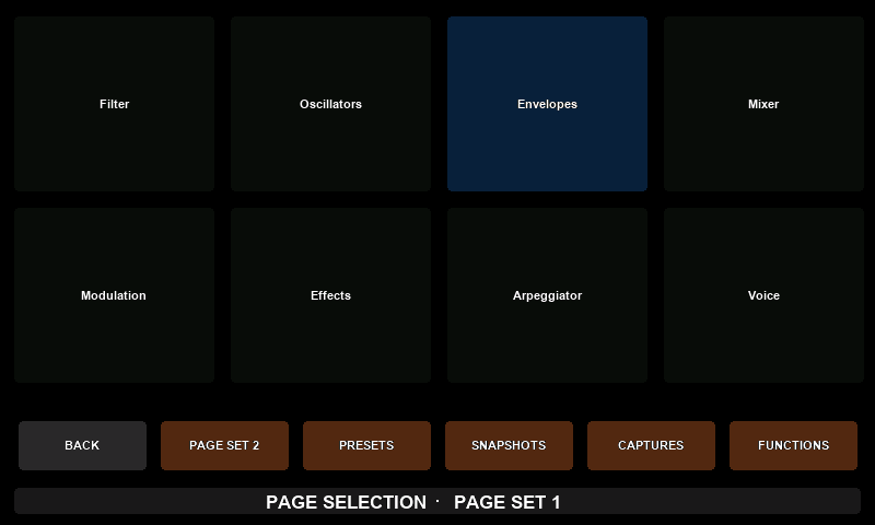

Page selection ​
Page selection, page set 1
PAGE SELECTION showing page set 1 of the Poly Synth preset. The Envelopes page is the current page
The eight pads show the pages of the current page set, arranged like the knobs. The pad of the current page is highlighted in blue. When you touch a knob, its pad lights up, so you can check your choice before pressing.
  • Press a knob to show that page. The menu closes.
  • A pad without a name has no page, or its page has no controls or is hidden by the preset. Pressing its knob closes the menu, and the current page stays on the screen.
The buttons, from the left:
ButtonLabelWhat it does
[MENU]BACKcloses the menu
[CONTEXT]PAGE SET 2 / PAGE SET 1shows the other page set
[BUTTON 1]PRESETSopens preset selection
[BUTTON 2]SNAPSHOTSopens the Snapshots window
[BUTTON 3]CAPTURESopens the Captures window
[BUTTON 4]FUNCTIONSopens the Preset Menu

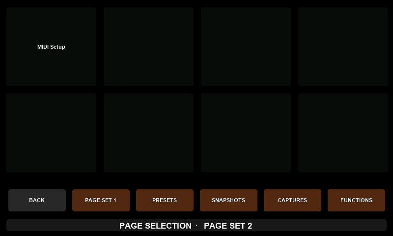

Page sets ​
A Mini preset has up to 16 pages, but the menu has only eight pads. Pages 1 to 8 form page set 1, pages 9 to 16 page set 2. The bottom bar shows which set you are looking at, and [CONTEXT] is labelled with the set it switches to.
Page selection, page set 2
Page set 2 of the same preset: page 9, MIDI Setup, is its only page
When you open the menu, it shows the set of the current page, or the set you switched to the last time you had the menu open.

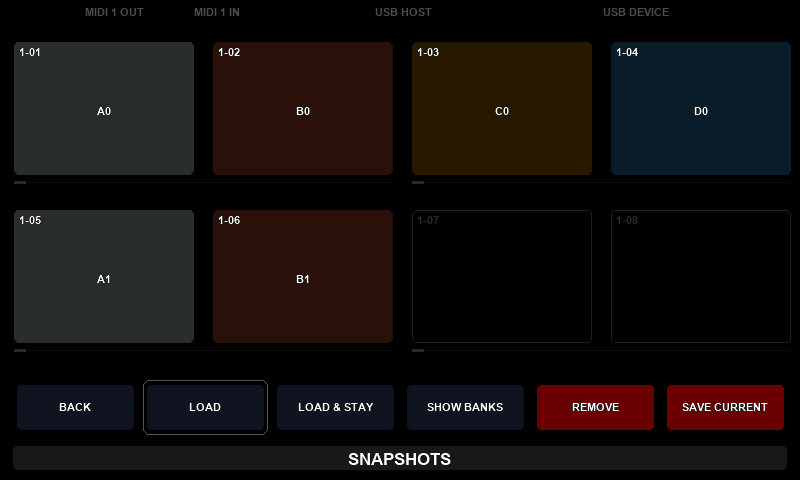

The Snapshots window ​
Press [MENU], then SNAPSHOTS. You can also assign Open snapshots to a button; it is on [BUTTON 4] of the Controller context by default.
Bank 1 of the Poly Synth preset with six snapshots. LOAD is the selected mode
The eight pads are the slots of one bank, arranged like the knobs. Each pad shows its bank and position in the top-left corner, for example 1-05 for the fifth slot of bank 1. A slot with a snapshot is filled with the snapshot's colour and shows its name; an empty slot is only outlined.
Under each pair of slots is a thin line: the morph slider of that pair. See Morphing.
[MENU]BACKcloses the window
[CONTEXT]LOADmode: pressing a knob loads the snapshot and closes the window
[BUTTON 1]LOAD & STAYmode: pressing a knob loads the snapshot, and the window stays open
[BUTTON 2]SHOW BANKSopens the bank selection
[BUTTON 3]REMOVEmode: pressing a knob deletes the snapshot
[BUTTON 4]SAVE CURRENTmode: pressing a knob saves the current values into the slot
LOAD, LOAD & STAY, REMOVE and SAVE CURRENT are modes: the selected mode has a light outline and decides what pressing a knob does. The window always opens in LOAD mode.
Saving a snapshot ​
  1. Set the controls to the sound you want to keep.
  2. Open the Snapshots window and press SAVE CURRENT.
  3. Press the knob of a slot.
The current values are saved into the slot at once. If the slot already holds a snapshot, it is replaced without asking.
A new snapshot is named after its position in the grid: the letter is the column and the number is the row, so the top row is A0 to D0 and the bottom row A1 to D1. Its colour also follows the column. You can rename and recolour snapshots in the Electra One app, in the Snapshots tab of the preset.
A snapshot keeps the values of the controls that send MIDI. Controls that send nothing are not included.
Loading a snapshot ​
  1. Open the Snapshots window. It opens in LOAD mode.
  2. Press the knob of the snapshot.
The controls take the values of the snapshot and send them to your instruments. In LOAD mode the window closes. In LOAD & STAY mode it stays open, so you can try one snapshot after another.
Pressing the knob of an empty slot changes no values. In LOAD mode the window closes all the same.
Removing a snapshot ​
Press REMOVE, then the knob of the snapshot. The snapshot is deleted at once, without asking.

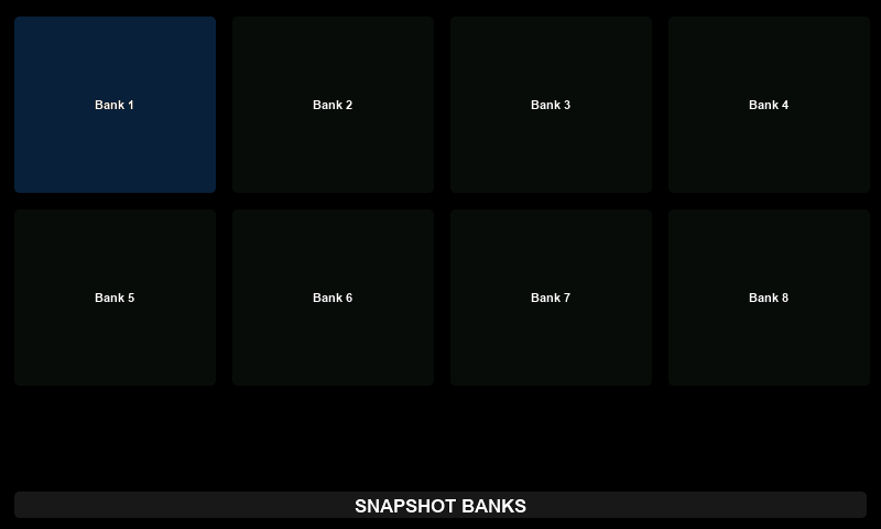

Banks ​
Press SHOW BANKS to choose another bank.
Snapshot banks
SNAPSHOT BANKS: the current bank is highlighted in blue
The eight pads are the eight banks. Press a knob to show that bank; you return to the Snapshots window in LOAD mode. Press any button to return without changing the bank.
Banks are named Bank 1 to Bank 8 until you give them names in the Electra One app.

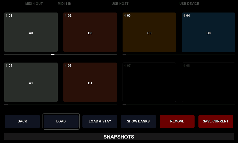

Morphing ​
The eight slots form four pairs: slots 1 and 2, 3 and 4, 5 and 6, and 7 and 8. Each pair has the knobs of its two slots:
  • The left knob of a pair morphs: it blends the values of the two snapshots. Turned fully one way you hear the left snapshot, fully the other way the right snapshot, and in between a mix of the two.
  • The right knob of a pair randomizes: each control gets a random value between its values in the two snapshots. The further you turn, the wider the range.
When you touch a knob of a pair, the slider under the pair lights up, and it shows the position of the morph.
Morphing a pair
KNOB 1 is touched and turned: the slider under A0 and B0 shows the position between the two snapshots
Both slots of the pair need a snapshot; otherwise turning the knobs does nothing. Pressing the knobs still works as the mode says, so a morph can be saved: press SAVE CURRENT and press the knob of a free slot.
How morphing and randomization treat each control is explained, with diagrams, in Morphing and Randomization.

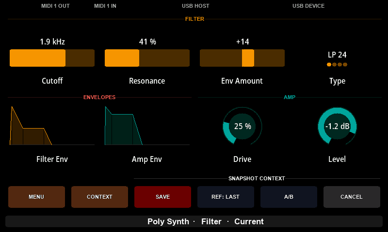

The snapshot tool bar ​
The snapshot tool bar saves variations of a sound one after another, and lets you compare them with the sound you started from.
  1. Open the Snapshots window and press SAVE CURRENT.
  2. Hold the knob of a slot for one second. A snapshot already in it is replaced.
The current sound is saved into that slot, the window closes, and the four buttons become the SNAPSHOT CONTEXT:
The SNAPSHOT CONTEXT after holding slot 7
[BUTTON 1]SAVEsaves the current sound into the next slot of the bank, replacing a snapshot that is there. After the last slot of the bank, the label is RETAKE: pressing it saves nothing, and the next SAVE writes the first slot after the one you held again.
[BUTTON 2]REF: LAST / REF: FIRSTchooses what A/B plays: the variation you saved last, or the slot you held
[BUTTON 3]A/Bswitches between the reference and your current sound. Press it to hear the reference, and again to return to your sound as you left it.
[BUTTON 4]CANCELends the session. The saved snapshots stay, and the controls keep the values they have.
If you hold the last slot of a bank, the session uses the slots before it, from the first slot of the bank.
Your current sound is whatever you are working on, saved or not. If you turn a knob while A/B plays the reference, the changed sound becomes your current sound, and the next A/B keeps it and plays the reference again.
The bottom bar shows what you are hearing after the preset and page names: A0 First or D3 Last while A/B plays the reference, and Current otherwise. Each save is confirmed there for about two seconds, for example Snapshot D0 saved.
SAVE saves whatever you hear, so pressed while A/B plays the reference, it saves the reference with any changes you made to it. CANCEL leaves the values as they are: press A/B again before CANCEL to return to your sound. Loading another preset, or opening the Snapshots window again, also ends the session.
While the tool bar is active, the knobs work as usual, so you can shape the sound and save it with SAVE every time you like what you hear. [CONTEXT] hides and shows the tool bar, so you can reach the preset's controls on the buttons in between.

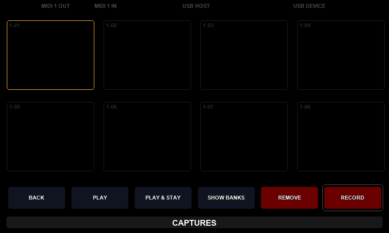

Recording a capture ​
  1. Open the Captures window and press RECORD.
  2. Press the knob of a slot. The slot gets a yellow outline: it is armed.
  3. Play. The recording starts with the first MIDI message that arrives. MIDI clock alone does not start it.
  4. Press the same knob again, or press RECORD, to stop. The capture is saved into the slot.
An armed slot
Slot 1-01 is armed and waits for the first MIDI message
The window stays open while you record, and you can close it with BACK: the recording goes on. When you open the window again, it is in RECORD mode with the slot still armed, and pressing its knob stops the recording.

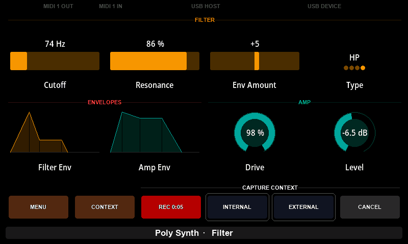

Recording with the capture tool bar ​
The capture tool bar lets you record while the preset page is on the screen, so you can record the moves you make on the controls.
The window closes, and the four buttons become the CAPTURE CONTEXT. Nothing is recorded yet: MIDI that arrives before you press RECORD is discarded.
[BUTTON 1]RECORDstarts recording at once. While it records, the label shows the time, such as REC 0:05. Press it again to stop: the capture is saved, the tool bar closes, and the bottom bar shows Capture A0 saved for about two seconds.
[BUTTON 2]INTERNALrecords the messages the Mini sends itself: your knob moves and button presses. Lit when on.
[BUTTON 3]EXTERNALrecords the messages that arrive at the Mini. Lit when on.
[BUTTON 4]CANCELstops without saving and closes the tool bar
Recording with the tool bar
The CAPTURE CONTEXT while recording: REC 0:05, with both INTERNAL and EXTERNAL on
With the tool bar, the recording starts when you press RECORD, not with the first message. [CONTEXT] hides and shows the tool bar.
INTERNAL and EXTERNAL stay as you set them for later recordings, also those started by a knob press, until the controller restarts.
When you press RECORD while other captures are playing, the recording starts in time with them, ends on a whole number of their bars, and is saved as a loop.

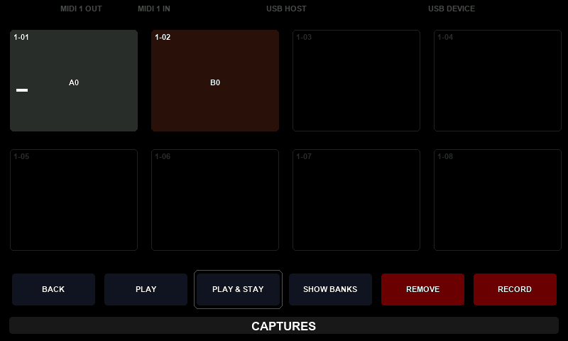

Playing a capture ​
  1. Open the Captures window. It opens in PLAY mode; press PLAY & STAY if you want to start several captures.
  2. Press the knob of a capture.
A capture playing
PLAY & STAY mode: A0 is playing, and the bar in its slot shows how far it has played
A white bar in the slot shows how far the capture has played.
  • Pressing the knob of a playing capture that loops stops it.
  • Pressing the knob of a playing capture that does not loop starts it again from the beginning. It stops by itself at its end.
Up to eight captures can play at the same time. A capture started while others are playing waits for the next bar of the capture that started first, so they stay in time. The Mini's Captures window has no button that stops all playback; stop looping captures with their knobs.
Whether a capture loops, the port it plays to and whether it follows MIDI clock are set in the Electra One app.
