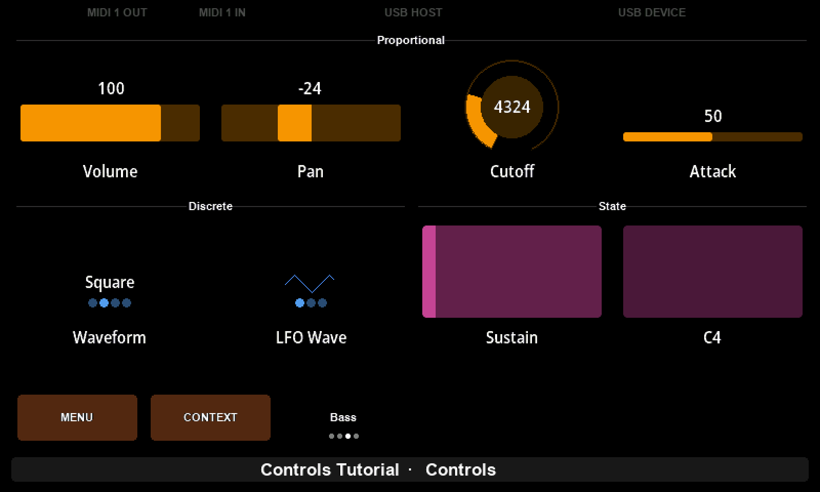

Here is where we are going. Eight controls on the knobs, one on a button, and a label over each family:
The finished page
The finished preset on an Electra One Mini

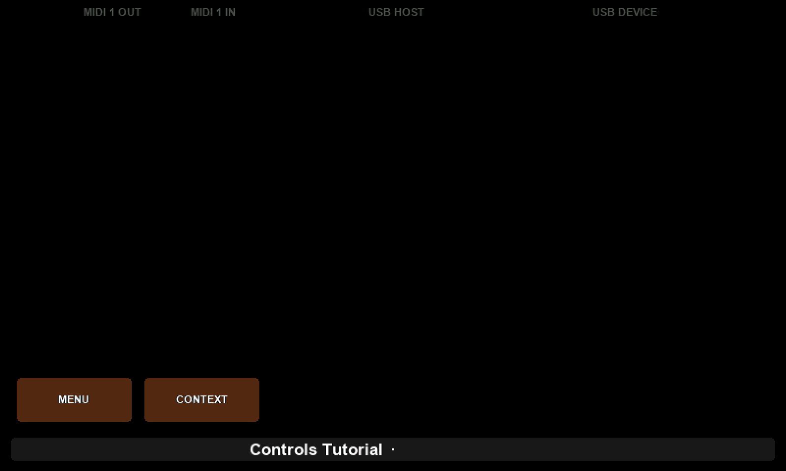

1. An empty preset ​
Go to WORKSPACE and click CREATE PROJECT - with the controller connected, so the preset is made for the model you have. Click the pencil by MY PRESET in the top-left corner and name it Controls Tutorial, then hover over PAGE 1, click its pencil, and name the page Controls.
Leave the editor in Basic mode; nothing here needs Expert. Put the Layout tab and the Console tab side by side in split view, so you can build controls and watch their messages at once. Then click Send to Electra.
An empty preset on the Mini
The Mini with the empty preset loaded: a name along the bottom and nothing else
An empty preset really is empty: no controls, and no MIDI device either. The first control you drop brings one with it.

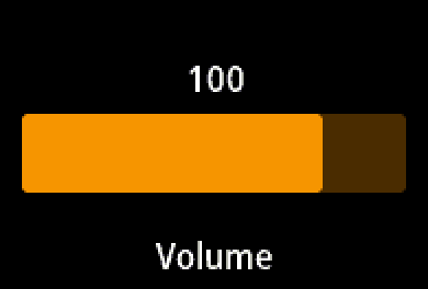

The plainest control there is: a range from 0 to 127, sent as Control Change 7, the controller number instruments have used for volume since MIDI began.

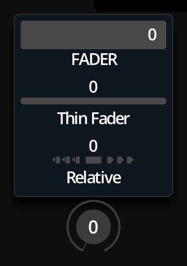

Find the faders tile in the repository under the screen. On the Mini it shows the Dial first, so click its little triangle to open the variants and pick Fader, the full-size bar. Drag it onto the top-left slot, which belongs to KNOB 1. Select it, name it Volume, colour it orange, and in the VALUE section type 7 into Parameter. Send, and turn the knob.
The faders tile opened
The faders tile with its variants open: Fader, Thin Fader and Relative above the Dial
Volume on the Mini
The Volume fader at 100
The bar follows your hand and the console fills with cc 7 … on channel 1. Notice what you did not type: Min and Max, the range you see, and MIDI Min and MIDI Max, the range that is sent, all start at 0 and 127. For a plain CC parameter that is already right.

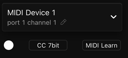

Your fader also arrived knowing three things you never told it: which instrument to talk to, what colour to be, and what message to send. All three come from the sidebar - the selected device, which is the port and channel, and the colour dot and message type below it. Set them before you drag and every control arrives the way you want it.
The device and the defaults row
The selected device above the defaults row: a colour, a message type and MIDI Learn

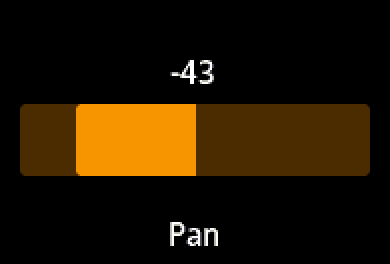

3. Pan, where the two numbers part company ​
This is the idea the rest of the tutorial rests on.

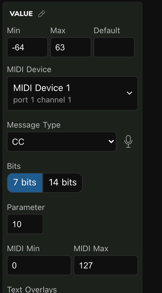

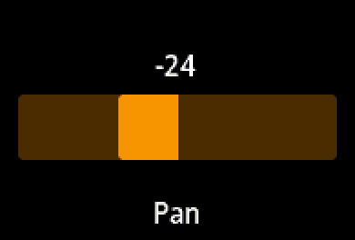

Pan is sent as 0 to 127, the same as volume: 0 hard left, 64 centre, 127 hard right. But nobody thinks about panning that way. A musician thinks "20 to the left", and a control that says -20 is far easier to read than one that says 44. So a control keeps two numbers - the display value on the screen, and the MIDI value in the message - and maps one onto the other in a straight line, in both directions.

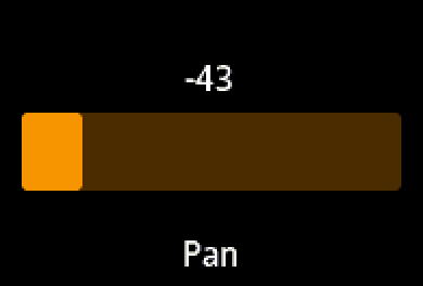

Drag another Fader onto KNOB 2, name it Pan, colour it orange, and set Parameter 10, Min -64, Max 63. Leave MIDI Min and MIDI Max at 0 and 127. Send, and sweep the knob end to end.
Pan on the Mini
Pan reading -24
Pan's value card
Pan's value card: Min and Max at the top, MIDI Min and MIDI Max at the bottom
The card holds both ranges: Min and Max at the top, MIDI Min and MIDI Max at the bottom, with the message between them. The Mini shows one number and the console shows another:

Both ranges are 128 values wide here, so each step of the knob is one step of the MIDI value and the sum is simply "add 64". That is a happy accident of this particular pair of ranges. The rule underneath is: the display minimum sends the MIDI minimum, the display maximum sends the MIDI maximum, and everything between is spread evenly and rounded.

Look at Mode in the control card. It says Bipolar, which is why the bar grows out of the middle: a bipolar fader draws from zero, right for positive values and left for negative ones. Switch it to Unipolar, send again, and the value has not changed, nor the message - only the picture.
BipolarUnipolar
Pan, bipolarPan, unipolar
Same control, same value, same bytes on the wire. The picture is what tells you at a glance whether a parameter is centred or turned down. Put it back to Bipolar before you go on.

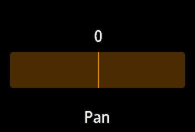

A centred bipolar fader
Its bar has no length, so a single line marks the zero. An empty track would look like a fader turned all the way down, which is the one thing a centred pan is not.
Pan at zero
Pan centred, with a line marking the zero

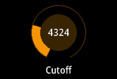

4. Cutoff, a dial with more than 127 steps ​
128 steps is plenty for a volume. It is not plenty for a filter sweep, where each step is audible as a click. MIDI's answer is to send two controllers for one parameter - the chosen one carries the coarse half, the one 32 higher the fine half - which together make a 14-bit number, 0 to 16383.
Open the faders tile's variants again, pick the Dial, and drop it on KNOB 3. Name it Cutoff, Parameter 74, switch Bits from 7 bit to 14 bit, and set both ranges to 0 … 16383. Send, and turn slowly.
Cutoff on the Mini
The Cutoff dial, a quarter of the way up its 16383 steps
Every step now puts two lines in the console:
cc  channel #1  ctrl 74   64
cc  channel #1  ctrl 106  76
Controller 74 carries the coarse half, controller 106 - that is 74 + 32
  • the fine half, and the instrument puts them back together as 64 × 128 + 76, which is 8268: the number on the Mini. Sweep slowly and watch which line moves. The fine half runs 76, 85, 88, 93… while the coarse half sits at 64 the whole time, and only moves when the fine half has gone all the way round. That is what "128 times finer" means in practice.

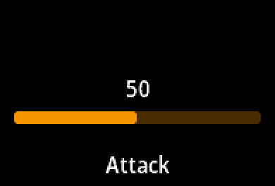

5. Attack, two ranges of different sizes ​
Pan had 128 display values and 128 MIDI values, which made the mapping tidy. Instruments are rarely so kind: a great many parameters read best as a percentage, and 0 to 100 is not 0 to 127.
Take the Thin Fader this time, drop it on KNOB 4, name it Attack, Parameter 73, Min 0, Max 100, MIDI range untouched. Send, and step up from zero one click at a time.
Attack on the Mini
The Attack thin fader at 50
The thin variant puts a slim bar under a larger number - where the value matters more than the bar does, the number gets the room. And the numbers are worth watching:

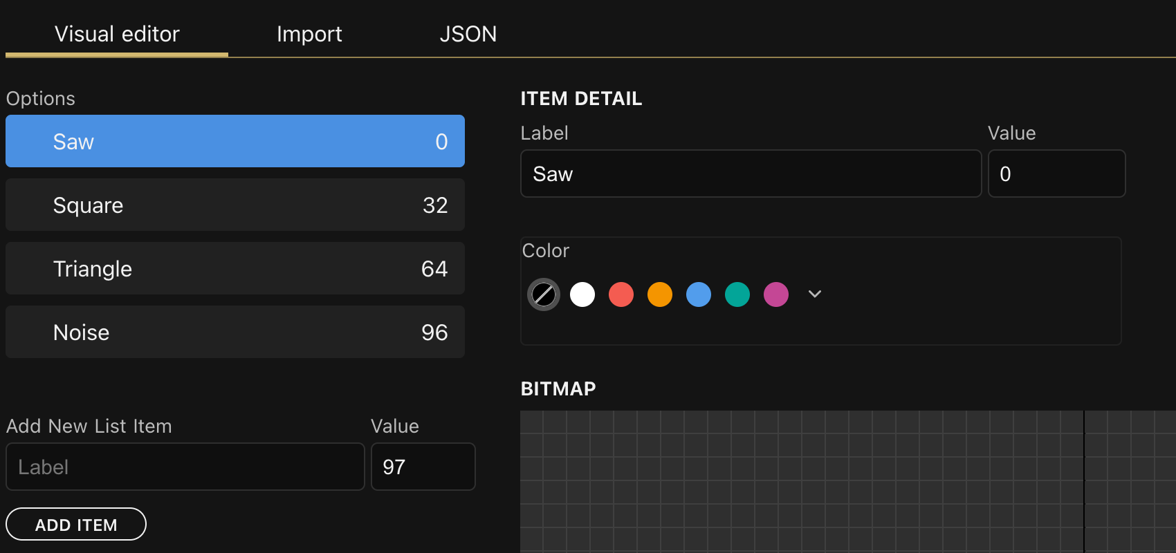

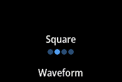

6. Waveform, a handful of named choices ​
The proportional family is done. Now the second kind.
An oscillator's waveform is not a range. It is four or five things with names, and the numbers behind them mean nothing at all - 0 for Saw, 32 for Square, 64 for Triangle, everything between unused. A fader here would be useless; you would be hunting for a number with no idea what it sounds like.
Drag a List from the lists tile onto KNOB 5, name it Waveform, and colour it blue - one colour per family, so the finished page shows the three kinds at a glance. Parameter 70. Then click EDIT beside List Items and add four, each with a Label and a Value:
LabelValue
Saw0
Square32
Triangle64
Noise96
The list items editor
The list items editor: four items, each a label and the MIDI value it sends
Waveform on the Mini
The Waveform list on Square, with one dot per item
The Mini shows the name of the selected item over a row of dots, one per item, and the knob steps through them one at a time. The console shows cc 70 0, cc 70 32, cc 70 64, cc 70 96 - the item's value, sent as it is.
Look at the value card and you will see Min and Max are gone, replaced by a single Default Midi Value. There is nothing left to map: for a list the display side is the label, and each item's Value is the MIDI value, typed straight out of the instrument's manual.

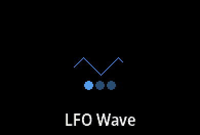

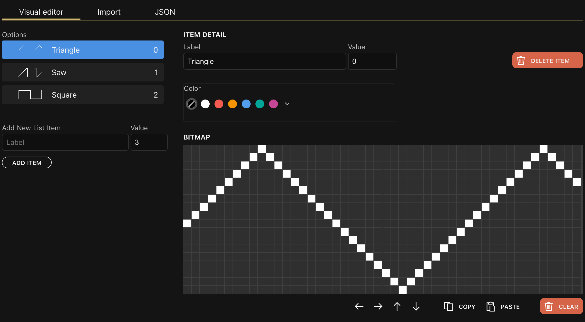

7. LFO Wave, a list that draws its options ​
Some options are quicker to recognise as a picture than as a word. You know a square wave on sight; reading the word takes longer. A list item can carry a small drawing, 48 by 18 pixels, shown in place of the label.
Drop another List on KNOB 6, name it LFO Wave, colour it blue, Parameter 76, and give it three items: Triangle 0, Saw 1, Square 2. Now click Triangle in the Options list and look under ITEM DETAIL: there is a BITMAP grid.
Drag on it to draw. Shift-click draws a straight line from the last point, which is how you get a clean diagonal without any patience at all. Starting on a lit pixel rubs out instead. The arrows nudge the whole drawing a pixel at a time, CLEAR wipes it, and COPY and PASTE move one to another item - useful when two symbols share most of their shape.
The bitmap editor
The bitmap editor: the three items with their drawings, and the 48 by 18 grid
LFO Wave on the Mini
The LFO Wave list showing a drawn triangle wave
Turn the knob and the console reads cc 76 0, cc 76 1, cc 76 2. A drawing is only ever a drawing: the item's Value is still what gets sent, and the message has not changed in the slightest.

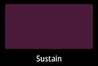

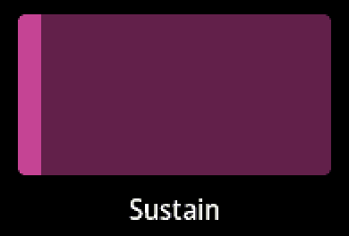

8. Sustain, on or off ​
The third kind. A sustain pedal is not a range and not a list of options: it is one thing, either on or off. That is a Pad.
Open the pads tile, drag the Pad Toggle onto KNOB 7, name it Sustain, colour it pink - third family, third colour - and set Parameter 64, which is the sustain pedal in MIDI. Send, then press KNOB 7; the knobs push in like buttons.
OffOn
Sustain offSustain on
Each press flips the pad and the console says cc 64 127, then cc 64 0.
No Min and Max here either. A pad has an ON value and an OFF value instead - simply the two MIDI values this control can ever send. Change them and it sends something else: 64 and 0 for an instrument that wants a half-pedal, or two values from the middle of a range to switch between two settings.

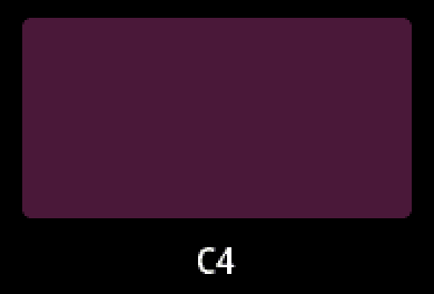

9. C4, a pad that plays a note ​
A pad does not have to send a Control Change. Change its message and the same switch does something else entirely - and with a Note it becomes a key.
Drag a Pad Momentary onto KNOB 8, name it C4, colour it pink, and change Message Type from CC to Note. The card changes as you do: the ON and OFF values are gone - a note has no use for them - and a Note field takes their place. Type 60, and the editor writes the name beside it: 60 → C4. Electra One counts octaves so that middle C is C4, which is worth knowing, because plenty of instruments call that same note C3.
C4 on the Mini
The C4 pad, waiting to be pressed
Send, then press and hold KNOB 8:
90 3C 7F   on    note c4  127     (as you press)
80 3C 7F   off   note c4  127     (as you let go)
Note On at full velocity while you hold, Note Off when you let go. That is the other pad mode at work: a Momentary pad is on only while pressed, where the Toggle pad next to it stays where you put it. One suits a sustain switch and the other suits a key - a key that latched on would be no use to anybody.

One thing left, and it takes a minute. Drag a Group label from the labels tile onto the thin row above the top row of controls, name it Proportional, and drag its corner handle out to four columns wide. Do the same on the row above the second row of controls, twice: Discrete two columns wide over the two lists, and State over the two pads.
The finished page
The finished preset: Proportional over the faders, Discrete and State over the second row
Groups change nothing about what the controls do. They are there so that a glance tells you what you are looking at - which, once a preset has thirty controls on six pages, is not a small thing.
