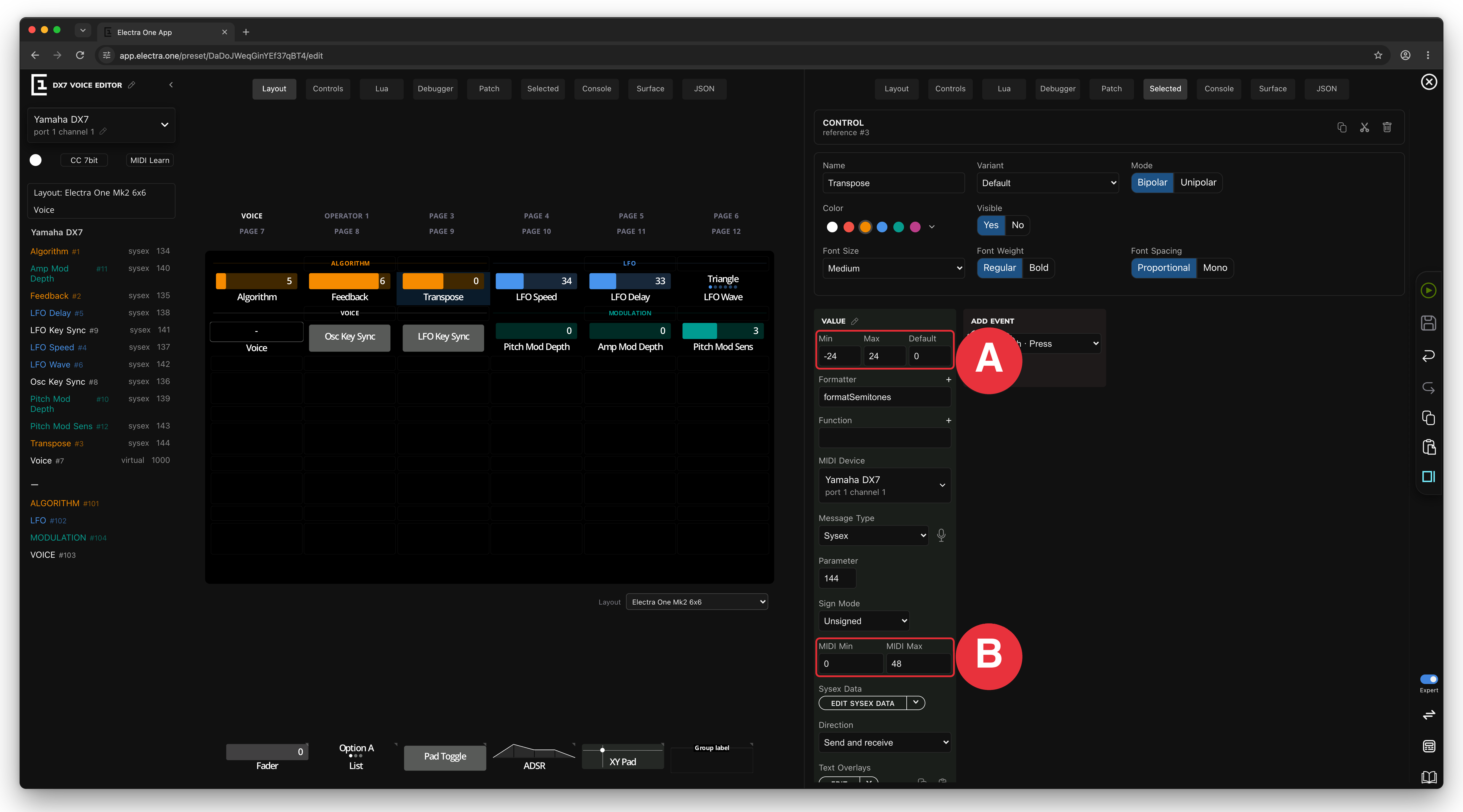

Control settings on the Selected tab
The settings of the Transpose control on the Selected tab: the display range (A) and the MIDI range (B)

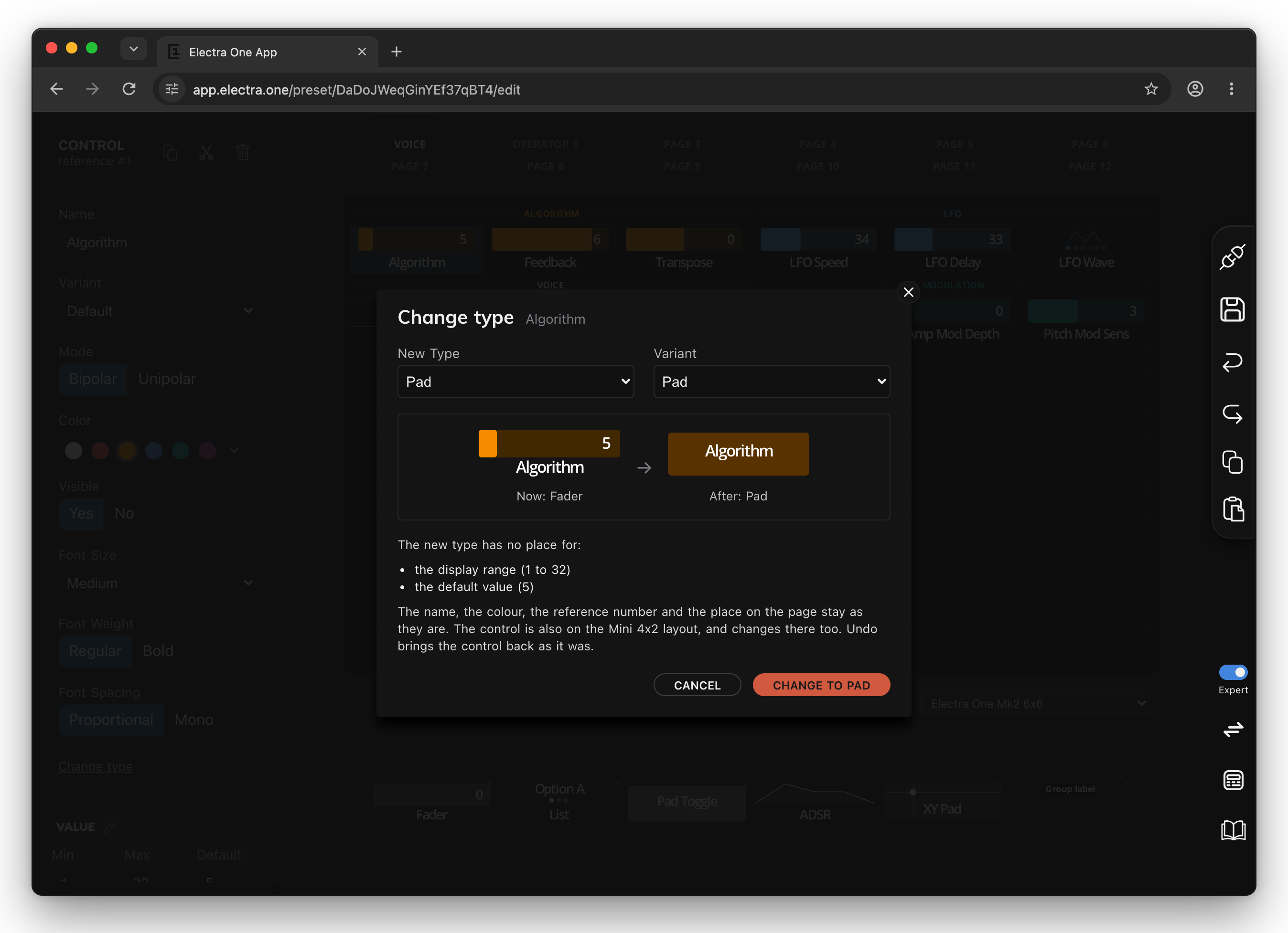

Changing the type ​
A control does not have to be removed and built again when it turns out to be the wrong type: a fader that should have been a list, a list of two items that should have been a pad. Click Change type, the last line of the control card.
Changing the type of a control
Changing the Algorithm fader to a pad: the control now and after, and what the pad cannot keep
  1. Choose the New type, and its Variant if the type has variants.
  2. Compare the two pictures: the control as it is now, and as it will be.
  3. Read the list under them. It names everything the new type has no place for. When the list is empty, nothing is lost.
  4. Click Change to type, or CANCEL to leave the control as it is.
The control stays the same control. Its name, colour, reference number and device are kept, and so is its place on the page. A control that is placed on both layouts changes on both, and the window says so. Lua scripts and events that use the reference number keep working.
What is kept of the values depends on the two types:
ChangeWhat happens
Between faders and listsThe message is kept. A fader's text overlays become the list items, and the other way round. A list has no display range, so a fader's Min and Max are lost when they differ from the MIDI range, and the Default is converted to a MIDI value.
To a padThe MIDI Min and Max become the OFF value and ON value. For a list, the first and the last item become the two states, with their State Labels, and the other items are lost. A numeric Default is lost.
From a padThe OFF value and ON value become the MIDI Min and Max. The State Labels become list items or text overlays. A Default State of On is lost.
To a relative controlThe ranges and the Default are lost: a relative control sends steps, not values.
Between envelopes, the XY pad and the V faderValues with the same name keep their messages: an ADSR changed to an AR keeps attack and release, and loses decay and sustain. Other values are moved in order. Values the new type adds get new messages, as if the control had been dragged from the repository.
A single value to an envelope, or backThe fader's value becomes the first value of the envelope. An envelope changed to a fader keeps its first value and loses the others.
List items, text overlays and state labels are lost by every type that does not show them: envelopes, the XY pad, the V fader, relative and custom controls and text boxes. The font is kept by faders, lists and text boxes, the Width and Height by text boxes and custom controls, and the Placeholder by text boxes. A message type the new type does not offer, such as a pad's Note, is replaced by the default message type.
The change is one step of Undo: undo brings the control back with everything it had.
Values: display and MIDI ​
This is the most important idea in the control settings. A control's value has two sides:
  • the display value, the number you see on the controller, and
  • the MIDI value, the number the control sends to the instrument and receives from it.
They are often the same, 0 to 127 on both sides. But instruments rarely think in 0 to 127. The DX7's Transpose is sent as 0 to 48, while the musician thinks of it as −24 to +24 semitones. Its Algorithm is sent as 0 to 31, while the manual and the front panel number the algorithms 1 to 32. A preset should show what the musician knows, and send what the instrument expects.
So a value card has two ranges:
  • Min and Max (A in the picture above) are the display range.
  • MIDI Min and MIDI Max (B) are the MIDI range.
Electra One maps one range onto the other in a straight line: the display minimum sends the MIDI minimum, the display maximum sends the MIDI maximum, and everything in between is spread evenly and rounded to whole numbers. The same mapping works backwards: when the instrument sends a MIDI value, the control shows the matching display value.
display value, what the controller showsMin … Max−24 st0 st+24 st+12 st sends 36MIDI Min … MIDI Max02448MIDI value, what the DX7 receives
The DX7's Transpose: display −24 to +24 is sent as MIDI 0 to 48. Each display step is one MIDI step.
Some typical settings:
ParameterMinMaxMIDI MinMIDI MaxWhat the musician sees
a CC parameter01270127the MIDI value itself
DX7 Algorithm132031algorithms numbered as on the synth
DX7 Transpose−2424048semitones up and down
DX7 Detune−77014detune around the centre
a pan−64630127left, centre and right
a percentage010001270 % to 100 %, rounded
A few rules to keep in mind:
  • Negative numbers belong to the display range. MIDI Min and MIDI Max are 0 or more; to show negative numbers, give Min a negative value.
  • The ranges don't have to be the same size. With a display range wider than the MIDI range, several display values send the same MIDI value, and the knob moves in visible steps. With a narrower display range, each display step jumps over several MIDI values.
  • Default is a display value: the value the control starts with when the preset loads. Electra One does not send it when the preset loads, so the instrument keeps its own sound until a knob is turned. On the Mk2, a double tap on a fader, list, envelope or XY pad resets it to the default and sends it, unless the controller's double-tap setting has been changed. Pads, relative and custom controls are not reset.
  • Formatters and overlays see the display value. See Formatters and functions and Lists and overlays.

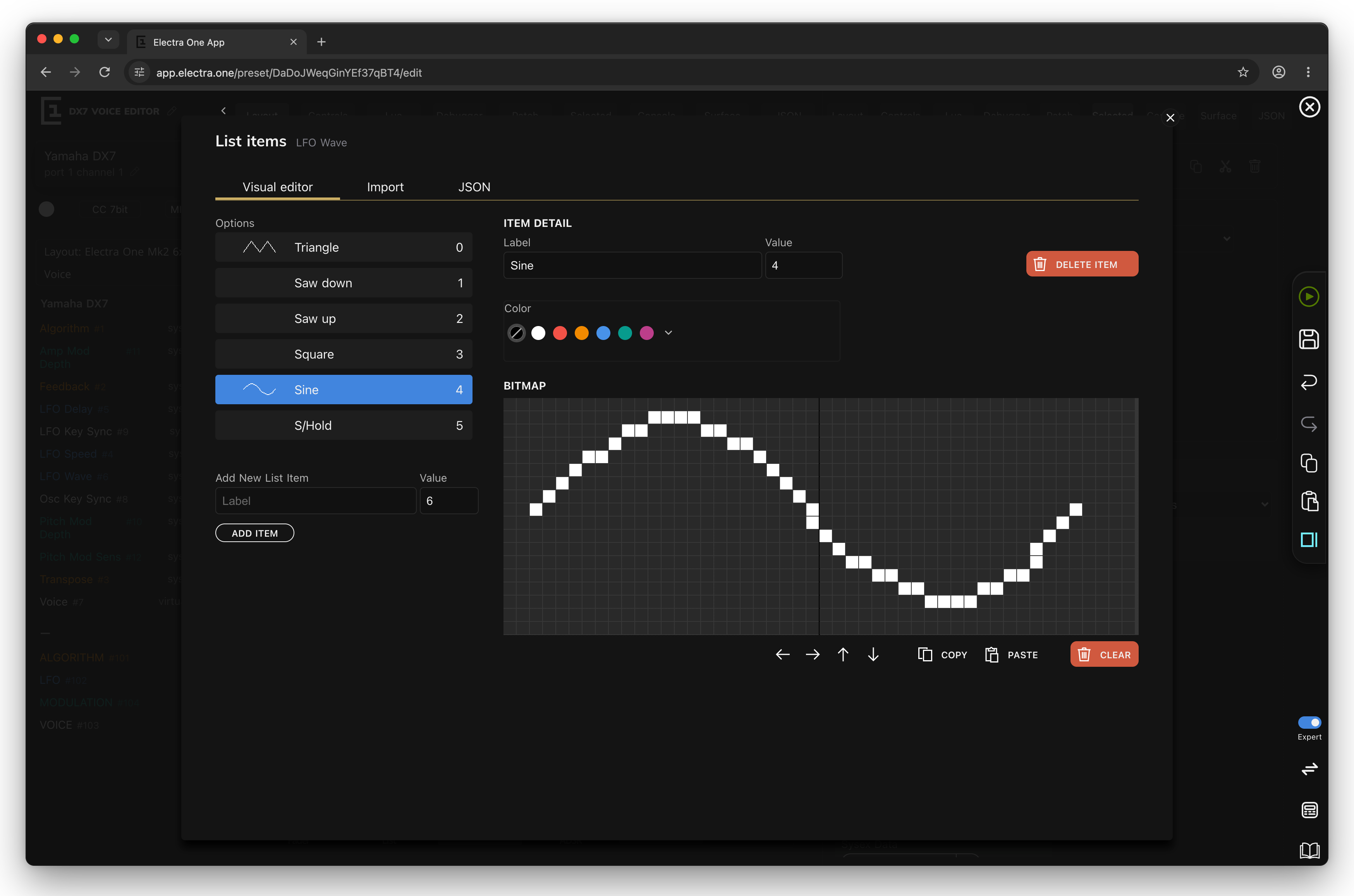

Lists and overlays ​
Lists have List Items, and faders can have Text Overlays: names shown in place of some values, such as "Off" at 0 or "Centre" at 0 on a pan. The value card shows the first items; EDIT opens the editor, and the copy and paste icons move a whole list from one control to another.
The list items editor
The list items of the DX7's LFO Wave
The editor has three tabs:
Visual editor. The items in order, each with its bitmap, colour, label and value.
  • Add new list item (or Add new text overlay): type a Label and a Value, and ADD ITEM. The value is filled in with one more than the highest value in the list.
  • Drag an item to change the order. The controller shows the items in this order.
  • Select an item to change its label, value and Color, or to DELETE ITEM. An item's colour replaces the control's colour while that item is selected.
  • BITMAP draws a 48×18 picture shown in place of the label, for waveforms and symbols. Drag to draw, start on a lit pixel to erase, Shift-click to draw a line. The arrows move the picture, COPY and PASTE move it between items, CLEAR erases it.
Import. Paste a list, or OPEN TEXT FILE (.txt, .csv, .tsv), one item per line: a label, then optionally a value and a colour, separated by tabs, commas, semicolons or |. APPEND adds the items, REPLACE replaces the list (ADD ITEMS when the list is empty). Labels longer than 14 characters are shortened. Handy for long lists of patch names or effect types copied from a manual.
JSON. The items as JSON.
Values are checked: a text overlay against the fader's Min and Max, a list item against the message's MIDI range, and two items may not share a value. The visual editor marks a problem; Import and JSON refuse it. The values of list items are MIDI values; the values of text overlays are display values, so an overlay on the Transpose fader for "0 st" is at 0, not at 24.

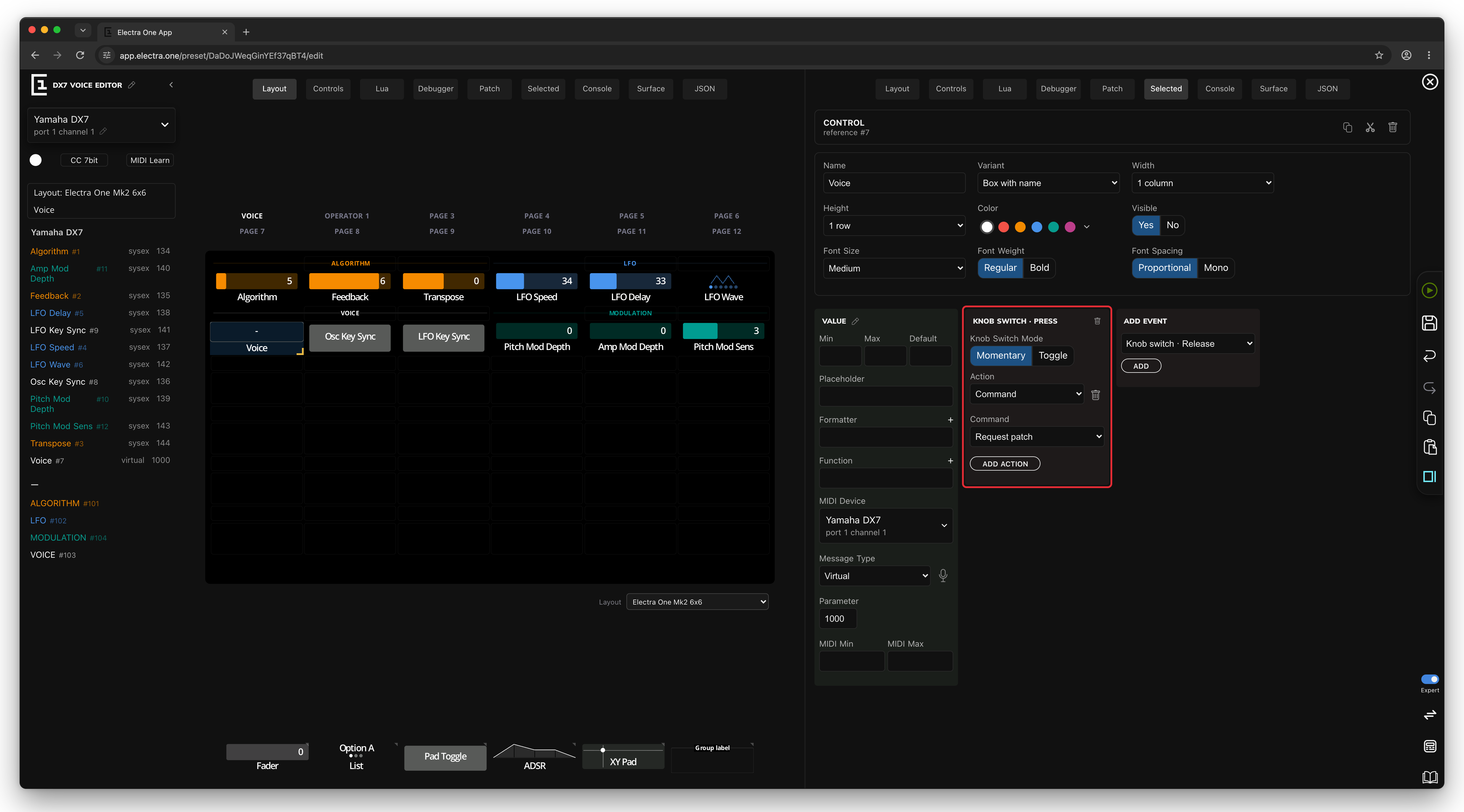

Events ​
Expert. Events decide what happens when the knob of a control is pressed, released, touched or let go. There are two sources:
  • Knob touch. The knobs of both the Mk2 and the Mini are touch-sensitive, so touch events work on both.
  • Knob switch. The Mini's knobs can also be pressed like a button, and a switch event runs on the press. The Mk2's knobs cannot be pressed, so there a tap on the control on the screen acts as the press.
Events
Pressing the Voice text box asks the DX7 for its voice
  • ADD EVENT chooses the gesture: Knob switch · Press, Knob switch · Release, Knob touch · Begin or Knob touch · End, and ADD.
  • Knob switch mode or Knob touch mode: Momentary or Toggle.
  • ADD ACTION adds what happens, in order. An Action is one of:
    • MIDI message: a device, a message type, a parameter and a Value, either a number or a Lua function that returns one,
    • Lua function: a function of the script, called with the control, the gesture (its source and event), the pot, the value id and the value,
    • Command: one of Electra One's commands, such as Request patch, Switch to page, Open snapshots or Set default value. Commands that act on a control act on this one when Control is left empty.
  • Remove action removes an action, Remove event the whole event.
A Knob switch event replaces what a press or tap on the control normally does: a pad no longer toggles and a fader no longer opens its detail. A switch event with no actions therefore disables the gesture for that control. In Toggle mode, the presses alternately run the Press and the Release actions. Knob touch events only add actions; the control keeps working as before. On the Mini, the four buttons under the page fire the switch events of the pad or list above them.
