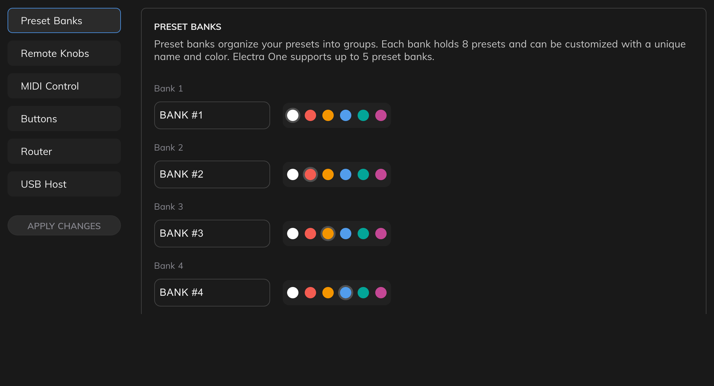

Preset Banks ​
Preset Banks
The five preset banks of the Mini with their names and colours
The Mini has five banks of eight presets. For each bank you can set:
  • Bank name, shown on the bank buttons of preset selection,
  • colour, chosen from the colours the controller can show.

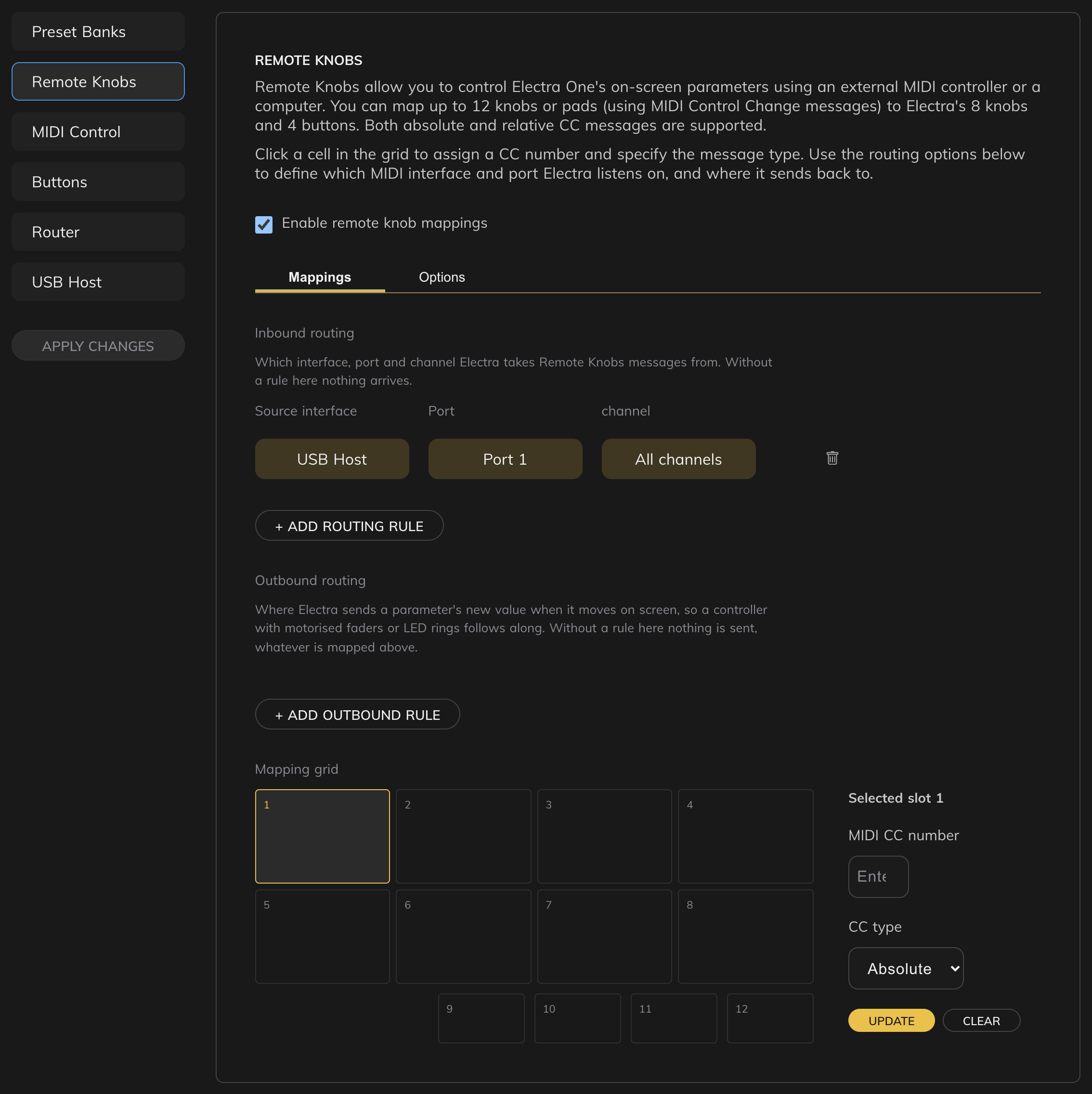

Remote Knobs ​
Remote knobs let the knobs or pads of another MIDI controller, or a DAW, move the controls of the Mini, and send the values back when you turn the Mini's knobs. The ideas behind them are explained in Remote knobs.
On the Mini you can map up to 12 knob slots: the eight knobs and the four buttons.
Remote Knobs
Remote Knobs: the mapping grid has the eight knob slots of the Mini, and a smaller row of four for its buttons
  • Enable remote knob mappings switches the remote knobs set here on and off. A preset's own remote map works either way.
  • Mappings tab:
    • Inbound routing chooses the ports and channels the remote knobs listen to. + Add routing rule adds one.
    • Outbound routing chooses where the values of the controls are sent back. + Add outbound rule adds one.
    • Mapping grid: slots 1 to 8 are the knobs, arranged like them; slots 9 to 12, in the row under them, are [BUTTON 1] to [BUTTON 4]. Click a slot, set its MIDI CC number and CC type (Absolute for faders and knobs, Relative for endless encoders), and click Update. Clear removes the mapping.
  • Options tab:
    • Takeover decides what happens when a remote fader and a control disagree: Jump, Pickup, Scale or Nudge. See Remote knobs.
    • Send values on preset and snapshot load and Send values on page change keep a remote controller with motorised faders or LED rings in step with the Mini.
A knob slot drives the control that is at that position on the page you are looking at. Slots 9 to 12 drive the controls on the four buttons.

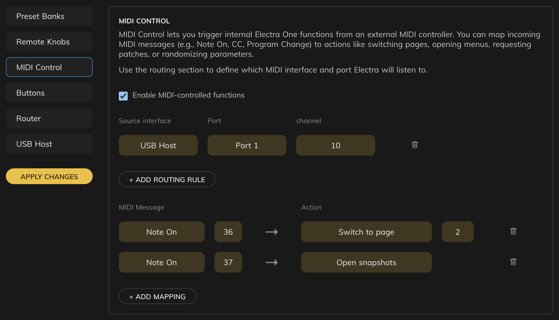

MIDI Control ​
MIDI Control runs a controller function when a MIDI message of your choice arrives: a footswitch that changes the page, the pads of a small controller that open windows, or a button in a DAW that loads a preset. See also MIDI Control.
MIDI Control
MIDI Control mappings for the Mini
  • Enable MIDI-controlled functions switches MIDI Control on and off.
  • The routing rules choose the ports and channels MIDI Control listens to. Without a rule, nothing arrives.
  • + Add Mapping adds a mapping: a MIDI Message (Note On, Note Off, Control Change or Program Change, with its number) and an Action.
Notes, Control Changes and Program Changes that match a mapping are used by MIDI Control and don't reach the preset, and neither does the Note Off of a key whose Note On runs an action. Everything else that arrives on a MIDI Control route reaches the preset as usual. A Control Change mapping runs its action for every value, so a footswitch that sends 127 when pressed and 0 when released runs it twice.
The actions for the Mini:
ActionWhat it does
Open pagesopens the menu with page selection
Open presetsopens preset selection
Open snapshots, Open capturesopens the Snapshots or Captures window
Open functionsopens the Preset Menu
Open systemopens the Settings window
Close windowcloses the window that is open
Next page, Previous pageshows the next or previous page that has controls
Switch to pageshows the page with the number you enter, 1 to 16, if it has controls
Next preset, Previous presetloads the preset in the next or previous slot
Switch to presetloads the preset with the number you enter: 1 to 8 are bank 1, 9 to 16 bank 2, and so on up to 40
Toggle sensitivityswitches low knob sensitivity on or off
Request patchsends the preset's patch request
Open detail, Close detailopens the detail window of the control whose knob is touched at that moment, or closes it
Set default valuesets the selected value of the touched control to its default value
Next handle, Previous handleselects the next or previous value of the touched multi-value control, a custom control with several values included
Set default valuessets every control to its default value
Randomize valuesgives every control a random value
The Mini also reacts to messages on its CTRL port without any mapping: Program Changes switch presets, or snapshots after a Bank Select, Control Changes morph snapshots, and notes start captures and transpose them. See The CTRL port.

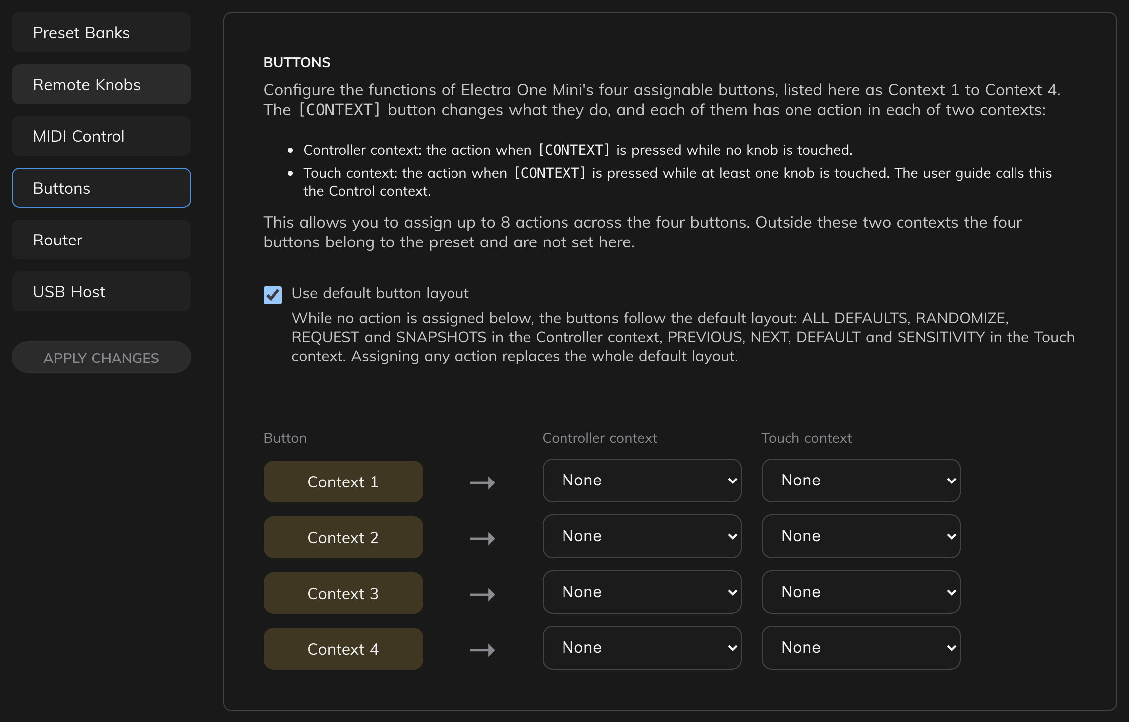

Buttons ​
The Buttons section sets what [BUTTON 1] to [BUTTON 4] do in the Controller context and the Control context.
Buttons
The Buttons section of the Mini: Context 1 to Context 4, each with an action for the Controller context and for the Touch context
  • Use default button layout: while no action is assigned, the buttons use the default layout: ALL DEFAULTS, RANDOMIZE, REQUEST and SNAPSHOTS in the Controller context, PREVIOUS, NEXT, DEFAULT and SENSITIVITY in the Control context. Switch it off to have no actions at all.
  • Context 1 to Context 4 are [BUTTON 1] to [BUTTON 4].
  • Controller context is the action when [CONTEXT] is pressed without touching a knob.
  • Touch context is the action when [CONTEXT] is pressed while a knob is touched. This manual calls it the Control context.
Choosing any action replaces the whole default layout: the buttons you leave at None do nothing. The actions you can choose are listed in Choosing the actions.
On the page, without a context, the four buttons always belong to the preset's controls; they are set in the Preset Editor.

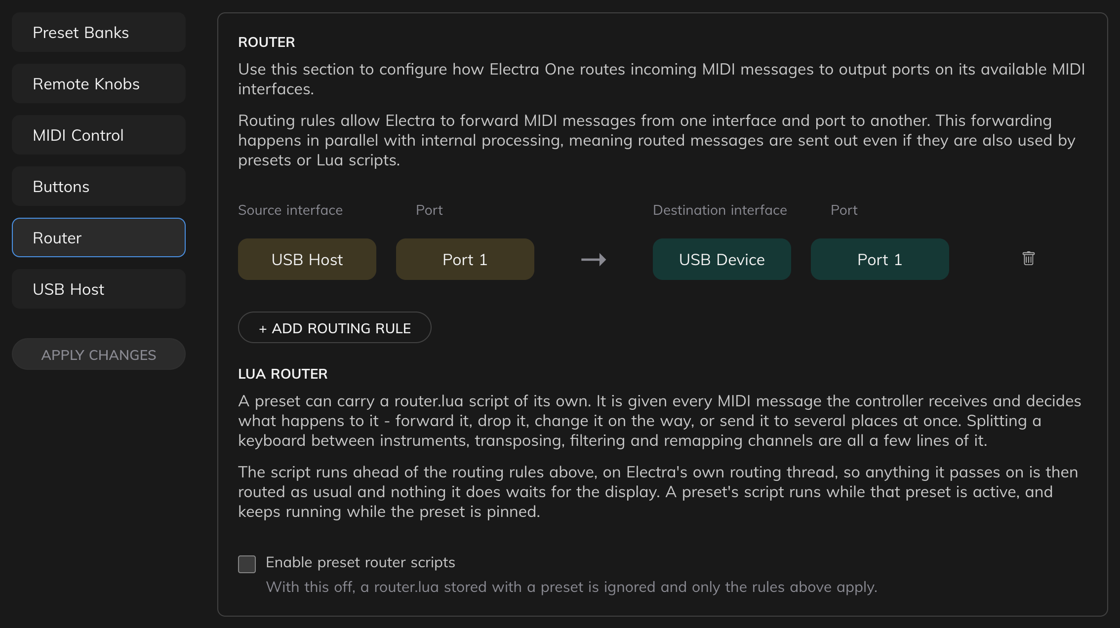

Router ​
The router passes MIDI messages between the Mini's interfaces: the USB Host port, the USB Device port (your computer) and the MIDI IO sockets. How it works is explained in Router.
Router
Router rules of the Mini
Each routing rule takes messages from a source interface and port, and passes them to a destination interface and port. + Add routing rule adds a rule.
The Mini has one pair of MIDI sockets, so a rule that sends to MIDI IO always uses Port 1; the destination port can't be changed.
Enable preset router scripts allows presets to run a router script that filters and changes the messages passing through the router.

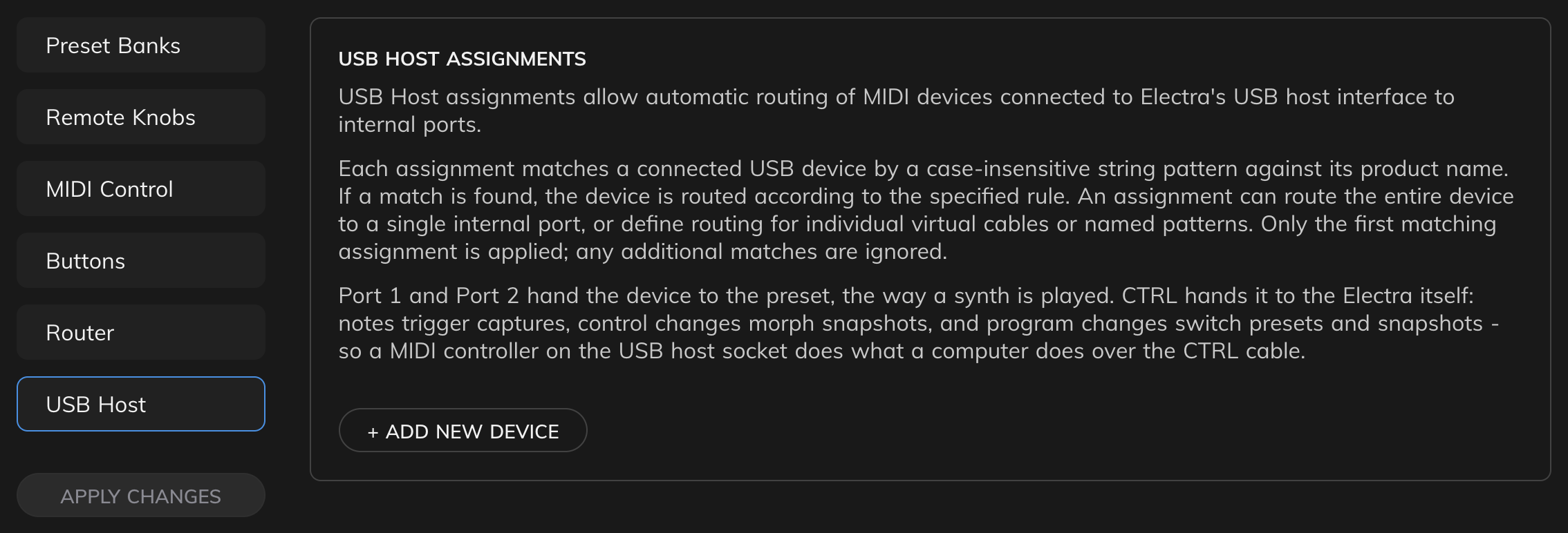

USB Host ​
The USB Host section decides which of the Mini's ports a USB MIDI device on the <USB HOST> port uses. This lets presets and routes tell two devices apart.
USB Host assignments, with no devices assigned yet
+ Add new device adds an assignment:
  • The assignment matches a device whose product name, the name the status bar shows, contains the text you enter. The match ignores upper and lower case.
  • It sends the whole device to one port, or sets a port for each of the device's virtual cables (counted from 0) or named ports. A cable that the assignment does not list is not used.
  • Only the first assignment that matches a device is used.
  • A device that no assignment matches uses Port 1.
  • Assignments apply when the device is plugged in.
The ports mean:
  • Port 1 and Port 2: the device's messages go to the preset, the way an instrument's messages do.
  • CTRL: the device's messages go to the controller itself, as if they came from the computer's CTRL port. Notes start captures, Control Changes morph snapshots, and Program Changes switch presets and snapshots. See The CTRL port.
The Mk2 manual describes how devices are detected and assigned in more detail: USB Host.

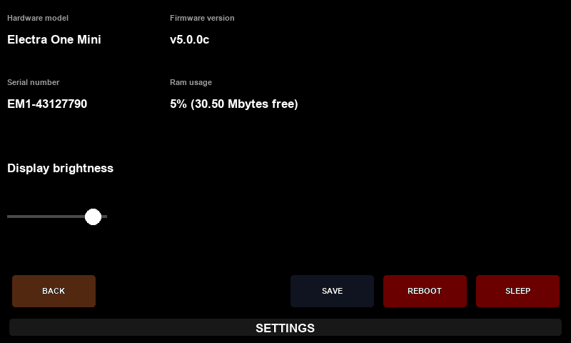

System ​
Hold [MENU] for one second. The Settings window opens while you are still holding the button.
The Settings window
The SETTINGS window of Electra One Mini
It shows:
ItemWhat it shows
Hardware modelElectra One Mini
Serial numberthe controller's serial number, starting with EM1
Firmware versionthe version of the firmware the controller runs
Ram usagehow much memory is used, and how many megabytes are free
Display brightnessa slider for the brightness of the display
The buttons, from the left:
ButtonLabelWhat it does
[MENU]BACKcloses the window
[CONTEXT], [BUTTON 1]–close the window
[BUTTON 2]SAVEsaves the state of the controller
[BUTTON 3]REBOOTrestarts the controller
[BUTTON 4]SLEEPputs the controller to sleep
SAVE, REBOOT and SLEEP act when you let go of the button, and they don't ask for confirmation. Pressing a knob closes the window.
SLEEP is described in Power On & Sleep Mode.
Display Brightness ​
Turn KNOB 5 to change the brightness. The display follows as you turn. The brightness is saved when you close the window, press SAVE or press REBOOT.
