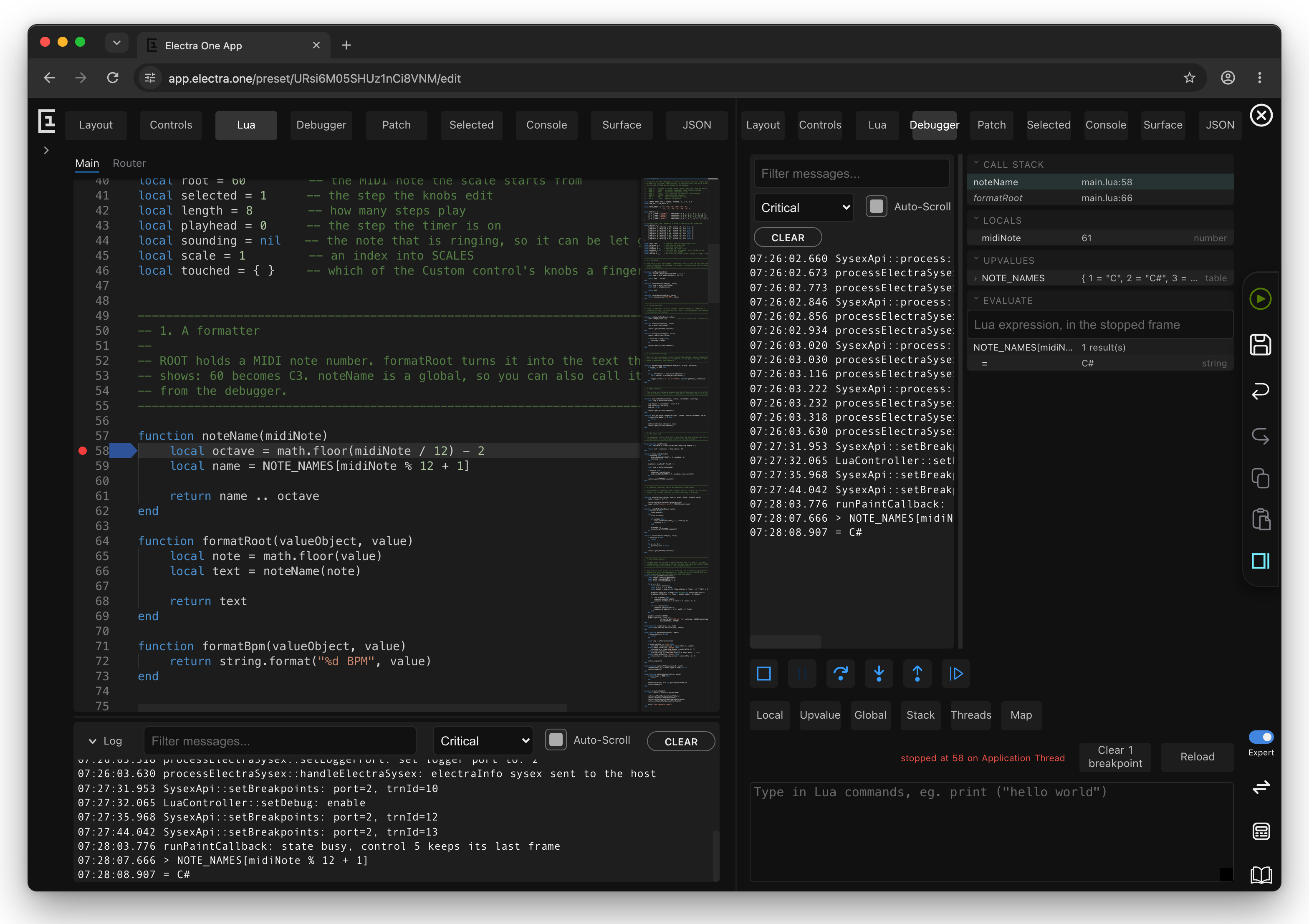

ROOT holds the MIDI note number 60, yet the control shows C3. A formatter is doing that - a Lua function the control calls whenever its value changes. Let's stop inside it while it works.
  1. Open split view, with the Lua tab on one side and the Debugger on the other.
  2. In the Lua tab, click line number 58, local octave = ..., inside noteName. A red dot marks the breakpoint.
  3. Click Attach, the first button of the debugger's toolbar. A bug icon appears in the controller's bottom bar with RUNNING beside it.
    The controller while attached
    The Mini's bottom bar with the bug icon and RUNNING, beside the running timer's icon
  4. Turn KNOB 6 (ROOT) one step.
Everything stops. On the controller the word beside the bug icon turns to a red STOPPED, the Lua tab highlights line 58, and the status reads stopped at 58 on Application Thread. The instrument is frozen mid-thought, waiting for you.
Stopped in the formatter
The script stopped at line 58 in noteName: the Lua tab highlights the line, and the debugger shows the call stack, the locals, the upvalues and an evaluated expression
CALL STACK shows how the script got here, innermost first: noteName at main.lua:58, and beneath it formatRoot at main.lua:66, which called it. The second name is in italics, which is the editor's way of saying it read the name out of your script rather than being told it - the controller called formatRoot itself, so Lua never learned what it was called.
LOCALS shows midiNote, holding the note you turned to. Notice what is not there: octave and name are missing entirely, because their lines have not run yet, so those variables do not exist.
valueObject is different again - it is one of the script API's objects, so it says it is a ControlValue and offers a ›. Open it and the debugger asks the object what it holds: getValue, getText, getMin, getMax, getControl, each with its answer.
UPVALUES stays empty until you click the Upvalue button. Then NOTE_NAMES appears - it belongs to the script rather than to this function, which is exactly what an upvalue is.
EVALUATE runs any Lua you like, right where the script is standing. Type
NOTE_NAMES[midiNote % 12 + 1]
and press Enter: the answer is C#. Locals and upvalues are both in scope, so you can try a line here before you commit it to the script.

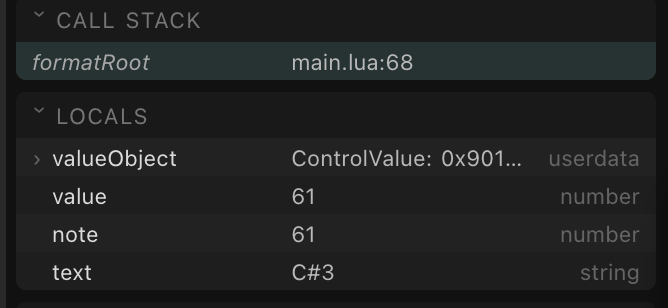

Now press Step out. The script finishes noteName and stops in formatRoot at line 68, where LOCALS has gained note and text, and text holds C#3 - the very string the control is about to draw.
After stepping out
Stopped at line 68 of formatRoot, with valueObject, value, note and the finished text
Press Continue, and the controller comes back to life.

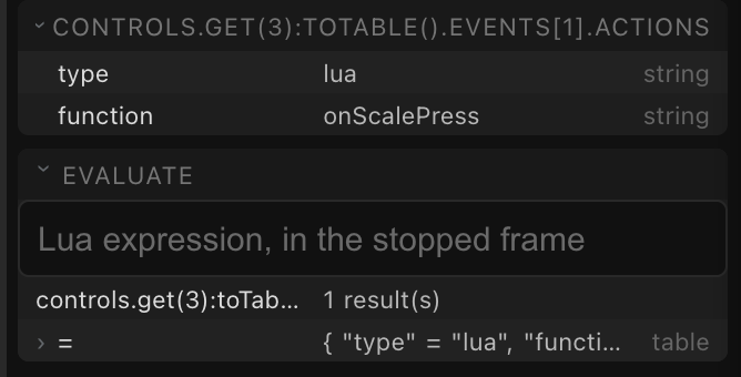

Opening an object ​
control has a ›, and this is where it gets satisfying. Open it and you get the control exactly as the preset file describes it: name, type, color, bounds, pageId, values, events. Any field that is itself a table opens in turn, so you can keep going down:
control:toTable().events[1].actions[1]
   function = onScalePress
   type     = lua
That is the preset's own wiring, read live off the controller - the event that called the function you are standing in.
An object opened
The Scale control opened through toTable, down to events[1].actions[1] and the lua action naming onScalePress

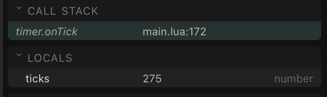

Everything so far waited for you. The sequencer's clock does not: timer.onTick runs four times a second whether you touch anything or not, and stopping inside it feels quite different.
Clear the breakpoints and set one on line 172, playhead = playhead % length + 1. Make sure the sequencer is running, and Attach.
It stops immediately - there is no gesture to make, the tick was already due. LOCALS holds a single argument, ticks, at 1.
The music stops with it, and a note is left hanging. The note from the previous tick is released at the top of the next one, so for as long as you sit there, it sounds. Nothing is broken; that is simply what stopping a sequencer means.
Press Continue and it stops again almost at once, because the next tick is 125 ms away. A breakpoint inside something that runs constantly is a breakpoint you cannot easily get away from.

Look at ticks now. It is no longer 1:
ticks   275
ticks is not a counter - it is how many periods this one call stands for. While you were reading, a few hundred of them came and went, and the tick you are in now stands for all of them. This is why a script that counts time should add ticks rather than 1: otherwise it loses time whenever the controller is busy.
The controller mentions it in the log, too:
timer.onTick of preset 16 is in trouble on its 123967 us period:
last 1879238 us, worst 1879238 us, ...
A tick that should take 124 ms took over a second - which was you, reading.
A timer tick
timer.onTick stopped at line 172, with ticks standing for 275 periods rather than 1

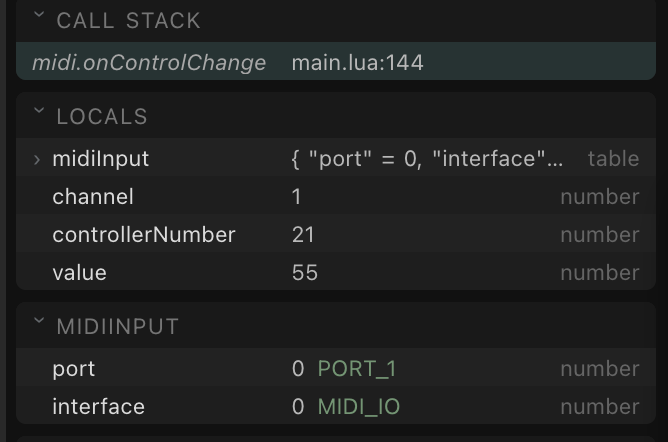

midi.onControlChange runs for every Control Change that reaches the preset. Unlike everything so far, what triggers it comes from outside the controller.
Clear the breakpoints, set one on line 144, if controllerNumber ~= 1 then, and Attach. Now send the controller a Control Change - move a knob on a keyboard plugged into the USB Host port, or send one from your computer.
LOCALS has the message in pieces: channel, controllerNumber, value, and midiInput, which is a table and has a ›. Open it, because it answers something no log line ever could:
port        0   PORT_1
interface   0   MIDI_IO
The green name beside each number is the debugger telling you which constant the value stands for. A bare 0 would say nothing - 0 is MIDI_IO, and PORT_1, and INTERNAL. So this particular message arrived through the MIDI DIN input, on port 1.
A MIDI callback
midi.onControlChange stopped at line 144, with midiInput opened to show port 0 PORT_1 and interface 0 MIDI_IO

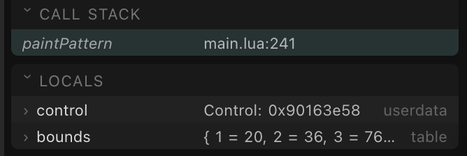

Now for the one callback in the preset that is not on the application thread. Move the breakpoint to line 241, inside paintPattern, leave the sequencer running, and Attach.
The status says something new:
stopped at 241 on Lcd Thread
The picture freezes. The rest of the screen is still drawn - the bottom bar still reads STOPPED - but the Pattern control keeps the last frame it managed.
Stopped on the display thread
paintPattern stopped at line 241, with the control it is drawing and the bounds it was given
Now turn a knob. Nothing happens.
That is worth sitting with, because it is not obvious. The thread that reads the knobs is running perfectly well. It is the script that is stopped, and the knob's handler is part of that same script. A thread that wants to enter a stopped script is turned away rather than made to wait - so your turn is not saved up for later, it is simply gone.
Press Continue, and the debugger tells you what was given up while you looked.
Which thread, and why it matters
A stopped script freezes everything belonging to that preset, whichever thread stopped. What the thread name tells you is where the line runs - and a paint callback runs on the display thread, which is why it has to be quick. Anything slow in there shows up as a screen that will not keep up with the knobs, and you have just seen what that looks like.

  • Open the objects. A control, a value or a MIDI message will tell you what it holds.
  • Try the line before you write it. That is what EVALUATE is for.
