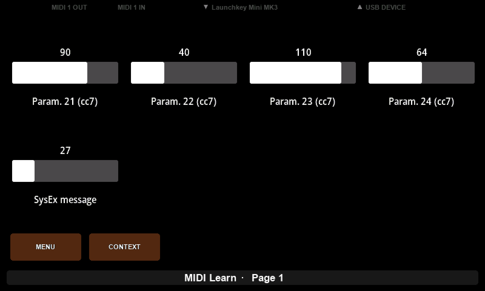

A preset built by turning knobs
Four faders and a SysEx control on the Mini, none of them typed in by hand
What we will build ​
A preset called MIDI Learn, built almost entirely by turning knobs on an instrument - and then repaired in the places where turning knobs does not get you all the way there.

Turn a knob, all the way from one end to the other, and a tile appears.
The learned parameters
Four learned control changes, each with the range heard so far under it
Three things are in that tile. The name is what was heard - controller 24, a plain 7-bit control change - and it is a placeholder rather than a name. The bar shows the value that arrived last. The line underneath is the one to watch: it is how much of the parameter's travel the editor has heard, and it is what the control will be built from.
Sweep four or five more knobs and drag the tiles onto the page one at a time. A tile leaves the list as it lands, so what remains in the sidebar is what you have not placed yet, and CLEAR empties the list without placing anything. That is a working preset, from an instrument you have no documentation for, in about a minute.

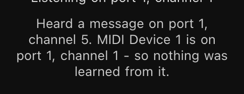

Nothing appears?
The list only shows parameters on the selected device's port and channel. A message from anywhere else says so instead:
A message from another device
Heard a message on port 1, channel 5. MIDI Device 1 is on port 1, channel 1 - so nothing was learned from it
It is the first thing that goes wrong for most people, and the fix is at the top of the sidebar: check the device's port and channel against the ones the instrument is actually sending on. SysEx and Song Position are the exceptions - they have no channel, so they are matched on the port alone.

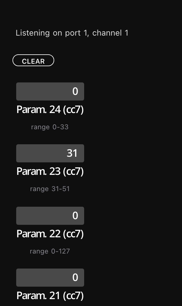

3. Why the sweep matters ​
Look again at the line under each tile. After a session of ordinary knob twiddling it will read something like range 31-51, and that is not the parameter's range - it is the part of it you happened to touch.
The editor cannot ask a knob how far it goes. It only knows the values it has heard, so a knob nudged from 31 to 51 has told it the parameter runs from 31 to 51, and the control you drag onto the page will run from 31 to 51 too, with two thirds of the parameter out of reach.
So turn each knob all the way to one end and then all the way to the other. The caption is there to tell you whether you did: a knob you only touched reads only 87 so far - turn it end to end, which is the same advice at the moment it is needed.
The other end of this is a parameter that genuinely does not use the whole range - a coarse tune that runs 52 to 76. A full sweep learns that correctly too, and gives you a control that covers exactly what the instrument accepts and no more, which beats typing 0 and 127 and wondering later why the top of the knob does nothing.
It is a floor and a ceiling, not a measurement
The range only ever widens. Sweep a knob properly, then send that parameter a stray value from somewhere else, and the range grows to include it and stays grown. CLEAR is the only way back.

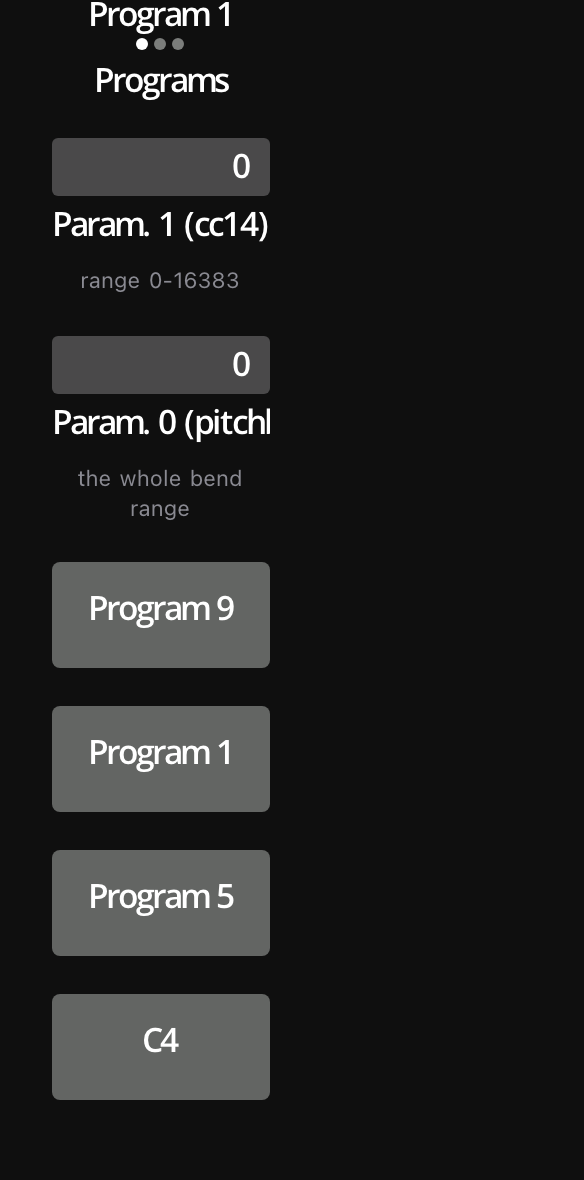

Each becomes a tile - and, the part worth watching, not all of them become the same kind of control.
What the messages become
A list of programs, a 14-bit fader, a bipolar pitch bend fader, three program pads and a note pad
SentLearned asBecomes
Control Changecc7a fader
a CC and its partner 32 highercc14one fader over 0-16383
NRPN or RPNnrpn, rpna fader
a notenotea momentary pad, named C4
a program changeprograma momentary pad, Program 5
several program changesprograma pad each, and a list of all of them
the bend wheelpitchbenda bipolar fader, -8192 to 8191
aftertouch, poly or channelatpoly, atchannela fader
a song positionsppa fader
A pad per program is what you want for three favourites on a page; a list is what you want for a bank of them. MIDI learn cannot know which, so it offers both and lets you take the one you need.

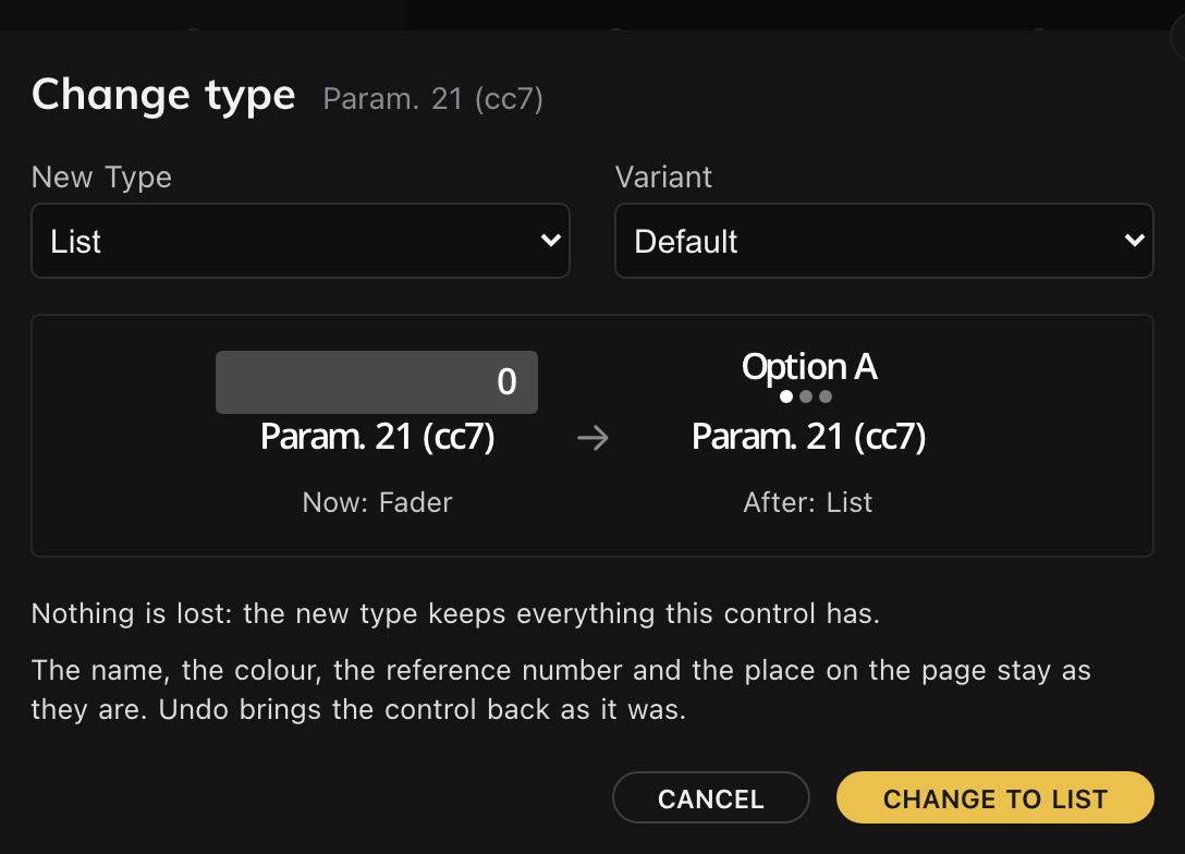

7. Fixing the shapes afterwards ​
Take one of the faders from step 2 - a knob that really selects between a handful of things rather than sweeping a range. It arrived as a fader because that is all its messages looked like. Select it and click Change type, the last line of the control card.
Changing a learned fader into a list
The control now and after, and the line saying nothing is lost
The window draws the control as it is and as it will be, and underneath tells you what the change costs. For a learned fader the answer is usually nothing is lost: the new type keeps everything this control has. That sentence is the whole point of the window: when a change would cost something - a list has no display range, a pad keeps only two values - it says so instead and names what goes. Read it before you click, and if you clicked anyway, Undo brings the control back as it was.
Click Change to list. The name, the colour, the reference number, the device, the place on the page and - most importantly - the message the learn worked out all stay as they were. Only the shape changed. Now give it its items, and give the control a real name while you are there.
The other way round, too
A learned note arrives as a momentary pad, right for a drum and not for a held note. A learned program change arrives as a pad, right for one favourite and not for a bank. Change type moves any of them, and never touches the message underneath.
