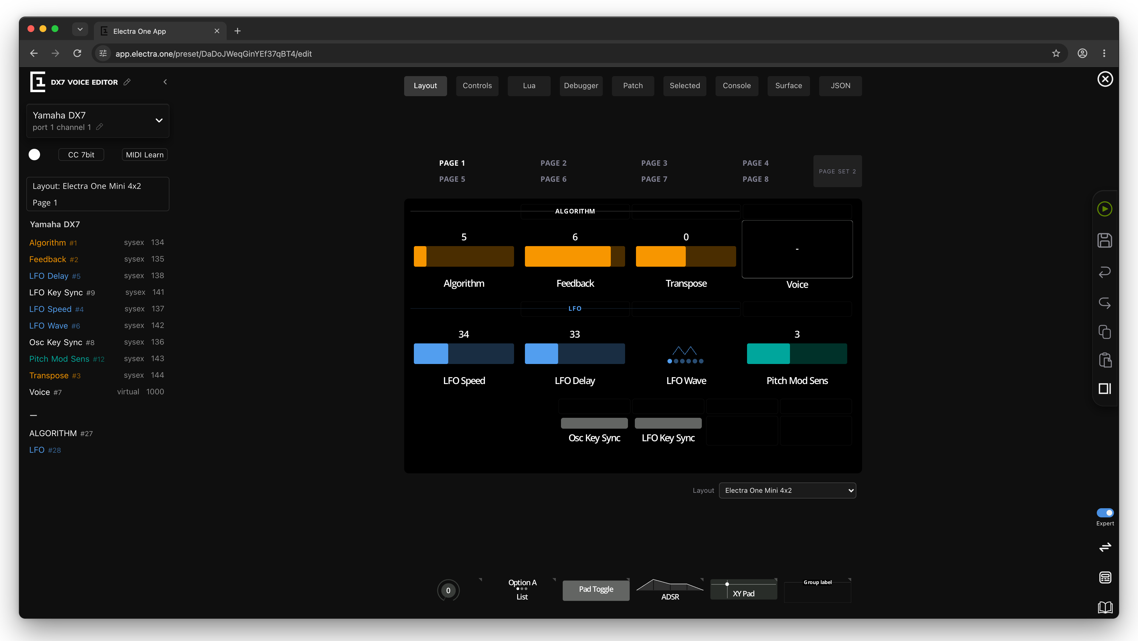

The Mini layout ​
Every project has a layout for each controller model. The Mini's layout is called Electra One Mini 4x2. Choose it in the Layout selector under the page. When the editor opens with a Mini connected, it shows the Mini layout.
The Mini layout in the editor
The Mini layout of the DX7 Voice Editor: two rows of four controls with group labels, and two pads in the button row
A project doesn't have to be created for the Mini: you can open any project and choose the Mini layout. A control that is placed in both the Mk2 and the Mini layout is one control with the same settings, so a preset can work on both models. See Using one control on both models.
The preview in the editor is the Mini's screen, 800 by 480 pixels.

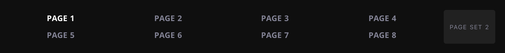

Pages and page sets ​
A Mini preset has 16 pages. The page strip over the grid shows eight of them, with a button to switch to the other half:
  • PAGE SET 2 shows pages 9 to 16.
  • PAGE SET 1 shows pages 1 to 8.
The page strip of the Mini
The page strip shows pages 1 to 8 and the PAGE SET 2 button
The controller shows the pages in the same two sets, on the eight pads of its page selection. A page without controls is not offered on the controller.
To move a page to the other set, drag it onto the PAGE SET button and hold it there until the set changes, then drop it on a page.
