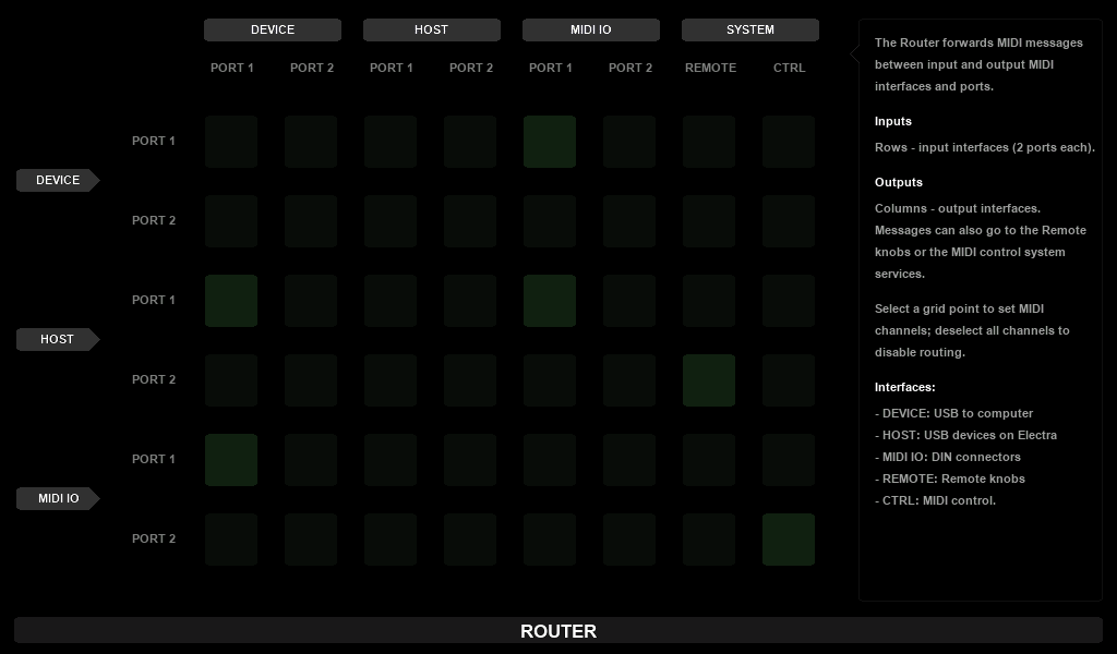

On Electra One Mk2, open ROUTER from the main menu. The screen is a grid: each row is a source, and each column is a destination. A lit square is an active route. Tap a square to select it, and the sidebar on the right shows its settings: tick All channels to turn the route on, or untick it to turn the route off. The last two columns, REMOTE and CTRL, send messages to the remote knobs and to MIDI control. For those you can also pick Individual channels. Your changes are saved when you close the screen.
The Router screen of Electra One Mk2
Electra One Mk2: a computer and a USB keyboard connected to a synthesizer on MIDI IO Port 1, a second USB controller on the remote knobs, and a footswitch on MIDI control
In the picture, your computer plays the synthesizer on <MIDI IO> Port 1 and receives its replies, a USB keyboard plays the synthesizer and records into the computer, a second USB controller moves the remote knobs, and a footswitch on <MIDI IO> Port 2 runs MIDI control commands.

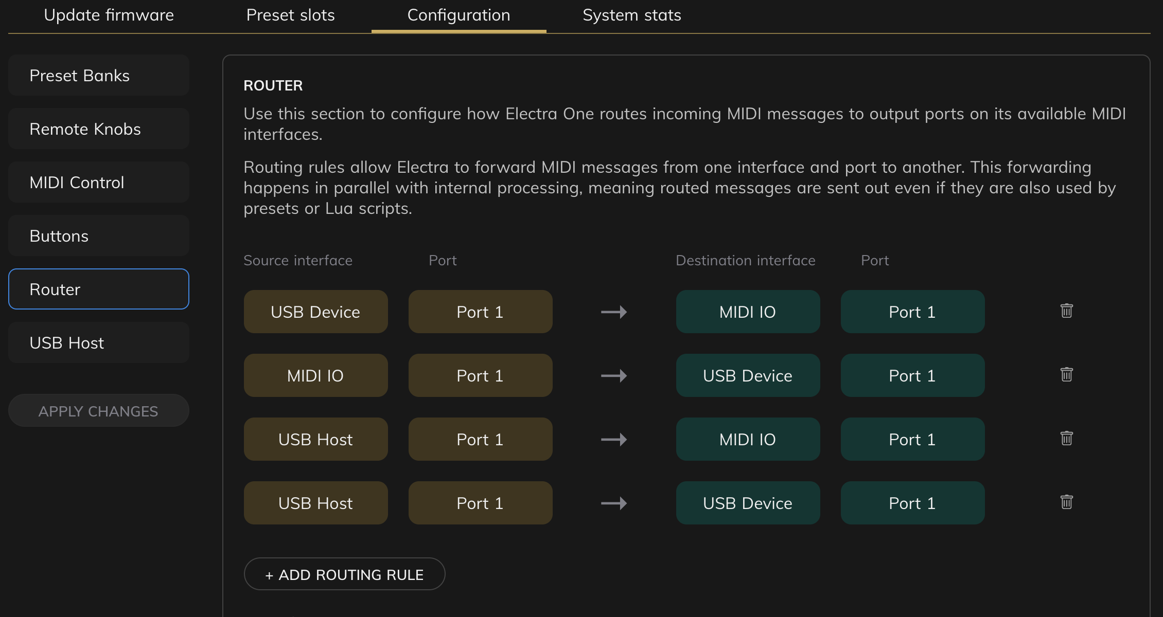

On Electra One Mini, and on the Mk2 too, you set routes in the Electra One app. Open CONTROLLER, choose the Configuration tab and then Router. Each row is one route, from a source interface and port to a destination interface and port. Add a route with + ADD ROUTING RULE, remove one with its bin icon, and click APPLY CHANGES to send them to the controller.
Routes in the Electra One app
The Router settings in the Electra One app: four routes connecting a computer, a USB keyboard and a synthesizer on MIDI IO
Routes to the remote knobs and to MIDI control are set on the Remote Knobs and MIDI Control tabs next to it.
