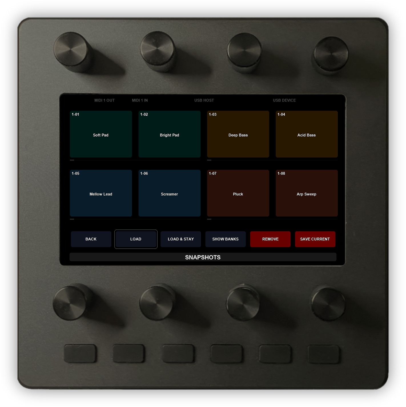

When you load a snapshot, Electra One sets all the controls to the stored values and sends the values to your instruments. If any Lua functions are bound to the saved values, Electra One calls them accordingly. The screen shows the new values, and the instruments play the sound you saved.
Electra One Mini showing a bank of snapshots
Electra One Mini: the SNAPSHOTS window with eight sounds of the Analog Poly preset

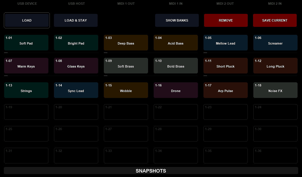

Each slot is labelled with its bank and position, for example 1-05 for the fifth slot of bank 1. A saved snapshot also has a name and a colour, so you can tell your sounds apart at a glance. Banks can have names too, such as "Live Set" or "Film Score".
The SNAPSHOTS window of Electra One Mk2
Electra One Mk2: one bank with room for 36 snapshots, of which 18 are used

On the controller, the SNAPSHOTS window shows one bank at a time. In the window you choose what a touch on a slot does: load the snapshot and close the window (LOAD), load it and keep the window open to try more sounds (LOAD & STAY), clear the slot (REMOVE), or save the current values into it (SAVE CURRENT). SHOW BANKS switches to another bank. On the Mk2 you touch the slots; on the Mini you press the knob next to a slot.

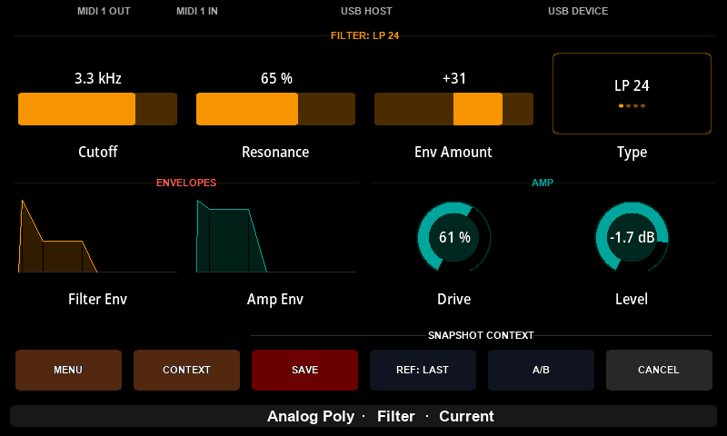

The Snapshot tool bar helps you create variations of a sound. It saves each variation into the next slot and lets you compare it with the snapshot you started from, without opening the SNAPSHOTS window again.
To start, choose SAVE CURRENT in the SNAPSHOTS window and hold a free slot: keep your finger on it on the Mk2, or keep the knob next to it pressed down on the Mini. A tap or a short press is not enough - that only saves the snapshot, and the window stays open without the tool bar. Hold for at least a second, until the window closes and the tool bar appears, and only then let go. Electra One saves the current sound into that slot and shows the tool bar on the page. On the Mk2 it takes the row above the controls; on the Mini it appears as the SNAPSHOT CONTEXT above the buttons.
The Snapshot tool bar on Electra One Mini
Electra One Mini: a variation with a darker cutoff and more resonance, ready to be saved with SAVE; the bottom bar reads Current
The first snapshot, the one you held, is your starting point. From then on you play and turn knobs as usual, and use the four buttons of the tool bar:
  • SAVE saves the current sound as a new variation, into the next slot of the bank. Press it every time you like what you hear. When the bank's last slot has been used, the button reads RETAKE: press it to start over from the first slot after your starting point. Your starting point itself is never overwritten.

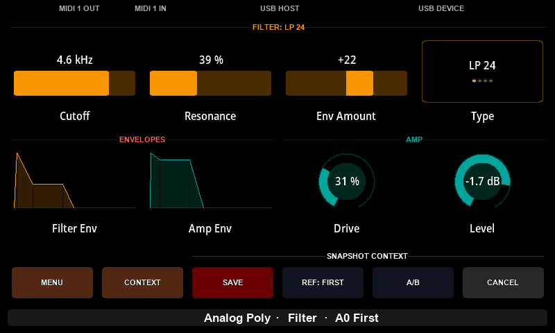

  • A/B switches between the reference and your current sound. Press it once to hear the reference, and again to return to your current sound, exactly as you left it.
  • REF: LAST and REF: FIRST choose the reference for A/B: the variation you saved last, or the snapshot you started from.
  • CANCEL closes the tool bar. Everything you saved stays in its slot.
Your current sound is whatever you are working on, saved or not. If you change something while A/B plays the reference, the changed sound becomes your current sound: the next press of A/B keeps it and plays the reference again, so no edit is lost.
While the tool bar is open, the bottom bar says what you are hearing, after the preset and page names: A0 First or D3 Last while A/B plays the reference, and Current otherwise. Each save is confirmed there for about two seconds, for example Snapshot D0 saved, with the name the new snapshot was given. On the Mk2, a tool bar button lights up when you touch it.
Opening the SNAPSHOTS window again closes the tool bar, as CANCEL does.
Comparing with the starting point on Electra One Mini
Electra One Mini: A/B with REF: FIRST plays the starting point, a brighter cutoff, and the bottom bar reads A0 First; pressing A/B again returns to the variation
