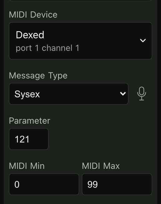

Put a dial on the page, call it OP1 Level, and give it Min 0 and Max 99 with MIDI Min 0 and MIDI Max 99 - the range a DX7 operator's output level has, with the number on screen the same as the number in the message.
Set Message Type to Sysex and Parameter to 121, which is what the DX7 calls operator 1's output level. Then open EDIT SYSEX DATA and write the message out, one byte at a time: the constants 43 for Yamaha, 10 for a parameter change on channel 1, 00 for the parameter group and 79 for parameter 121 in hexadecimal, and finally a Parameter value byte, which is where the knob's value goes. Leave Direction on Send only, and don't type F0 or F7 - the controller wraps the message itself.

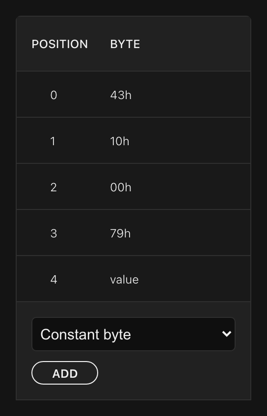

A control's own template
The SysEx editor: 43h, 10h, 00h, 79h and a value byte
Send to Electra, open the Console with IN on your controller's Port 1, and turn the knob:
F0 43 10 00 79 01 F7
F0 43 10 00 79 02 F7
That is a DX7 parameter change, and a real DX7 would move its operator 1 output level to match.

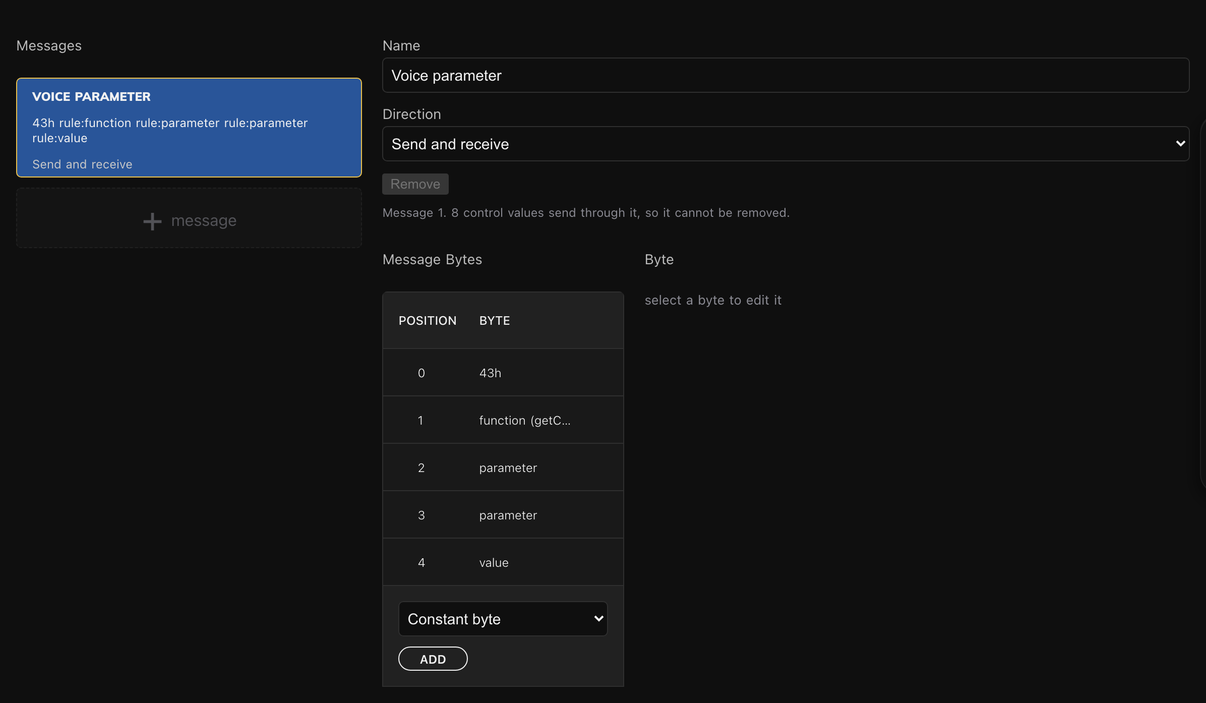

Clear the selection, open the Patch tab and its Messages sub-tab. This is the device's own library of templates, and it is empty.
Click + message and name it Voice parameter. Give it the same bytes as before with one difference: where you typed the constants 00 and 79, add two Parameter number bytes instead. A Parameter number byte inserts the Parameter of whichever control is using the message - the field that did nothing at all a moment ago. For now leave the first at its default and give the second the default too; we will come back to the first in the next step.
The device's message library
The Messages tab: Voice parameter, made of 43h, a function byte, two parameter bytes and a value byte
The last byte needs no setting up either. In a device message a Parameter value byte always carries the value of the control using it, so the editor does not even offer you the list of parameters it offers in a local template. There is only one answer it could be.
Now point the controls at it. Select OP1 Level and change Sysex Data from Local Sysex message to Voice parameter. The EDIT SYSEX DATA button disappears: the bytes belong to the device now, not to this control. Do the same for OP2 Level.

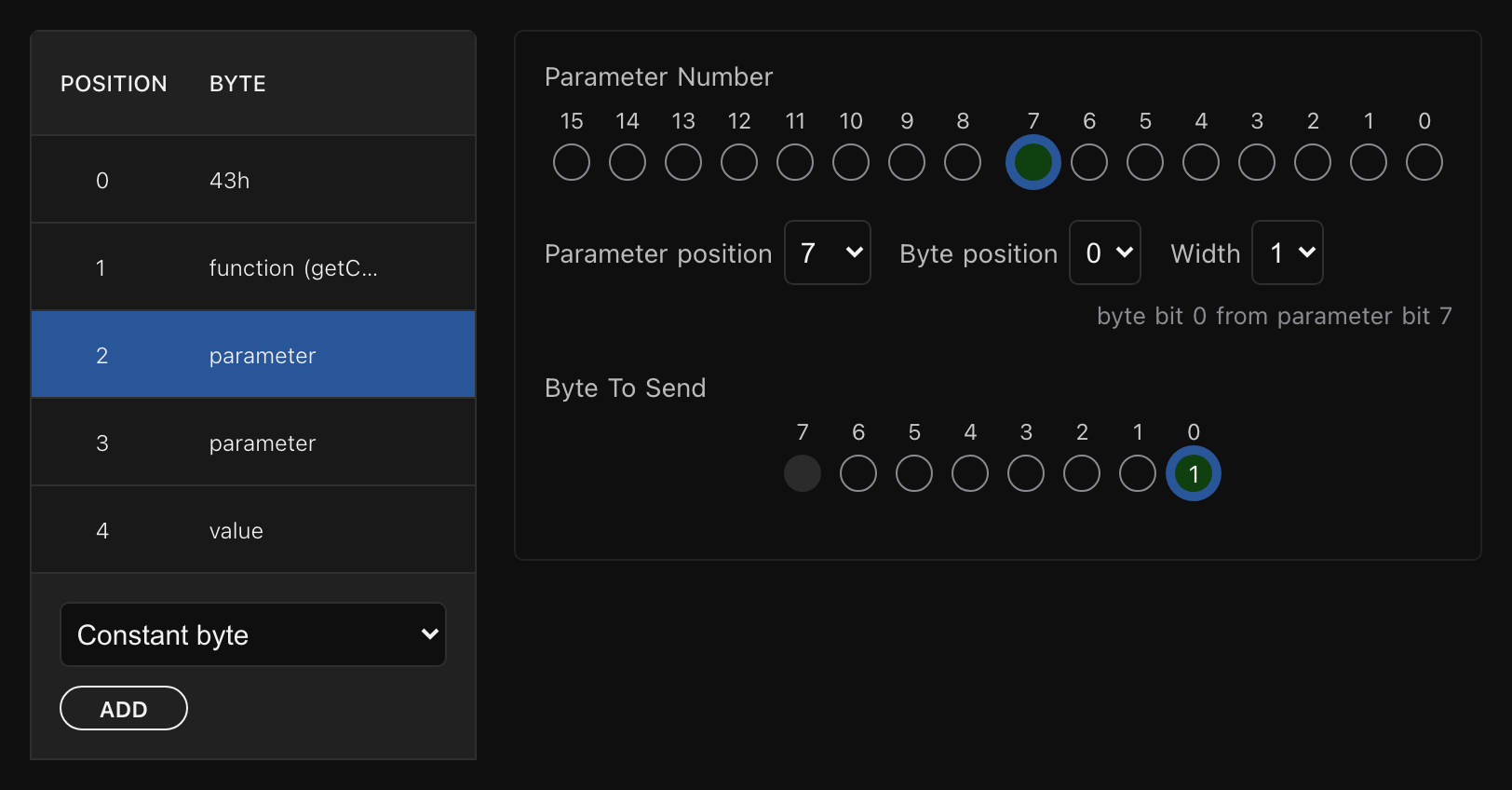

A SysEx data byte holds seven bits, so it counts to 127 and no further. Our parameter byte takes the lowest seven bits of the number and throws the eighth away: 134 is 1000 0110, and the seven bits that fit are 000 0110, which is 6.
The dangerous part is what happens next. Parameter 6 is not a gap in the DX7's numbering - it is operator 6's EG level 3. Turning the Algorithm knob does not fail. It quietly rewrites the envelope of operator 6, because what reached the instrument was a perfectly well formed message asking for exactly that.
This is why the real message has two bytes for the parameter number, and why the DX7's manual calls the first one a parameter group: the eighth bit lives there. So select the first Parameter number byte and tell it to carry just that one bit - Parameter position 7, Width 1, Byte position 0.
The parameter number split over two bytes
The Parameter number byte: bit 7 of the parameter word going into bit 0 of the byte
The picture is worth more than the three numbers. The top row is the parameter number, sixteen bits wide, with the one bit this byte carries lit. The bottom row is the byte that will be sent, with that bit in place. Underneath, in words: byte bit 0 from parameter bit 7.
Send again and turn every knob on the page:
F0 43 10 00 79 3F F7     ← OP1 Level, 121: bit 7 is 0, so the group byte is 00
F0 43 10 01 06 1F F7     ← Algorithm, 134: bit 7 is 1, so the group byte is 01
F0 43 10 01 07 05 F7     ← Feedback, 135
The six operator levels are unchanged, because their numbers are all below 128 and their eighth bit is zero. The two that were broken are fixed. One edit, in one place, and the whole page is correct - where the same fix across eight local templates would have been eight edits, and across a DX7 editor, 155.

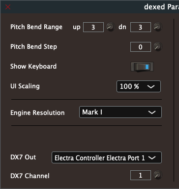

Our instrument sends its own parameter changes: move a slider on a DX7 and it puts the same message on the wire that it accepts. Dexed does too. Open its PARM dialog, set DX7 Out to your controller's Port 1 and DX7 Channel to 1.
Dexed's MIDI settings
Dexed's PARM dialog: DX7 Out set to the controller's Port 1, DX7 Channel 1

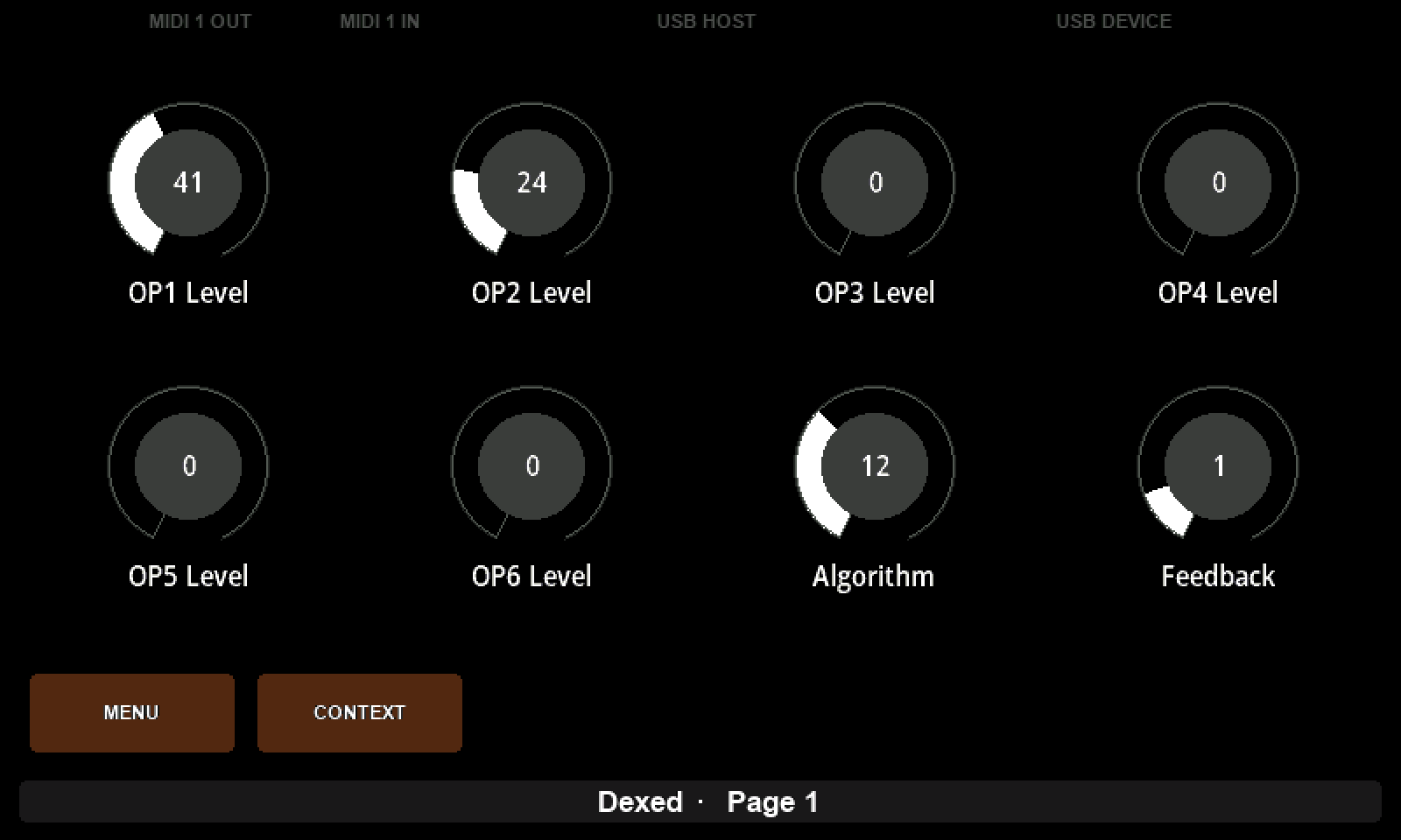

Then turn the message around. On the Messages tab, set Direction to Send and receive and send to Electra. Now turn knobs in Dexed - operator 1's Level, operator 2's, and the Algorithm - and watch the controller:
The controls following Dexed
Electra One Mini: OP1 Level 41, OP2 Level 24 and Algorithm 12, all moved from Dexed
Three knobs in Dexed, three different controls on the Electra, one template. Nothing in the preset says which message means which control; the parameter bytes say it, and the controller reads them back out.
The Algorithm is the proof. It arrives as 43 10 01 06 0B, and the controller has to put 01 and 06 back together into 134 before it knows which control the message is about. The same two bytes that split the number on the way out reassemble it on the way in.
