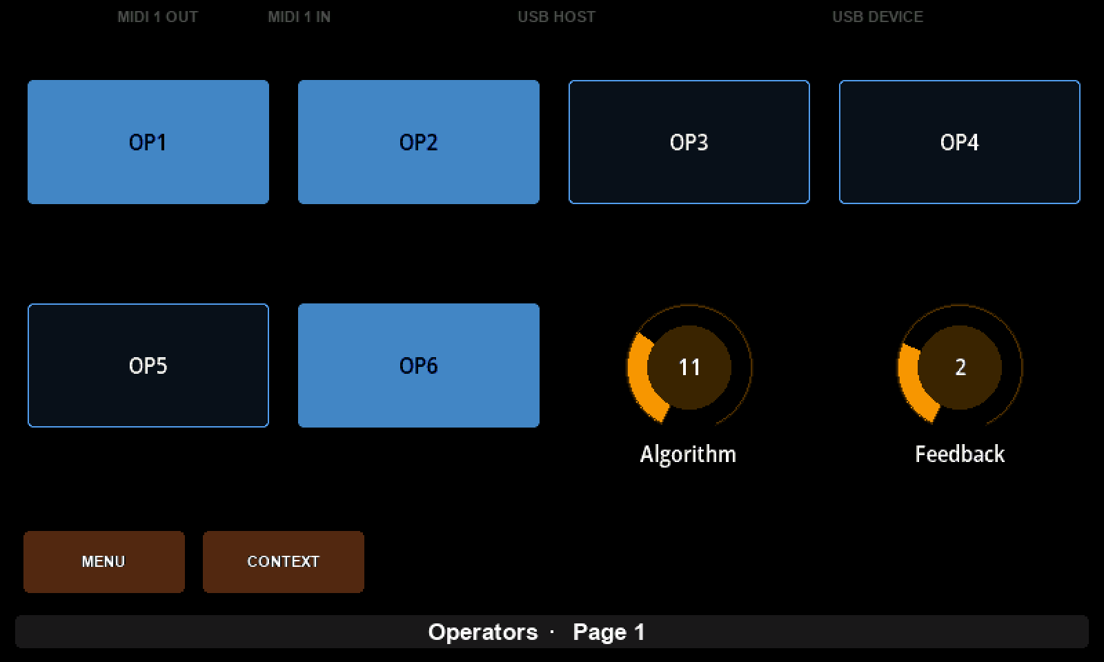

One preset, Operators, one page, eight controls - the operator section of a DX7:
WhatMessageWhat it teaches
Algorithm dial, 1 to 3243 10 01 06 + valuea message written byte by byte
Feedback dial, 0 to 743 10 01 07 + valuea parameter that needs only three bits
six pads, OP1 to OP643 10 01 1B + valuesix parameters sharing one byte
The first two are ordinary: one control, one message, one value. The six pads are the reason for the tutorial.
The finished preset
Electra One Mini: six operator pads, an Algorithm dial and a Feedback dial

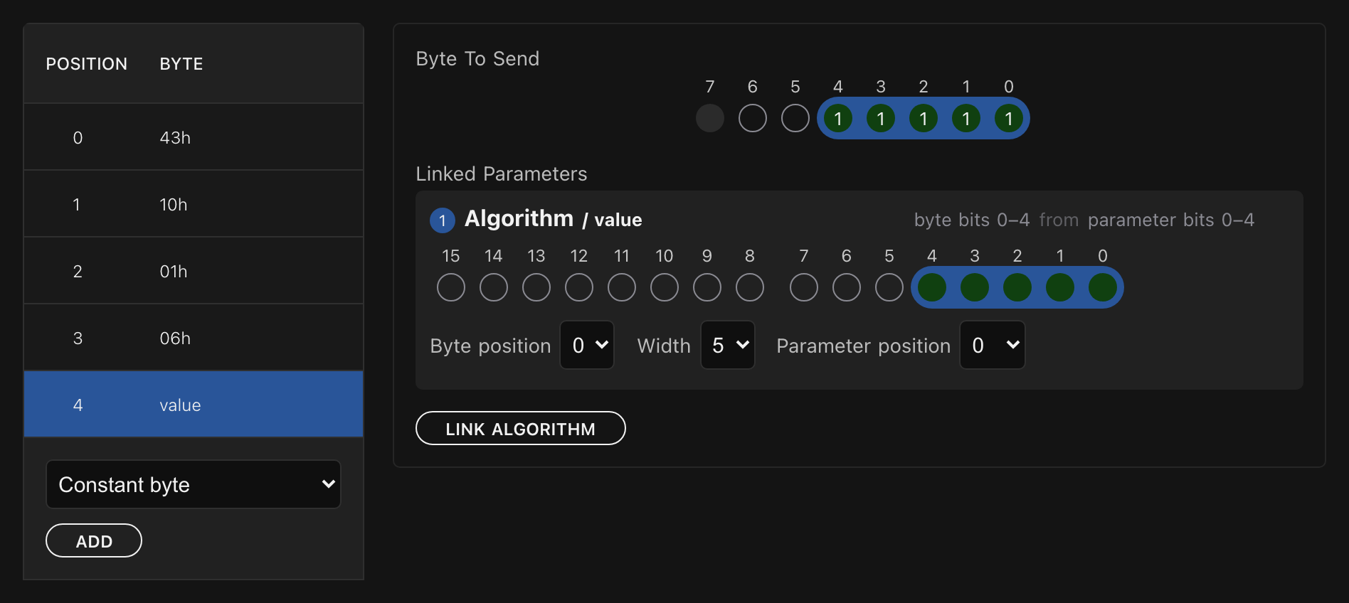

Start from an empty preset called Operators and give it one device: click an empty part of the page so nothing is selected, then name the device Dexed, with Port 1 and Channel 1.
Add a dial called Algorithm. Give it Min 1 and Max 32, MIDI Min 0 and MIDI Max 31, Message Type Sysex and Parameter 134. Then open EDIT SYSEX DATA and add five bytes: the constants 43, 10, 01 and 06, and a Parameter value byte at the end. Don't type F0 or F7 - the controller wraps the message itself.
Send to Electra, open the Console with IN on your controller's Port 1, and turn the knob:
F0 43 10 01 06 00 F7
F0 43 10 01 06 1F F7
A control's own message
The SysEx editor: 43h, 10h, 01h, 06h and a value byte carrying the Algorithm

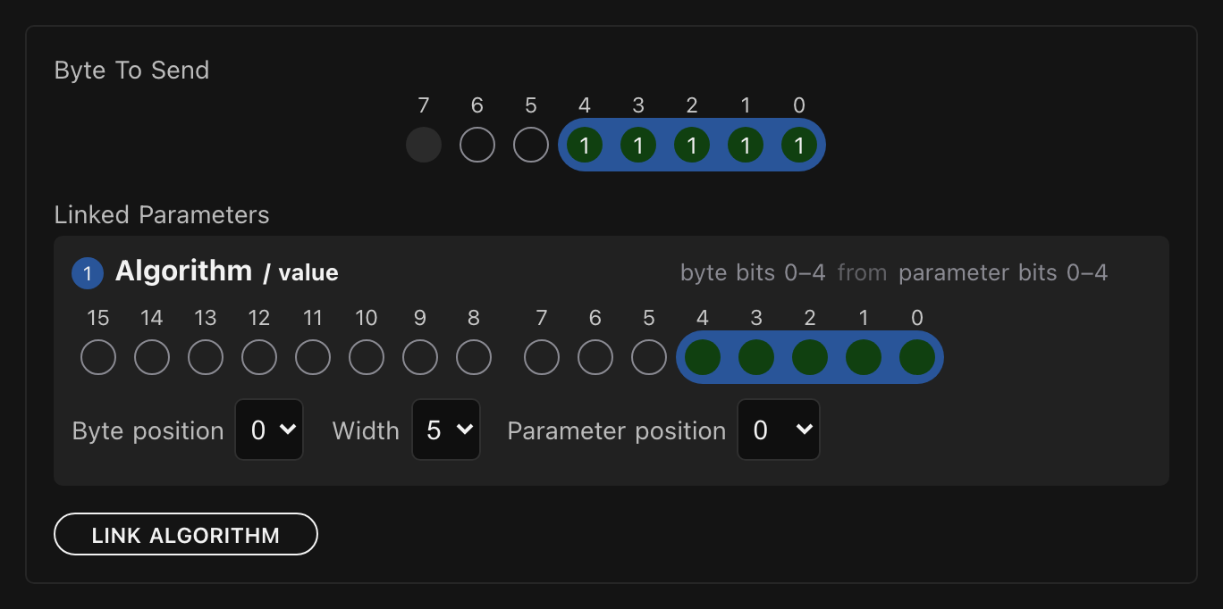

Open Algorithm's value byte and look at Width. It says 7, and the DX7's algorithms only need five bits to count to 31. Set it to 5. Do the same on Feedback, which needs three.
Send again and sweep both. Nothing changes. The bytes are identical.
That is worth understanding rather than shrugging at. Width is a claim on the byte, not a change to the value: it says how many of the seven bits this parameter is entitled to. With one parameter in the byte nothing else wants those bits, so claiming three or seven makes no difference to what goes out.
In the next step six parameters want the same byte, and the claim is the only thing keeping them apart.
Five bits of seven
The Algorithm's rule: byte bits 0 to 4 from parameter bits 0 to 4, with bits 5 and 6 left empty

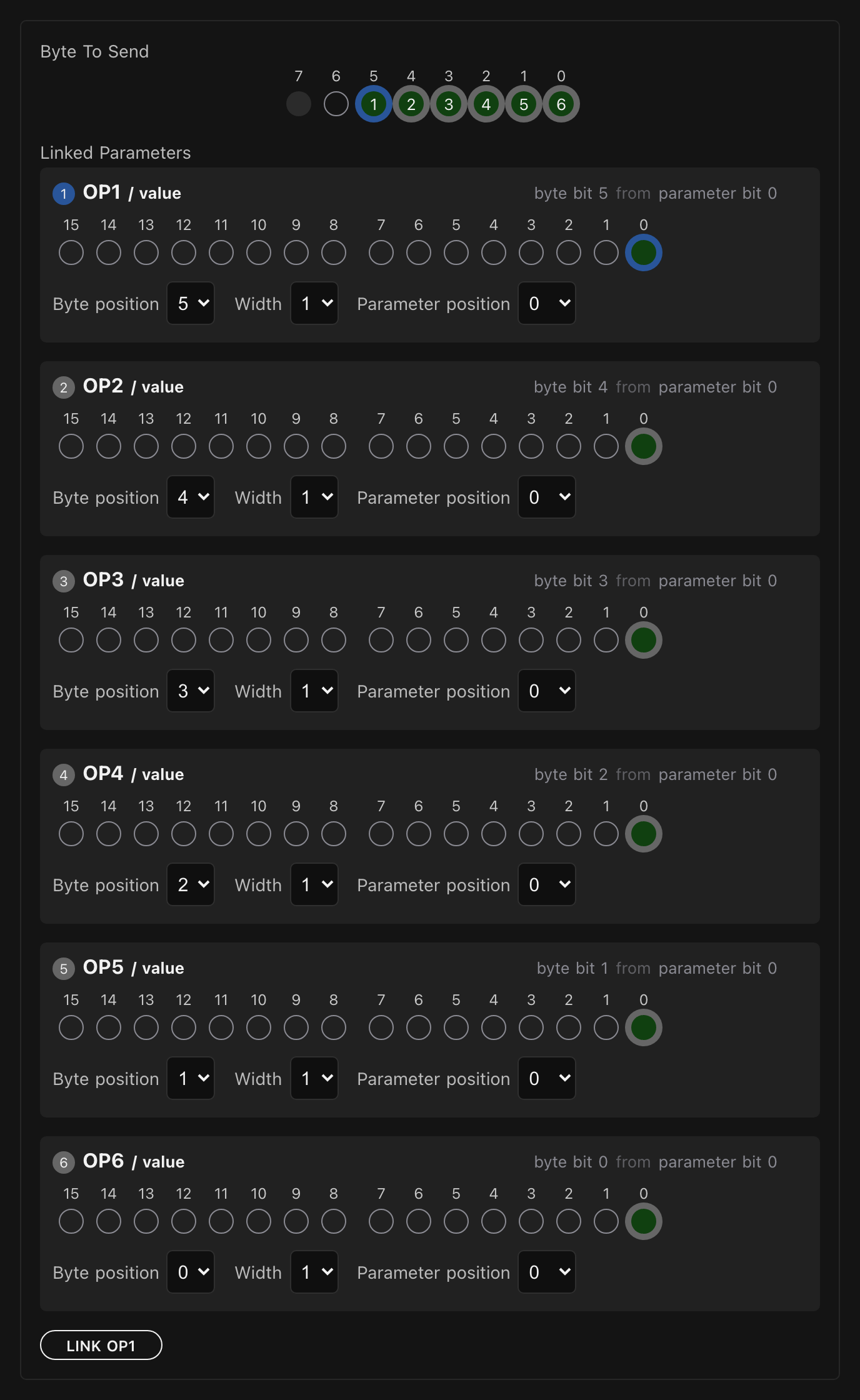

Build the template on OP1 only: constants 43, 10, 01, 1B, then a Parameter value byte. 01 1B is the DX7's operator on/off, and everything interesting now happens inside that last byte.
Putting six parameters in one byte ​
Select the value byte. It already has one rule, for OP1, seven bits wide - the whole byte. Three numbers describe it:
FieldWhat it means
Byte positionwhich bit of the outgoing byte the field starts at
Widthhow many bits it gets
Parameter positionwhich bit of the control's value to take
Two bit numberings sit side by side there, and that is what trips people: the word drawn on the rule card is the control's value, and Byte position is where it lands in the message.
Narrow OP1 first. Set its Width to 1 and its Byte position to 5, leaving Parameter position at 0 - a pad's value is 0 or 1, so bit 0 is the whole story. This matters before anything else: a new rule is dropped into the widest run of free bits, and while OP1 claims all seven there is no free run to drop one into.
Then, five times over:
  1. Click the next pad in the Preset Values list on the right. The button relabels itself - LINK OP2, then LINK OP3, and so on. Selecting a pad changes nothing on its own; it aims the button.
  2. Click that button. A new rule card appears, numbered.
  3. On the new card set Width to 1 first, then Byte position.
Width before byte position, because moving a field to a high bit trims its width to the room left and you would only have to set it again.
The byte positions run 4, 3, 2, 1, 0 for OP2 down to OP6, which is the order the DX7 uses:
bit   6   5   4   3   2   1   0
          OP1 OP2 OP3 OP4 OP5 OP6
Six parameters in one byte
Byte to send showing rules 1 to 6 across bits 5 down to 0, and the six rule cards below it

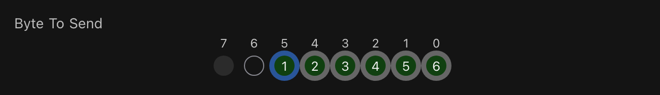

4. Reading the picture ​
The Byte to send strip above the rules is the byte itself, and every bit carries the number of the rule that claims it. When all six are in it reads 1 2 3 4 5 6 across bits 5 down to 0, with bit 6 empty because the DX7 does not use it and bit 7 greyed out because a SysEx data byte never has one.
The byte itself
The Byte to send strip: bits 5 to 0 marked 1 to 6, bit 6 empty, bit 7 greyed out
Each rule card says the same thing in words - byte bit 3 from parameter bit 0 - which is the quickest way to check a rule without counting circles. And clicking a pad in Preset Values lights up the bit it owns, so you can walk the list and confirm you have them the right way round.
The strip also warns you about the two ways this goes wrong. Two rules on one bit are not refused: the controller ORs them together, which is almost never what anybody meant. A rule running past bit 6 is not sent at all. Both are said in words under the byte, naming the rules involved.
