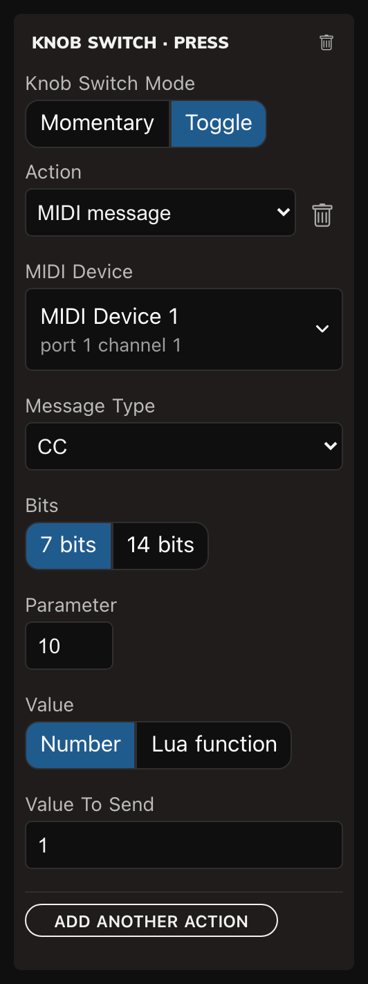

Set Knob Switch Mode to Toggle. In momentary mode a press runs the Press actions and letting go runs the Release ones; in toggle mode letting go does nothing at all, and the next press runs the Release actions instead. The two edges of one gesture become two alternating states.
So give it both edges. Leave the Press action sending 1, then ADD EVENT → Knob switch · Release, and give that one an action sending CC 10 value 0.
The press event
KNOB SWITCH · PRESS in Toggle mode, with a MIDI message action sending CC parameter 10, value 1
Send, and press the knob twice: cc 10 1, then cc 10 0, and round again. Read the times rather than the values, because momentary mode sends those very same two lines - one on the way down, one on the way up, a fraction of a second apart. In toggle mode there is a whole press between them.

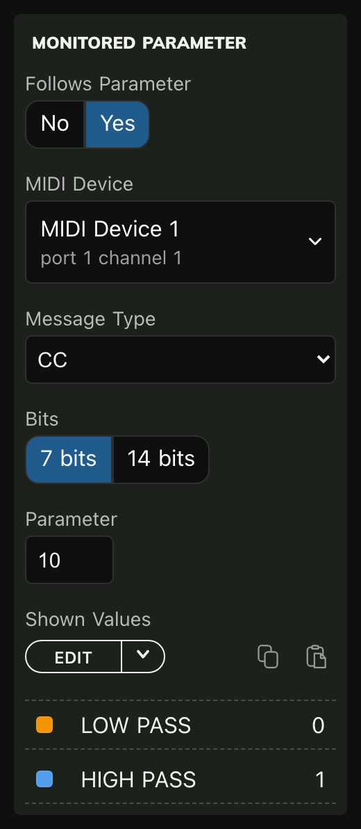

A group can. Drag a Group label onto the thin row directly above Cutoff, name it Filter type, and set Variant to Button - which draws it as a pad-shaped label rather than a line. Then switch Follows parameter on, give it the same device, CC and parameter 10, and under Shown values name 0 LOW PASS and 1 HIGH PASS, each in its own colour.
The group's monitored parameter
Follows parameter set to Yes, CC parameter 10, with LOW PASS on 0 and HIGH PASS on 1

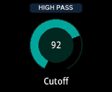

Send, and press the knob.
Low passHigh pass
The label changes its name and its colour with every press, and it did so without a knob, without a slot you could have put a control in, and without a line of script. That is worth pausing on: a group never sends anything, it only ever shows what a parameter is doing, which is exactly why it can sit there watching a parameter that something else owns.

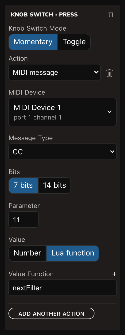

Two positions took two numbers. Four would take four, and a gesture has only two halves - so a press that steps 0, 1, 2, 3, 0, … has to work its value out rather than have it typed in. That is what the Value setting's second choice is for.
Drop another Dial on KNOB 2, name it Cutoff 2, give it CC, 7 bits, parameter 2, and add a Knob switch · Press event - leave this one Momentary, since there is nothing to alternate between - with one action: a CC message on parameter 11. Then open the Lua tab and write five lines.
filterType = 0
function nextFilter()
    filterType = (filterType + 1) % 4
    print("filter type " .. filterType)
    return filterType
filterType lives outside the function so that it survives from one press to the next, and % 4 wraps 3 back round to 0. The print is not decoration: it goes to the log under the script, prefixed lua:, and it is the cheapest way there is to watch an event fire.
Back on the action, switch Value from Number to Lua function and name nextFilter.
A Lua function as the value
The action's Value set to Lua function, with nextFilter in the Value Function field

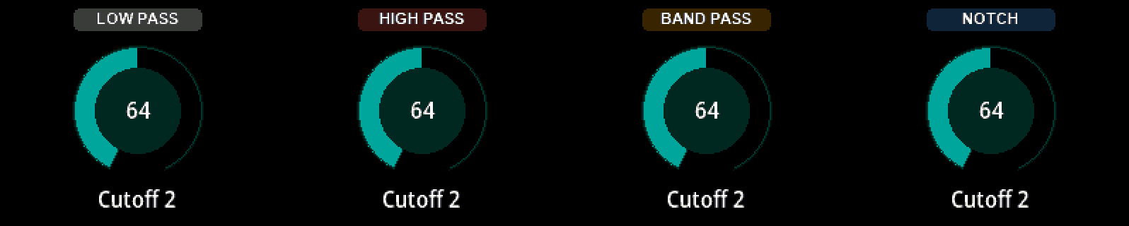

Give this dial a group of its own exactly as before - Filter type 2, Button, following CC parameter 11 - with four Shown values: 0LOW PASS, 1 HIGH PASS, 2 BAND PASS, 3 NOTCH. Send, and press the knob four times.
Four presses
The second dial under LOW PASS, HIGH PASS, BAND PASS and NOTCH in turn

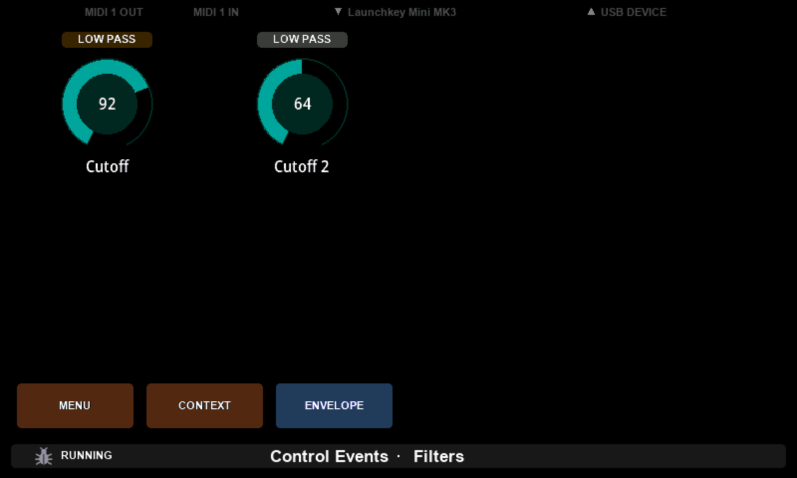

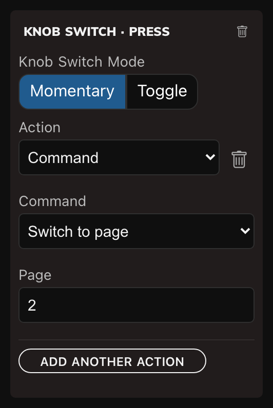

An action does not have to be a MIDI message. The third kind is a Command, something the instrument does to itself, and the useful one to start with turns a pad into a page button.
Name this page Filters and PAGE 2 Envelope, so there is somewhere to go. Then drop a Pad on the first slot of the Mini's button row, name it ENVELOPE, set its Message Type to None, and give it a Knob switch · Press event with one action: Command, Switch to page, Page 2.
A command action
The action set to Command, Switch to page, with Page 2
None is worth the moment it takes. A pad arrives with a message of its own and a pad that is really a button has no use for one - worse, a pad left on CC 1 is registered on the same parameter as Cutoff, so a CC 1 arriving from outside would drive them both.

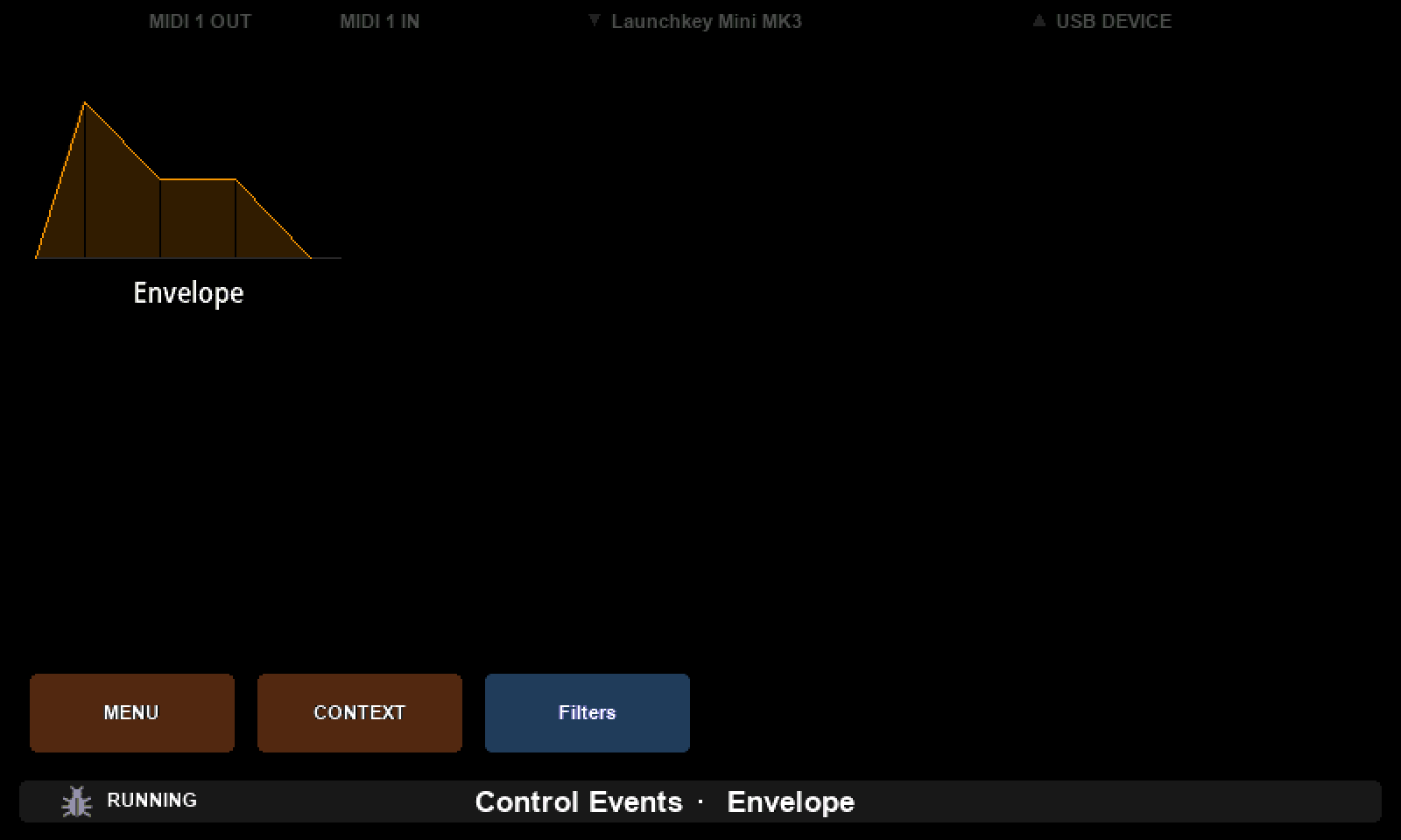

Now go to Envelope and give it something to be: drag an ADSR from the envelopes tile onto the top row, name it Envelope, and set its four values to CC 73, 75, 79 and 72. Envelopes are not what this tutorial is about, but four knobs under one control are exactly what the last step needs. Then put a pad on the same button slot, name it FILTERS, message type None, and give it the same event with Page 1.
The second page
The Envelope page: an ADSR on the first four knobs, and a FILTERS button under the screen
Send, and press the button under ENVELOPE. The page changes; press the one under FILTERS and you come back. On the Mini it is the third button along, because the first two are the instrument's own MENU and CONTEXT.

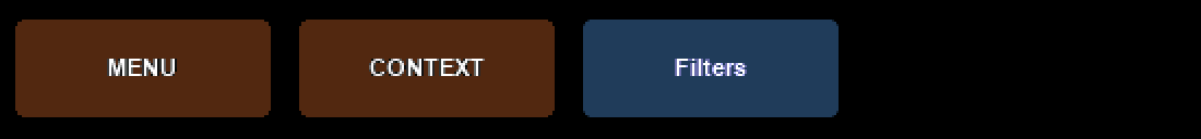

The buttons under the screen
MENU, CONTEXT and the preset's own FILTERS button
Notice what the pads do not do: they never light up, because they never toggle. That is the rule from step 2 doing real work - the switch event replaced the gesture, so the pad's own on and off is gone and the press is entirely yours. The name on it is a label now rather than a state.

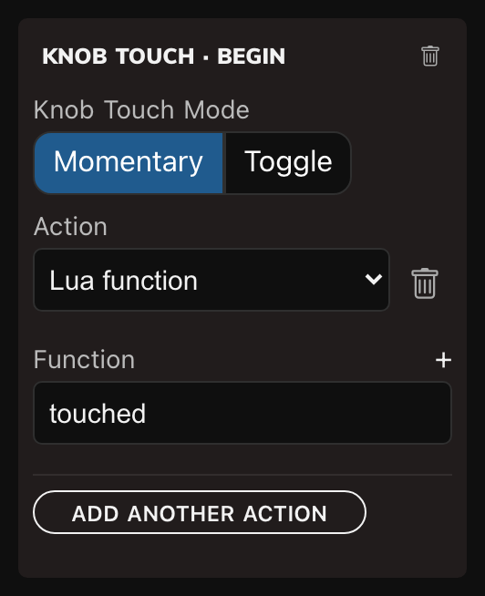

One last source. The knobs of both models are touch-sensitive, and a Knob touch event runs the moment a finger lands on one, before anything has been turned. Add this to the script:
function touched(control, source, event, pot, valueId, value)
    print(control:getName() .. " " .. valueId
          .. " on knob " .. pot .. " is " .. value)
Then select the ADSR, ADD EVENT → Knob touch · Begin, and give it one action: Lua function, touched.
A touch event
KNOB TOUCH · BEGIN with a Lua function action calling touched
Send, and brush the four knobs in turn.
