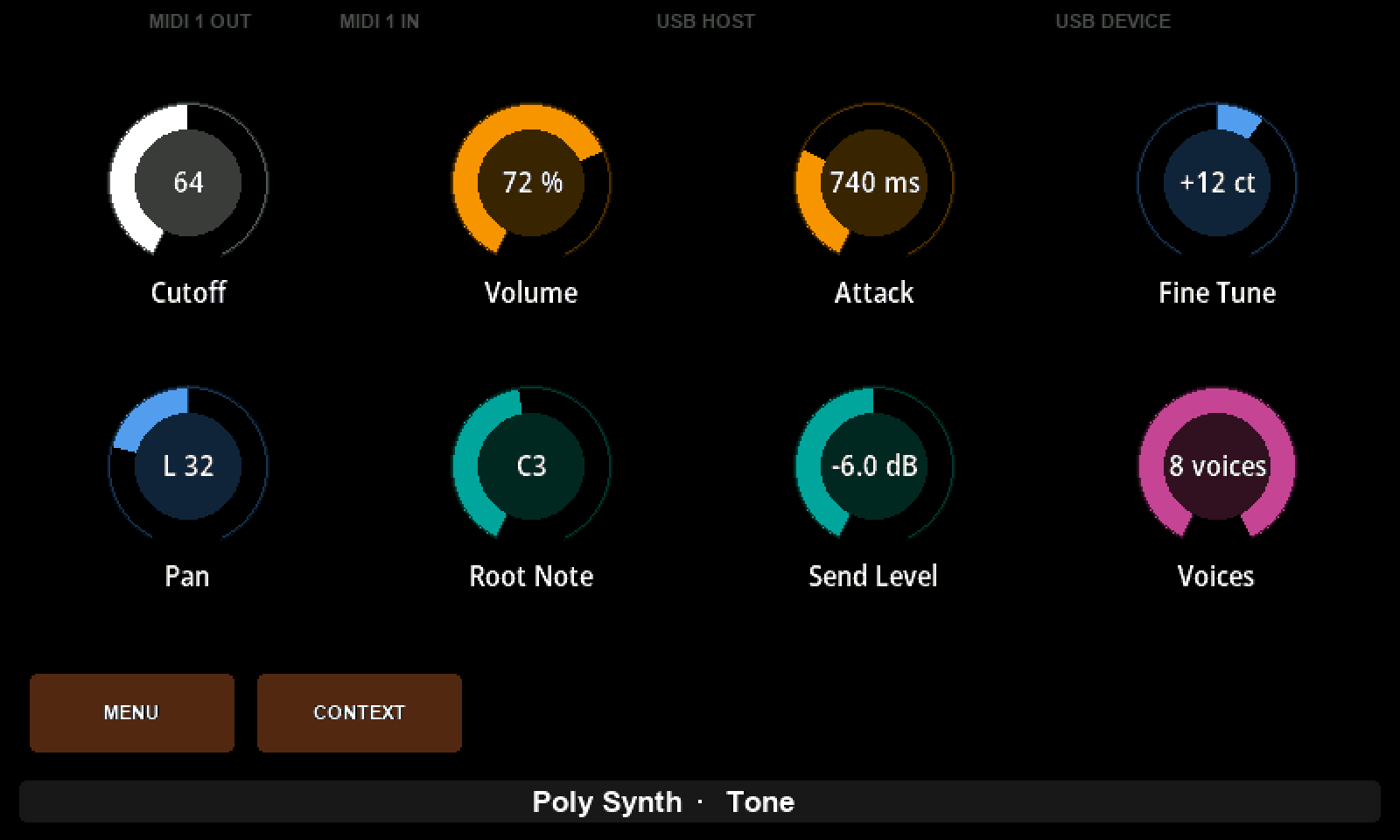

What we will build ​
One preset, Poly Synth, one page, eight dials. The first has no formatter at all, and is there for contrast. The other seven each show a different way of turning a number into something a musician reads without thinking.
The finished page
Electra One Mini: Cutoff 64, Volume 72 %, Attack 740 ms, Fine Tune +12 ct, Pan L 32, Root Note C3, Send Level -6.0 dB, Voices 8 voices
Cutoff says 64, which is what every one of them would say without a script. The others say 72 %, 740 ms, +12 ct, L 32, C3, -6.0 dB and 8 voices.

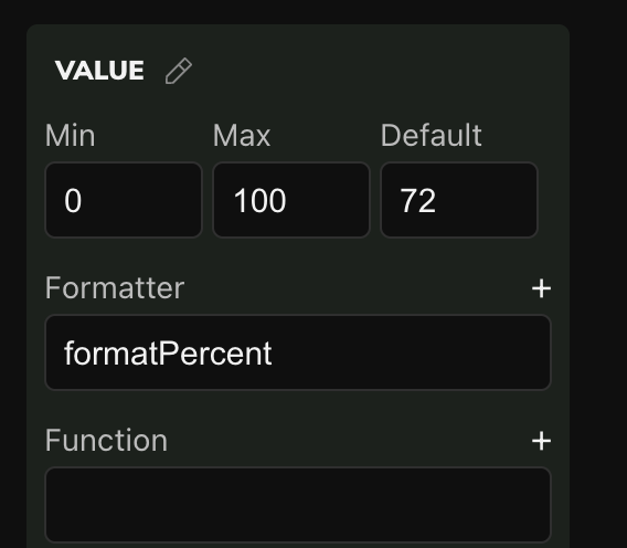

Put a dial on the page, call it Volume, and give it Min 0 and Max 100. Choose CC 7bit with Parameter 7 - a real volume control - and a Default of 72, so there is something to look at.
Now look at the VALUE card in the sidebar. Under the three range fields there is a field called Formatter, and this is the whole of the wiring: you type the name of a function, and the controller calls it.
The value card
The VALUE card: Min 0, Max 100, Default 72, and Formatter set to formatPercent
Type formatPercent into it. Then click the small + beside the label, and the editor writes an empty function of that name at the end of the preset's script, ready to fill in:
function formatPercent(valueObject, value)
    -- your code goes here and it must return a value to display
    return(value)
The + is a convenience, not a requirement - a formatter is found by name, so a function you write yourself on the Lua tab works just as well. What matters is that the name in the field and the name in the script are spelled identically.

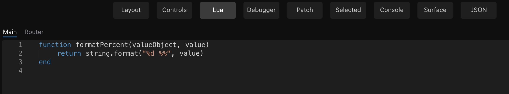

3. Your first formatter ​
Click the Lua tab, along the top of the editor. The whole preset has one script and this is it, so every formatter you write from here on goes in this one place - including the empty one the + just added.
Replace its body with a single line:
    return string.format("%d %%", value)
The Lua tab
The Lua tab of the editor, holding the formatPercent function and nothing else
string.format builds a piece of text from a pattern and some values. %d means "put a whole number here", and everything else in the pattern is text that comes out as it went in. The doubled %% is how you write a single % sign, because a lone one would be read as the start of another instruction.
Click Send to Electra and turn the knob. It says 72 %.

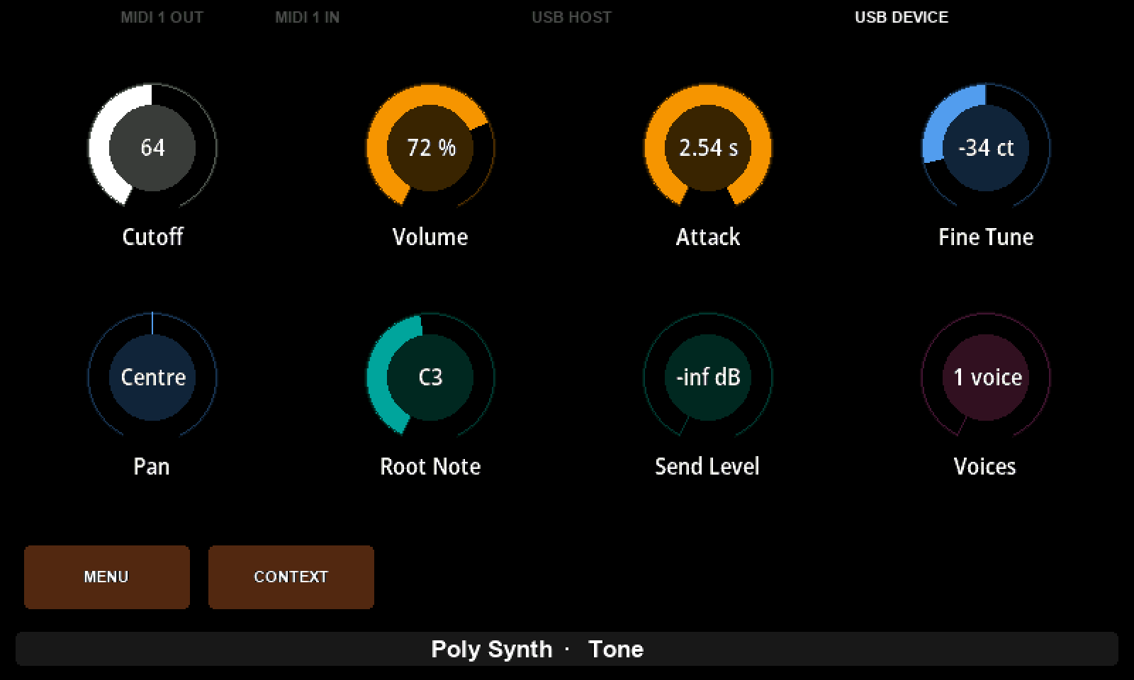

5. Seeing the awkward values ​
A formatter is only as good as its worst case, and its worst cases are the ends. Turn every knob to an extreme and look:
The awkward values
The same page: Attack 2.54 s, Fine Tune -34 ct, Pan Centre, Send Level -inf dB, Voices 1 voice
Attack has crossed into seconds, Fine Tune has gone negative, Pan sits at Centre, Send Level shows -inf dB where the arithmetic would have failed, and Voices has remembered to say voice rather than voices. Those five are exactly the cases the if lines were written for, and the only way to know they work is to go and look at them.
