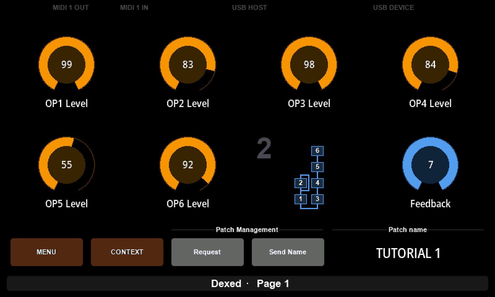

What we will build ​
The same preset, with the Algorithm dial turned into a diagram.
The finished page
Electra One Mini: six operator dials, the algorithm drawn as six numbered boxes with their connections, and the Feedback dial beside it
The number stays as a grey watermark in the corner, because it is still worth knowing; the diagram is the point.

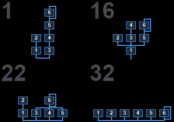

Four algorithms
Algorithms 1, 16, 22 and 32, each drawn as boxes and lines
Algorithm 1 is two stacks; 16 is a tree into a single carrier; 22 has one operator modulating three; 32 is six carriers side by side. The one thing they share is the line along the bottom, which is the output.

3. The grid the DX7 draws on ​
The thirty-two algorithms are data, and the data is a layout. Every one of them places six operators on a grid six columns wide and four rows deep, and every operator carries two more facts: what it connects to below it, and whether it has a feedback loop.
That is five numbers per operator, thirty per algorithm:
-- which operator, its column, its row, the link below it, its feedback loop
local ALGORITHMS = {
    { 6,3,0,0,1,  5,3,1,0,0,  4,3,2,0,0,  3,3,3,2,0,  2,2,2,0,0,  1,2,3,1,0 },
    { 6,3,0,0,0,  5,3,1,0,0,  4,3,2,0,0,  3,3,3,2,0,  2,2,2,0,1,  1,2,3,1,0 },
    -- ...thirty more
Read the first row as: operator 6 sits in column 3, row 0, draws a line straight down, and has a feedback loop; operator 5 is under it doing the same without the loop; and so on down to operator 1, which joins the output.
The layout is the DX7's own, the one Dexed draws, so a reader who knows the synthesizer recognises it immediately. The whole table is in the script; there is no insight in retyping it.

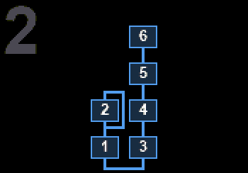

The algorithm from a dump
Algorithm 2 drawn after a voice dump arrived: the feedback loop is on operator 2
Send a voice dump at the controller and the diagram redraws itself. The picture above is algorithm 2 arriving that way - note the feedback loop on operator 2, where algorithm 1 has it on operator 6. Nothing was turned; the drawing simply followed the sound.
