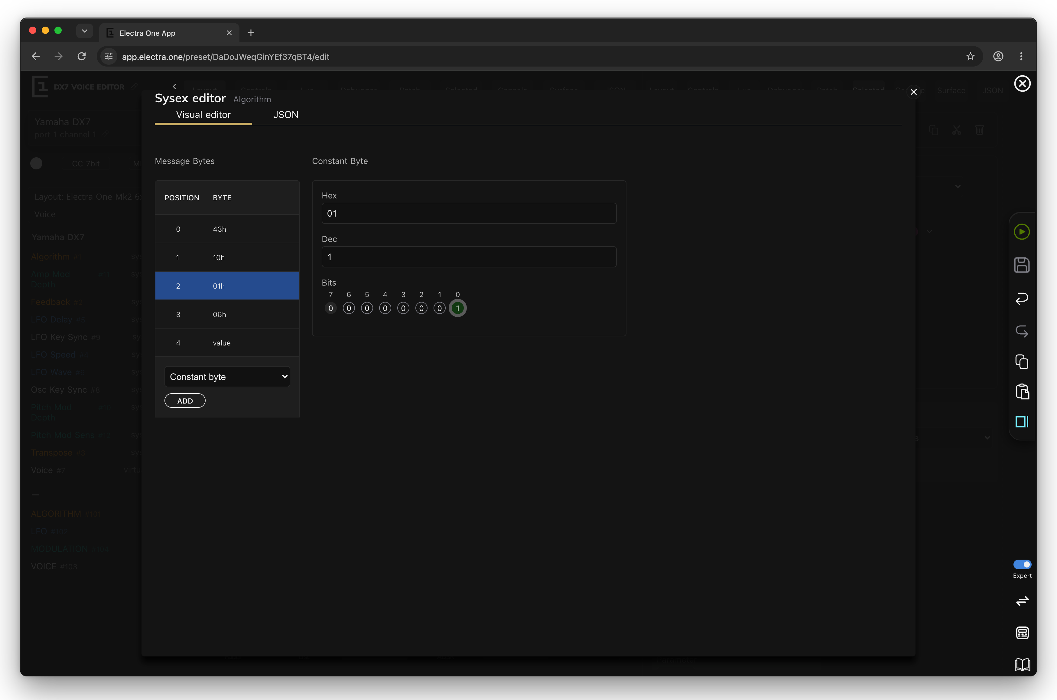

The SysEx editor
The Algorithm control's template: 43 10 01 06 and the value, with the value byte selected
The editor has two tabs, Visual editor and JSON. Changes take effect at once; there is no OK button. Close the editor with the cross, or with Close, and go back when it is open beside the grid.
An empty template offers Duplicate from the last message you edited, adjusted to this control's parameter, to start from a similar message.
On the left, Message Bytes lists the bytes in order. Click a byte to edit it on the right. To add a byte, choose its type under the list and click ADD; drag a byte by its handle to move it, and click the bin to remove it.
F0 and F7 are not part of the template. Electra One adds them when it sends the message, and leaves out any F0 or F7 typed into the template. A message can be up to 512 bytes long.

Constant byte ​
A fixed number, typed in Hex or Dec, or set by clicking its Bits. The Algorithm template has four: 43, 10, 01 and 06.
A constant byte
The group byte 01h as a constant
A data byte in a SysEx message has 7 bits. The editor warns if bit 7 is set, because such a byte would be read as the start of another message.

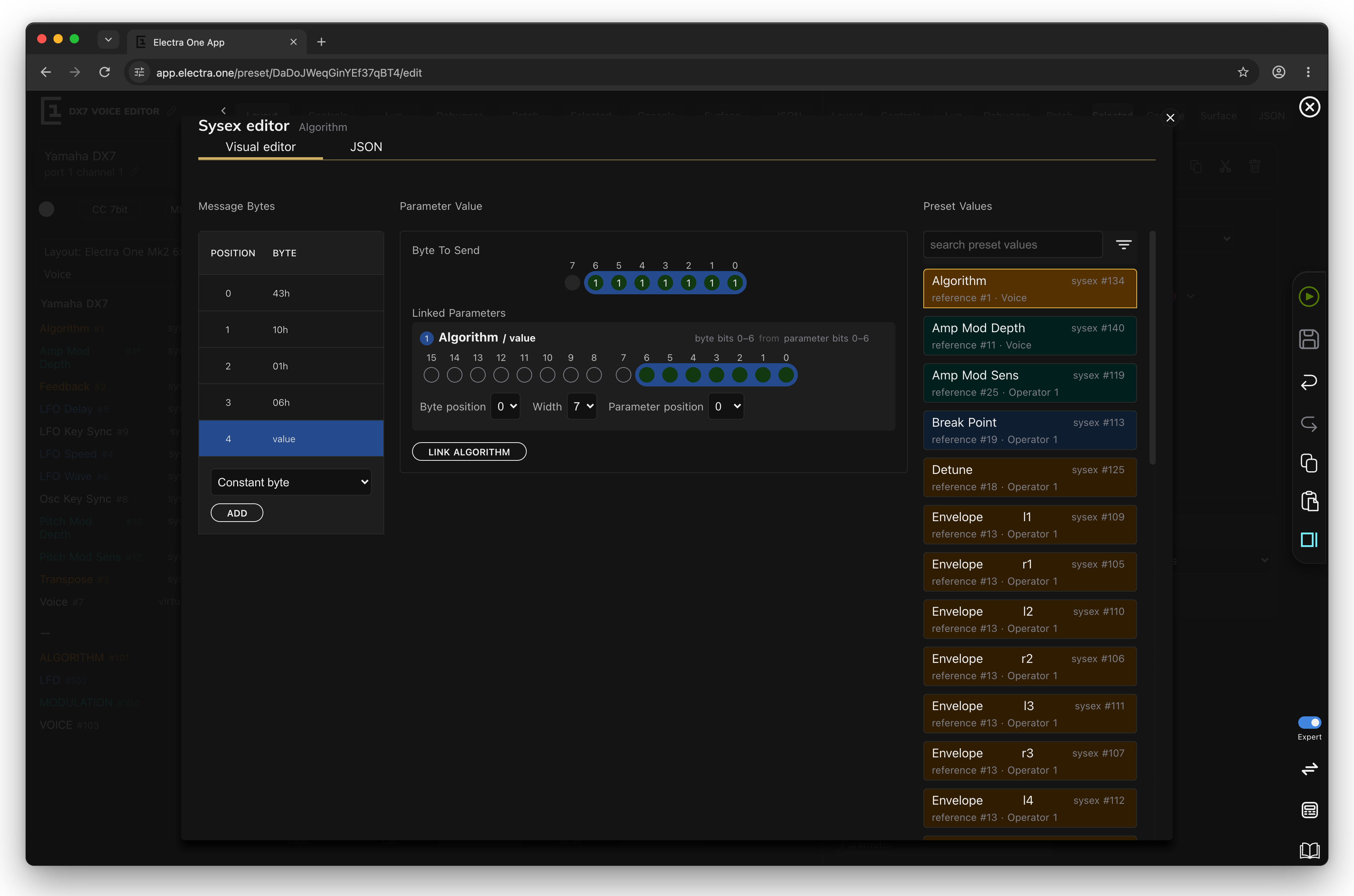

Parameter value ​
This is where the control's value enters the message. A Parameter value byte takes bits of a value and places them in the byte. In the simplest case, and in most templates, the byte is the value: all 7 bits of it, in bits 0 to 6.
The form shows:
  • Byte To Send: the 7 bits of the byte, with the number of the rule each bit comes from.
  • Linked Parameters: one card per rule. Each rule copies Width bits, starting at Parameter position in the value, into the byte at Byte position. Click the bits of the parameter word to choose them, Shift-click to extend the selection.
  • Preset Values: the values of the control's device. Select one and click LINK name to add a rule for it; the rule goes into the free bits of the byte. By default a new byte is linked to the control's own value. In a device message, a Parameter value byte always carries the value of the control that uses the message, and this column is not shown.
Byte To Send warns when two rules claim the same bit and when a rule runs past bit 6.
Why rules and not simply "the value"? Because instruments pack their data. Some store two parameters in one byte, such as a waveform in bits 0 to 2 and an octave in bits 4 to 6. Others spread a 14-bit value over two bytes. With rules, one byte can carry bits of several parameters, and one parameter can fill several bytes:
Byte positionWidthParameter positionMeaning
070the whole 7-bit value
040the lowest 4 bits of the value, in bits 0 to 3
430the lowest 3 bits of the value, in bits 4 to 6
077the upper 7 bits of a 14-bit value (its MSB)
The value sent is the MIDI value of the control, after the display range has been mapped to the MIDI range. See Values: display and MIDI.

  1. Add four Constant byte entries: 43, 10, 01 and 06.
  2. Add a Parameter value byte. It is linked to the control's own value, all 7 bits.
  3. Set the control's range: Min 1, Max 32, MIDI Min 0, MIDI Max 31.
Turning the knob to algorithm 6 now sends F0 43 10 01 06 05 F7.

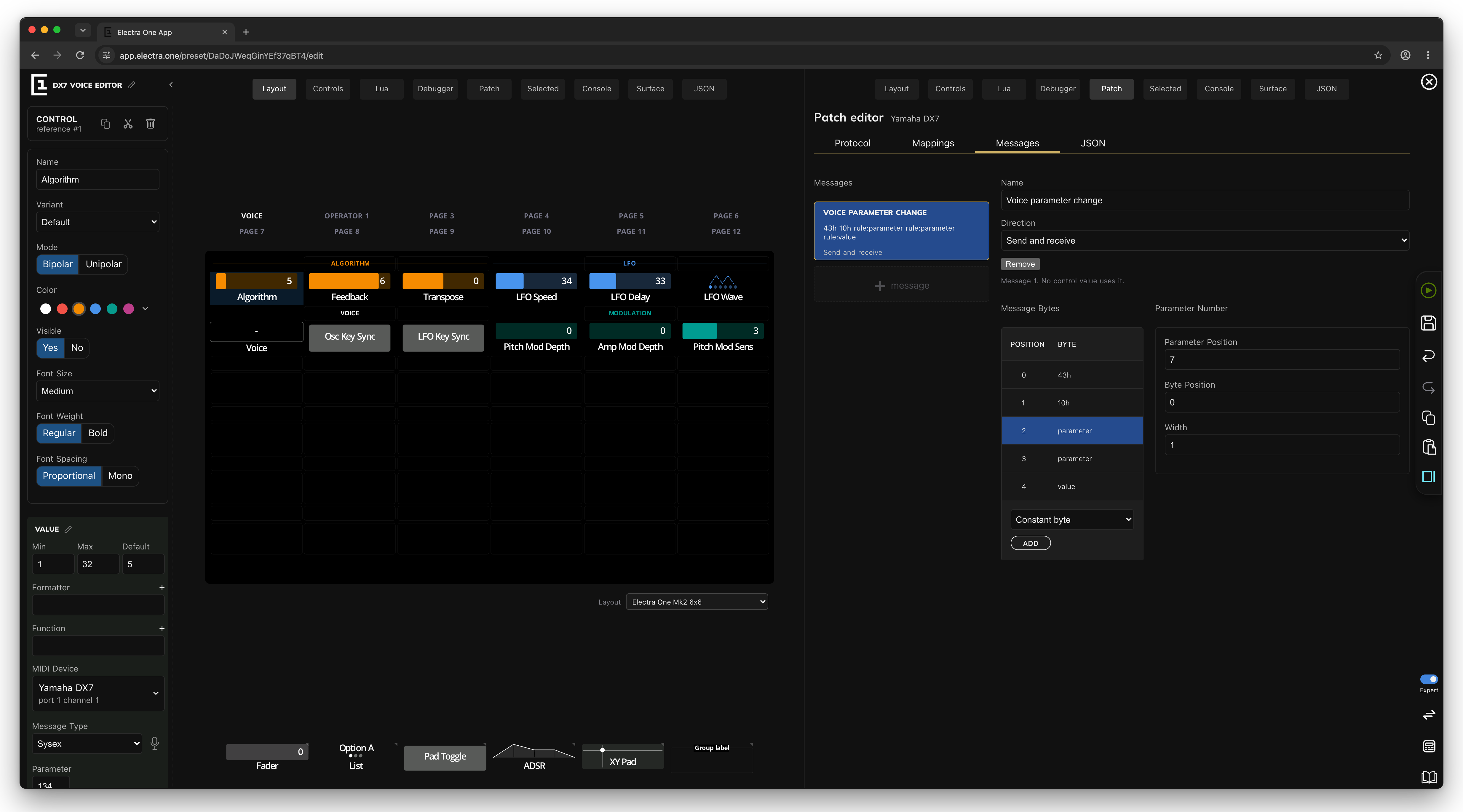

Expert. Device messages are edited on the Messages tab of the patch editor:
Device messages
The DX7 device's Voice parameter change message, with the first parameter number byte selected
  • + message adds a message.
  • Name makes it easier to find in the controls' Sysex Data list.
  • Direction works as for local templates. A control's Direction on a device message is the message's direction, so it applies to every control that uses it.
  • Remove deletes the message. It is disabled while a control uses it; the line under it says how many do.
  • Message Bytes is the same byte editor, with all byte types.
