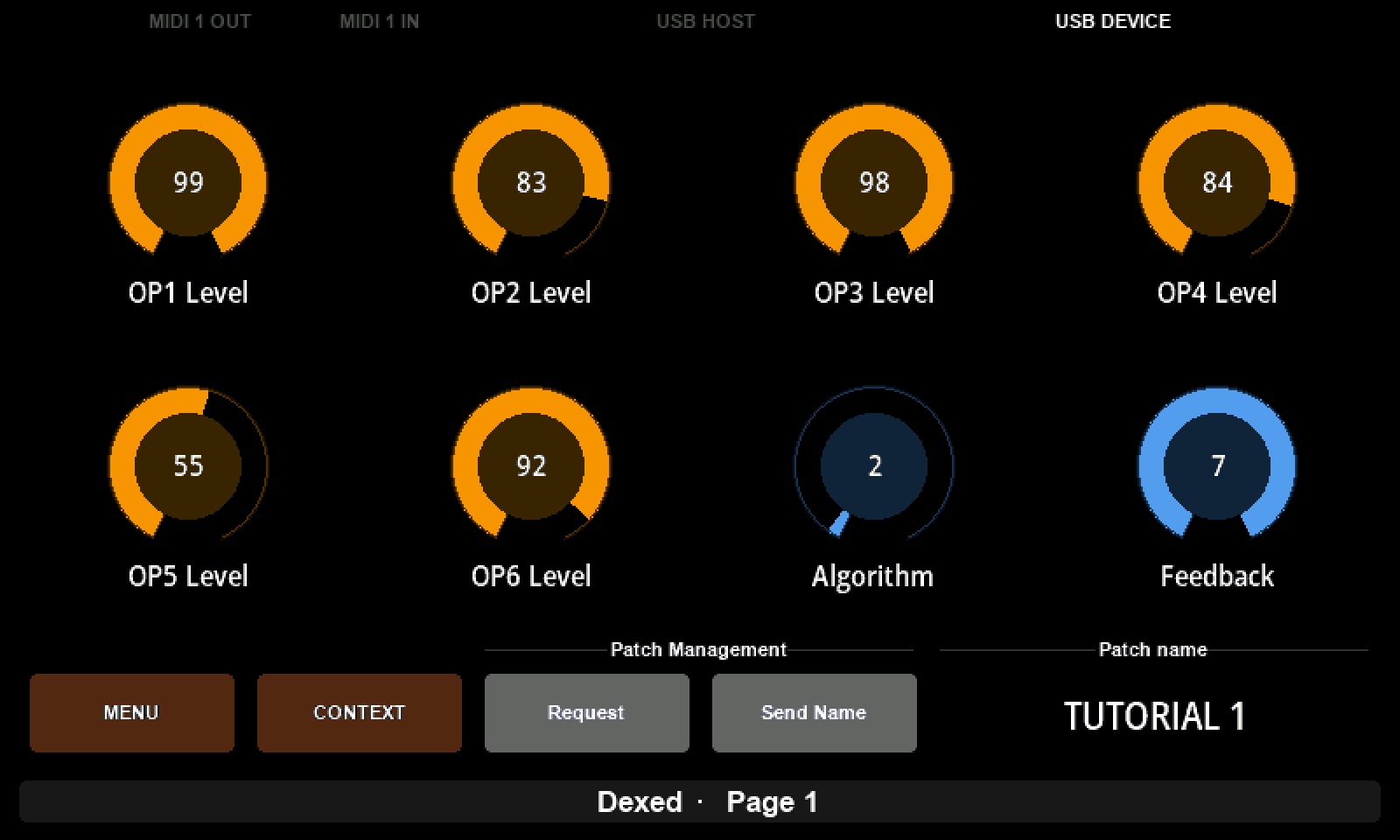

The finished page
Electra One Mini: eight operator dials, the Patch Management group with Request and Send Name, and the Patch name box reading TUTORIAL 1
The Mini's MENU and CONTEXT are buttons of their own, so the four page buttons are all still free: Request keeps button 1, Send Name takes button 2, and the Patch name box covers buttons 3 and 4.

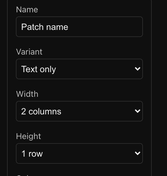

Drag a Text box into the third slot of the bottom row, and a Pad into the second.
The text box
The text box settings: Name Patch name, Variant Text only, Width 2 columns, Height 1 row
Name the box Patch name. Set Variant to Text only, which draws the text alone without the frame and label a box normally carries - right for a wide readout. Set Width to 2 columns so it covers buttons 3 and 4. Its Message Type is Virtual: the box sends nothing, it only shows. Give it a Placeholder as well, no voice, which is what it displays before any dump has arrived.
Call the pad Send Name and set it to Virtual too. Its work will be done by a script.
Two group labels finish the row: Patch Management over the two pads, and Patch name over the box. They cost no slot and they make the row read as two things rather than four.

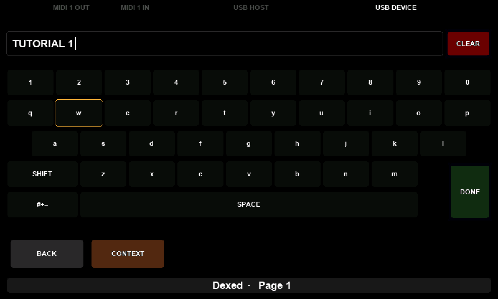

4. Editing it on the controller ​
Press button 3 and the controller opens a keyboard.
The keyboard
The Mini's keyboard editing the patch name: the text field reading TUTORIAL 1, the cursor ring on a key, CLEAR at the top right and DONE at the right
On the Mini, turn KNOB 8 to move the cursor over the keys and press KNOB 8 to type the one under it. SHIFT gives capitals, #+= symbols, CLEAR deletes. To keep what you typed, move the cursor onto DONE and press KNOB 8 there.
Any other button discards it
Pressing any other knob or button closes the keyboard without changing the text. If an edit seems not to have stuck, that is almost always why.
What DONE writes is the same override the script set in step 3. A name read from a dump and a name typed by hand are one string in one place, which is what makes the next step possible at all: the script does not need to know where the name came from.
The other side of that coin is worth knowing too. Request a patch, or let another dump arrive, and patch.onResponse overwrites whatever you typed. The instrument gets the last word, as it should.

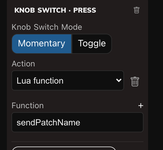

Now hang it on the pad. Select Send Name, and under Events: ADD EVENT → Knob switch · Press → ADD, then ADD ACTION → Lua function → sendPatchName.
The event
The Send Name pad: a Knob switch Press event whose action is the Lua function sendPatchName
