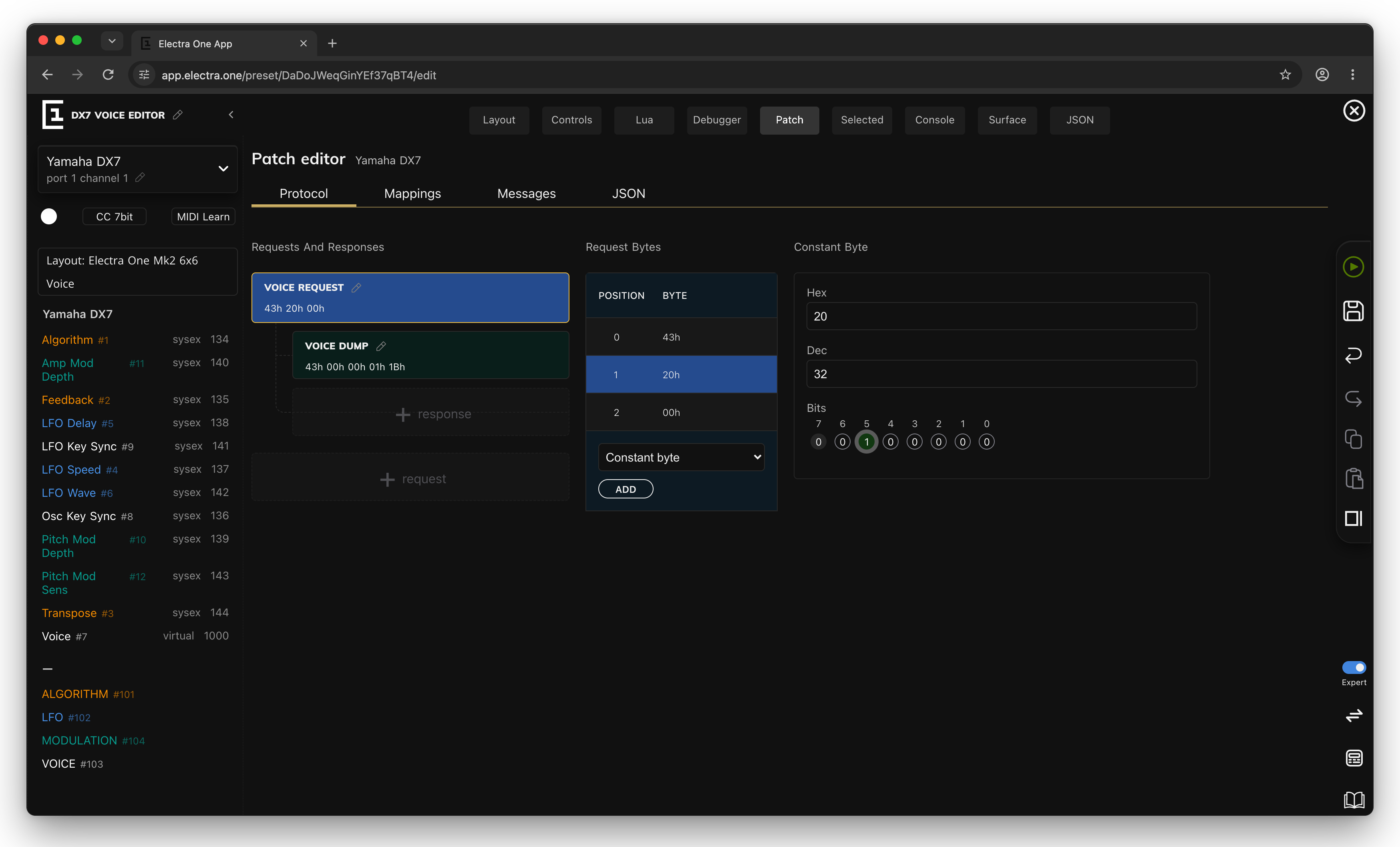

On the Protocol tab, Requests and Responses lists the requests, each with its responses underneath. A new device has one, Default request, with one Default response.
The request
The Voice request of the DX7 device: 43 20 00, with the byte 20h selected
  1. Click the request to select it. Its bytes appear in Request Bytes.
  2. For each byte, choose Constant byte, click ADD, and type the byte in Hex: 43, 20, 00.
  3. Click the name to rename the request, for example "Voice request".
Leave out F0 and F7: Electra One adds them. The DX7 on channel 1 is asked with F0 43 20 00 F7.
A request can also contain a Lua function byte, computed by the preset's script, for example a channel the user can change. Some instruments need more than one request, such as one for the sound and one for the global settings: + request adds another.

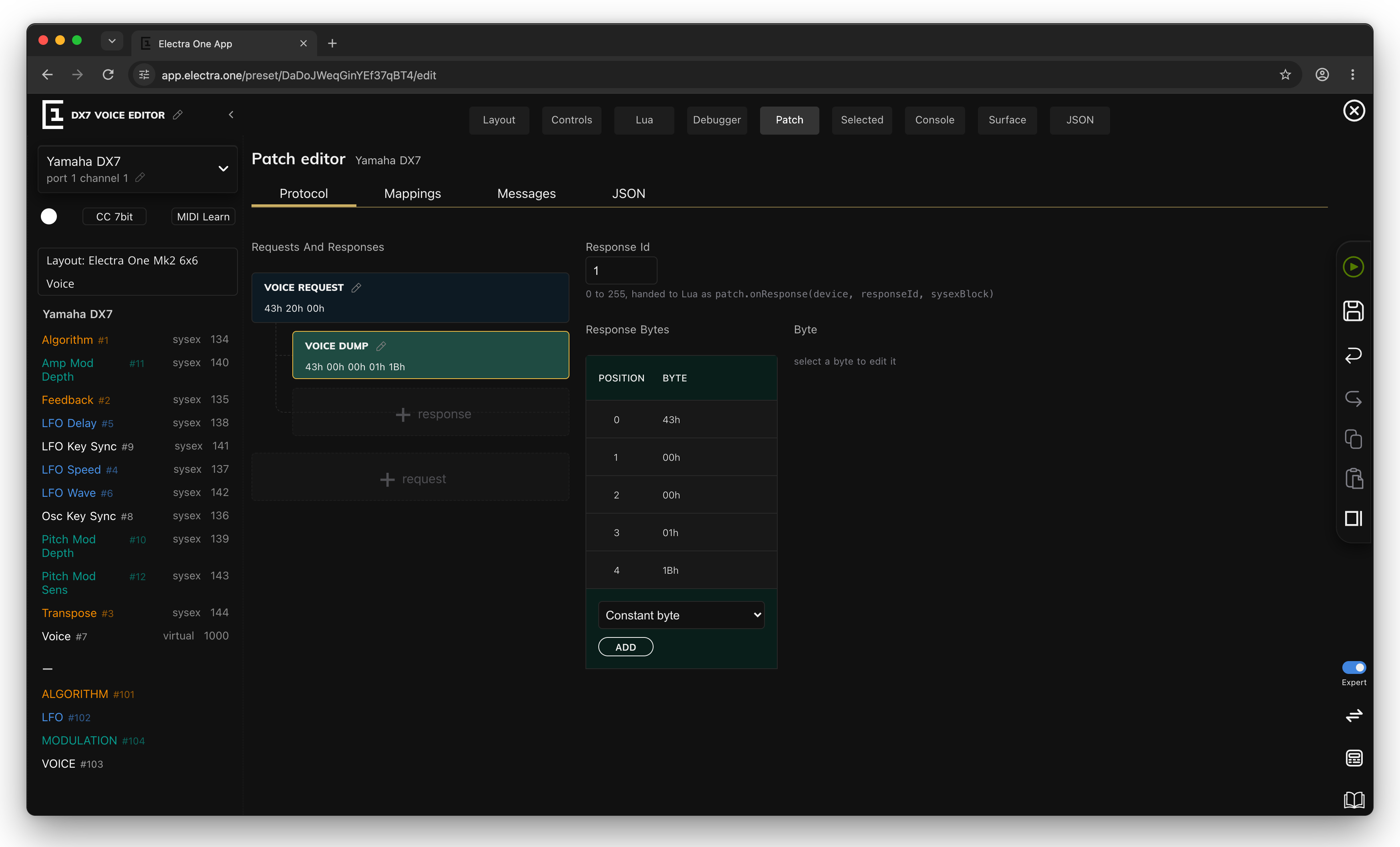

Step 4: Enter the response header ​
  1. Click the response under the request.
  2. In Response Bytes, add the header as constant bytes: 43, 00, 00, 01, 1B. Again without F0.
  3. Rename it, for example "Voice dump".
The response
The Voice dump response: the header 43 00 00 01 1B and its Response Id
The header should contain the bytes that are always the same in this response, and enough of them to tell it apart from other messages: here the manufacturer, the channel, the format and the size. Don't include bytes that change from dump to dump.
Response Id is a number from 0 to 255. Electra One passes it to the Lua function patch.onResponse so a script can tell responses apart. The DX7 Voice Editor uses 1.
An instrument that answers with several messages gets a response for each, added with + response.

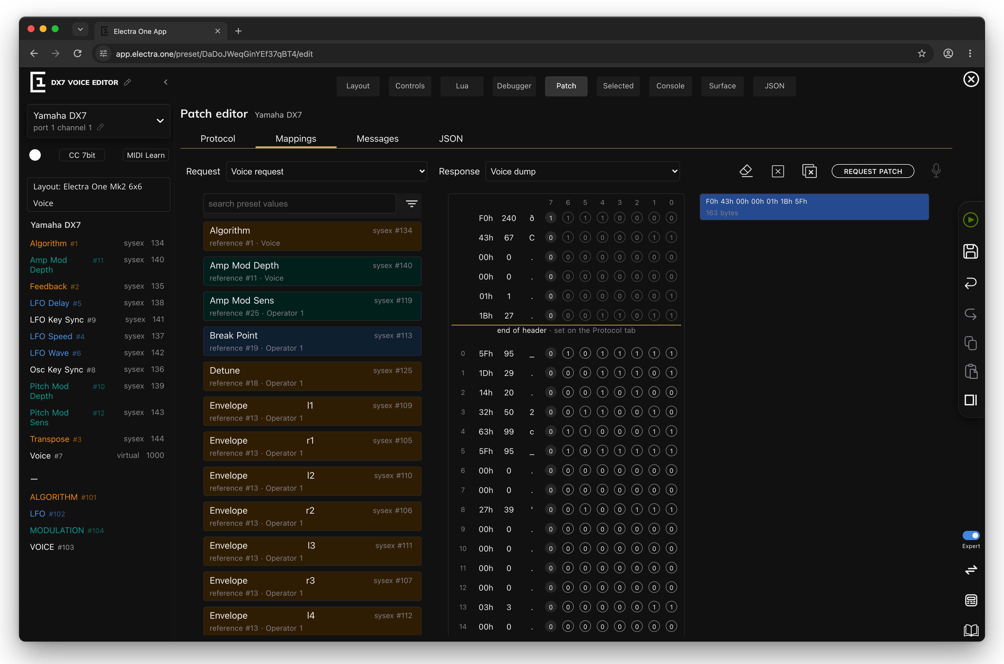

Step 5: Send the preset and capture a dump ​
The rules are easiest to make from a real dump. The patch editor can show dumps the controller receives, bit by bit.
  1. Click Send to Electra, so the controller has the request.
  2. Open the Mappings tab. Check that Request and Response show the request and response you made.
  3. Click the microphone in the menu, Enable MidiLearn. The controller now passes every SysEx message it receives to the editor.
  4. Click REQUEST PATCH. The controller sends the request, and the DX7 answers. You can also send the voice from the DX7's own front panel.
A captured dump
The DX7's voice dump captured on the Mappings tab
The dump appears in the list on the right, "F0h 43h 00h 00h 01h 1Bh 5Fh, 163 bytes", and in the middle column byte by byte:
  • the header on top, down to the line end of header,
  • then the data bytes, numbered from 0, the first byte after the header,
  • each with its value in hex, decimal and as a character, and its 8 bits.
Look at the character column at bytes 145 to 154: the voice name is there, "E.PIANO.1", with spaces shown as dots. It's a quick way to confirm you're looking at the right data.

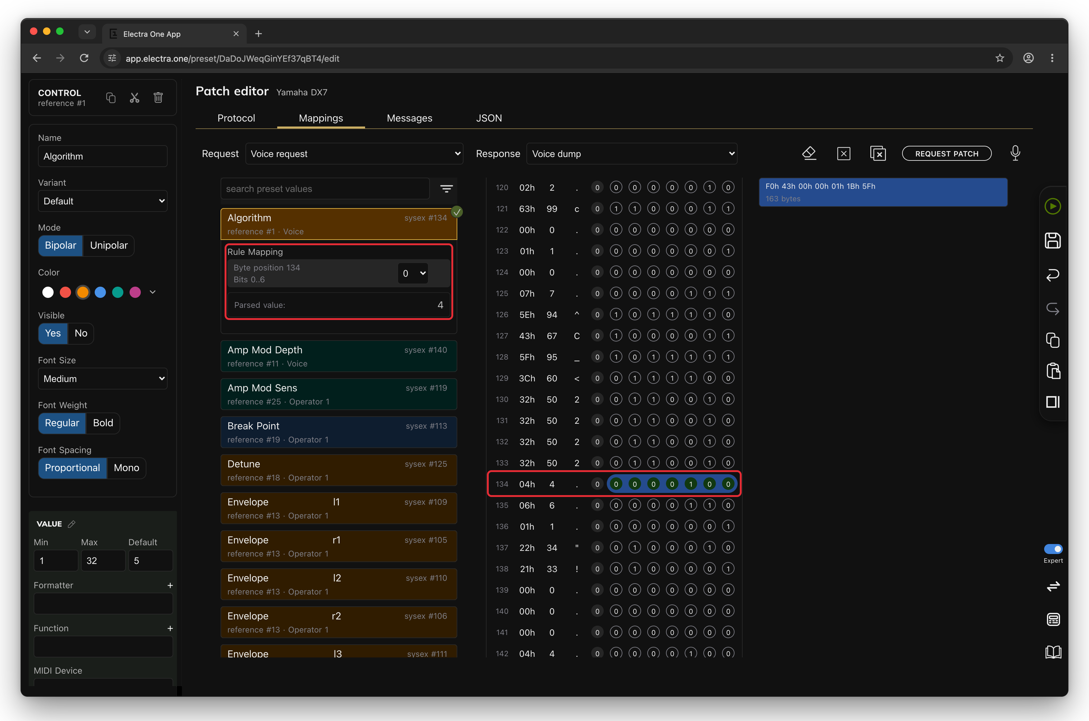

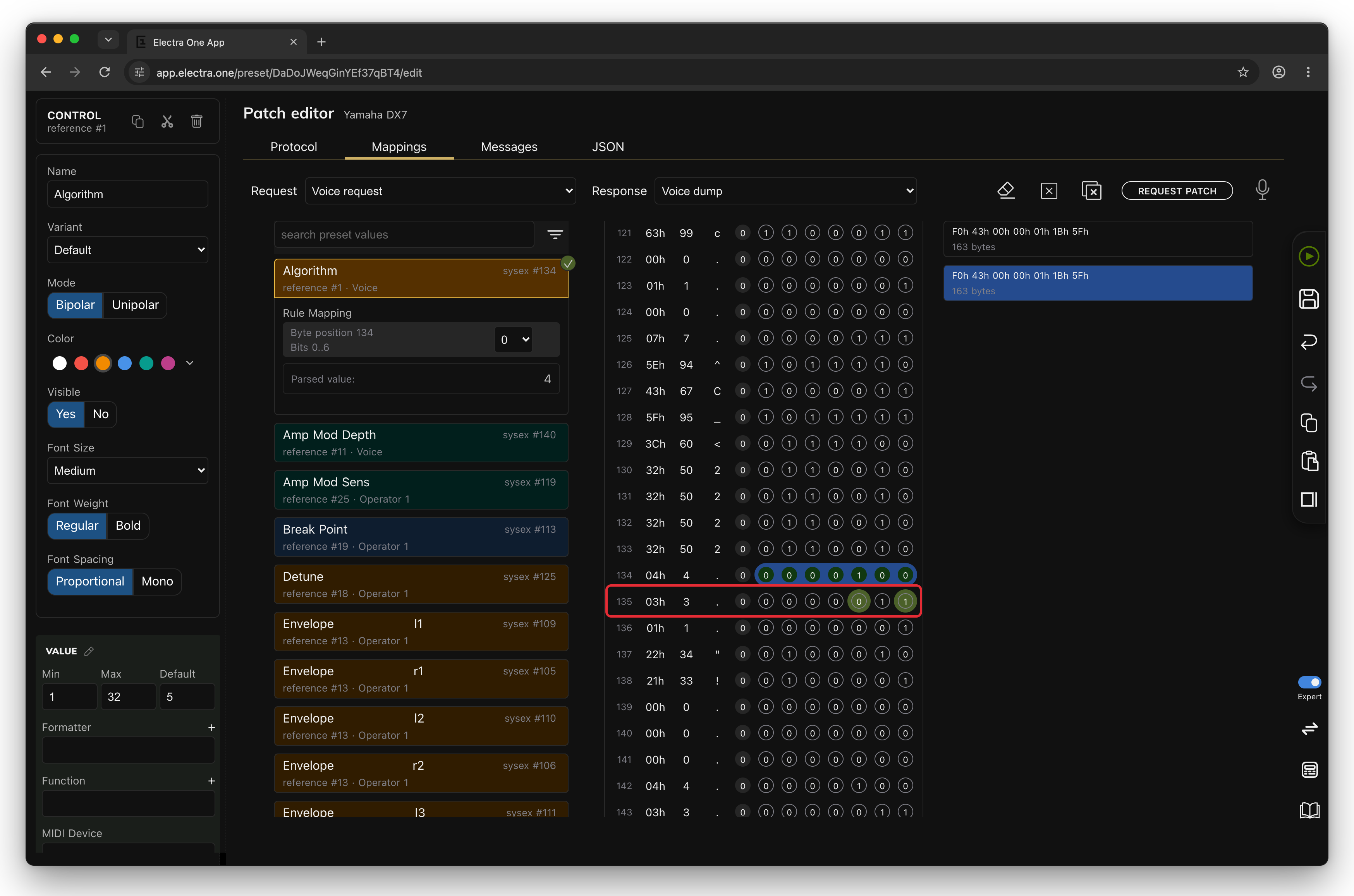

Step 6: Map a parameter ​
Now connect the bytes to the controls. The list on the left holds the values of the preset's controls; the filter button next to the search field chooses between This device only and All devices.
  1. Click Algorithm in the list.
  2. Find byte 134 in the middle column.
  3. Click its bits 0 to 6, one by one. Bits next to each other join into one rule.
A mapping rule
Algorithm mapped to bits 0 to 6 of byte 134. The parsed value is 4
Under the value, Rule Mapping shows the rule: Byte position 134, Bits 0..6, and the selector for where the bits go in the value (0 here). Parsed value is what the rule reads from the captured dump: 4.
The parsed value is a MIDI value. The Algorithm control shows it through its display range: MIDI 0 to 31 as algorithms 1 to 32, so 4 is algorithm 5, exactly what the DX7 shows. This is why the display and MIDI ranges matter; see Values: display and MIDI.
A value with a rule gets a tick in the list. Repeat this for every control: Feedback in byte 135, LFO Speed in 137, Transpose in 144, and so on. A bit that already belongs to a rule selects that rule's value when clicked; to remove a rule, click its bin.
Step 7: Find a parameter the manual doesn't list ​
Not every manual describes its dumps, and some describe them wrongly. The patch editor can find a parameter for you:
  1. Click the eraser, Clear marked bits.
  2. On the instrument, change one parameter, for example the feedback from 6 to 3.
  3. Request the patch again, or send the voice from the instrument.
Changed bits
After the feedback was changed from 6 to 3, the changed bits of byte 135 are marked in green
The bits that changed since the previous dump are marked in green. Here they are in byte 135: that is where the feedback lives. Marks add up until you clear them, so clear them before each experiment.

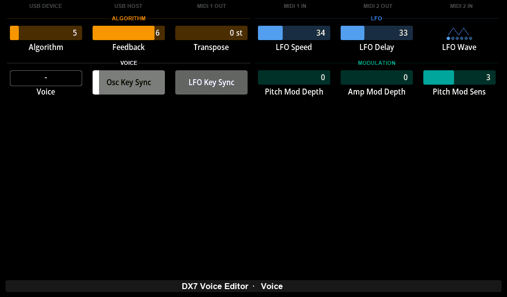

Controls before the request
Electra One Mk2 before the request: the controls show the preset's defaults

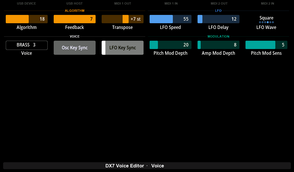

Controls after the request
After the request: the controls show the DX7's voice, and the Lua script shows its name, BRASS 3
Every mapped control jumps to the instrument's value. Electra One does not send these values back to the instrument; they came from it.

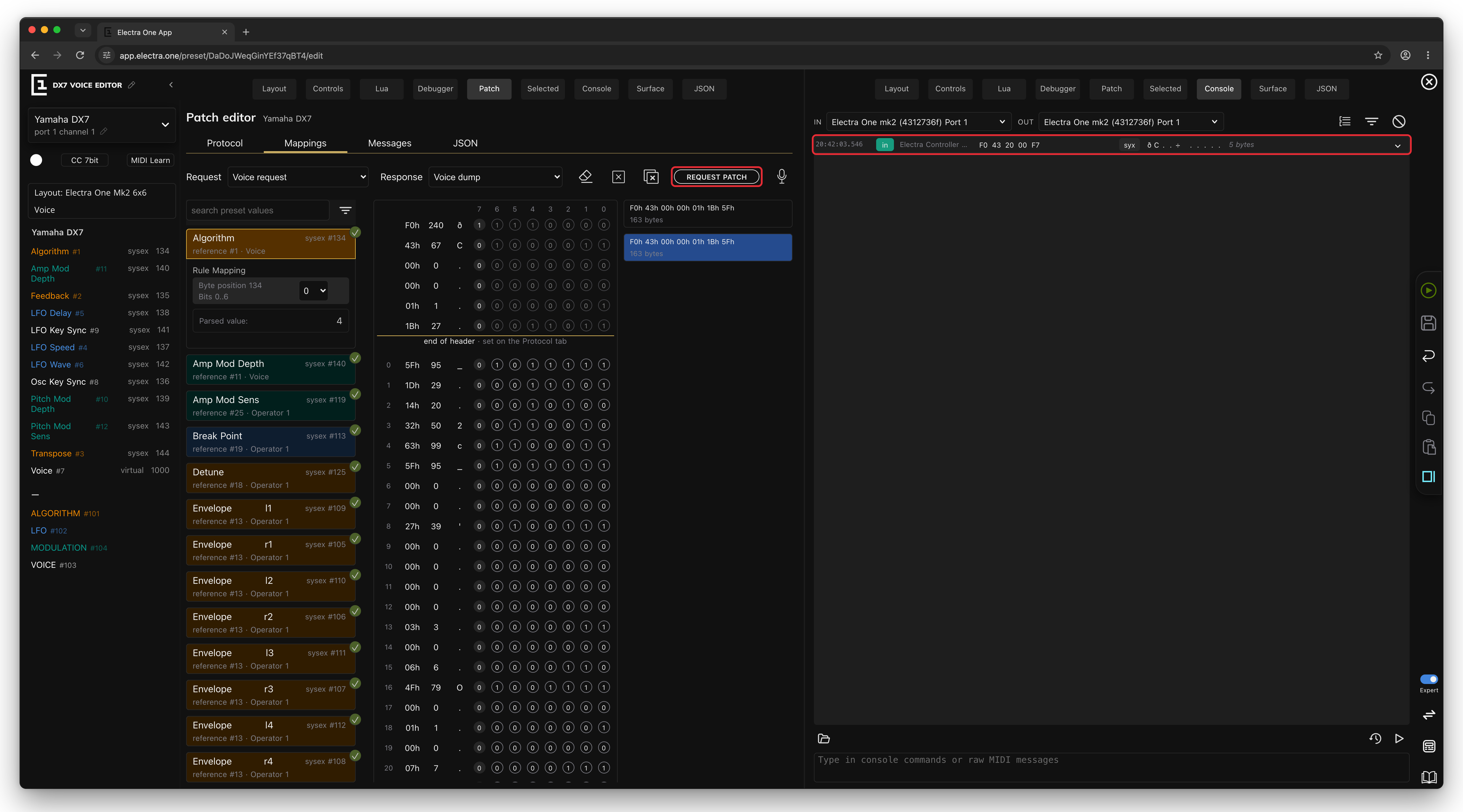

The MIDI Console in split view shows the request leaving the controller:
The request in the console
Split view: REQUEST PATCH on the left, the request F0 43 20 00 F7 arriving in the MIDI console on the right
