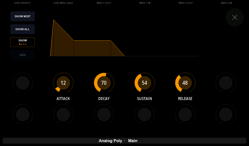

A control on a page is moved by one knob, so an envelope's knob changes one stage at a time and an XY Pad's knob one axis at a time. In a detail window each value has a knob of its own, with its name and its number under it: the whole envelope can be shaped without choosing stages, and both axes of a pad are in reach at once.
An envelope detail window
An ADSR envelope in its detail window: the graph, a knob for each stage, and the buttons that say what the knobs do

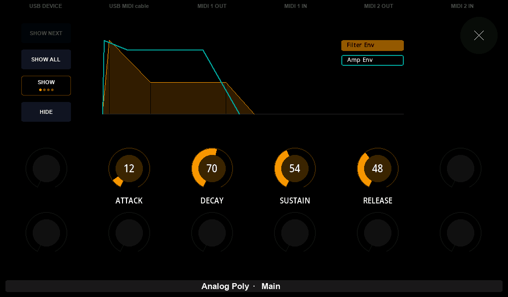

  • Envelopes can draw the preset's other envelopes of the same shape over this one, so two filter and amplitude envelopes can be compared, and the knobs can move them together.

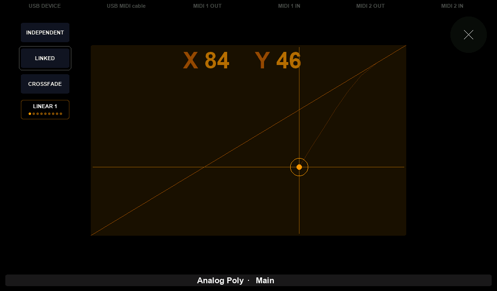

  • An XY Pad can hold its two values to a line across the pad, so one parameter follows the other as a filter's key tracking or a crossfade between two layers does.

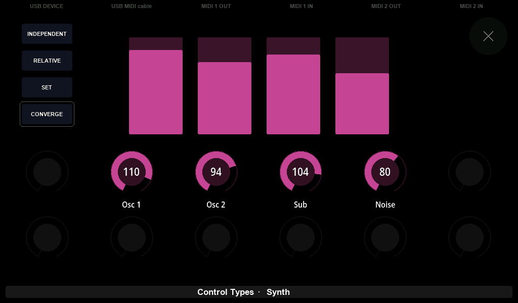

  • A V Fader 4 can move its four faders together: by the same amount, onto the same value, or drawing the other three towards the one you are turning.

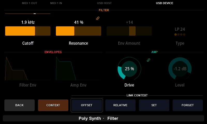

  • A fader can lead a group of other controls on the page, of any type, and they move when it does.
Two envelopes in one detail window
The amplitude envelope drawn over the filter envelope, each in its own colour. The knobs can move both
An XY Pad held to a line
The two values held to a line across the pad. There is one place on the pad to be, and both knobs drive it
Four faders converged
Turning one fader's knob brought the other three towards it, and turning it back returns them
A group of controls led by a fader
Cutoff leads; Resonance and Drive wear a chain and follow it. The rest of the page is dimmed

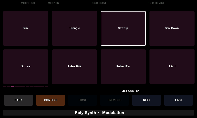

  • A list shows its items as a grid you can read and choose from, instead of stepping through them one at a time.

A list in its detail window
A twelve-item list shown as pads. The strip in the corner says where in the list the value stands
