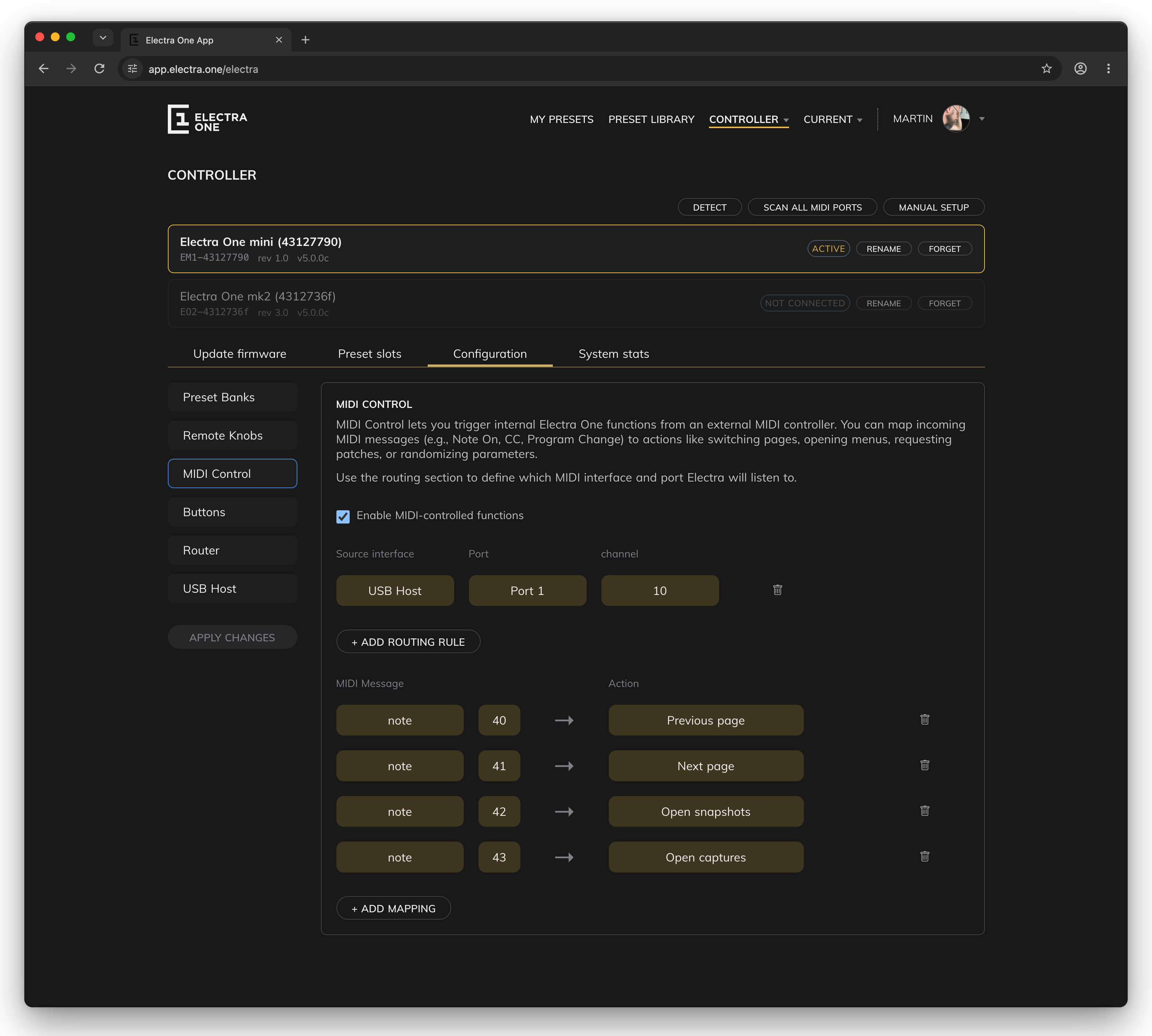

MIDI Control listens only to the inputs, ports and channels you route to it. On the Mk2 that is the CTRL column of the Router screen; in the Electra One app it is the routing section of the MIDI Control settings. The mappings belong to the controller, not to a preset, and work with every preset.
Only the messages that match a mapping are MIDI Control's. The rest of what arrives on its route reaches the preset as usual, so a controller can have two of its buttons switch pages while its other knobs and keys still play the preset. When a Note On runs a command, the Note Off of the same key is kept as well, so the preset never receives the release of a key it did not see pressed.

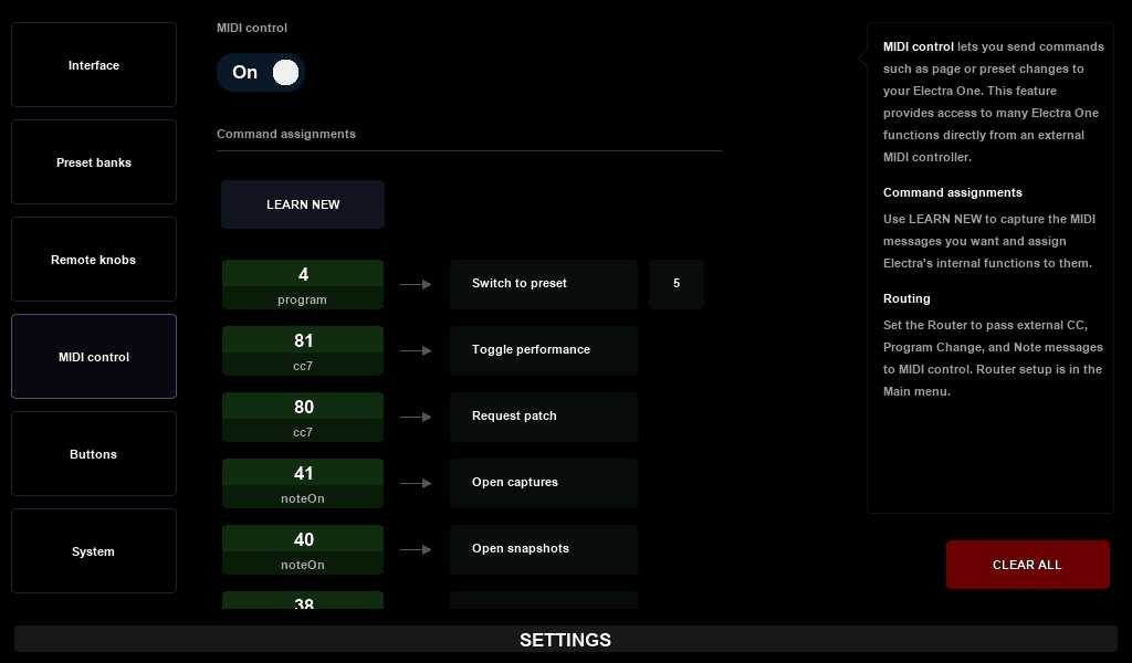

MIDI Control mappings on Electra One Mk2
Electra One Mk2: MIDI Control in the settings. LEARN NEW records the next message that arrives, and a command is chosen for it
On the Mk2, mappings are made in Settings ▸ MIDI control: press LEARN NEW, send the message, and choose the command. On the Mini, and on the Mk2 as well, they are made in the Electra One app.
MIDI Control in the Electra One app
Electra One Mini in the Electra One app: pads of a controller on USB Host Port 1, channel 10, switch pages and open the SNAPSHOTS and CAPTURES windows

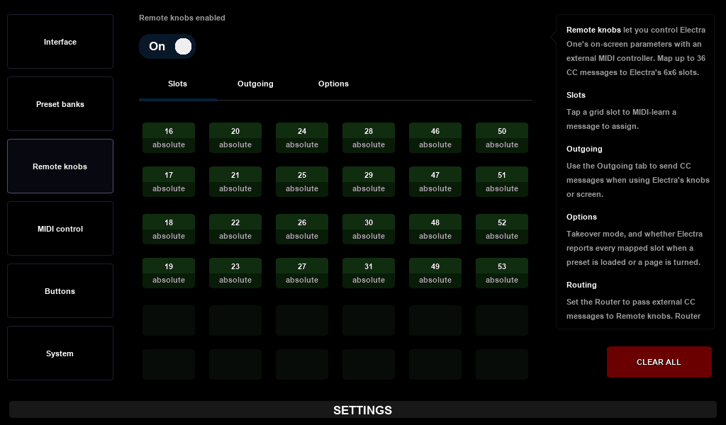

In Dynamic mode, a Control Change is mapped to a knob slot: a position of one of Electra One's own knobs. The Mk2 has 36 slots, twelve knobs in each of its three control sets; the Mini has 12, for its eight knobs and four buttons.
A slot drives whatever control sits at that position on the page you are looking at. When you turn the page or change the control set, the same message drives a different control. This is how an external controller extends Electra One's own knobs: one setup works on every page of every preset.
Each mapping is absolute, for faders and knobs that send a position, or relative, for endless encoders that send steps. When an absolute fader and a value disagree, the takeover setting decides what happens, as described in Remote knobs in The Concept of Control.
Dynamic mappings belong to the controller and are used by every preset that has no remote map of its own.

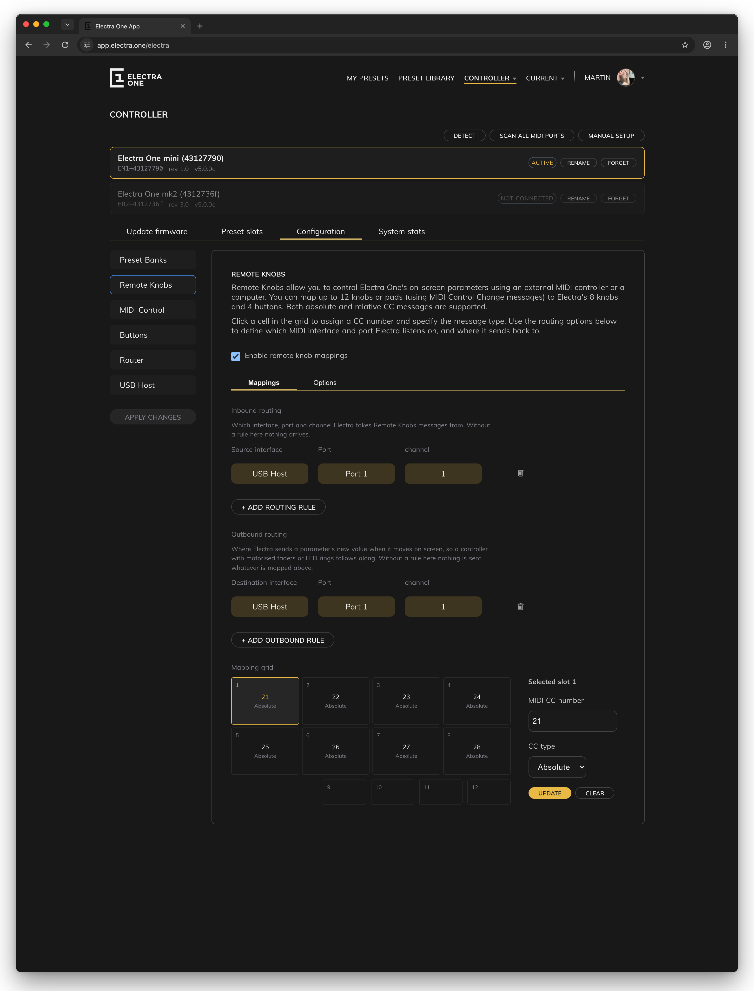

On the Mk2, the slots are set in Settings ▸ Remote knobs: tap a slot, press LEARN and move a knob on your controller. On the Mini they are set in the Electra One app.
Remote knobs in the Electra One app
Electra One Mini in the Electra One app: the knobs of a controller on USB Host Port 1 mapped to the eight knob slots, with the values sent back to the same port
