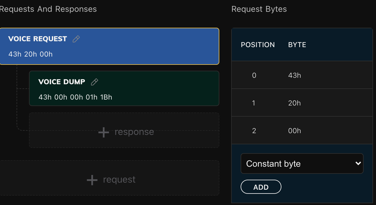

Click an empty part of the page so nothing is selected, choose Dexed in the device box, and open the Patch tab and its Protocol sub-tab. A new device already has a Default request with a Default response underneath.
Click the request to select it. Its bytes appear in Request Bytes: add three Constant bytes, 43, 20 and 00, and rename it Voice request.
The request
The Protocol tab: Voice request made of 43h, 20h and 00h, and the Voice dump response under it
As everywhere in the editor, you leave out F0 and F7 - the controller wraps the message itself. What goes on the wire is F0 43 20 00 F7.
The 20 is worth a second look. It is a constant, and it therefore hard-codes channel 1, exactly as the 10 of the parameter change did until a Lua byte replaced it in the last tutorial. The same getChannelByte trick works here with 0x20 in place of 0x10, and the preset already carries the function. It is left as a plain constant in these pictures only to keep the tutorial about the other thing.
4. The response header ​
Now the answer. Click the response underneath the request, add five Constant bytes in Response Bytes - 43, 00, 00, 01, 1B - set Response Id to 1, and rename it Voice dump.
A header is the beginning of the message, and the controller uses it as a fingerprint: every SysEx message that arrives is compared against it, and one that starts with those bytes is this response. So a header should contain the part of the answer that never varies, and nothing else. Here that is the manufacturer, 0n meaning "here is a dump" on channel 1, 00 for one voice, and the two bytes that say 155. Everything after them is the sound itself, different every time, which is exactly why the header stops there.
It has to be long enough to be unambiguous, too. Four bytes would also have matched a 32-voice cartridge dump, which begins 43 00 09 20. The fifth byte is what makes this header mean one voice and nothing else. A header takes no F7, because it is a prefix rather than a whole message.
Response Id is for Lua and nothing else: the controller hands it to patch.onResponse so a script can tell one kind of dump from another.
Then Send to Electra.

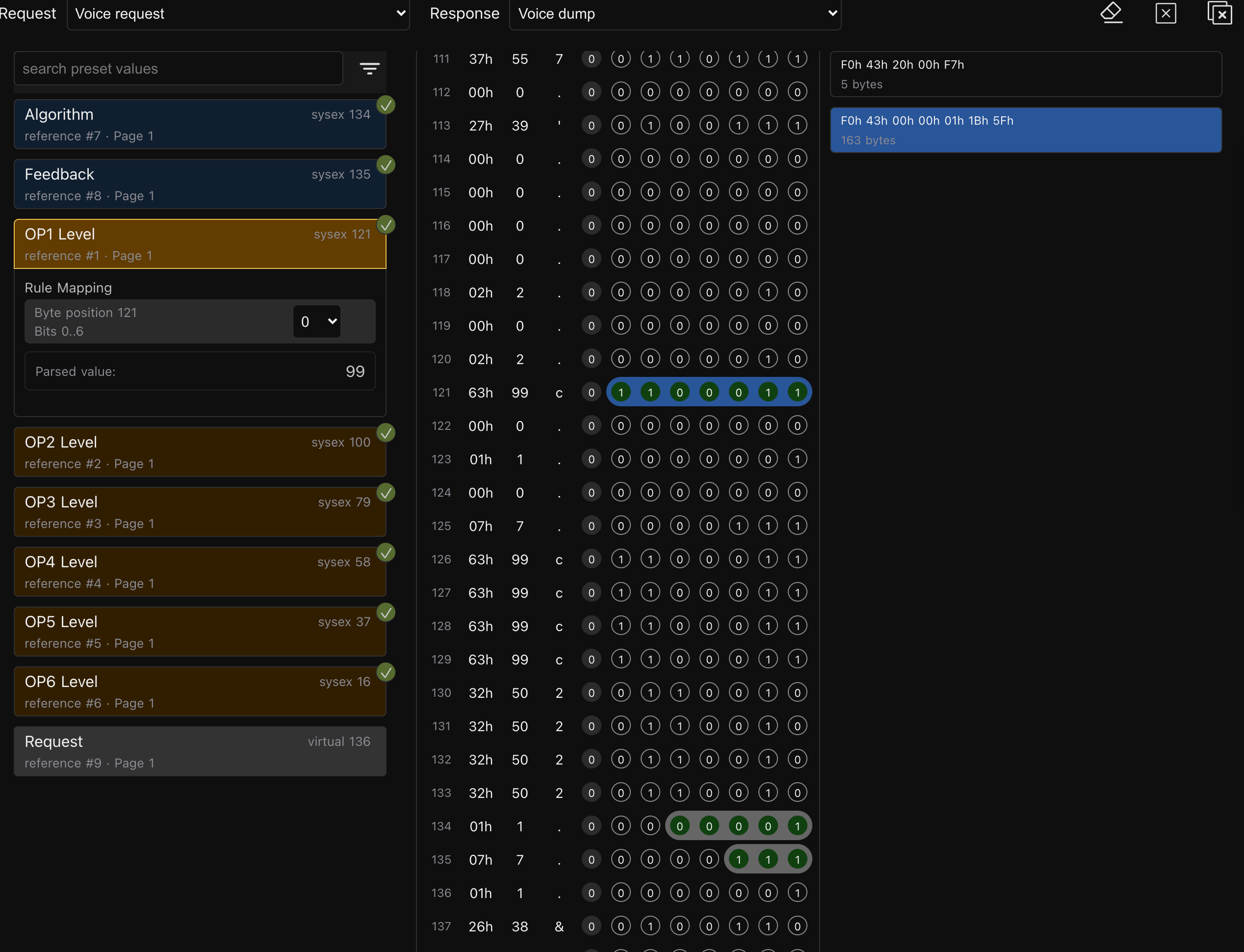

Rules are far easier to build from a real dump than from a manual, and the editor will show you one byte by byte. Open the Mappings tab - Request and Response at the top should show the two you just made - and click the microphone to Enable MidiLearn. The controller now hands every SysEx message it receives straight to the editor instead of acting on it.
Click REQUEST PATCH, then send a voice dump at the controller from your librarian.
A captured dump
The Mappings tab: the request and a 163-byte dump in the captured list, the dump's bytes in the middle column, scrolled to the voice name
Two things land in the captured list on the right. The five-byte F0 43 20 00 F7 is our own request going out - the editor captures everything it sees, including what the controller sends - and the 163-byte message is the dump: six header bytes, 155 data bytes, a checksum and F7.

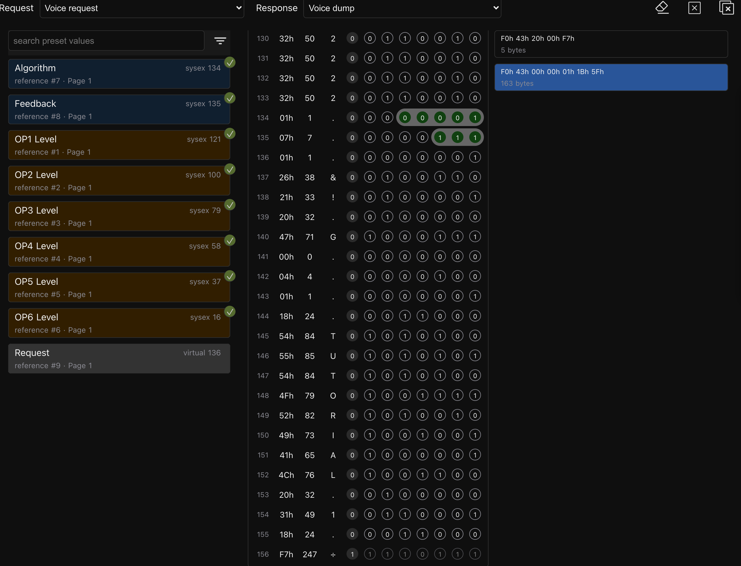

Click the dump and the middle column fills up. The header sits on top, down to the line end of header; then come the data bytes, numbered from 0, each shown in hexadecimal, in decimal, as a character, and as its eight bits.
Before writing a single rule, scroll to bytes 145 to 154 and read the character column downwards. Those ten bytes are the voice's name, and here they spell TUTORIAL 1, the space drawn as a dot. It is a small thing that proves a large one: if the name is legible, you are counting bytes the same way the manufacturer did, and every other byte is where the manual says it is.
Byte 155 is the checksum and 156 is the closing F7. The data really does stop at 154, which matters in a moment.
6. Bytes into controls ​
Now join the two halves together. The list on the left holds the preset's values; the middle column holds the dump. A rule is a line drawn between them.
Click OP1 Level in the list, find byte 121 in the middle column, and click its bits 0 to 6, one at a time. Bits next to each other join into a single rule as you go.
A rule
OP1 Level mapped to bits 0 to 6 of byte 121, with Parsed value 99
Rule Mapping underneath the value now reads Byte position 121, Bits 0..6, and Parsed value shows what that rule reads out of the dump on screen: 99. Byte 121 is 63h, which is 99 in decimal, which is a DX7 operator at full output. A tick appears beside the value in the list to say it is now read from a dump.
Parsed value is the reason for building rules from a captured dump rather than from the manual. You are never guessing: every click is checked against a real message before the controller ever sees it.
The other five operator levels are the same piece of work at bytes 100, 79, 58, 37 and 16. Then two that are not whole bytes: Algorithm is bits 0 to 4 of byte 134, and Feedback is bits 0 to 2 of byte 135. Small parameters share a byte rather than waste one each, so you take only the bits that belong to you - the receiving half of the packing that Six Switches in One Byte did by hand on the way out. A rule can read at most seven bits of one byte, which is all a SysEx data byte has to give.

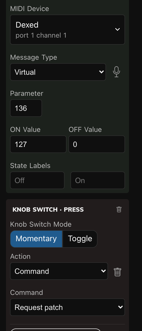

On the Layout tab, drag a Pad into the first slot of the bottom row. That row belongs to the Mini's four hardware buttons, and it takes only pads and lists. Call it Request, and set its Message Type to Virtual - which means the pad sends no MIDI of its own, because the work is done by a command rather than by a message.
Then give it the command. Under Events, ADD EVENT → Knob switch · Press → ADD, and on the event that appears, ADD ACTION → Command → Request patch.
The pad's event
The Request pad: a Virtual message and a Knob switch Press event running the Request patch command
Send to Electra and press the hardware button under the pad. F0 43 20 00 F7 appears in the console: the same bytes the editor's button sends, now under your thumb. Events are the subject of How Events Put More on One Page, and this is the simplest useful one there is.
One thing to know: a Knob switch event replaces whatever pressing a control normally does, so this pad no longer toggles on and off. For a trigger, that is exactly right.
